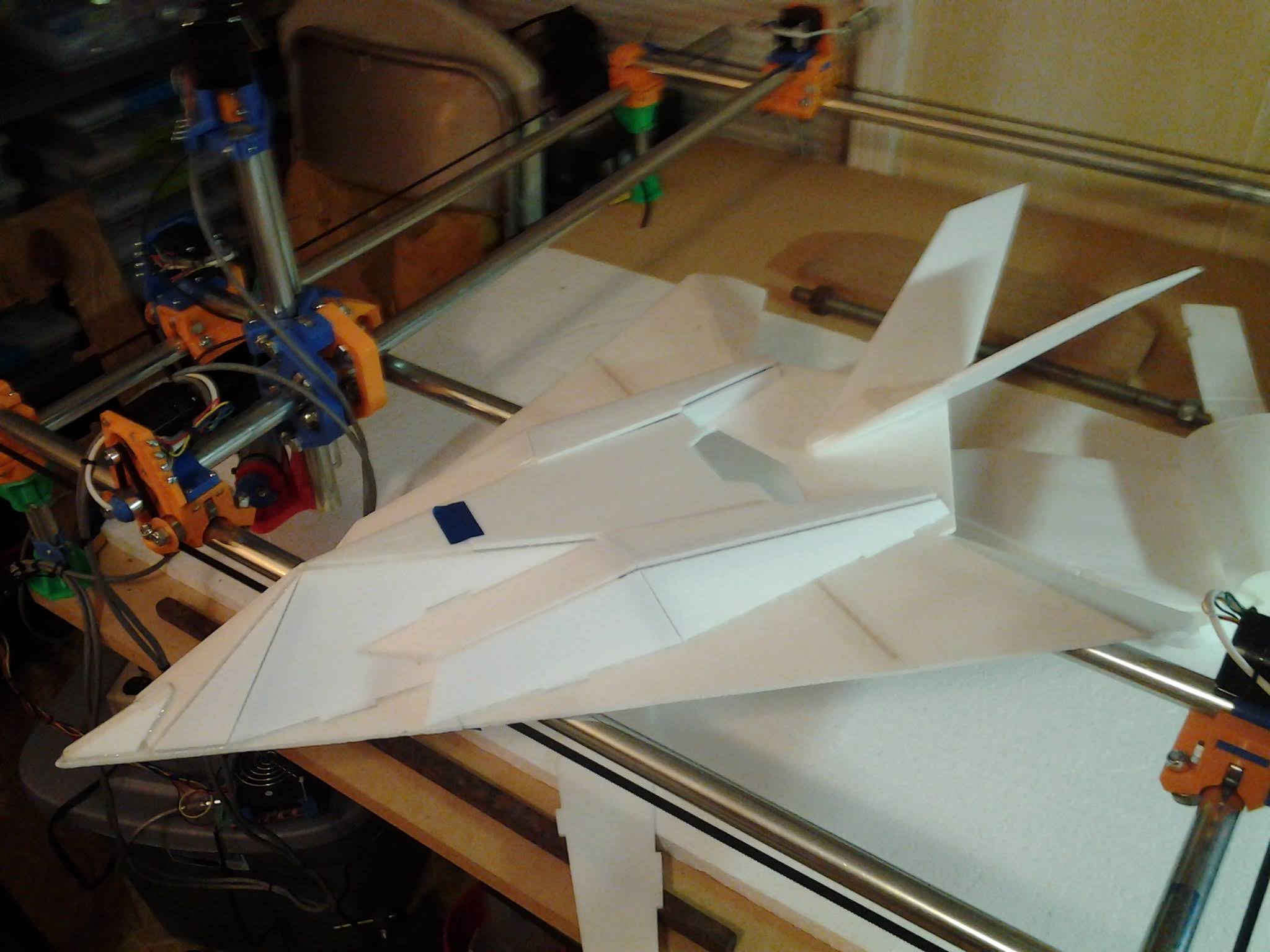

My late fishing/flying buddy and I set about to prove that very thing – getting into RC on the cheap – back in the 2010 time frame. RC was a rich man’s game when we were young but with the availability of cheap electric motors and electronics from China, we were able to get started for $100 or so. At first, we downloaded simple foamy PDF plans and hand-cut our planes from bluecore fan-fold insulation foam from Lowes… and with a cheap $35-$40 transmitter we flew – and crashed – those planes out in my pasture. Eventually, “demolition derby” style flying became our favorite past-time… flying, crashing, field-repairing with tape, craft sticks, skewers, hot glue, etc. Last man left with enough “plane” that could be thrown into the air, and “flown” for any distance, won.

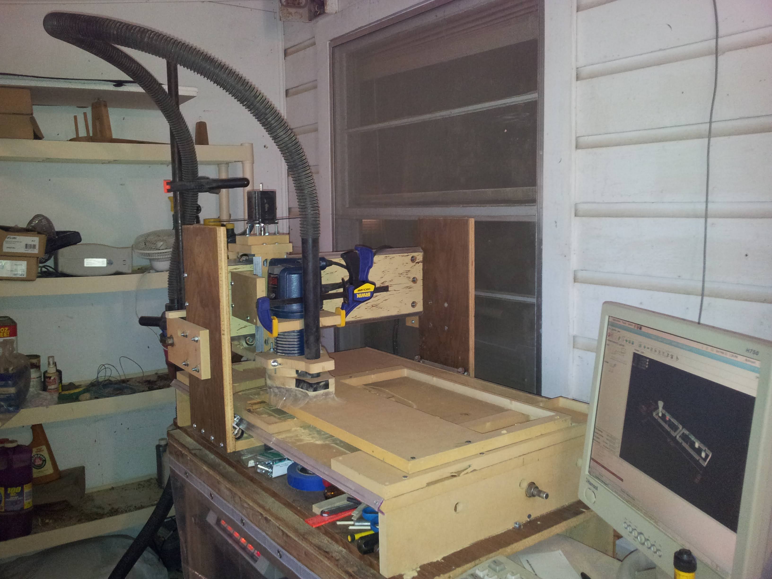

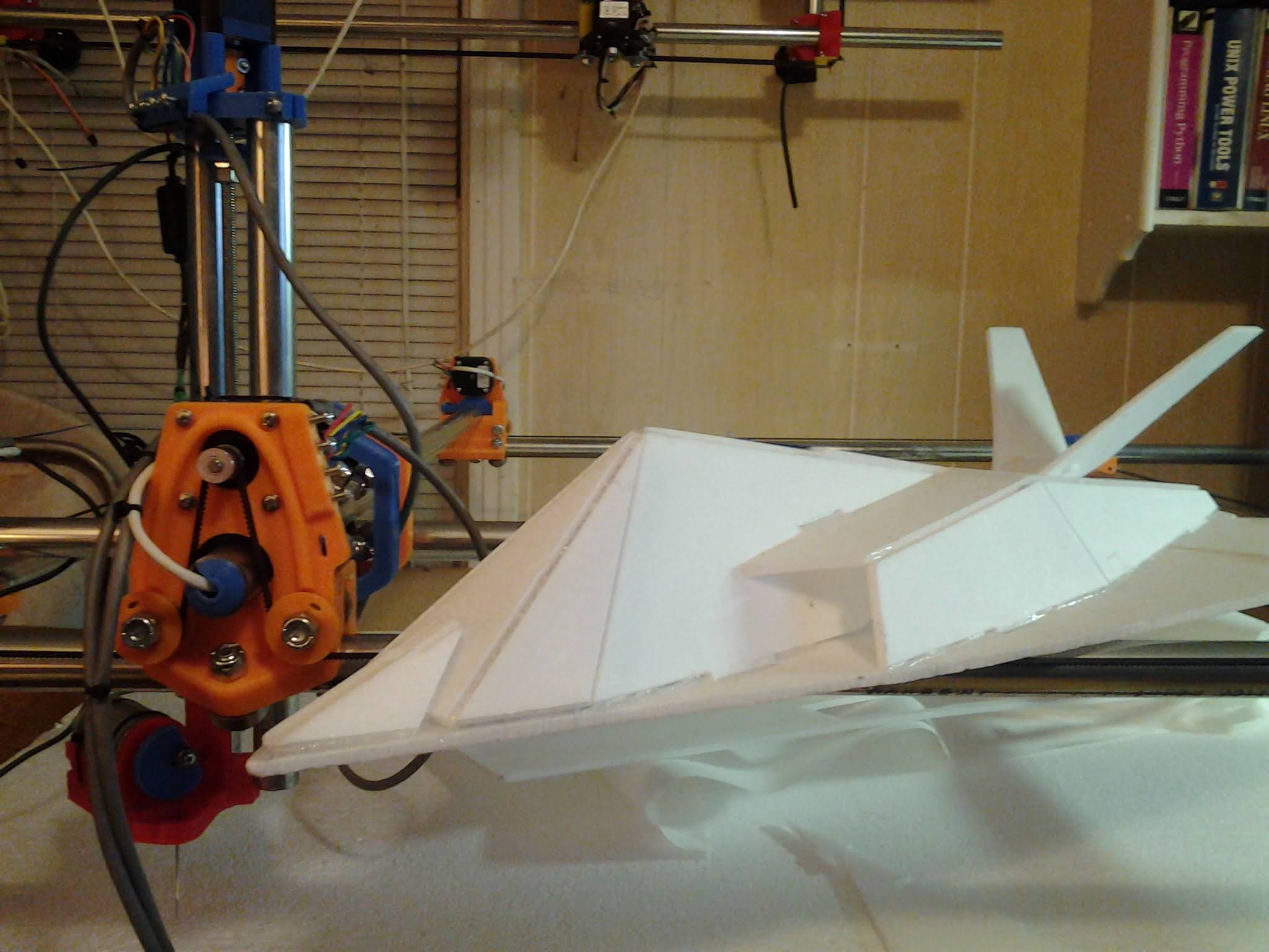

But I quickly learned to hate hand-cutting planes and, with my EE background and burgeoning interest in CNC, I set about developing the needle cutter. I built my buddy a similar BuildYourCNC-inspired 3-axis machine with a needle cutter and soon we were able to retire each night to our homes and cut our simple planes and assemble a new one over-night… and be back at it again the next evening. What great fun we had.
With SketchUP we were able to start designing our own planes and wound up with quite a fleet. The F4D Skyray (middle top) was our best flyer and we built countless others. Cheap, quick/easy to build… we quickly got over our apprehensions and fear of crashing.
I’m out of the RC and needle cutter “business” now but we did prove that getting into RC doesn’t have to be prohibitively expensive and great fun can be had with just a bunch of foam board and a few relatively cheap RC components.

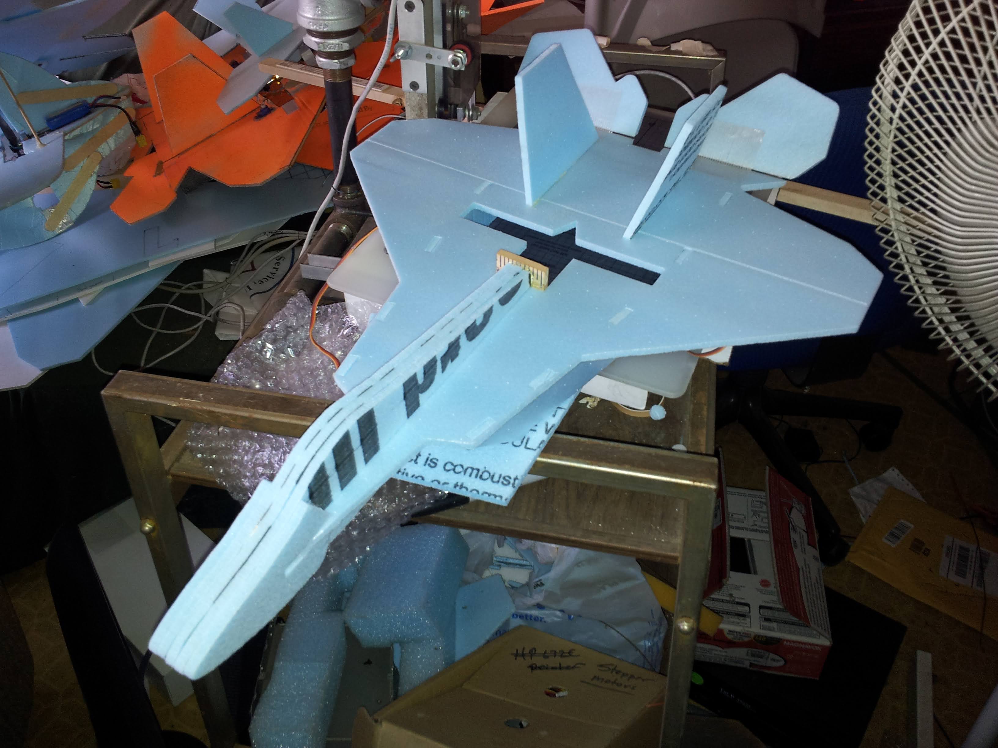

No, never did. Most of our planes were modeled after military planes and eventually we settled on a size and wing span appropriate for little BlueWonder motors and one panel of fan fold. Some were front-prop WW2 fighters but most were prop-in-slot jets… some flew well, others not.

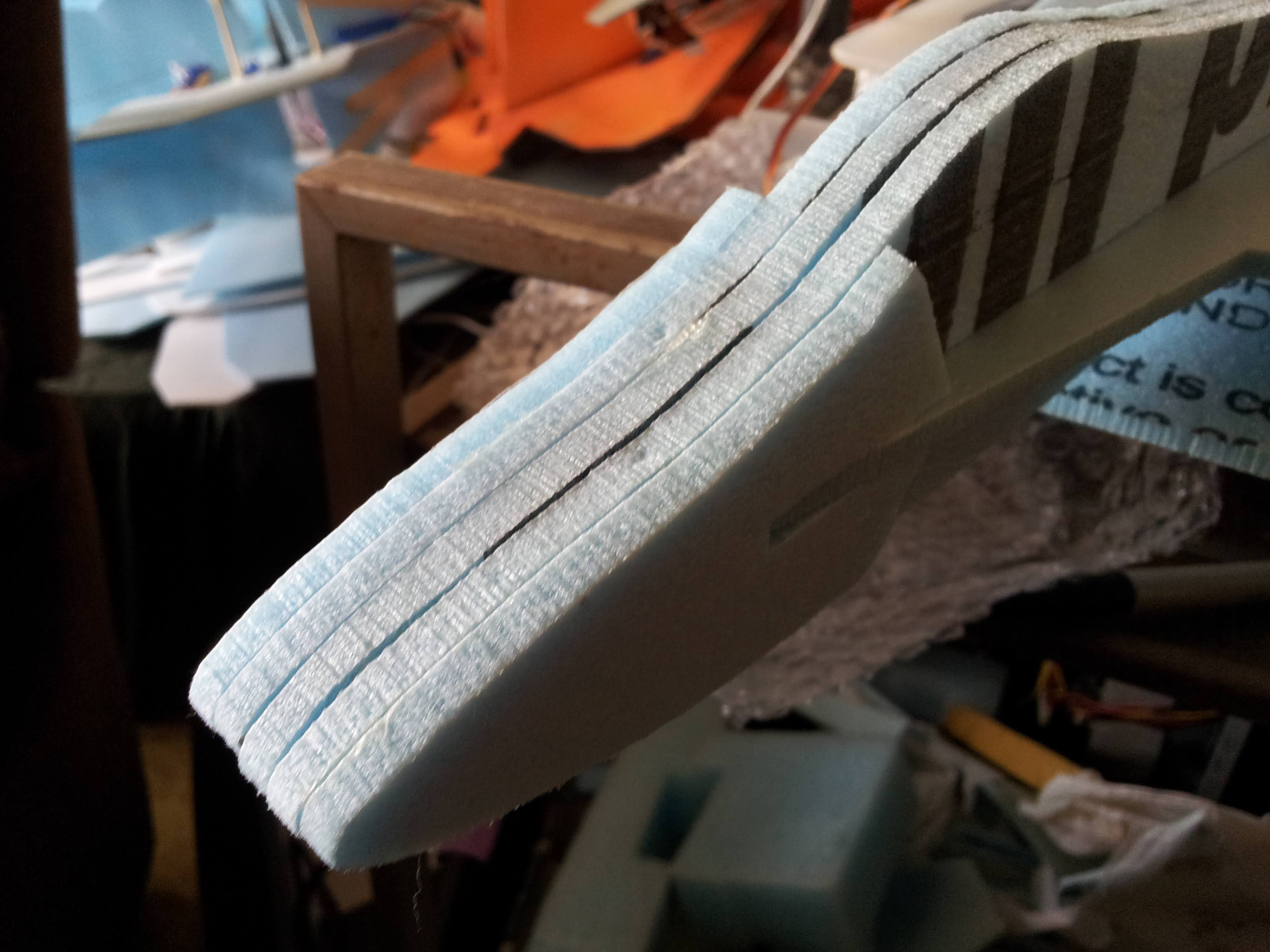

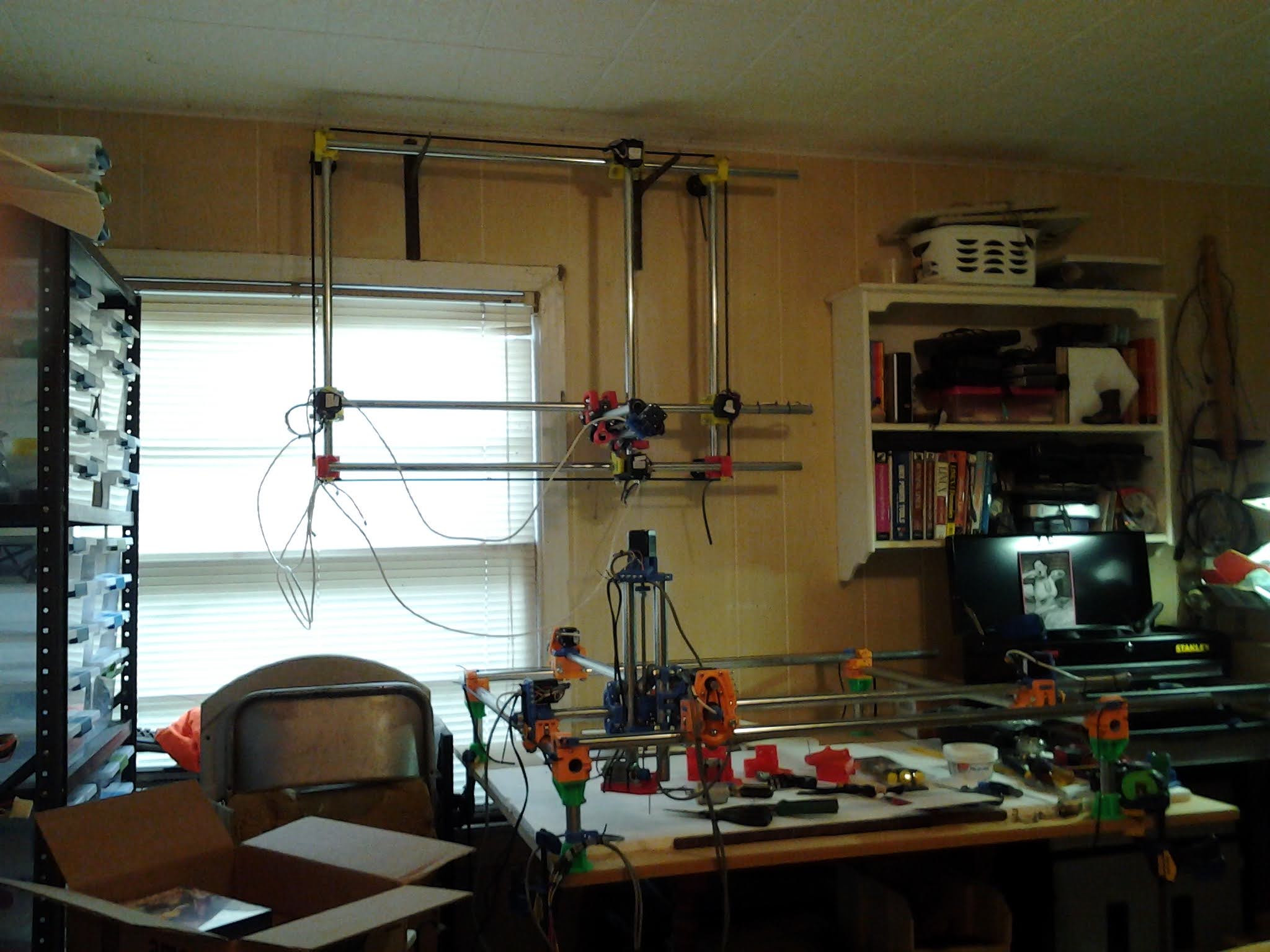

Our needle cutter systems changed over time as well, going from LinuxCNC-driven CNC machines and bluecore foam…
to over-sized Marlin-driven MPCNC’s and DTFB…
Lots of fun times we had playing with this stuff.

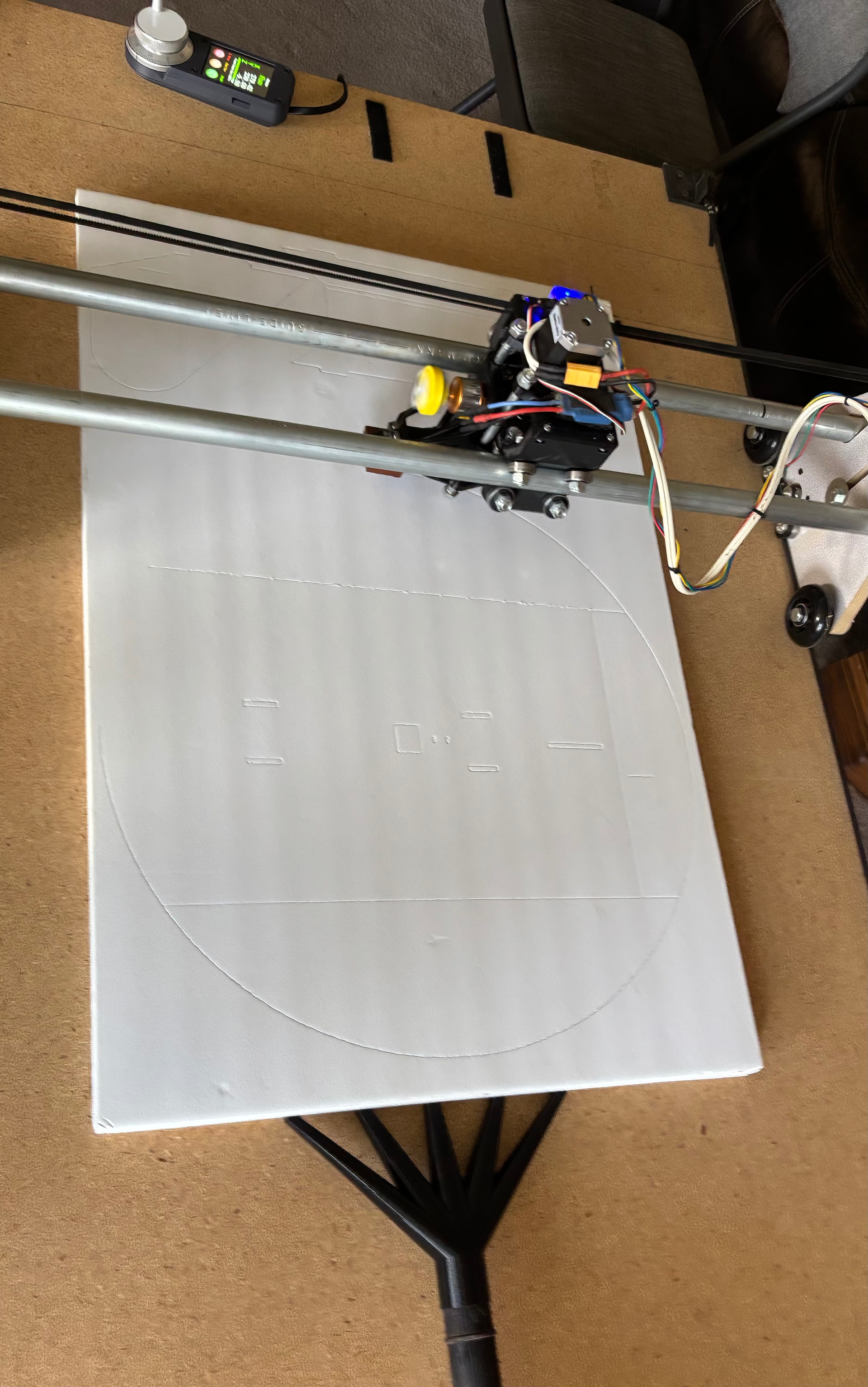

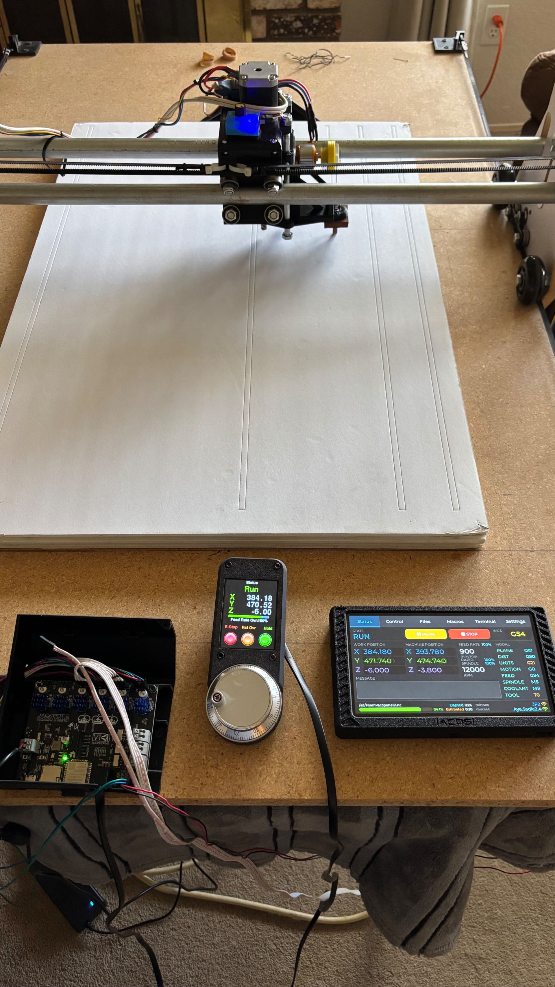

I renovated my needle cutter and added a vacuum table to it. It works really well. :airplane::+1:t2:

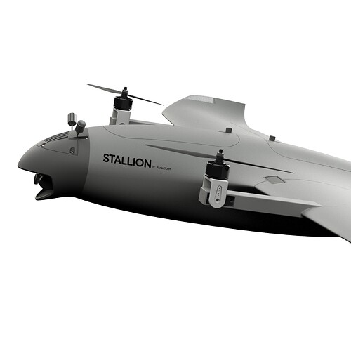

That looks a lot like one of the VTOL aircraft I’ve been admiring.
David, yes, similar but yours is a bit bigger. Have you ever flown a 3d printed plane? I don’t think I will because they are so brittle and I crash too much :wink: Getting the transitions to go smoothly (especially at the end of flight) has been tricky for me. I use Arduplane, which has so many parameters and you must get them right or it falls out of the sky.
