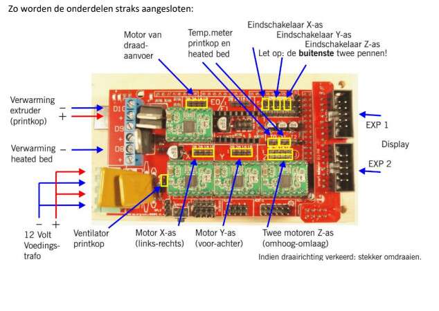

It is our picture off building 3D printers and unfortunately this is in Dutch but google translate will help. For micro stepping, do not forget to put jumpers on the pins beneath the stepperdrivers.

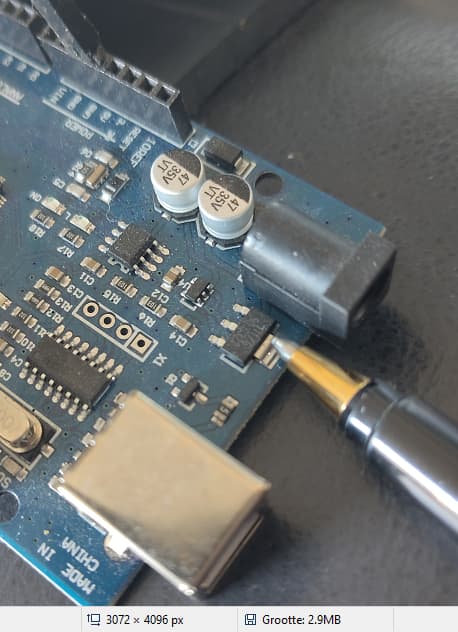

Another thing I might add is no matter how i flip the wires(and I have tried 30 different ways) they always run opposite in series. I am thinking i have a faulty board because with my 12v power supply hooked up the screen is washed out, but using usb in the 2560 its perfect.
probably your voltage regulator is blown up. It is the small black part with 3 solderpads on one side and a big one on the other. look for ams1117 5.0
