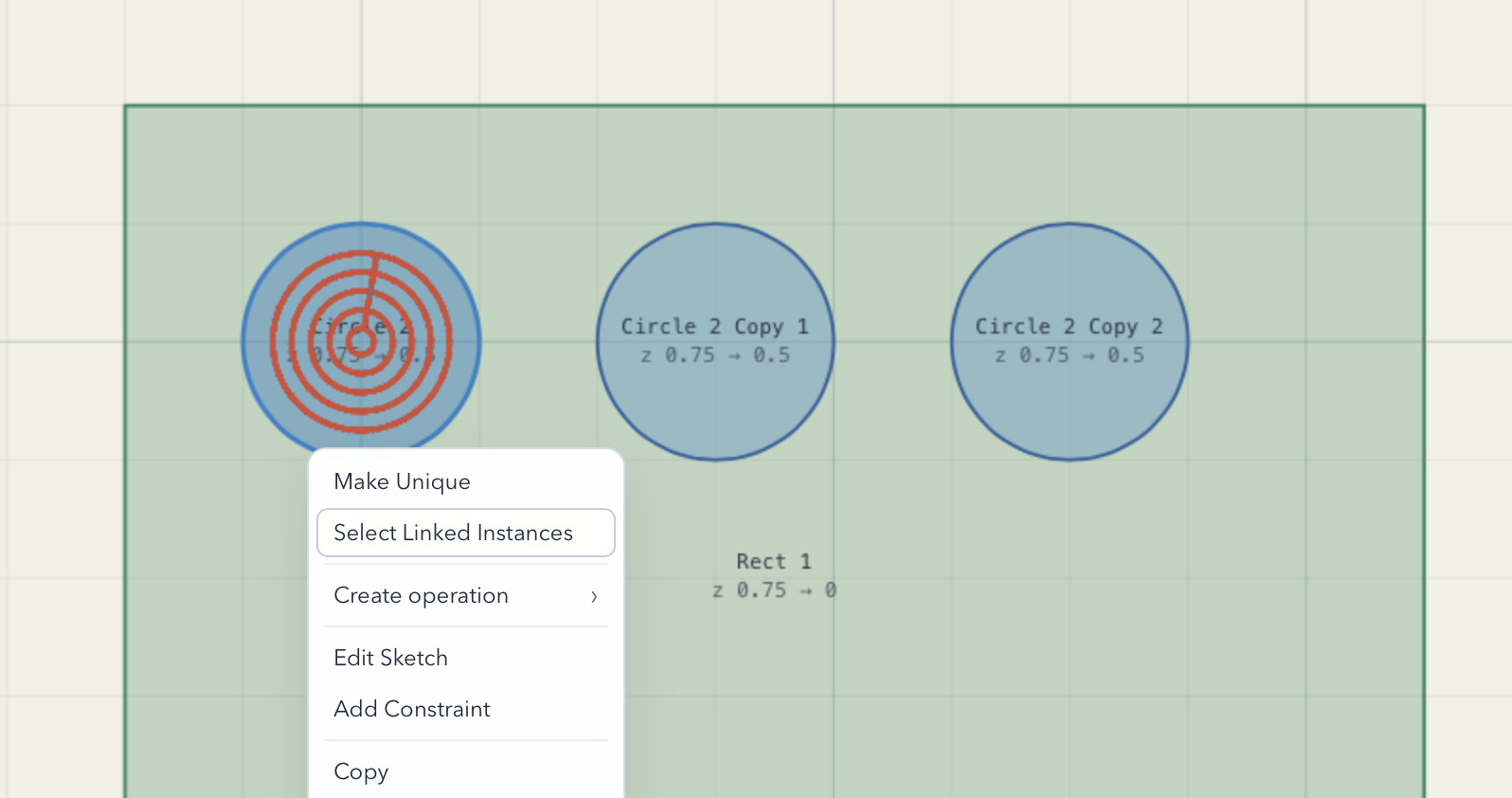

I also have another question. If I need to make multiple parts, I usually setup the cut for one to make sure that everything is working. What should be my workflow when I need to cut 5 or 10? I can copy the part itself but then I need to update all the cutting operations to include new shapes.
Thanks for the suggestions. I actually have an issue sitting in the backlog to address countersink and chamfer. I am pulling countersink into current iteration. I want to leave chamfer out of it for now since I would like to make that a new operation that can be applied to the pockets and edge cuts too, not just holes.
Regarding the multiple parts question - I was thinking about adding some kind of nesting (it is in the backlog somewhere). for now as you said - you need to copy thee initial part and add shapes into the operations. one thing that can help you - since the copies of a shape are just instances, you can select them all from the context menu, and then “use current selection” on the operation to include them. I am thinking to add an option on the copy command to automatically add copied instance into the same operations the original was added. that would make this much simpler.
