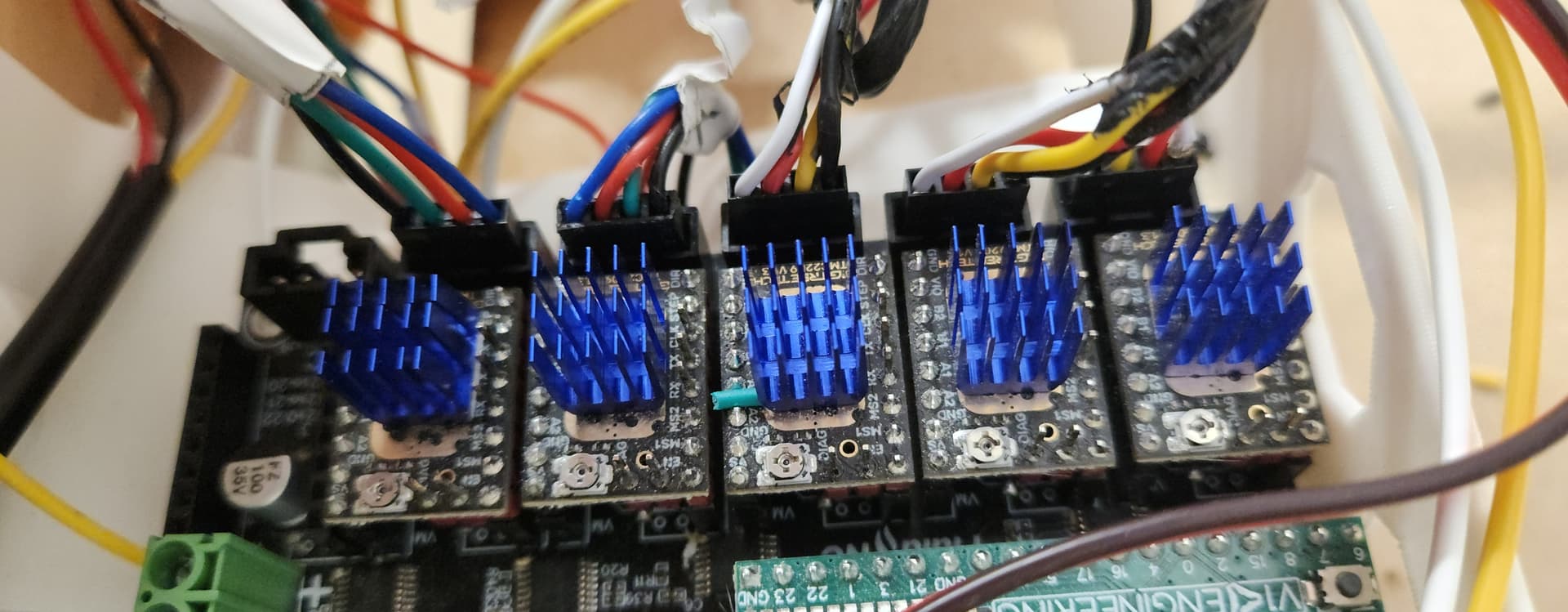

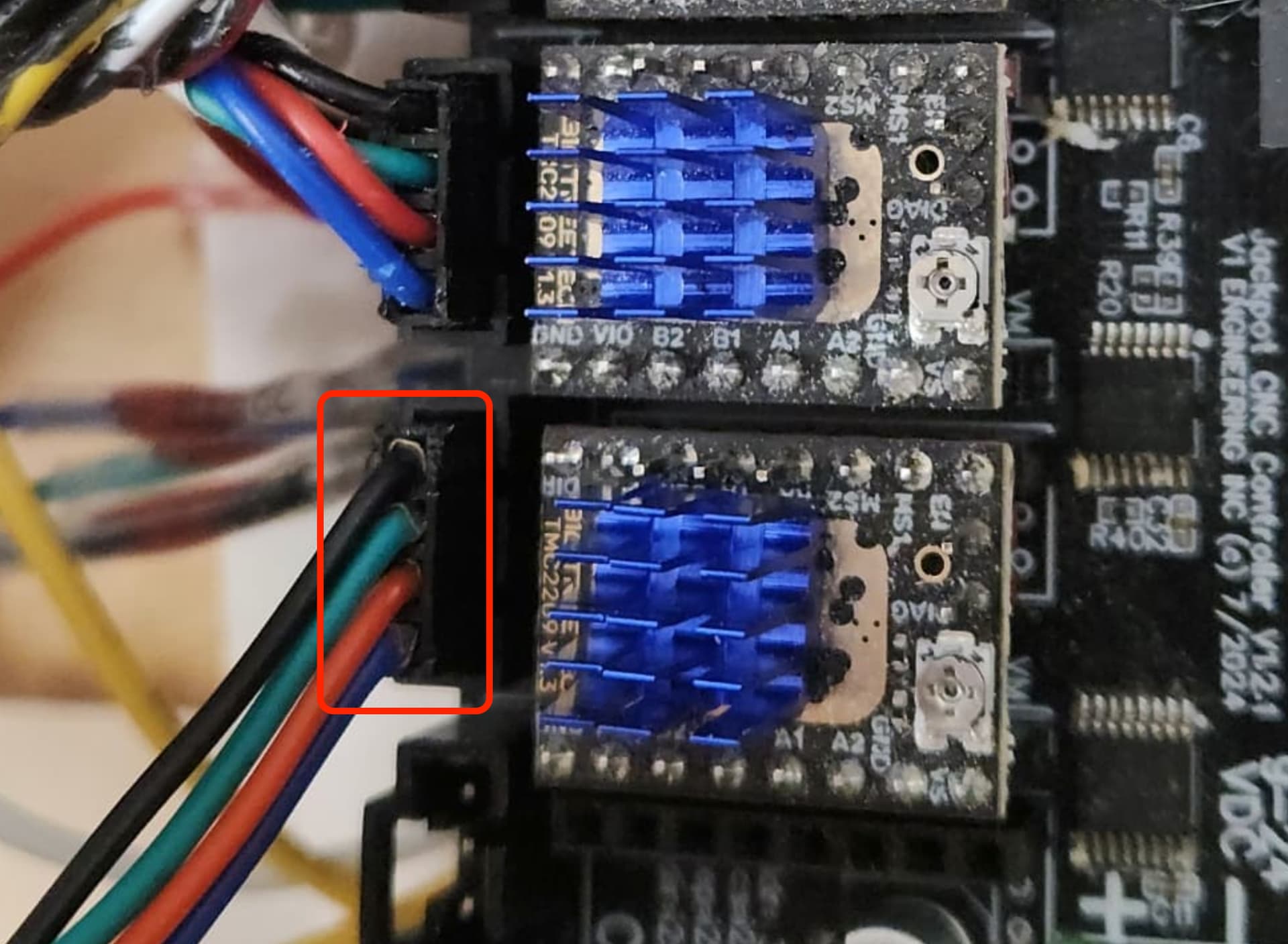

This connector does not look like it has contacts properly seated.
So i recrimped that one as well and still same result.
Just before you try to move the z axis, does $limits show both of the z limit switches closed?
You re-crimped that one (Looiks much better from the top), but they were sill moving opposite?
Then after that, you flipped just the last connector 180, and it’s still going opposite?
correct
it does indeed
That loose wire shielding is bugging me lol
Just to confirm, is it zmin or zmax that you believe going in the opposite direction?
I believe that you have your connectors wired as A- A+ B+ B-. Swap any two on one side, such as the red and blue pair or the white and red pair.
Zmin, it happened right after i recrimped that plug, with the exact same wiring
I just tried that as well with no success after that didn’t work with zmin i also tried with zmax again didnt work then i tried adjusting the config file adding

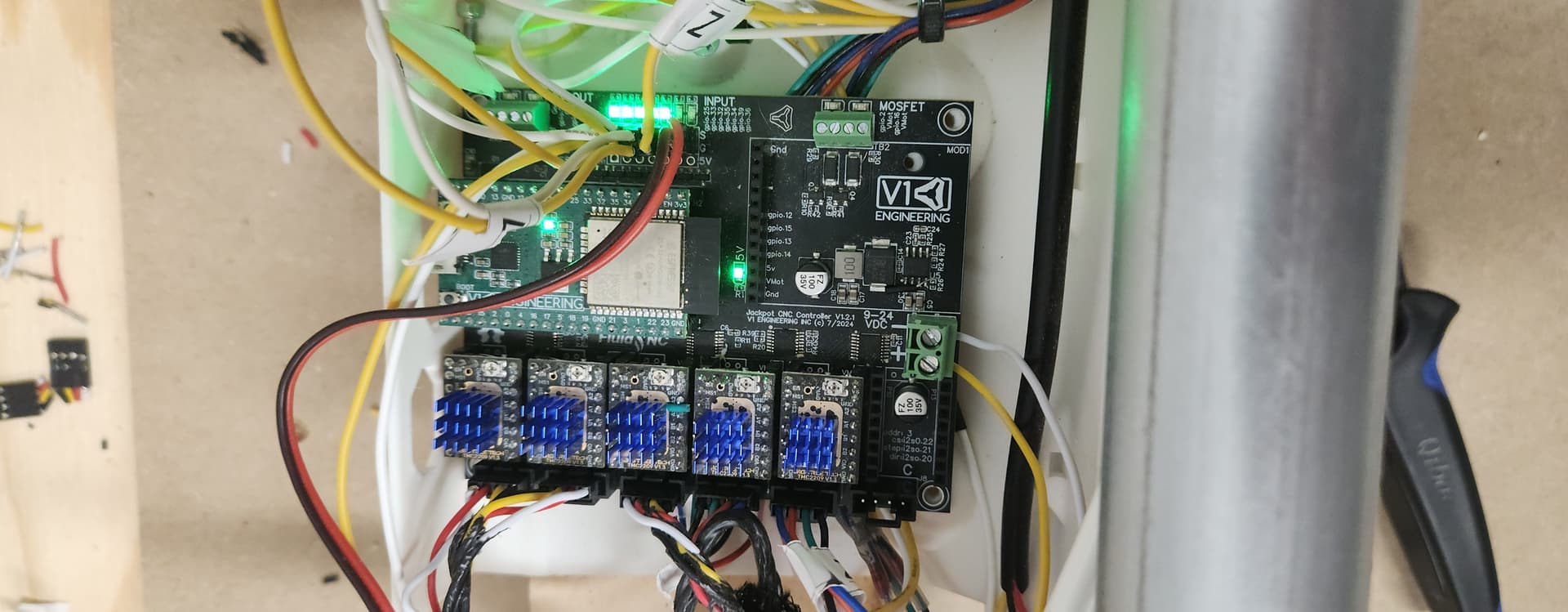

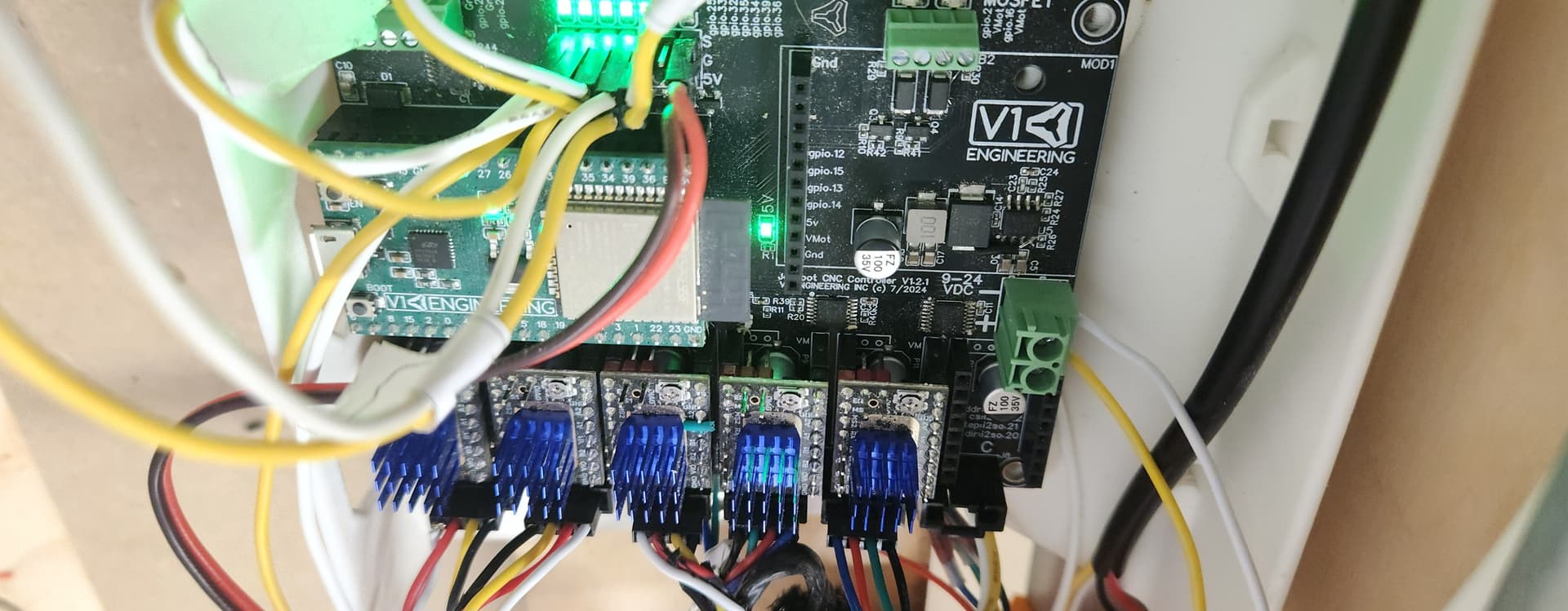

It had to have done something. If it didn’t these aren’t the cables for the Z steppers.
Do you happen to have a spare stepper motor that you can connect directly to the board for testing?
The logic for swapping the connector by 180 is that each pair gets reversed (which swaps the direction twice) and then the pairs get flipped (which also swaps the direction).
This is so weird… Not sure how this is possible.
Three different ways that have no explanation for why they aren’t reversing the motors.
  1. Swapping one plug by 180
  2. Swapping one coil wire by 180
  3. Inverting the direction in the stepper motor config.
You seem very competent. Which is why it is extra confusing. My brain keeps thinking things like, “this guy doesn’t know what direction his steppers are moving”. But you’re obviously more competent than that. I don’t know how to explain it. There is a wrong assumption somewhere.
Are the stepper motors moving smoothly and is the gantry lifting smoothly?
When you do one of those things to swap the direction, does the direction if motor motors change, or neither?
I like this idea. When I get in a jam like this , I often bust out a spare so I can start bisecting the problem space.
Exactly.
yeah the steppers are still moving smoothly. There just isn’t any change in the direction the steppers move. I do have a spare motor so ill test things with that next. also i realized after a $SS comand that the line i added to change the direction in the config file was apparently ignored, not sure why. I will add that config file below:
