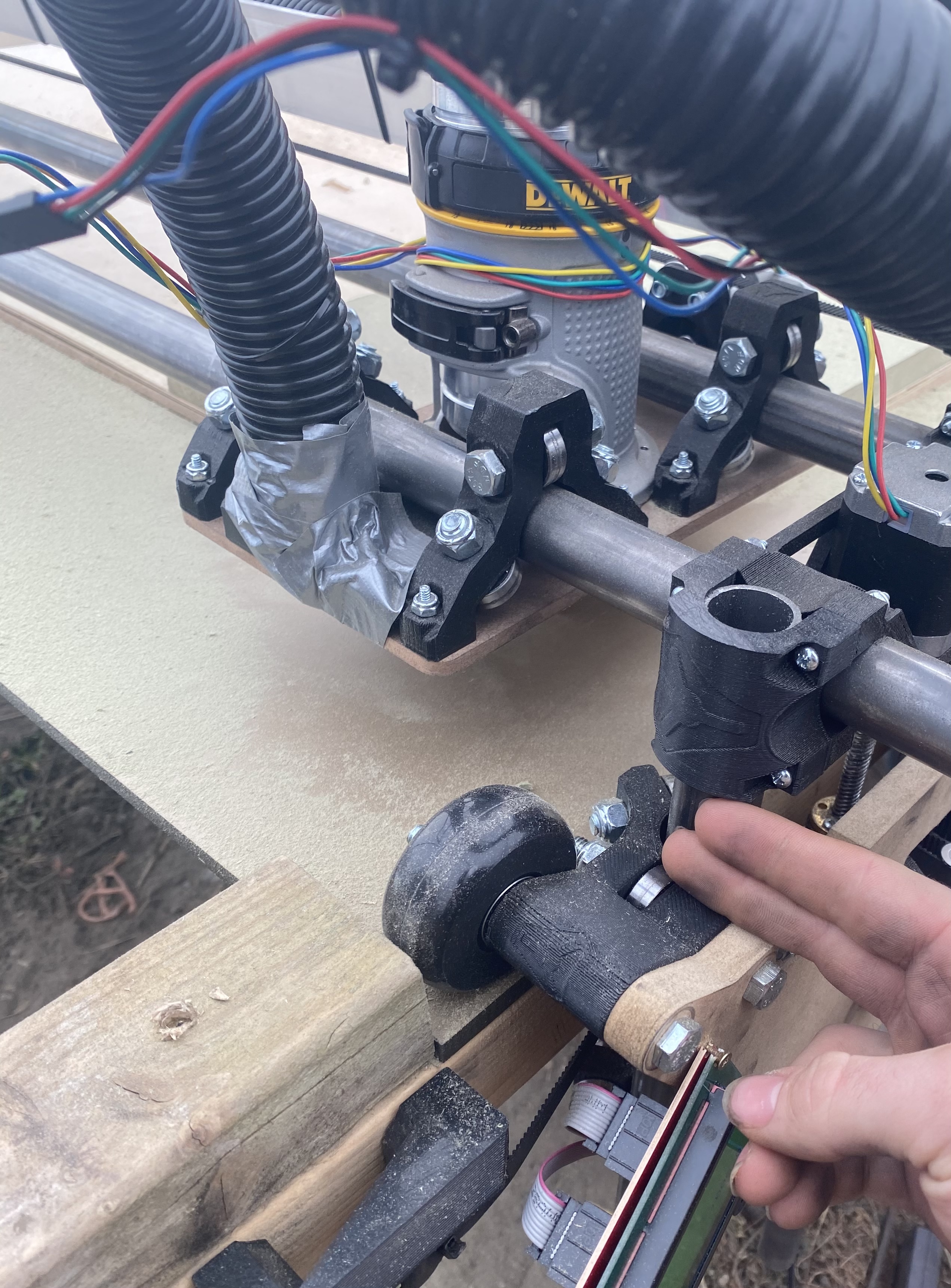

This is proof it cuts on my g code however it also shows inconsistent depths as the z axis fails under its own weight as it only dose it the end the spindle is as it’s too heavy for the motor.
Please just use the crown, after you set the drivers to under 0.7V.
That picture is not proof of anything except it is not doing what you want it to do.
Yes because the motor failed that’s why one is cut through the one beside it is shallow and the other is deeper
Charlie, please just try it. If you can’t try it I really can not help you. It is the weekend I am not working so please either try it or just get back to me when you do.
The test crown (the premade gcode, not you doing cam on it yourself) is a proven conservative test for us. It takes just a few minutes and if it fails on the TC, then we know nothing we do in the gcode, or estlcam settings is going to fix anything. It really is a quick sanity check to split the problem space down by about a third.
How do you have the Z wired? Is it in serial or dual? Parallel will cause this, easily.
The other very common issue is the max Z speeds. Did you use firmware from MarlinBuilder releases?
After that, we can look at the mechanical stuff, or how you are sending it, or the grub screws on the couplers or take another look at the wiring.
I know it is hard to be told to do something you don’t think will help, but we wouldn’t suggest it if it wasn’t in your best interest. We are on the same team here.
:+1:
To the OP: Keep working through the issues. The end result is well worth the effort.
I’ve ran the crown it cut the correct shape however the machine still dropped and worked it’s way out of square over the program at his lead to it cutting through the crown drivers where adjusted and everything worked fine I think I have a faulty stepper on my z axis as I connected them following the instructions and had the correct v1 looms for the kit it only drops when th z axis engages to move up or down and only on 1 side could you confirm if the stepper may be the issue
Thank you for testing that. It looks like it is a bit small. Are you using a larger bit than 1/8"? Did you use the premade gcode or do the CAM yourself?
I think I have seen one stepper be bad on these forums and I have posted 15k posts. Steppers are super simple and most of the time people think it is a bad stepper, it is either the wires, or the motor shaft is skipping in the coupler.
Can you share some pics of the electronics?
Does the Z fall on its own when you turn it off?
I used the pre made gcode and all I had to hand was an 1/8 inch the machine will drop when the powers off it just seemed to drop whenever the motor either in gaged or disingages I can’t picture the board atm as it’s at my workshop my setup had all the v1 parts as I bought a kit the motors all spin correctly and worked fine when I did a test run before mounting it to the table and it only dose it when it’s under its Owen weight and has dropped and gone staraight through the work pice spoil board and table previously
I’ve also checked the motor to screw connection and all grub screws are tight so it’s not slipping in that sense
