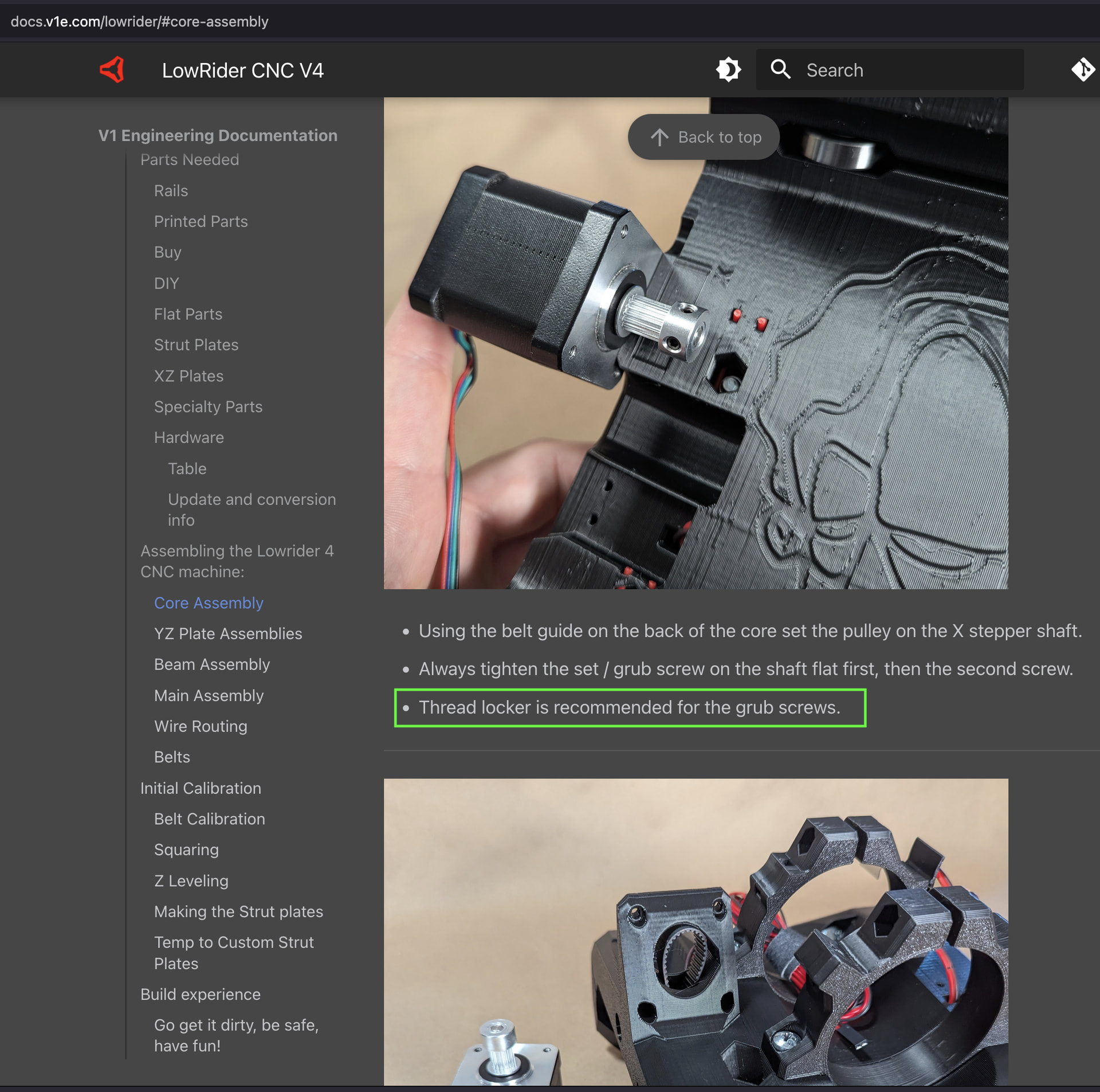

At this point Im wondering if the grub screws of the Z axes have become loose or something

Your z coupler grub screws should have loctite (blue)

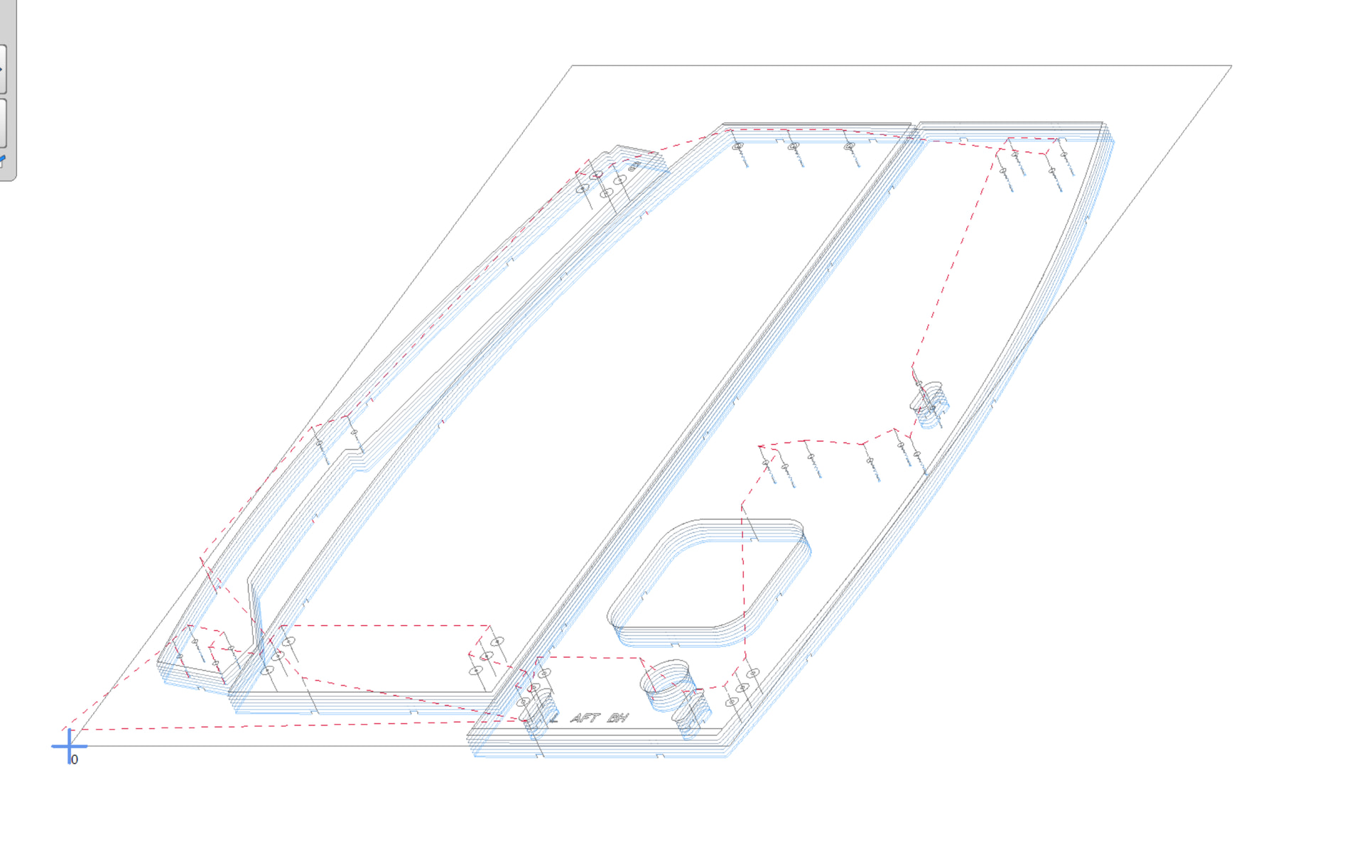

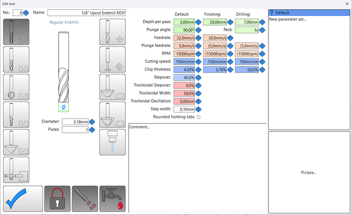

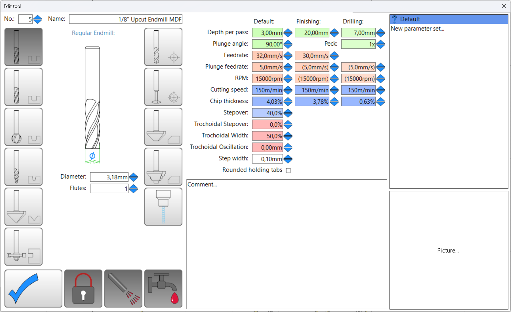

Ok so here are my tool settings and also the gcode I produced
LC1.gcode (136.3 KB)
With regards to the grub screws I dont have yet the blue loctite on them. I bought it because I had some issues in the past with some other screws of the machine becoming loose. I actually suggested that maybe would be good to put the suggestion to use blue loctite on screws in the instructions of assembly. It doesnt cost a lot and doesnt interfere with anything and avoids possible problems in the long run
As sson as I can I will check the state of the screws, tighten them and apply loctite to discard that problem (havent had time as I arrive quite late home)
It is. Maybe the documentation can be more clear, but the notes are definitely there. (Green highlight box is added just now by me)
Ah my bad! Now its there, thats great. :blush:
