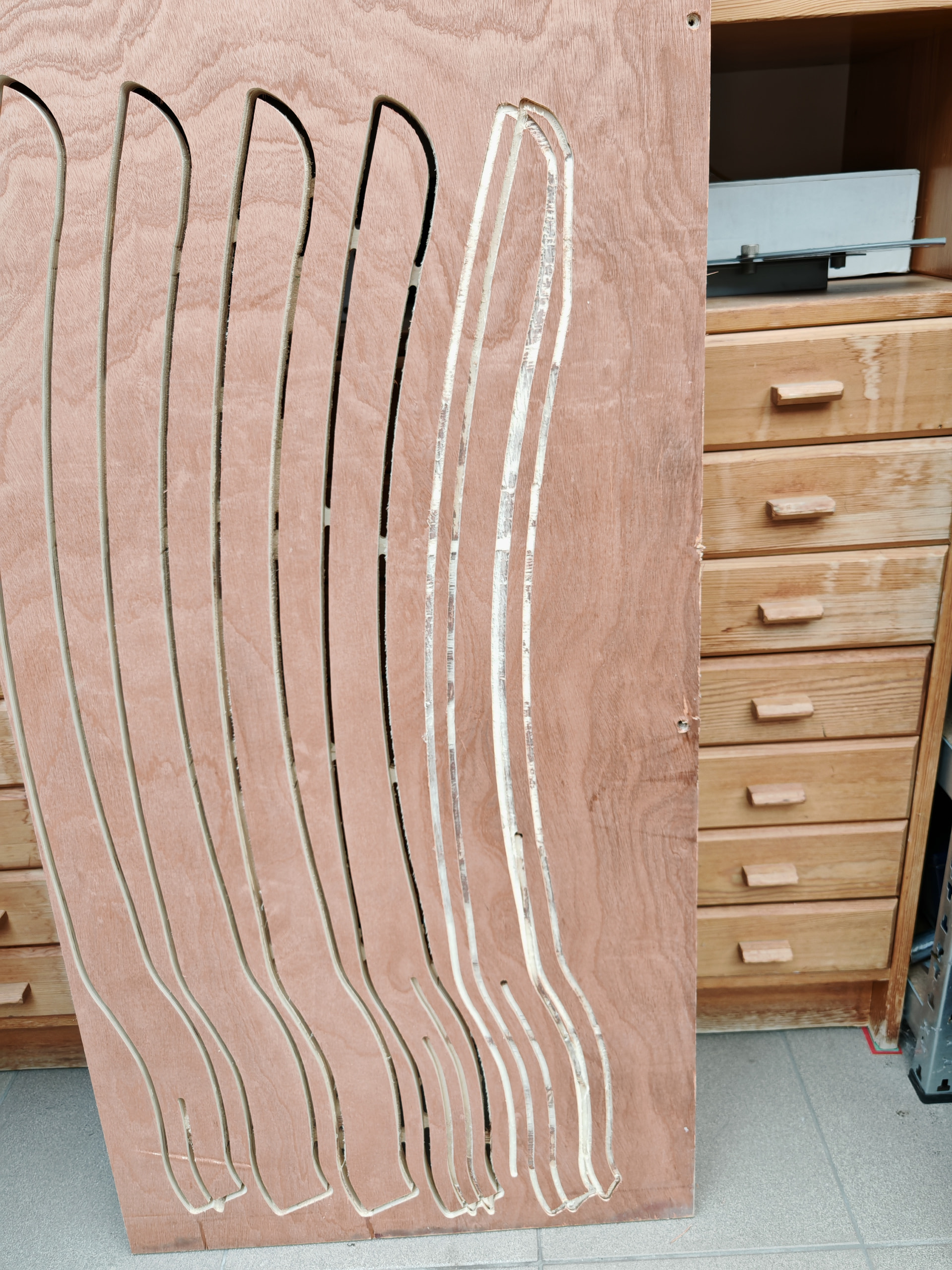

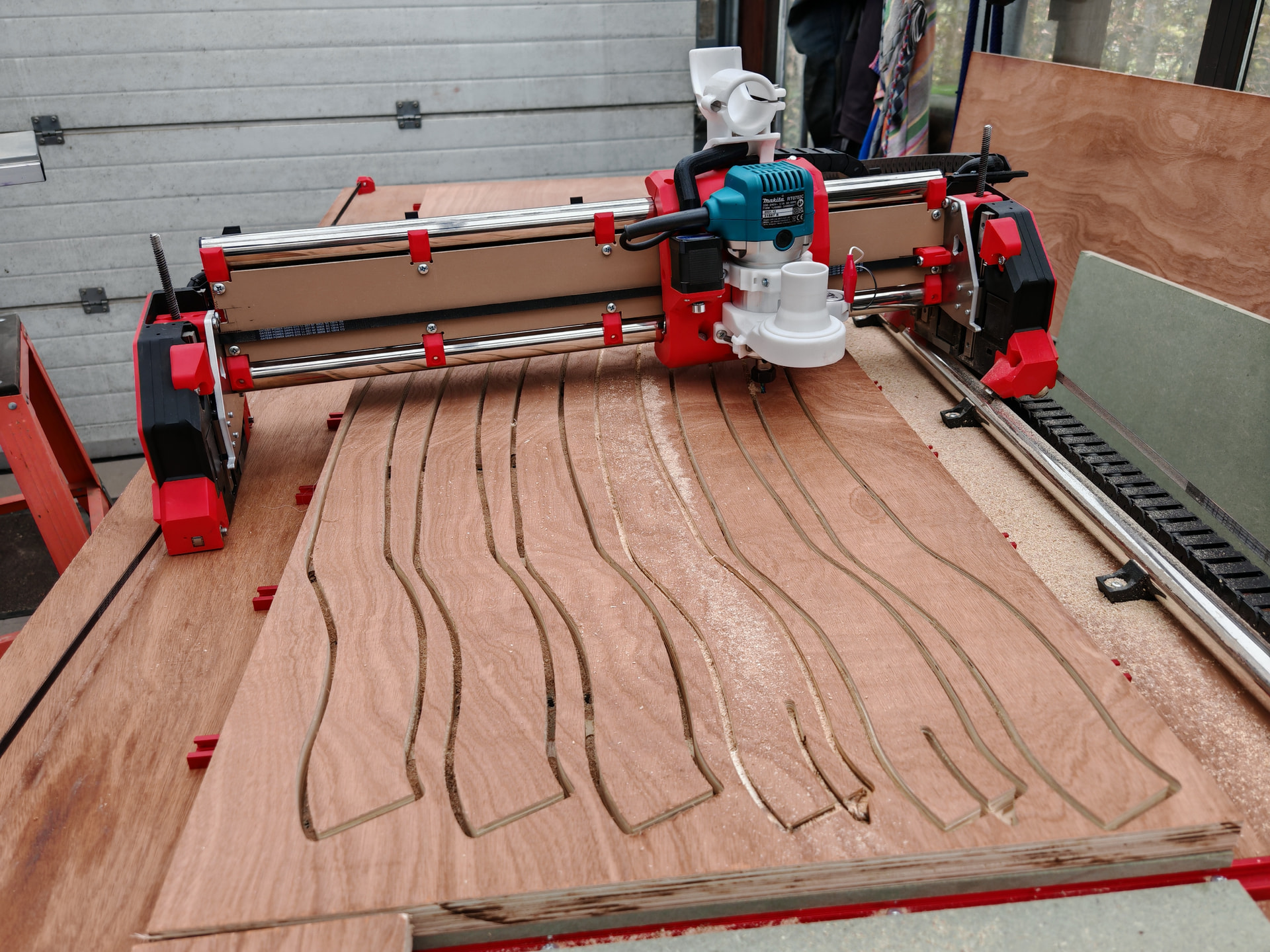

Hello,
I am just a beginner but have already been able to achieve great results with my Lowrider 4. However, I am now completely down due to recurring problems with routing 22 mm hardwood plywood. I have already tried everything:
- running the Makita at a faster or slower speed.
  • step depth: 2 mm and 4 mm
  • adjusted the feed rate several times.
  • applied ramping.
I use a 6 mm diameter CARBIDE DLC downcut cutter and manually ensure that no sawdust remains in the groove.
Can anyone help me? See attached photos. Many thanks in advance.

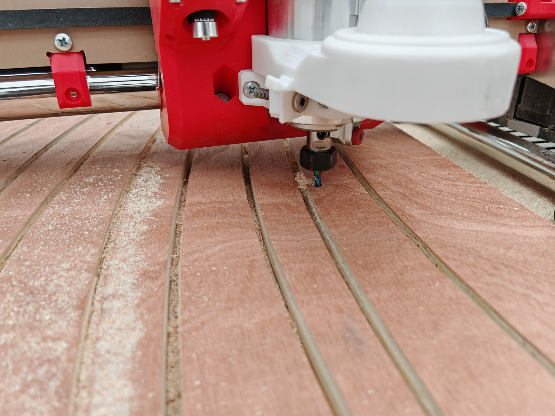

Get a new, sharp upcut. Always my first tip.
I really don’t understand everyone’s obsession with downcut endmills. :sweat_smile:
Thank you for your answer. The downcut cutter was new and never used. Would all problems be resolved by working with an upcut cutter?
Not sure, but I hope so. :grinning_face_with_smiling_eyes:

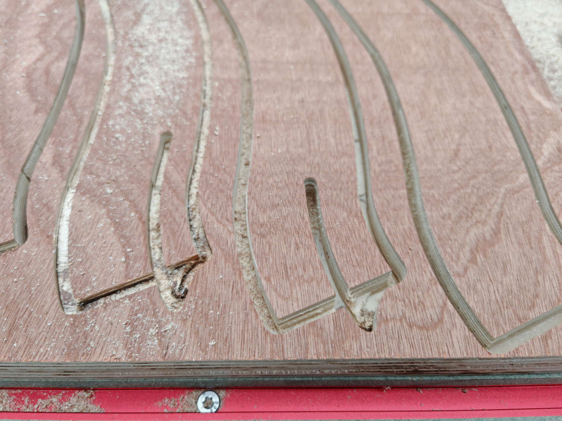

So the stepover is concerning to me! Did you observe your machine miss steps? Or this a new build that maybe your grub screws came loose one?
Also the down cut bits have their use but they cause heat from the dust being pushed down, up brings it out and clears your cut. If you have breakout on your ply wood try masking tape on your cuts.
The settings that worked for me using a 1/8 inch single flute upcut bit from the V1 store are:
4.75 mm DOC
25 mm/sec
Conventional cut direction
Hopefully this helps.
One belt is loser than the other is this maybe the reason for outbreak?
That will certainly have an effect.

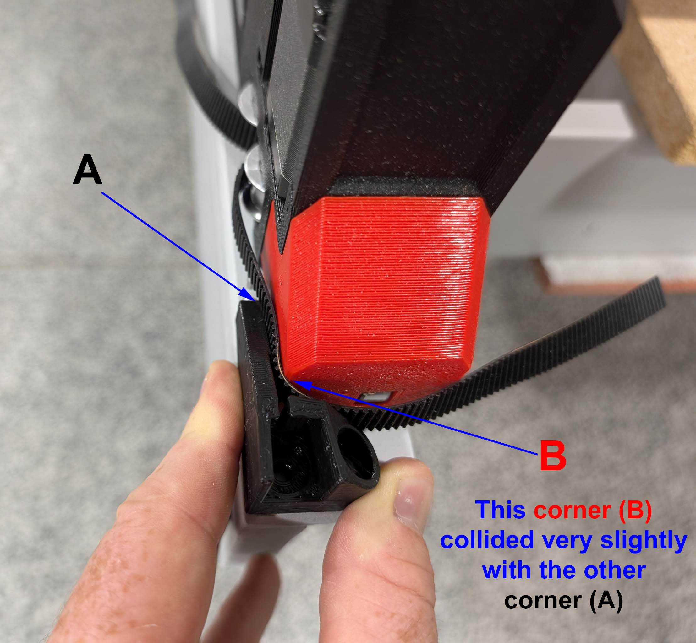

Problem found :
I was constantly working at the extreme end of the machine, and just before the end stop, the gantry snagged against the timing belt holder, with all the resulting consequences. So, the solution was to loosen the timing belt holder and reposition it better.
The snagging in the middle of the element being milled was most likely due to a timing belt that was too loose on one side, and my request to mill the final pass in the opposite direction.

I’m trying to picture that issue in my head so I can look out for it when helping others in the future.
Do you have a picture to show it?
Do you mean that the Y axis belt idler pulleys were binding up somehow? (The X axis timing belt and idlers are behind the core and inset, I’m not visualizing how that could bind)
Hallo Jim
hereby the picture you ask for, I hope this explains it all.
Also a big thank you for all the comments and for the good advice
greetings
Thank you. A picture is worth a thousand words.
I’m going to tag @vicious1 to this topic as we’ve had some recent discussions about how the LR4 could be made even better. This arrangement of parts was a part of that discussion.
