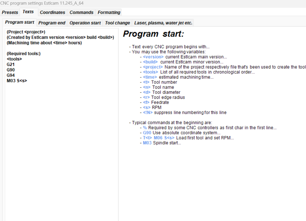

First of all I configured the CNC program settings/post processor in ESTLCam, with the little gcode pieces that the tutorial states for LR4/GBRL. I understand this code pieces are bits of code that are inserted at the start of the work/after a tool change or at the end on every gcode we create
Specifically my program start is as the tutorial states:
G21
G90
G94
G10 L20 P0 X0 Y0 Z0 (set current location to zero, survives reboot)
G0 X10 Y10 F2000 (move to probing location)
M0 (MSG Attach probe)
G38.2 Z-110 F200 P0.5 (probe down set thickness )
G1 Z10 F900
M0 (MSG Remove probe)
M62 P1 (If used start spindle pin27 )

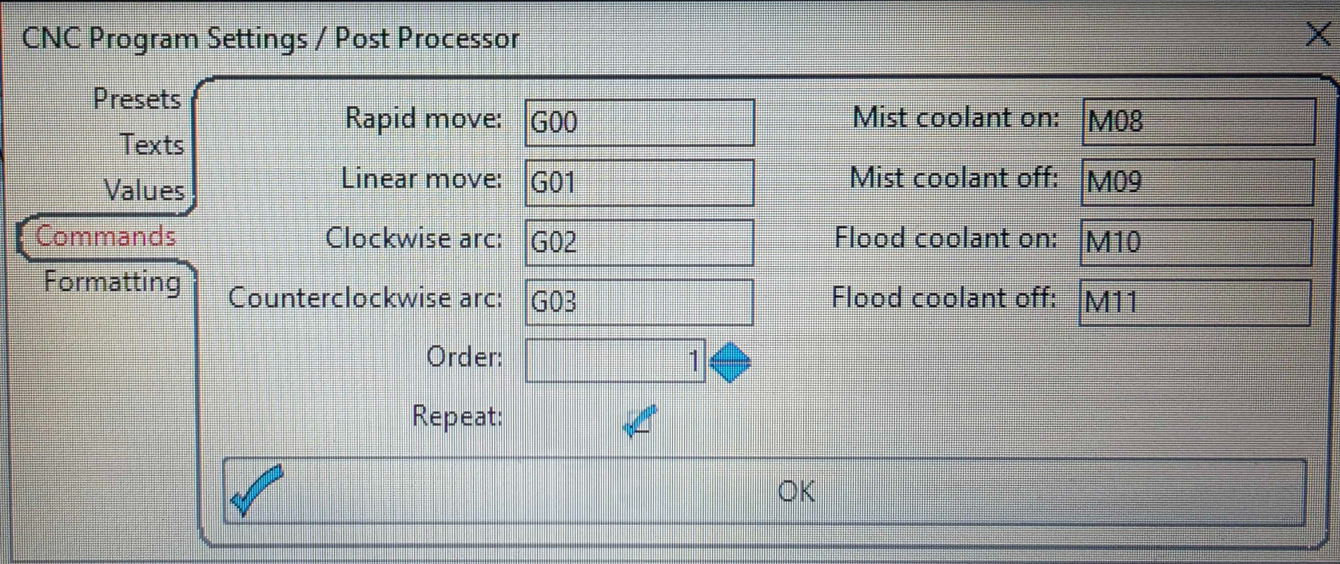

Do you happen to know as well why estlcam kerps inserting the codes m08 and m10 in my gcode
I dont know where is getting those from

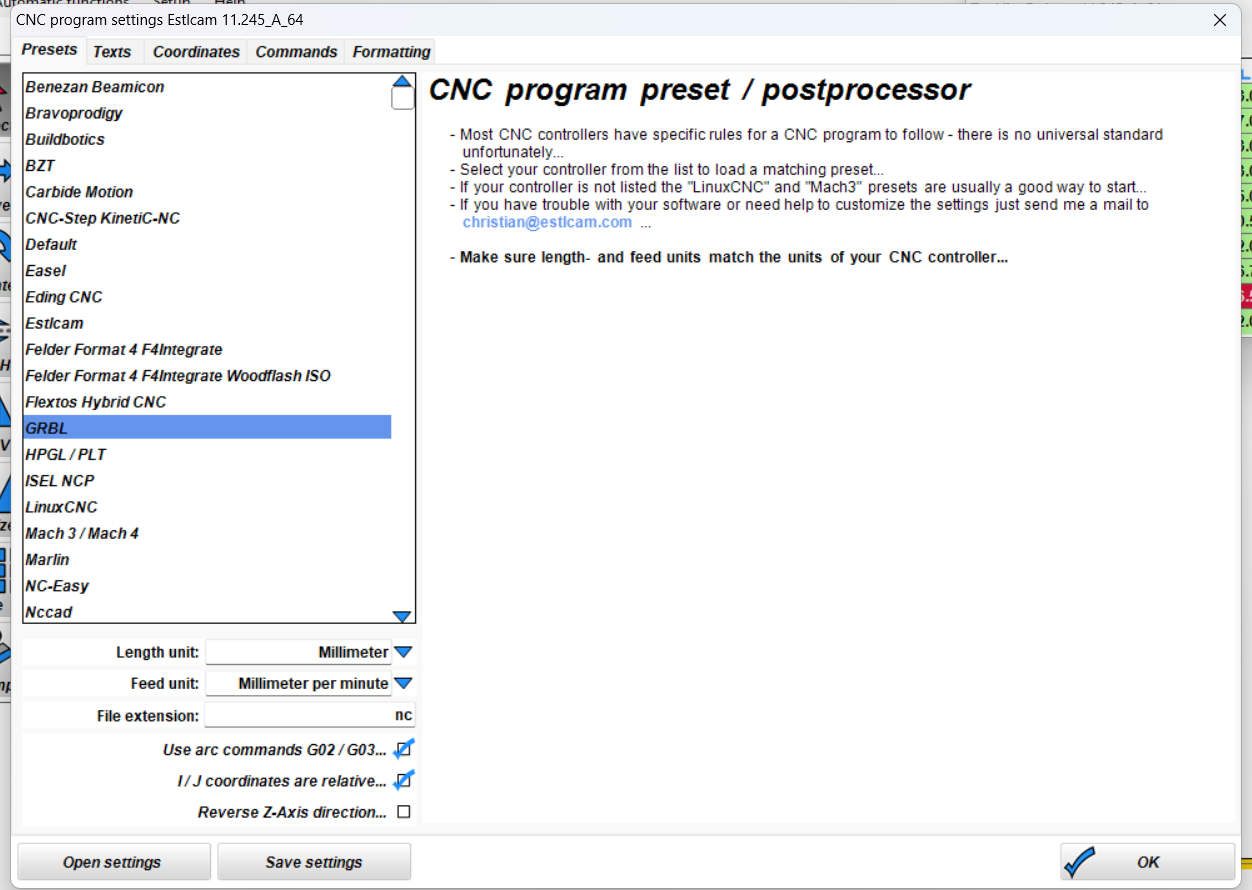

are you using 11 or v12 or v13?
I use 11. if you go into setup → controller commands
you can see the post processor and look at all the functions it puts in. If you are using a jackpot, you will want to look at the grbl. make sure that one is highlighted anyway or you’ll generate code for the wrong machine.
in the texts option, you will want to look at start, end and tool change commands to see if that is where you are getting the mystery commands.
when done, you can save the settings as a file and then select that file for your post processor with “open settings” if you change it. I have 2 different cncs and have to use 2 different post processors. one is stock and is selected in the list, the other is custom and I have to open it. Once you select, it will stay with that one until you select another. if you only have one setup, you should only need to do this once.

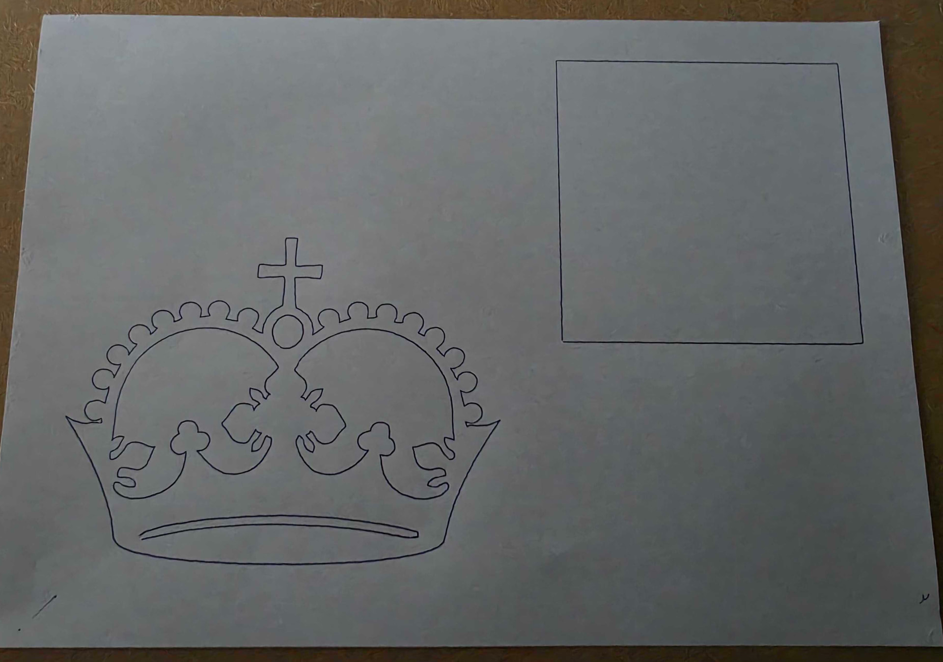

Guys loads of thanks. Finally managed to get my crown drawn!!!
The misterious codes were added it seems from this dialog in the cnc program settings as you said
These codes were not recognized by the jackpot and an error was issued and the program stopped. I just cleared those coolant fields and now theyre not output to the gcode file

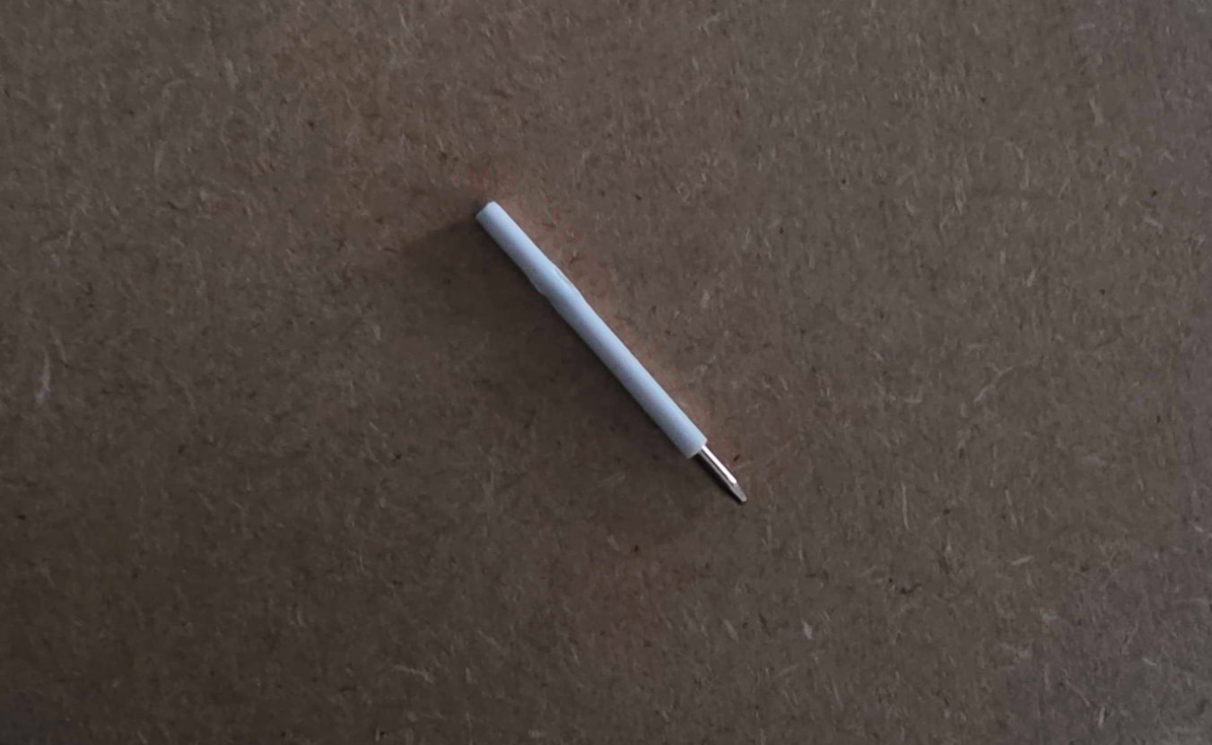

As a curiosity at the end instead of a pen attachment I got the ballpoint pen refill of one of my old pens, cut it and use it straight into the 1/8” collet adapter of the Makita and fit perfectly. In case is useful for anybody

In FluidNC, Mist On is M7, Off is M7.1, Flood On is M8, Off is M8.1. If you use M9, it turns off both.
There is no M10 or M11 in FluidNC.
