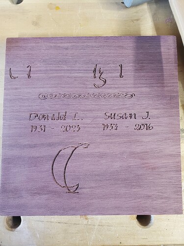

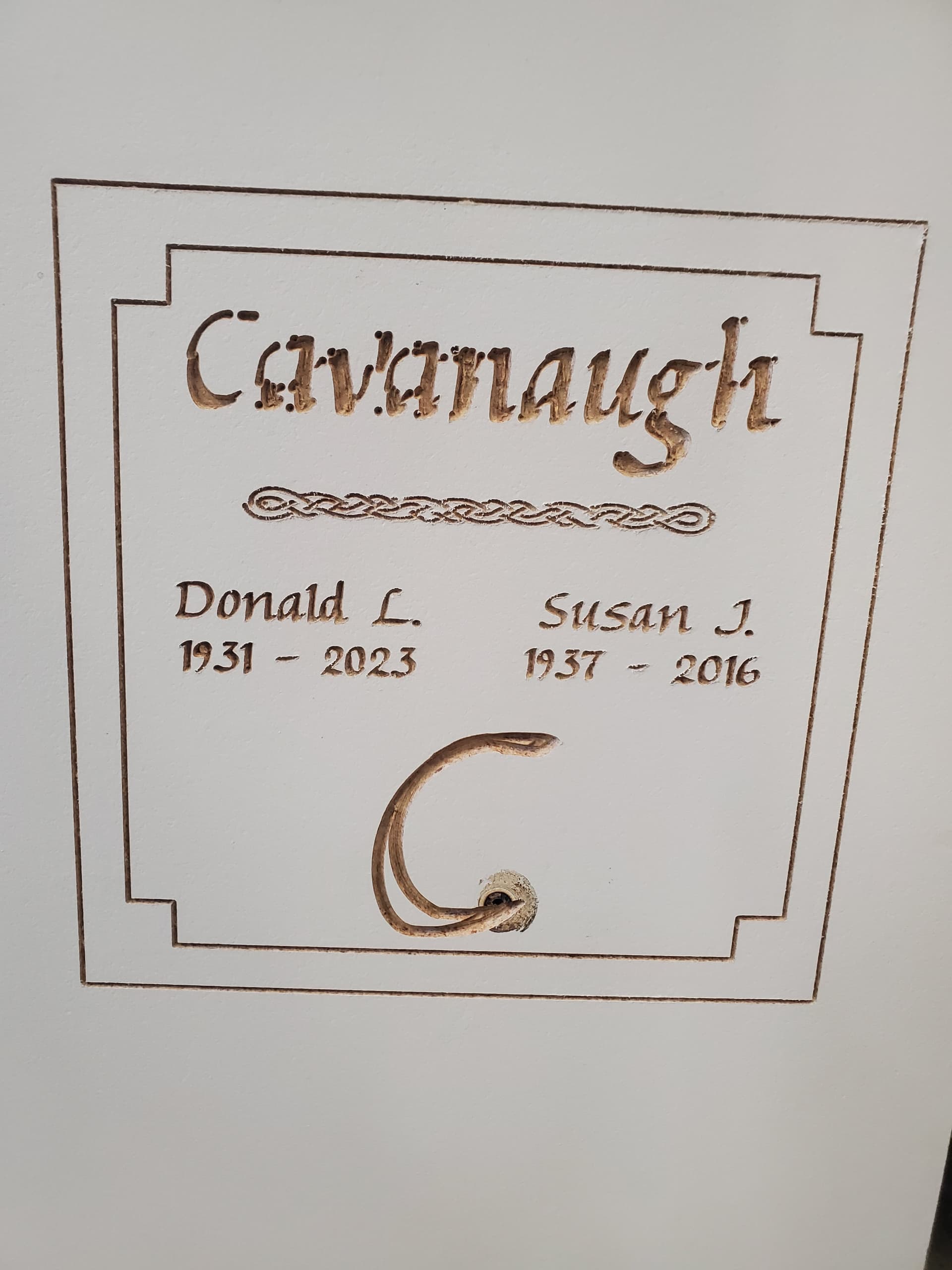

But as I was typing this out, I noticed my small sign engraving I was doing just uncalibrated for no reason. I’m using the 45 degree V bit .125" from V1E, but the tool is poking holes in the material in odd spots, then taking my 5 lines and getting the alignment all jacked up. The only code I changed from the test to final was depth and width of cuts. I didn’t adjust alignment to the design. Here’s the pictures of the test on white and final on purple heart.
I am concerned as to why the router makes heavy pokes that don’t jive with the design.
My X belt is nice and tight.
My Y could use maybe a touch of tensioning. A little slack and such could be explained, but it’s almost 20mm off on the final.
This is all a CAM issue at this point.
V bit are heavy cuts, the middle gets dragged while only the edges do much cutting all at different surface speeds.
Working in one material and not in another sounds like you went to aggressive.
Not sure about the Z axis pokes.
For a Vbit that is everything but feedrate. Depth is obvious but width can leave lines instead of clearing a section if it gets a flat bottom. This could explain your depth of cut/z poke.
I suggest looking at your gcode with a gcode visualizer. https://ncviewer.com/

Those stabs being taken at the material look to me like the contours were not properly closed or that there were tiny fragments of a drawing that are being done as well. Had that happen to me before.
