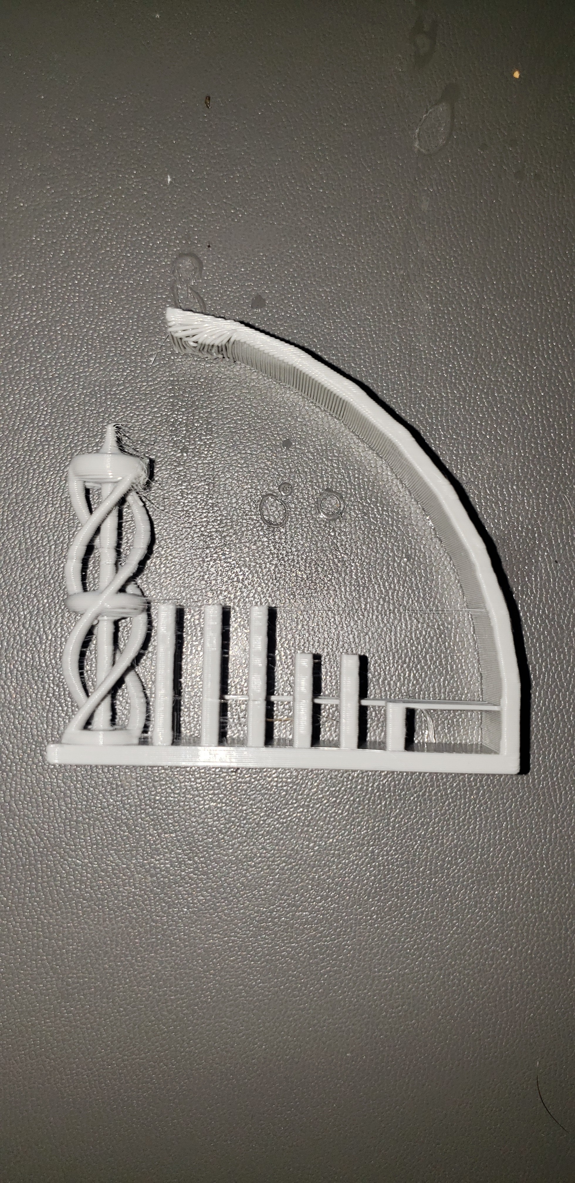

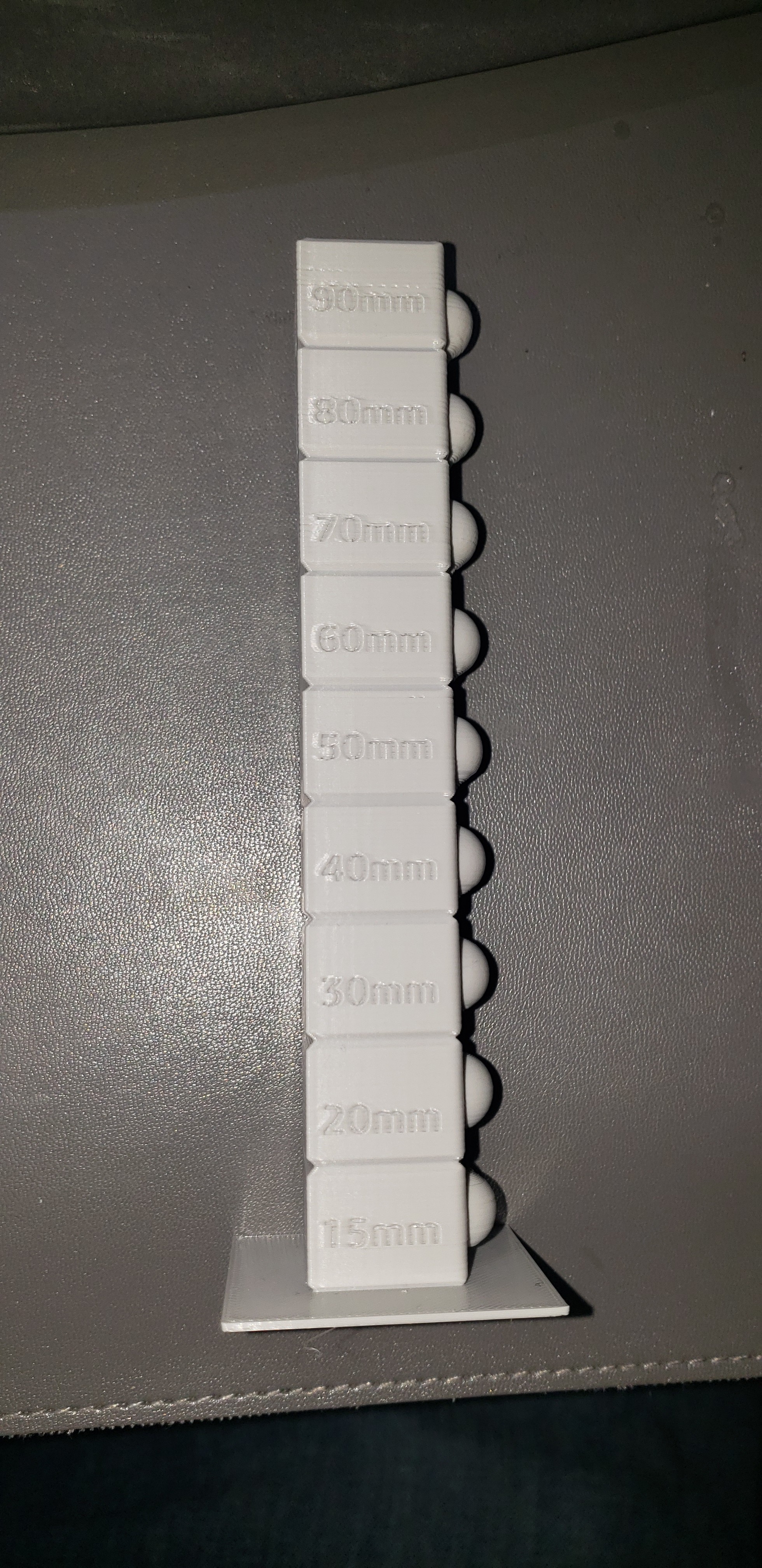

Using 0.2mm layers I then ran the following tests:

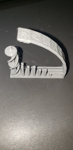

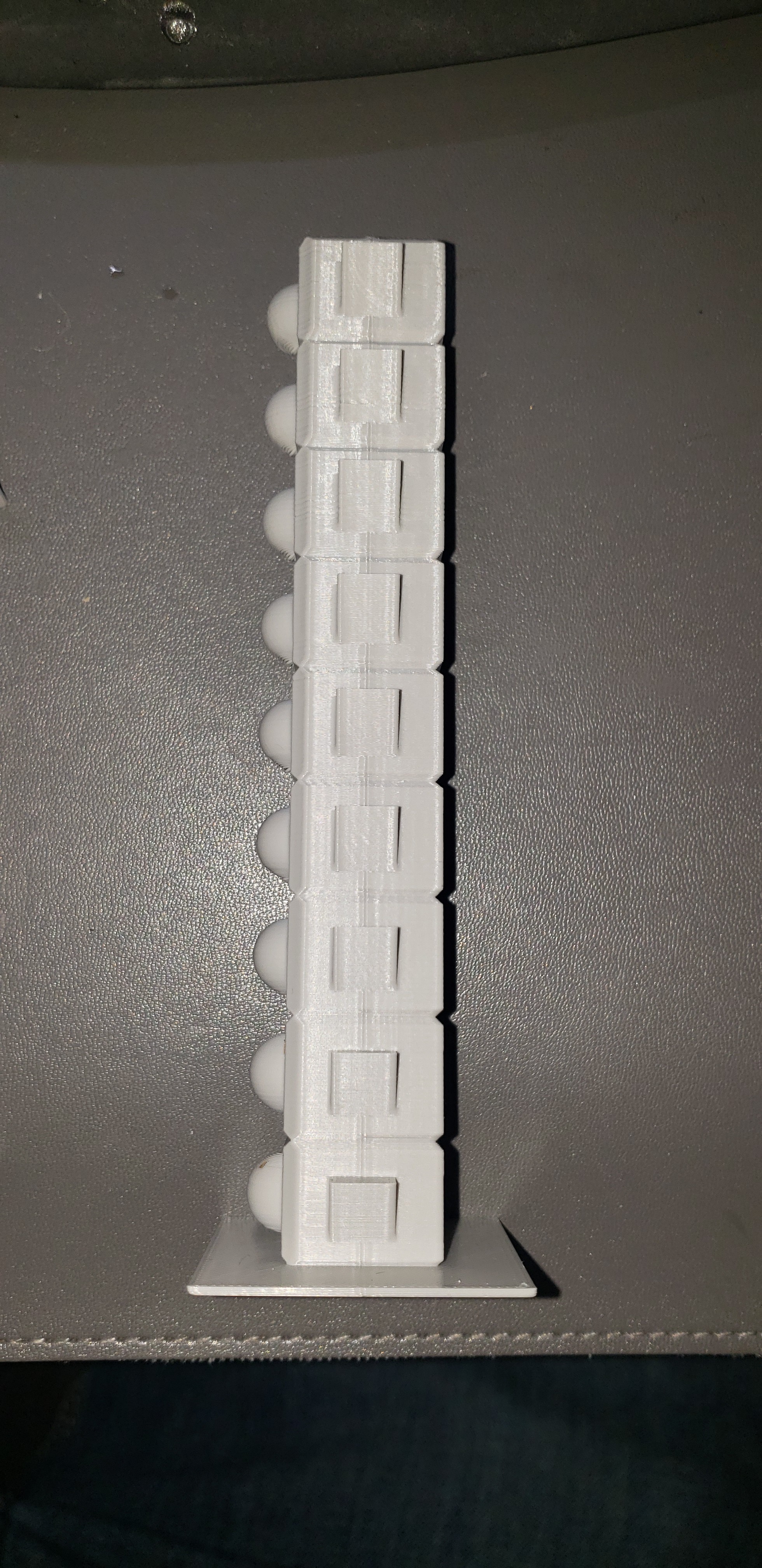

speed test:
I thought 15-40mm/s looked pretty good. The default for external perimeters is 30mm/s, so I just left it as is.

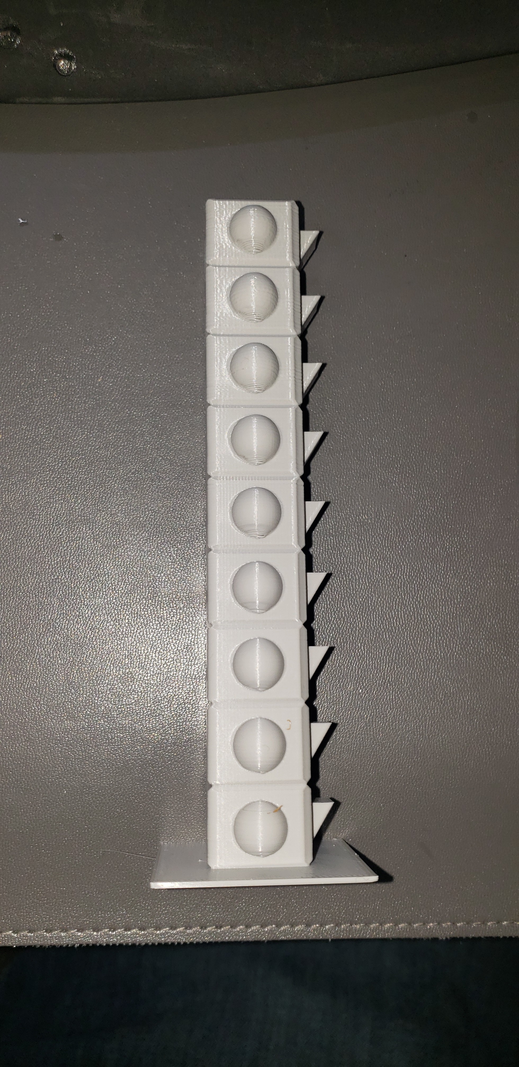

Retraction test:

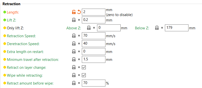

The only thing I adjusted here is my retraction length. I can maybe dial it in even better, but would definitely need some advice as there are so many retraction settings. I would prefer to be able to reduce my retraction length as this seems to have a big impact on external perimeter layer issues such as gaps.
From top to bottom here I have 0mm, 1mm, 2mm, and 2.5mm. The mini’s default is actual 3.5mm, but I was seeing the surface defects mentioned above. I settled on 2mm. It still has some slight stringing, but at 2.5mm you can definitely see some layer defects on the posts.

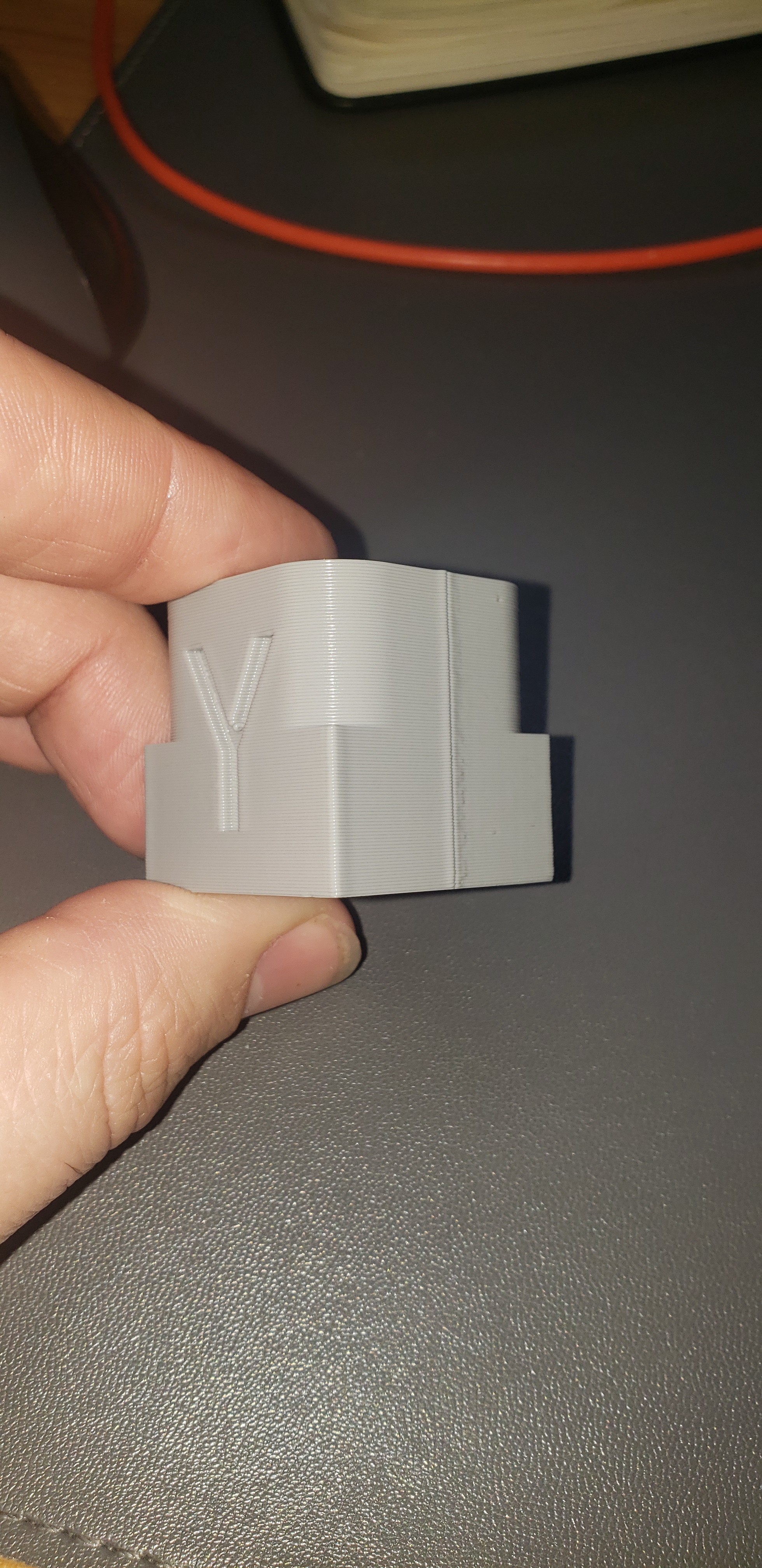

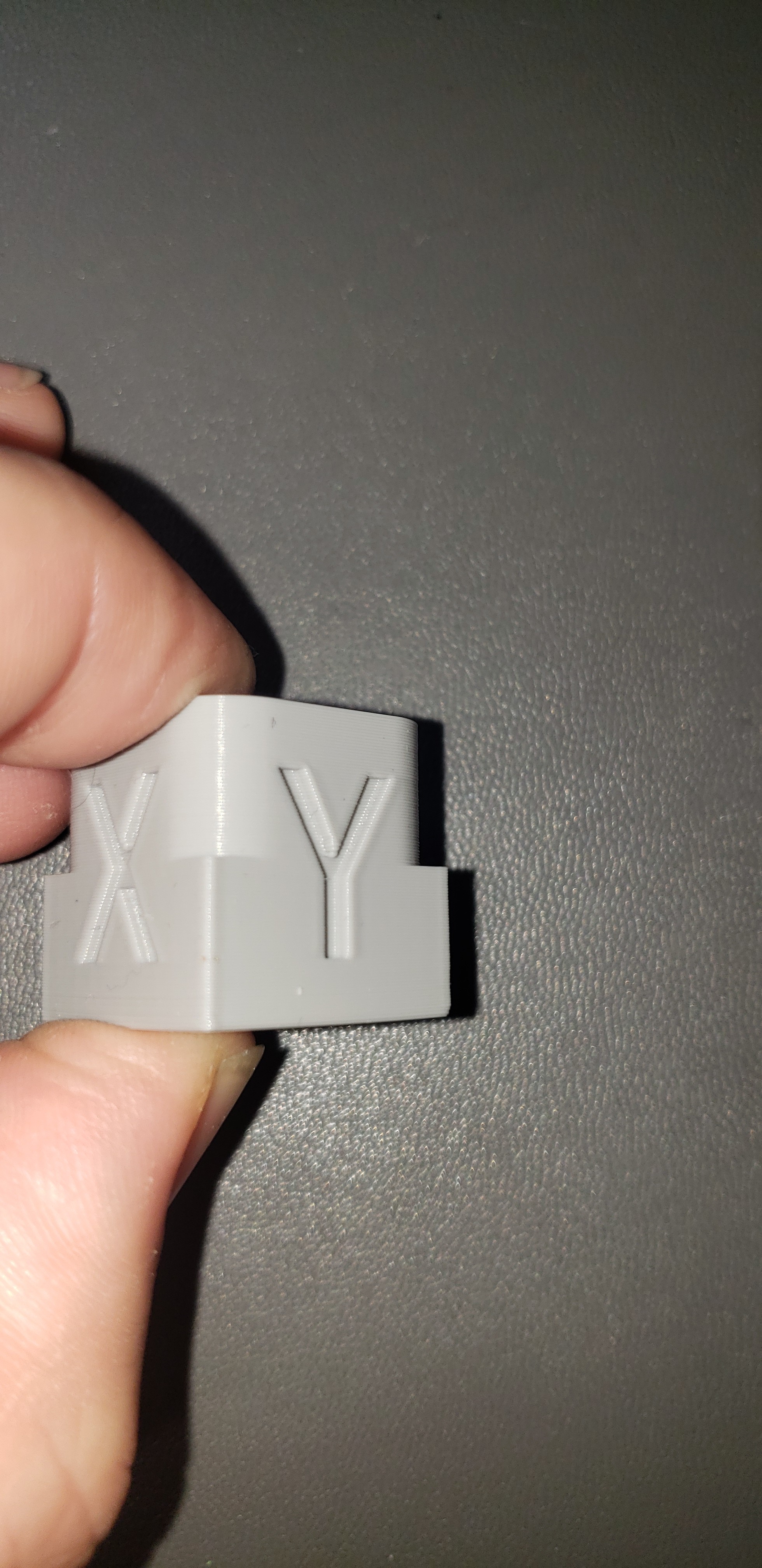

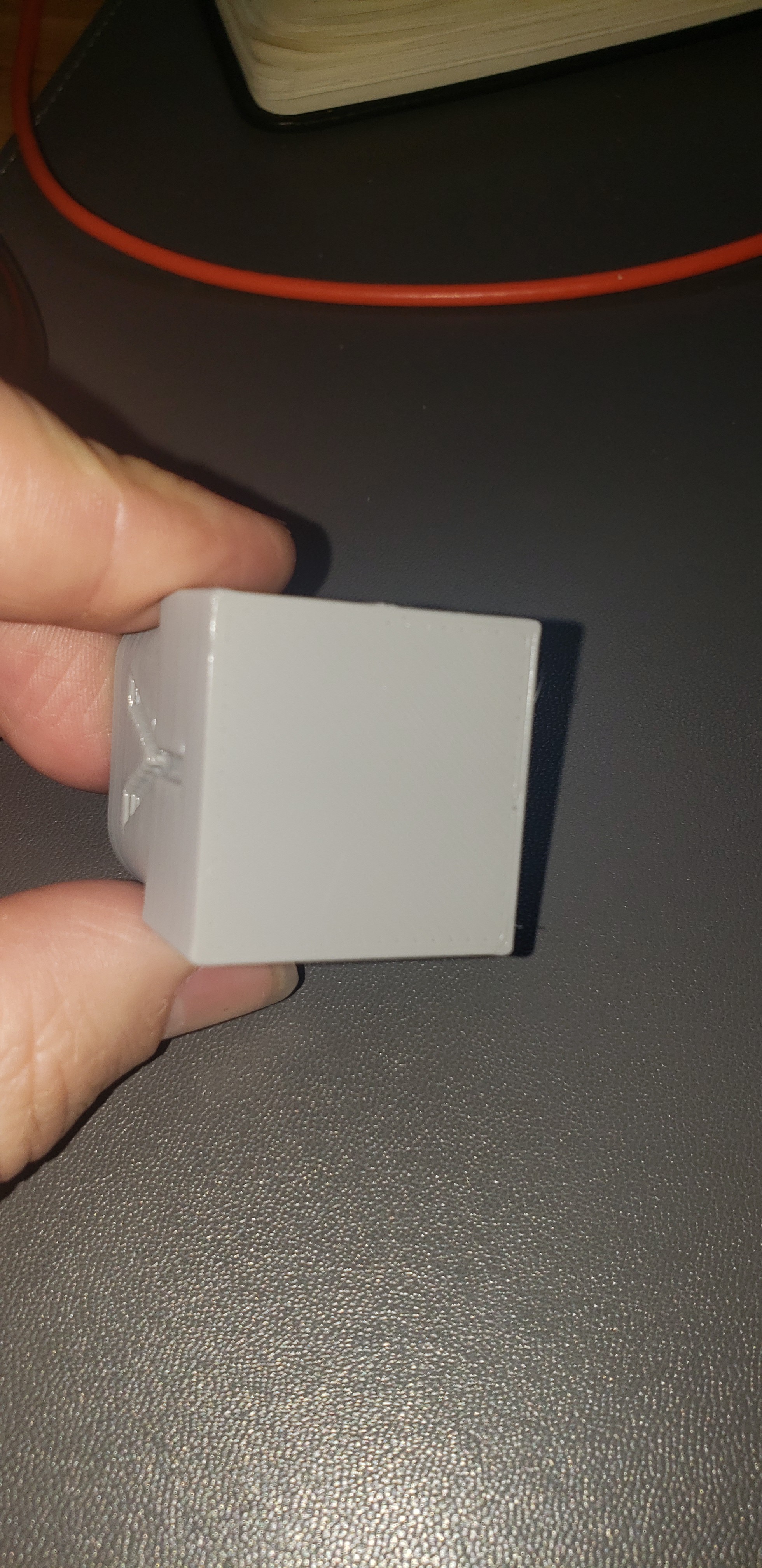

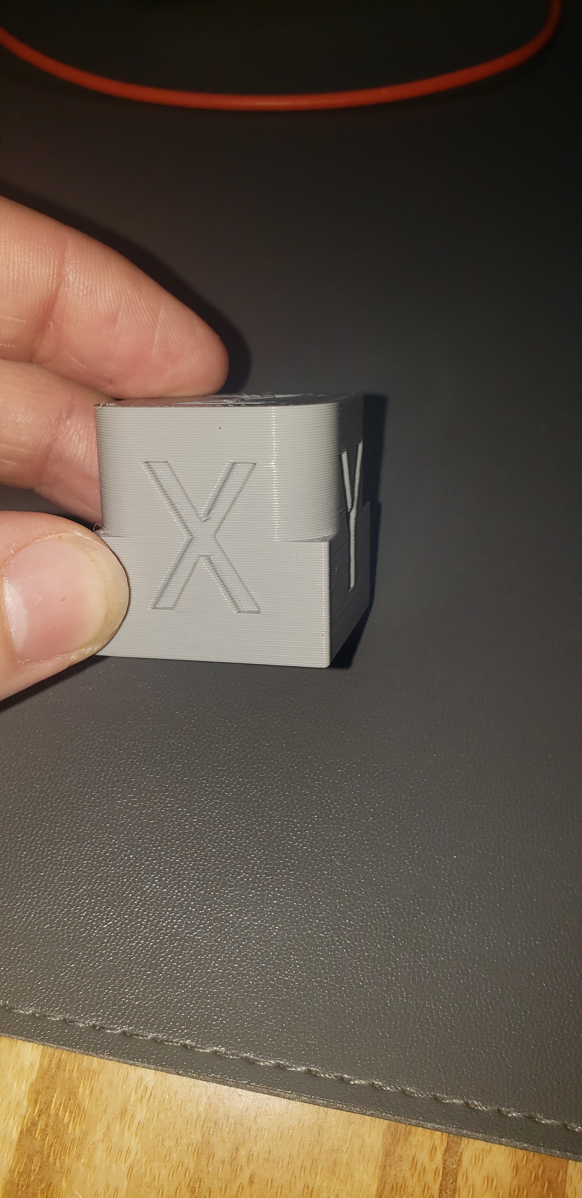

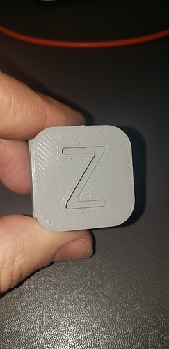

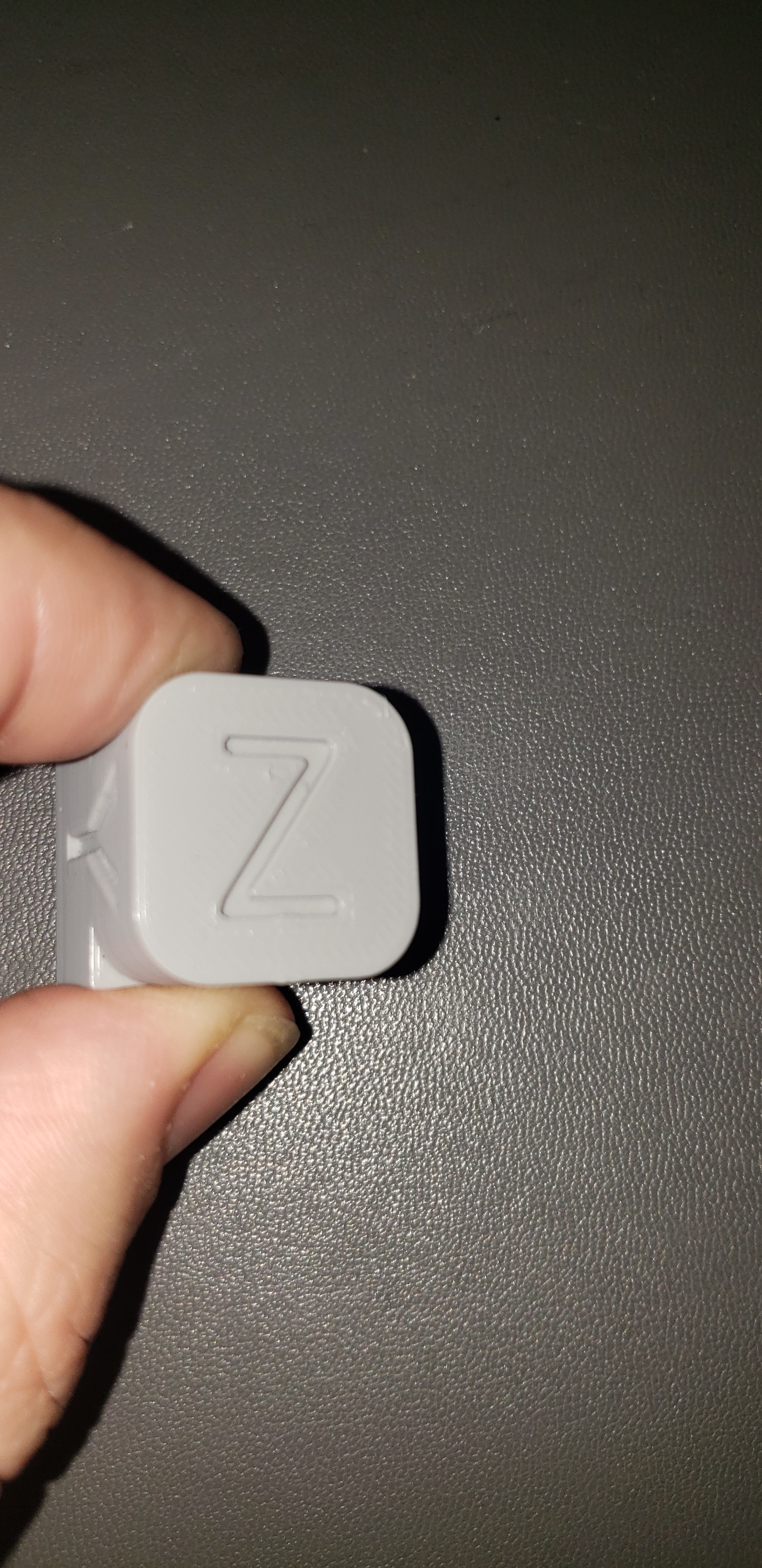

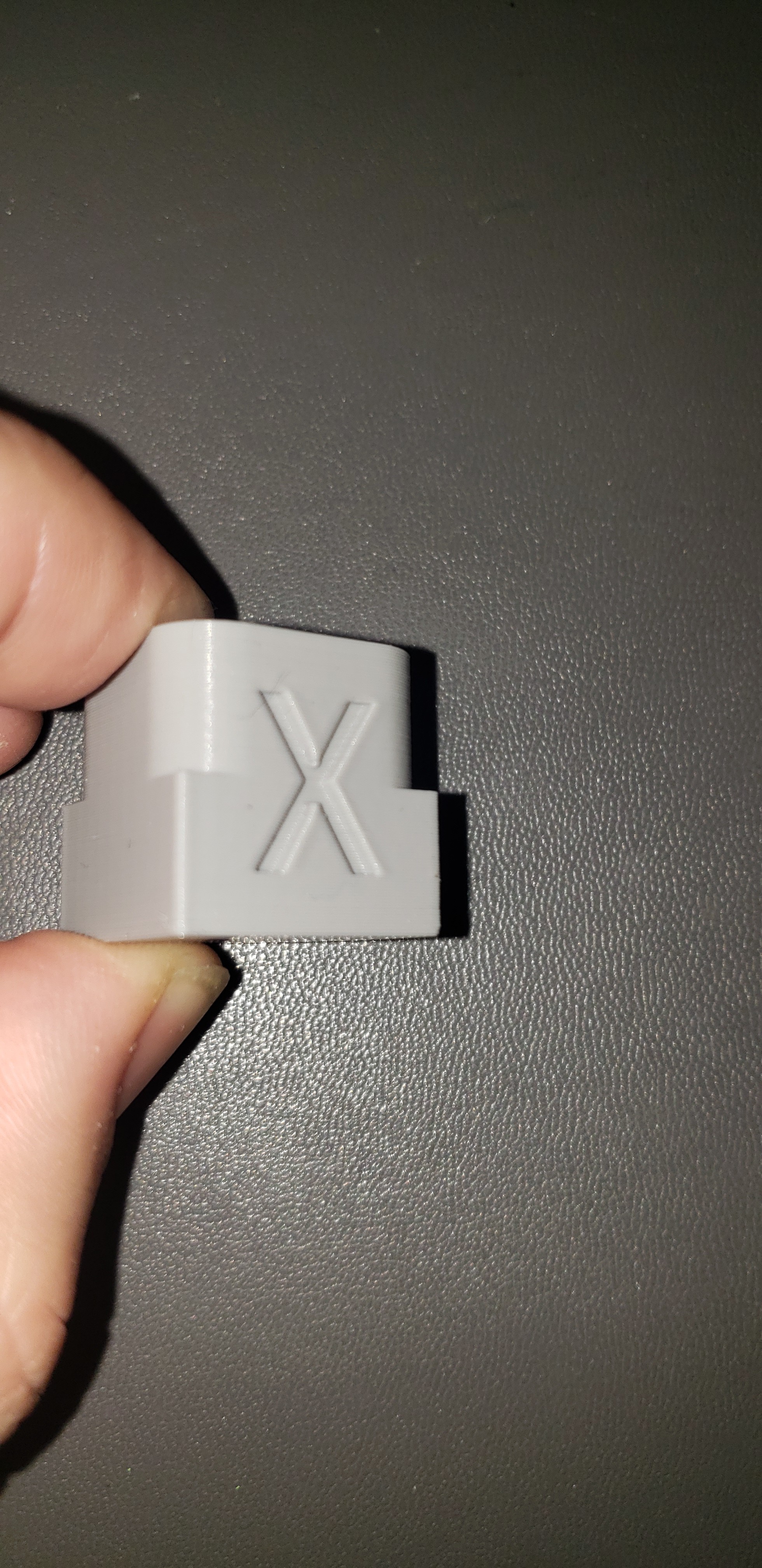

Calibration cube:
Looks pretty good to me. Let me know if there are some issues I am missing still. I did adjust seam to rear for this print.
X=19.94mm, Y=19.98mm, Z=19.97mm (20x20x20mm cube)

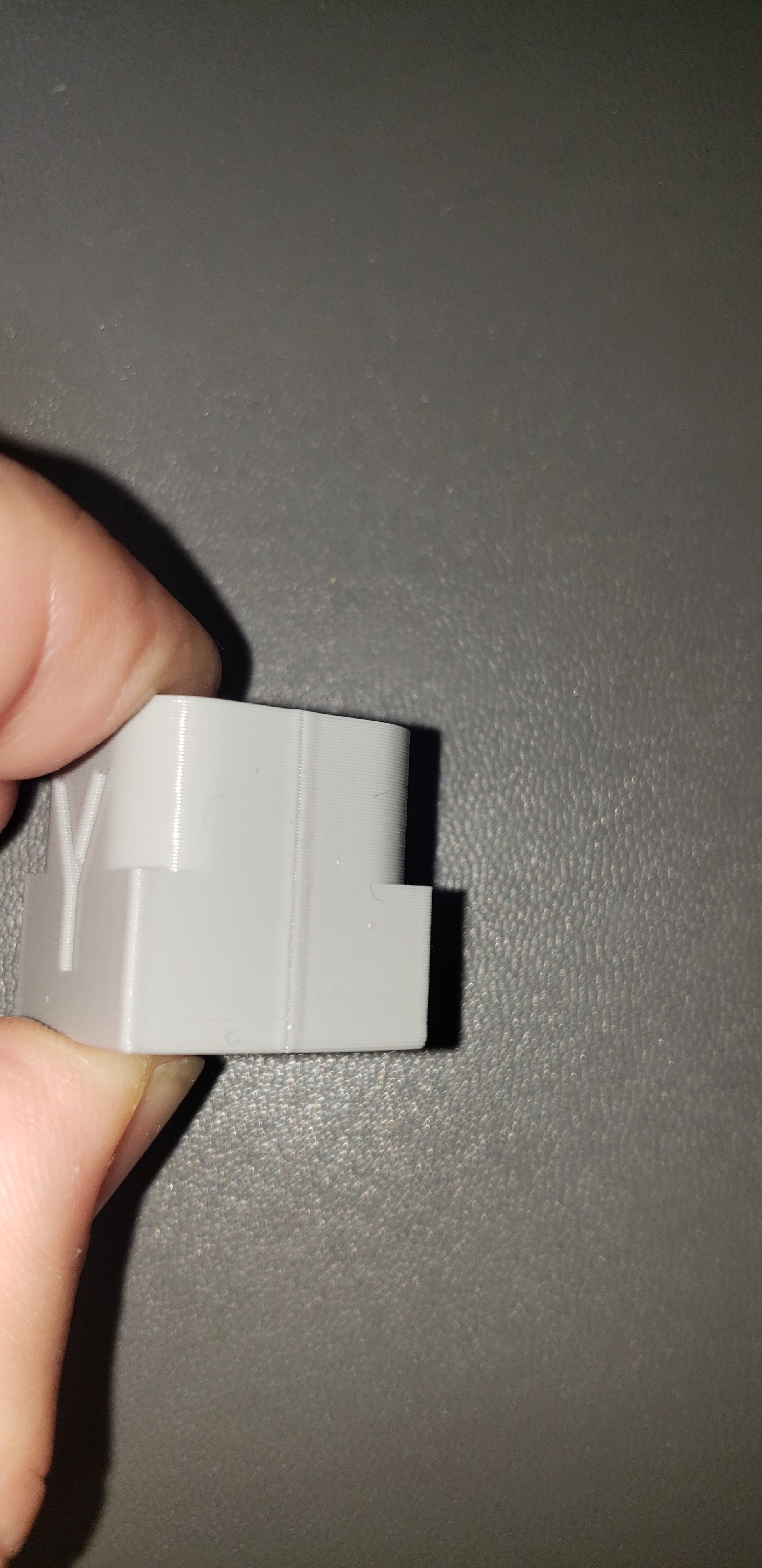

And finally just a test print:
My comments on this is that the print didn’t fail. Looks decent. It does have some slight stringing and some layer inconsistencies. The print is only 50Lx10Wx50H though so it is probably better suited for a .15mm layer height.
I think I can successful print the MPCNC at this point though. I have ordered a 0.6mm nozzle, so I might play around with it some if it comes in before the tubing. I also will do a couple tests at 0.25mm or 0.3mm layer heights with my 0.4mm nozzle to make sure it is dialed it at those layers before printing the components.
That said, I would love to hear if you have any ideas how I can improve my prints, especially pertaining to speed and retraction (and temperature). I know they are all related, but the challenge for me is not knowing which setting to change that has the best chance for improving the quality. For instance, on retraction, there are all these options to choose from and as mentioned above, I would like to be able to reduce stringing further while preventing the layer defects in the external perimeter.
I think it looks great now!!!
70mm/s retraction speed is very fast, if you have a geared extruder make sure that is actually possible. If it is set too high, it will basically just not retract. Although it looks like it is working pretty well.
Thanks.
70mm/s is default for the mini. Granted, I have replaced the stock extruder with a slightly different one. The main difference is the new extruder has teeth on both sides of the filament where the stock one only had teeth on one side and this cause slippage.
How can I tell if I am actually achieving 70mm/s? I know it is retracting as I can see the difference in prints when changing retraction length.
The extruder you bought should have specs for what those settings should be.
You can kinda do dirty figuring by how much the e-steps have changed. If you went up in steps 400s/mm to 800s/mm cut the speed. So in that example it has to move twice as far, so half as fast.
Okay good point. I don’t see any of that information. The specs just showed the gear reduction and what esteps to use.
They both have a 3:1 gear reduction, but the Mini used 325s/mm and the Bondtech uses 415s/mm. So speed should be closer to 55mm/s.

Nice work there. The small holes in the the top layer are neglegtable but you can ajust the percentege of top layer and perimeter to completely cover that.
The Z ring effect that you have on your layers… It gets worse as the print gets taller right? Although the mini has a different structure with a single Led screw it’s not imune to z wobling. Actually makes prety Hard to kill that. But it’s more a aestetics problem then a estructural problem so thats ok.
For bed adhesion I always print a brim/skirt of about 5 to 6 perimeter and a distance of 0.4 to 0.5mm. This helps to prevent curling and lifting outer borders from the part specially on thin or places with filetes. My first layer is very slow (tipically at 5 to 10mm/s) to ensure it stocks right. I always clean My glass with a window cleaning product that remove also any fat residue. I don’t use glues or adhesives on the glass. After cleaning NEVER touch the glass with your finger.

I would not say the z-ringing gets worse as the height increases, but rather it is random or inconsistent throughout height. With the mini, I think there maybe several factors contributing to this (especially since I consider what I am seeing now to be minor).
  1. Z-screw – The z-screw may have some slight debris that is inconsistent. I really should clean it really good. The Z-axis runs on two smooth rods with a floating screw so this should minimize ringing from this; however, if the rods aren’t perfectly parallel, smooth, or straight I imagine it could contribute to this.
  2. Cantilever X-axis – I really am not a fan of this design. It requires some attention to ensure the X-axis is parallel to the build plate. I think I am really close now, but I don’t have a great way to measure it perfectly. Also, since this is a bowden tube design, I am now wondering if the bowden tube is pulling the x-axis up as it moves further away from the extruder. I need to check into this.
  3. Extruder and hotend - Obviously, if my extruder is not consistently pushing filament or my hotend is not consistently heating it, this could affect layer volume and cause inconsistency.
Here is a nice write-up I found on Z-ringing if interested.

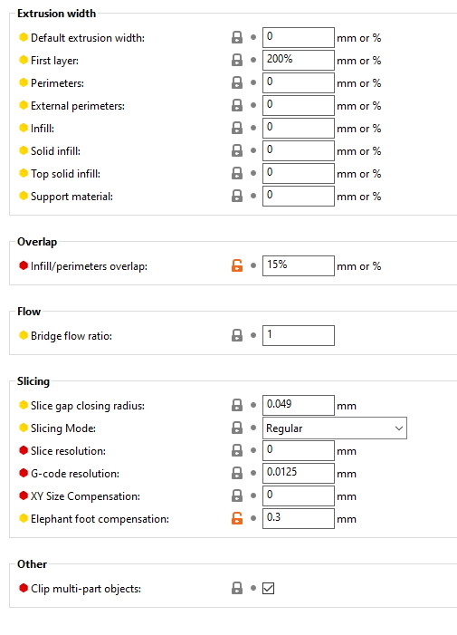

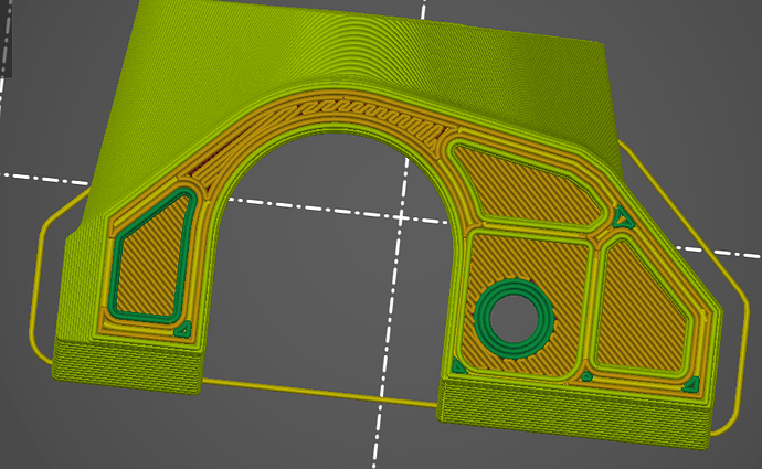

I have just sliced one of the Primo parts and found some inconsistencies I am not a huge fan of (0.3mm layer height, 0.65mm extrusion width). I believe I can help the top and bottom layers, but what about the areas around holes shown below?
Did you happen to share your extruder design? I would like to take a look at it. With the better prints I am having at the moment, I probably won’t replace mine, but possibly in the future.

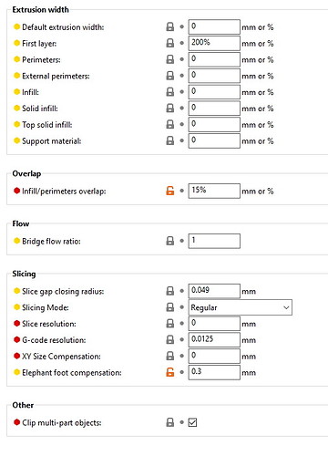

No the paramater I’m talking about is just below those
overlap
I don’t now exacly your settings but I just set the nozzle diameter. I don’t mess with the extrusion width and let the slicer calc that up. Setting that may cause the extruder to force more fillament to meet the desired width. I actually did not touch any of those.
My layer height is 0.34mm and my first layer height is 0.306mm to press the plastic on the glass without over squashing it and having to do much of after treatment to the part.
Yes I did. Here it is again. This is the NSTT extruder. There are other variations of my desing like the drakon or the piton extruder on Thingiverse. Check them out. It works really well. Also take a look at some of the comments on my design on Thingiverse.
All the possible issues that you might come across are answered there.
Thanks. I actually ended up changing the infill/perimeters overlap. It was default at 25% and I bumped it slightly to 30%. I didn’t end up adjusting any of the extrusion width options. I notice you have elephant foot compensation on. I actually turned that off due to the parts already being chamfered. We shall see if I regret that.

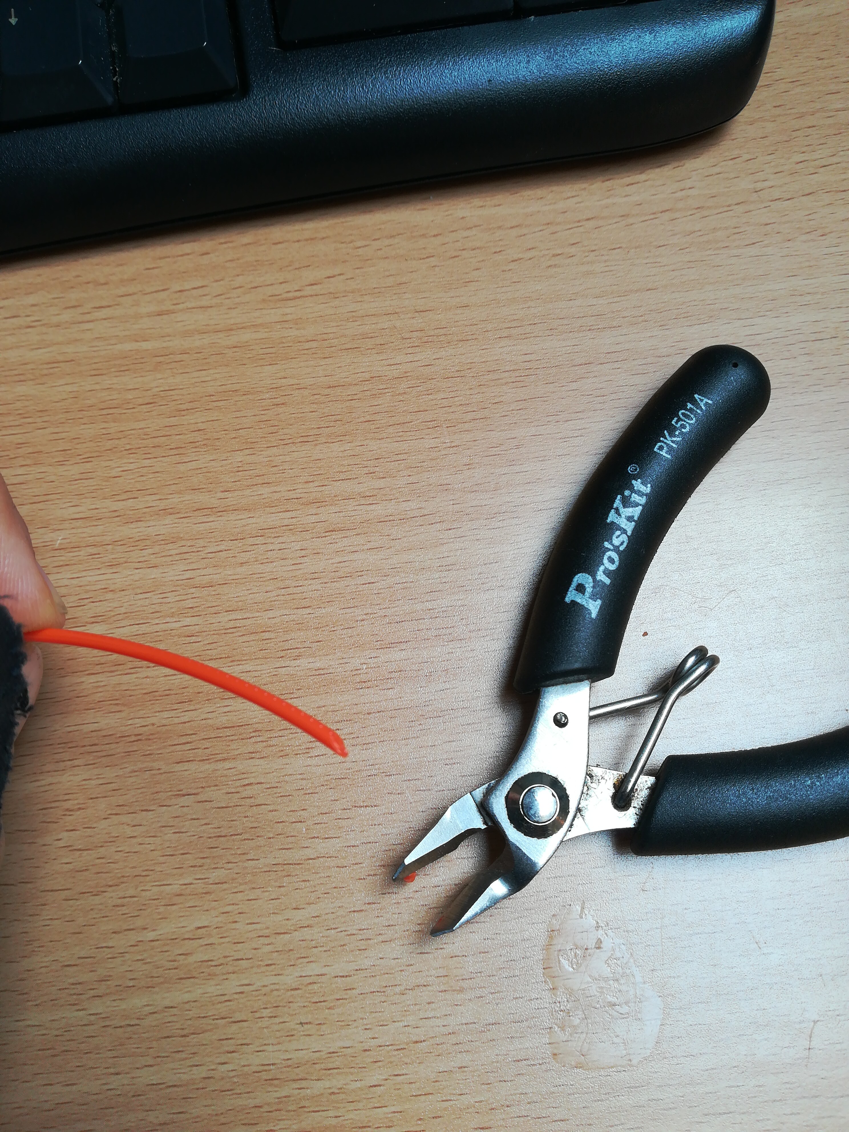

This happens also on my E3D clone. To minimize this I always clip the tip of the filament in a 45deg angle like this:
Also do some cold pulls should unclog your nozzle. I actually have that programed in the end code of my slicer. Cool the extruder to about 100º and retract the filament slowly after the print is done. This does the job for you. :wink:
