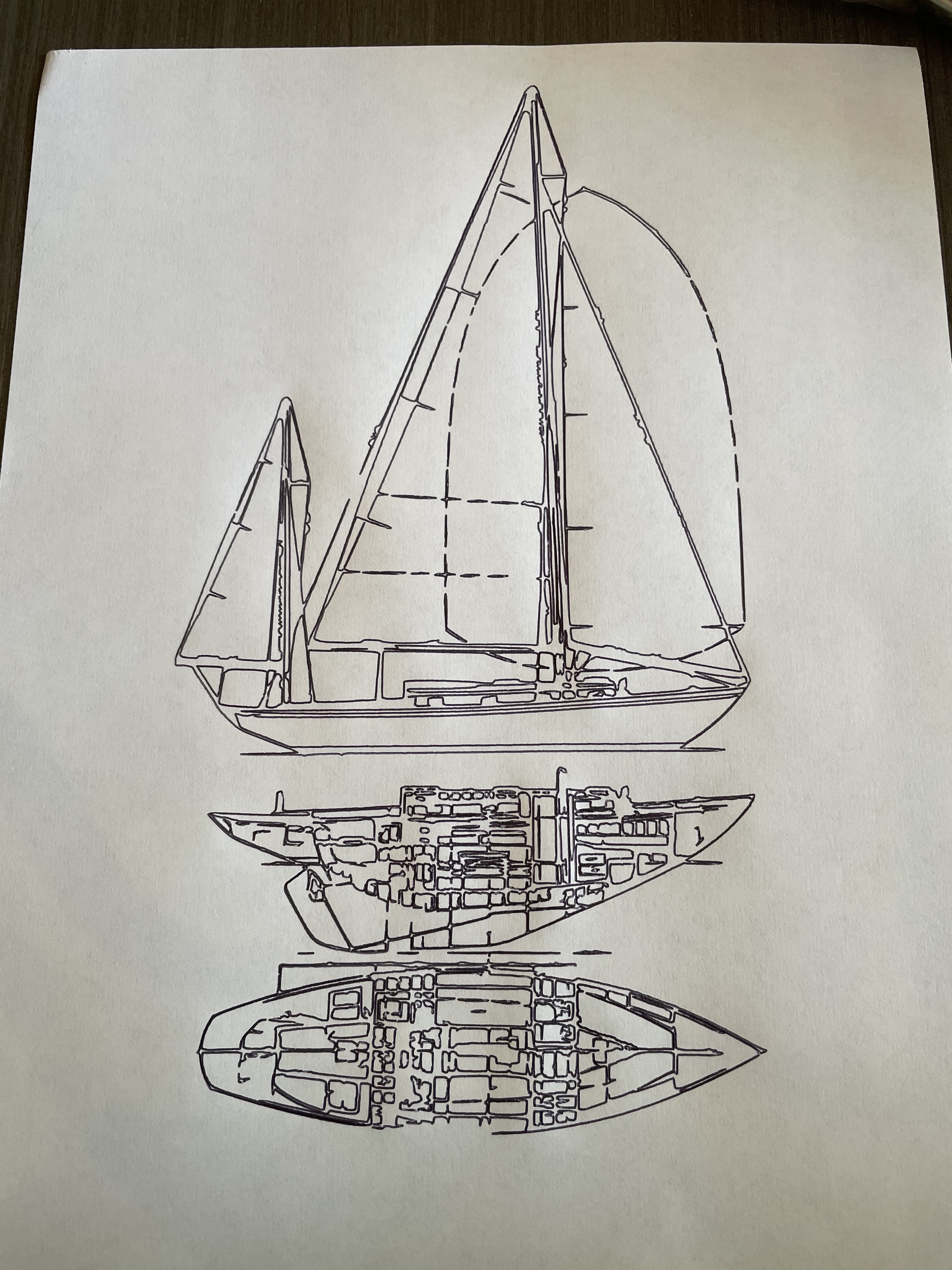

This started as a jpeg of a Ralph Winslow design wooden sailboat. I used inkscape to create the vector file and estlcam to create the gcode for the engrave. I think these will look nice in wood as a carving.
I had been using repetier host and this is the first file run through cncjs which is a nice program.
Thanks! I am working on something right now and it has been a while. I was actually thinking about it and there is a difference between functional, and functional that “looks good”. I can get functional stuff in minutes, it takes days to make them look good and not just be blocks. I highly suggest making functional blocky stuff to learn. As you progress, start with optimizing, then worry about looks. Oh and the trick to being really good at CAD, the stuff they do not teach you…learn to edit it. When you get taught, they always say start over, the real key is fix your mistakes so you do not have to start over.
Very, very low depth. The lines are pretty close together, so I would not go over 0.5mm. Or make it huge.
Yep, with my old 90 degree v bit it would look horrible. I’ll need some small bits and shallow cuts…
