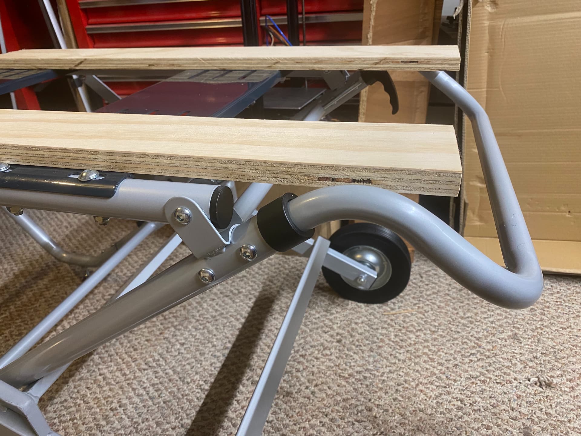

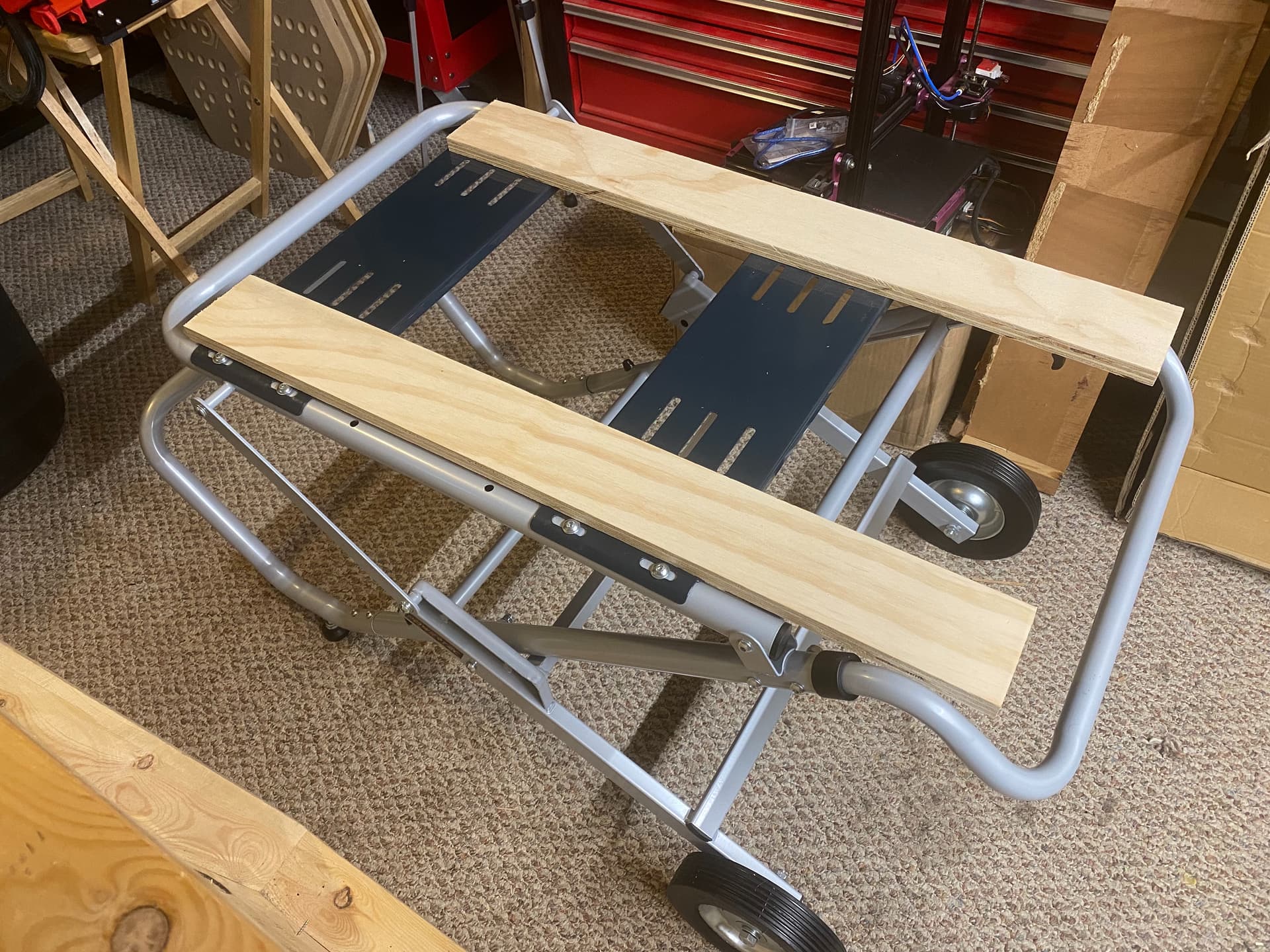

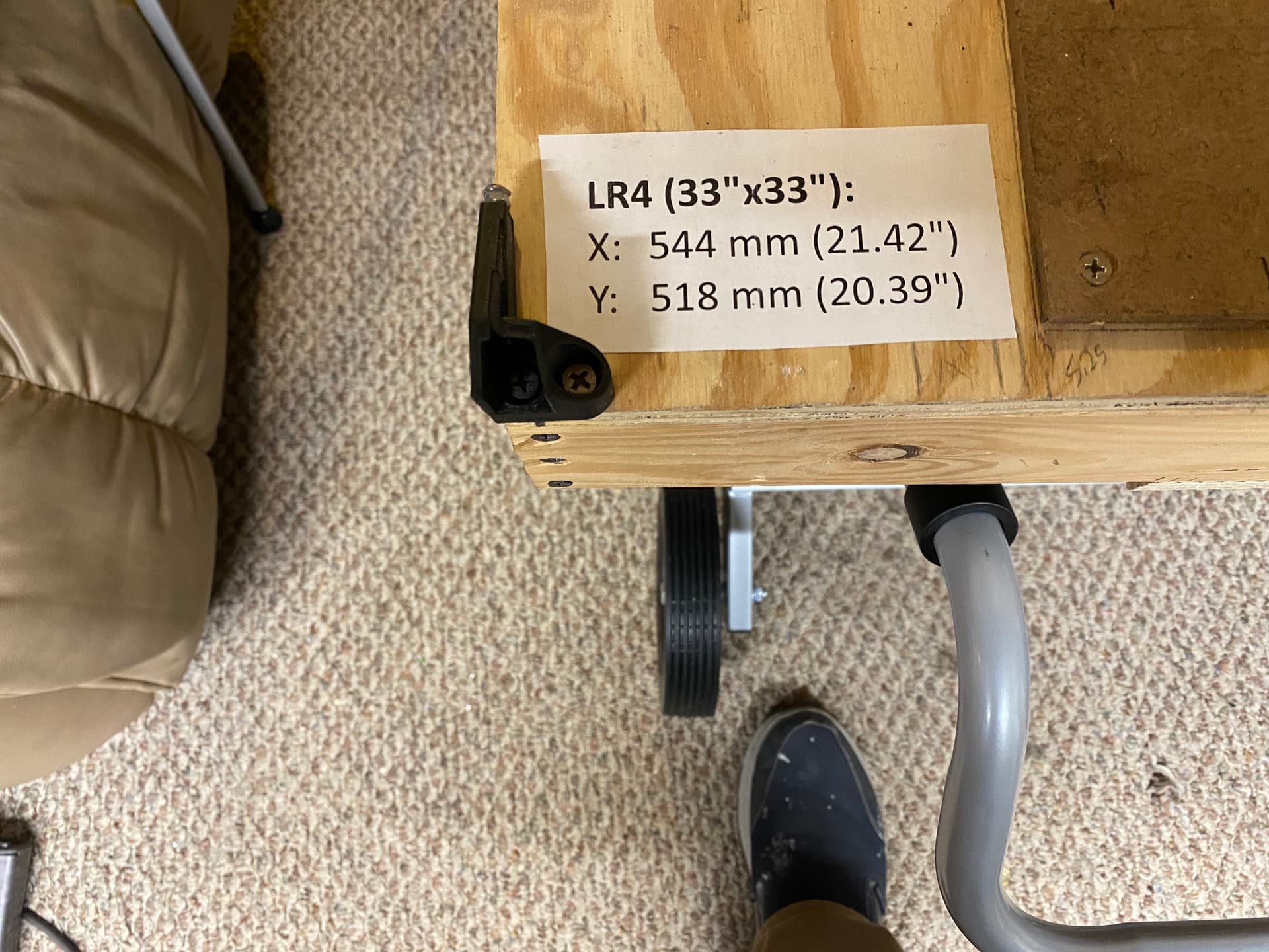

OK, so my foldable table saw stand arrived today, and I made quick work of cutting up two strips of “3/4” (18mm) plywood, about 4 inches wide and 33" long (same length as my small LR4’s table, which is 33"x33"), and it is going to work quite well.
Here the plywood strips are laying in place for sizing things up and measuring where to drill bolt holes.

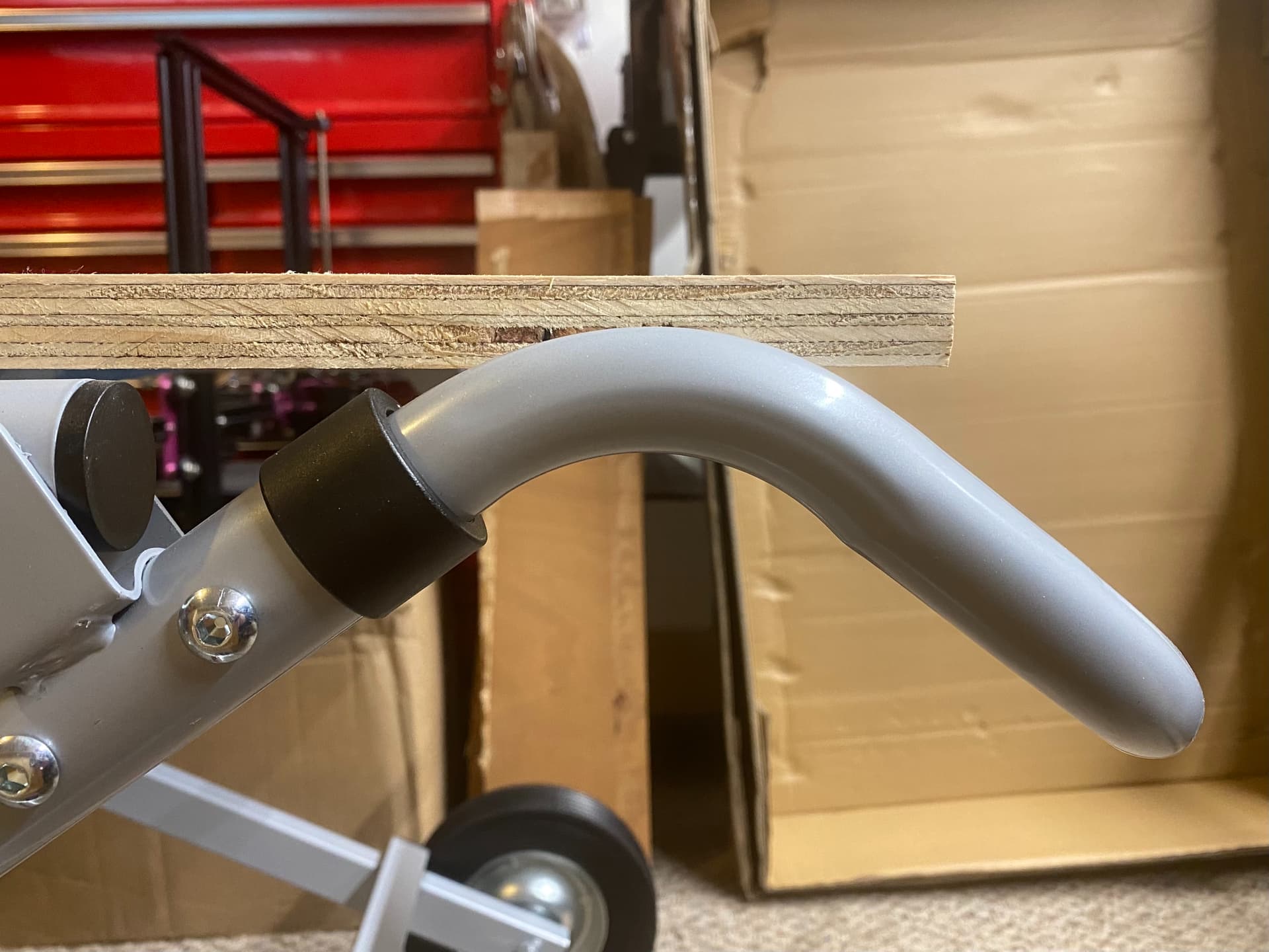

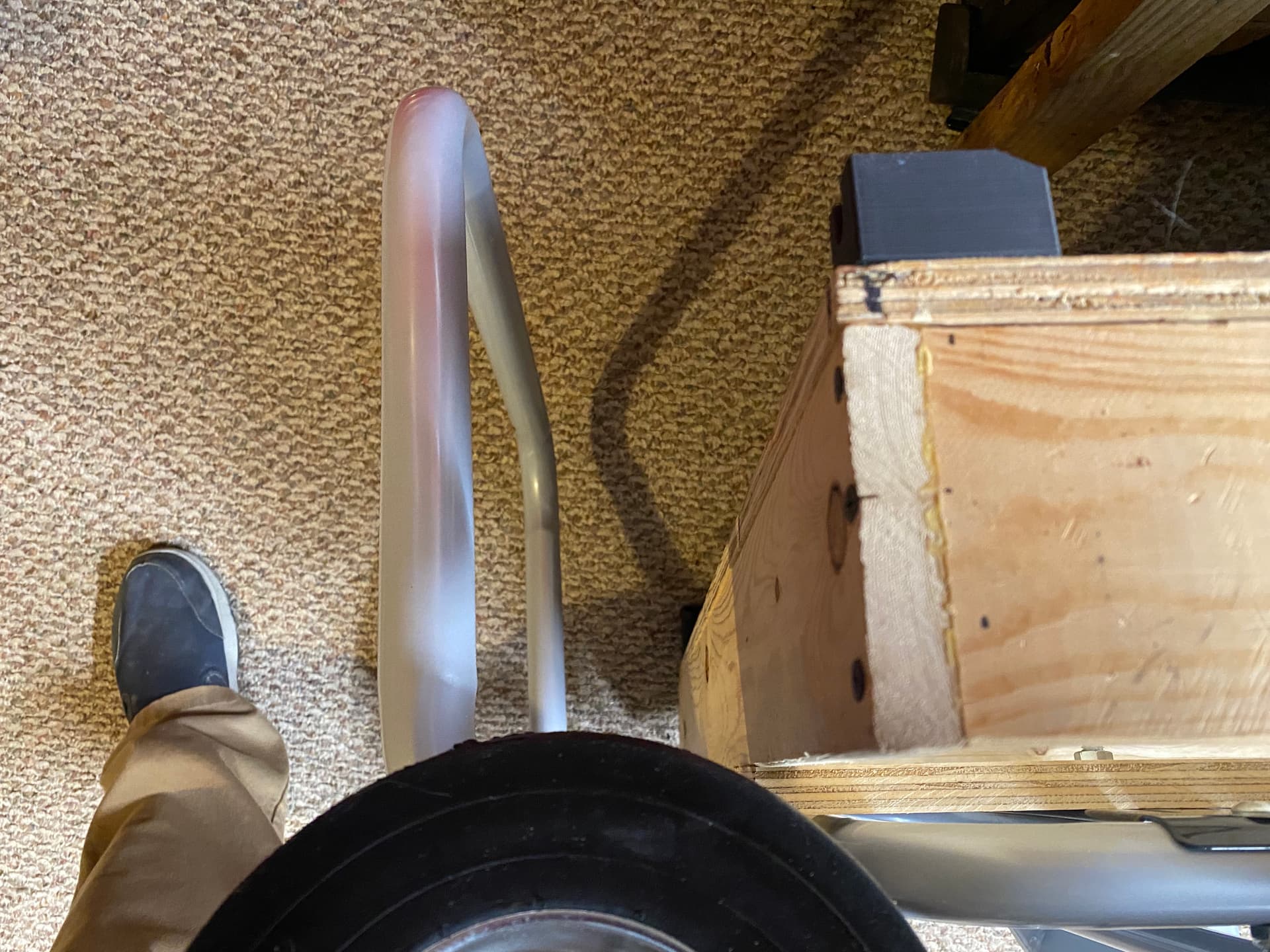

One of the questions above was about whether the handle protrudes into the plane of whatever is on top, and it does, but only by about 8mm or so, and even that did not interfere with placement of my small LR4. But just to show the intersection, here are some pics of that:

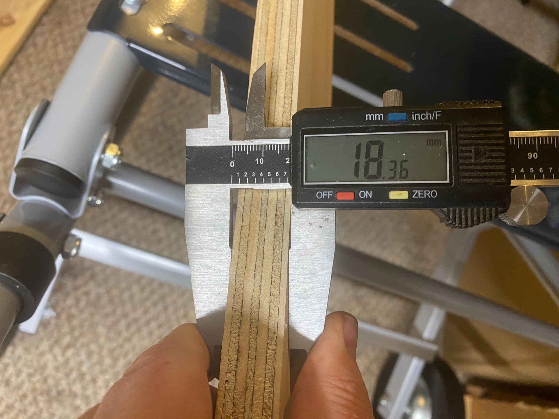

The plywood strips are about 18mm thick…
… and about 10mm worth of plywood is above the intersection point:
The two columns of bolt hole slots on the metal strips on the top of the stand, at their nearest, are about 40mm apart (nearest hole center to nearest hole center) and the outer column holes and inner column holes are staggered by about 20 mm.

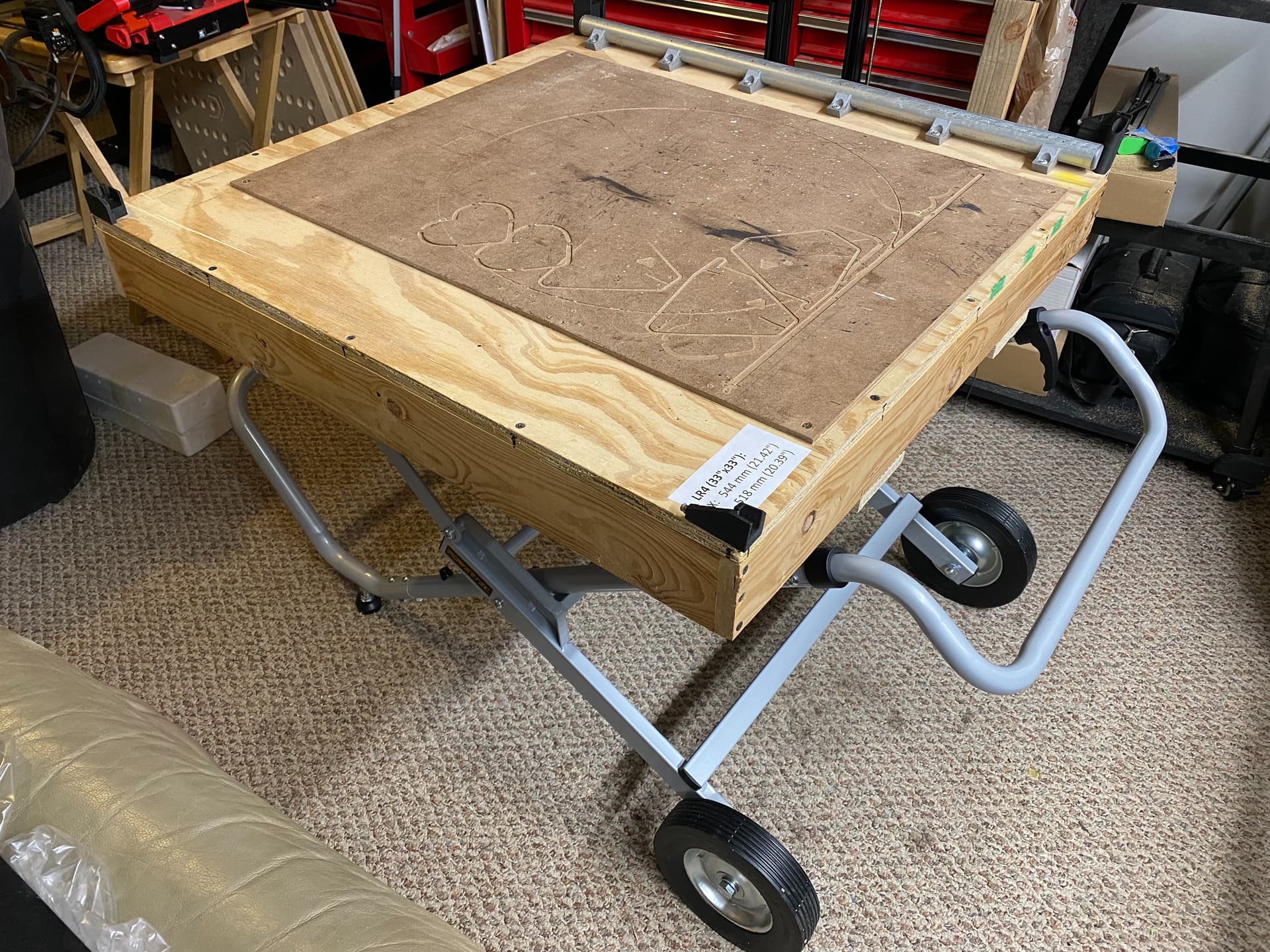

I got the bolt holes measured and drilled in the plywood, got the strips bolted in place, and then, with the stand folded up and standing in place, I positioned my 33"x33" table against the plywood strips and attached it using course-thread tapered-head screws:
I don’t yet have the small-gantry LR4 attached to it yet, but that’s quick and easy. I’m liking this!
The Ryobi Speed Bench table would be an even better thing to use, I think, but I had already bought this and it will suit for this purpose nicely.

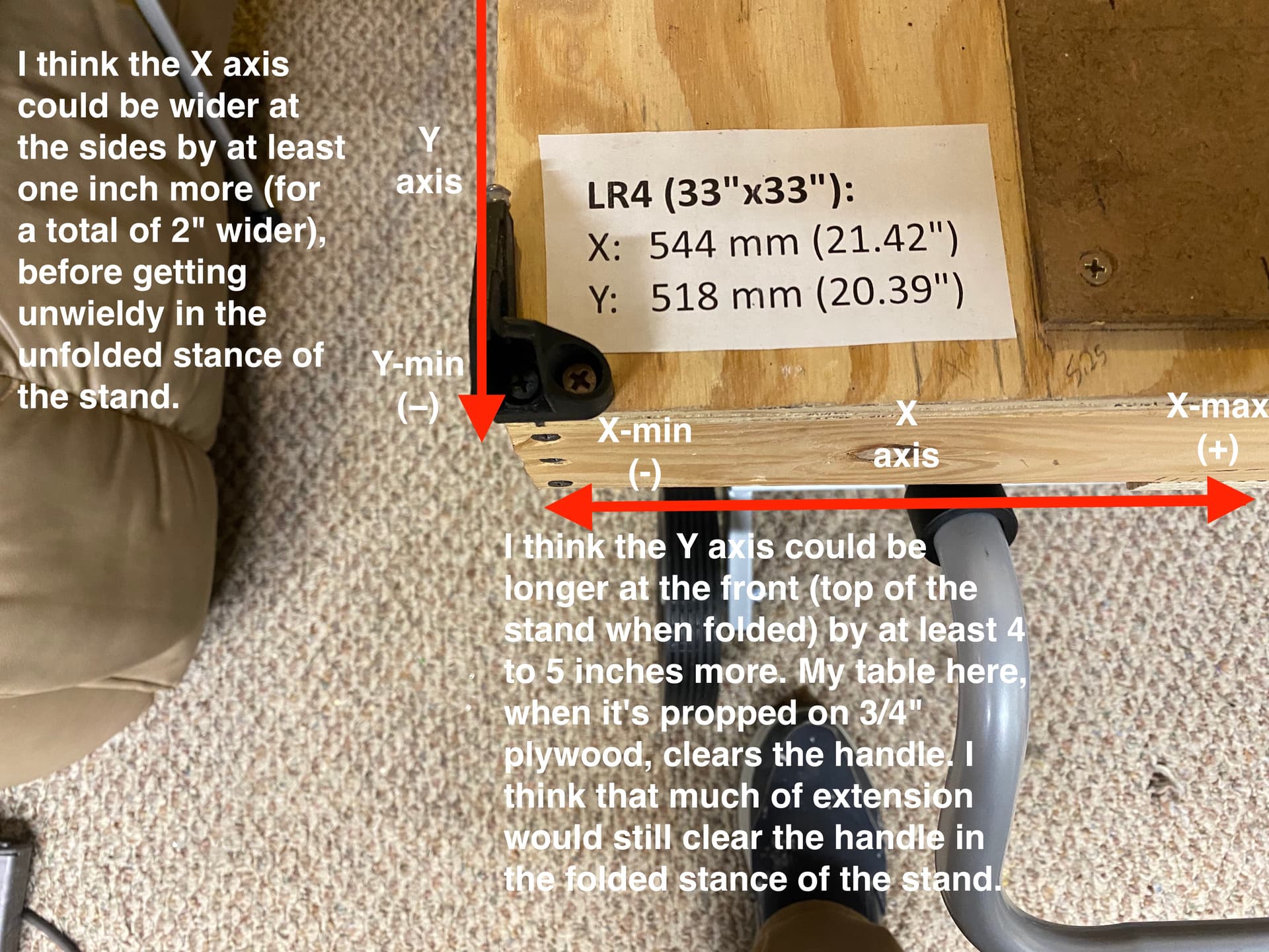

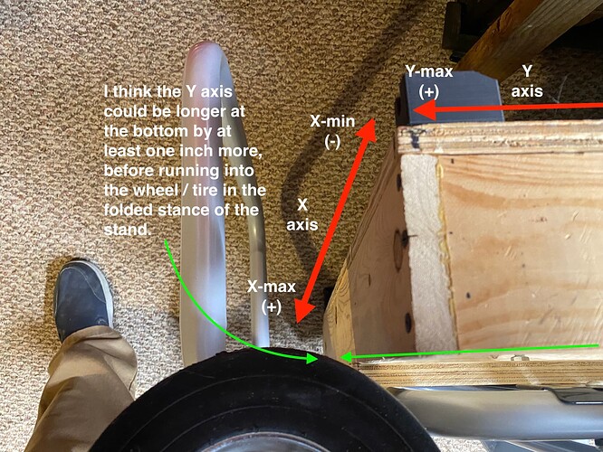

Out of curiosity, how much longer do you think it could be without getting too unwieldy? That just looks awesome, and would stow so neatly out of the way. Do you think you’ll need to add additional stabilization? If you made the Y running areas longer (creating a bit of an “H” shape) do you think you could get additional cuttable area (thinking that it would reduce the weight a bit and allow perhaps a bit more length for the part that folds “down”.

My little table here is 33" x 33". Based on what I’m showing above, I think it could be 35" (X axis) by 39 (Y axis) and still be OK. But for being able to run it without any additional stabilization, might not want to go much wider than the 33" width I’m using here.
Thanks for looking at it. That looks like you could squeeze in 24 x 27" cutting area, which is respectable!

It’s just the LR4 late-stage beta (release candidate x) CNC gantry I made during the beta test phase, attached to a wooden box frame with plywood on top, with some MDF on that for spoil board, all bolted to a foldable wheeled stand made for holding a contractor style table saw! I will try to (sometime) put the gantry back on for pics, if I did not already get pics.
