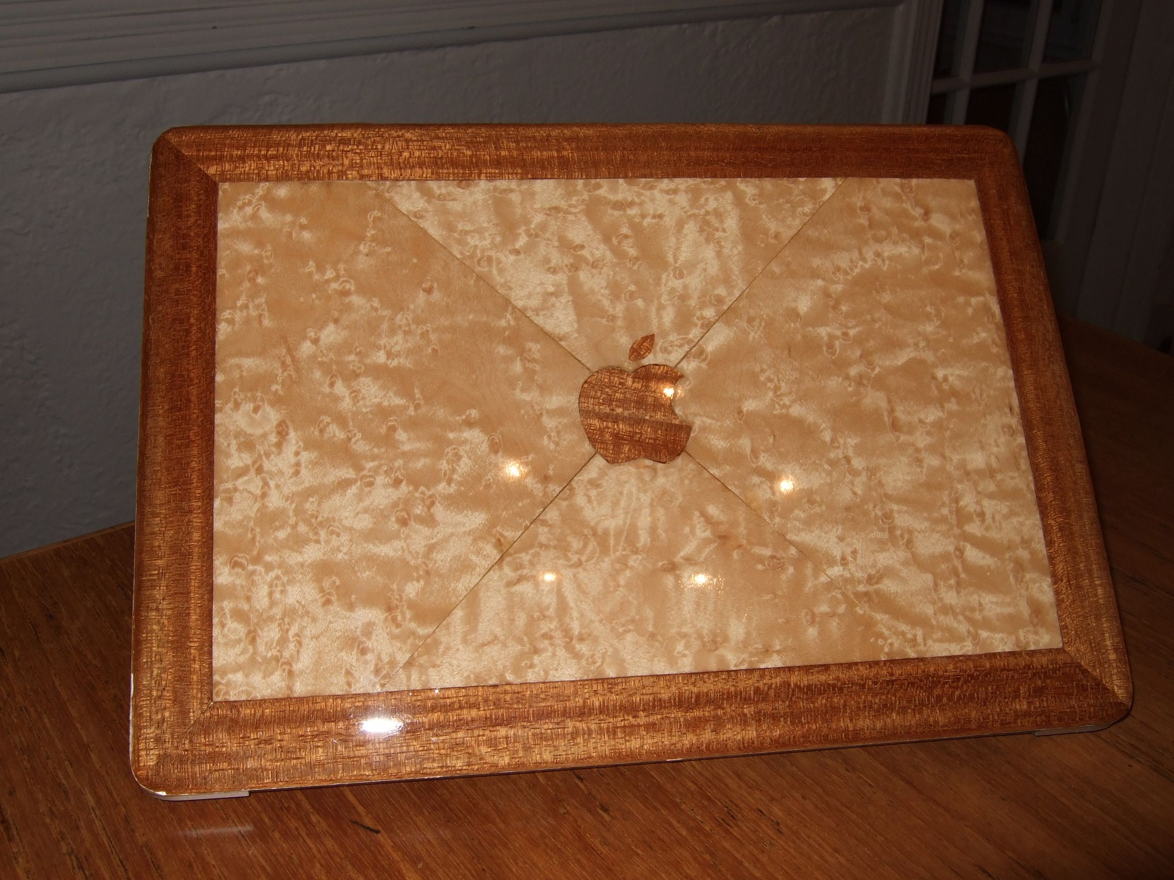

What is going on with that keyboard?! I love my mechanical keyboards but I don’t have one made out of wood and laquered to that level of shine!
I love them so much, I made one out of cherry and scrabble tiles… and you can learn all the details in an Instructable I wrote about the build:
(along with other maker projects of mine)
That’s awesome. I like the use of the resistor color code for the F keys. And you really did just completely wrap a whole keyboard in there. The cordless drill into a window opener is great too. I can’t wait to see what you do with a CNC machine.
