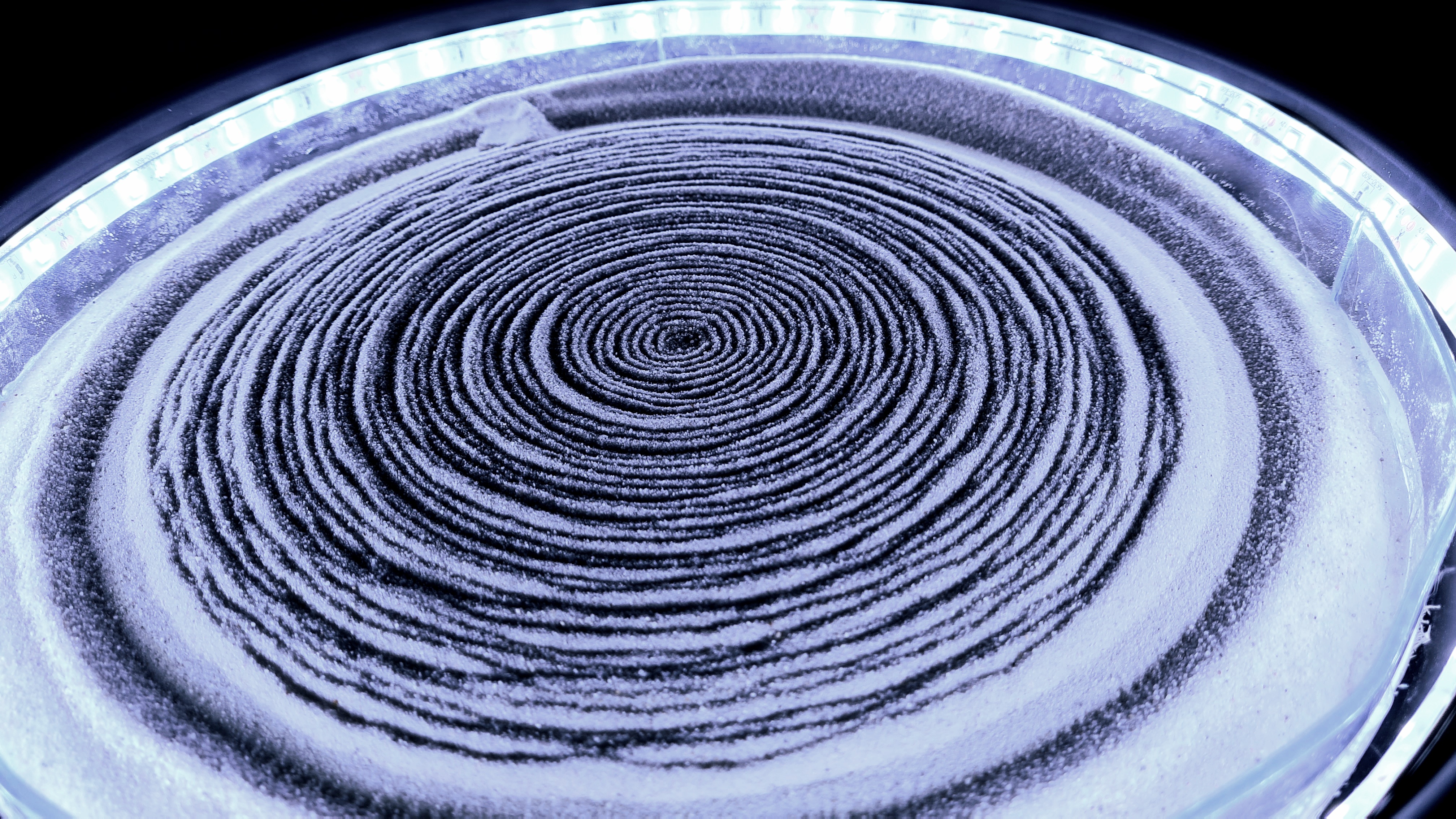

Hi all. Finally, my proof of concept work very well. I just have some trouble to make the ball turning and nit sliding! Have you an idea? Has someone get some luck to make the ball turning? Yes I have even try with the toy of my 9months child :man_facepalming:
It’s alive!
To get it to slide, the depth of the sand needs to be well below half the height. Closer to 1/3 or 1/4 is better. It makes it hard to keep even, but it can drive over it.

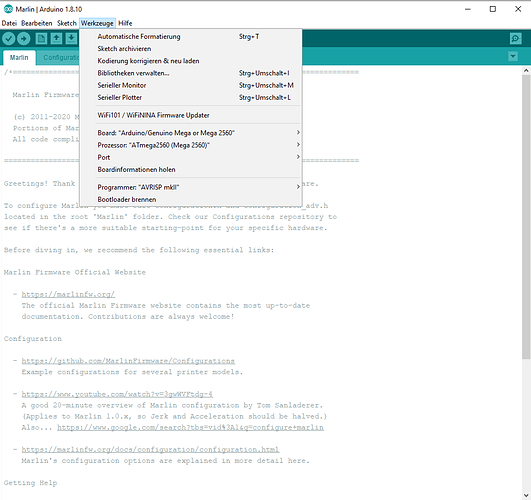

Hello everyone!
I am so happy to find this! I build the Rob Dobsons robot and its awesome.
but I did dive into this knowing nothing. So I just get to look at the robot…
I am sorry for asking for help. but if anyone can suggest a easy way to learn how to find and upload firmware would be great.
I have a Mega 2560 with ramps 1.4 board. i did see links for Marlin above and I do not know how to move forward. I also have a laser GRBL board if that’s an option?
Tried to just upload as is to board but get errors. and reading notes says to configure for use. I’m clueless.
thanks for any direction. I’m am looking to learn how the software side works.
Eric
Hey Eric
Dont feel sorry for asking for help. Just ask your questions here and I would love to help you.
First, you need to download Marlin for Arduino from the link below and upload the firmware to your Mega 2560. The Mega and Ramps combo is what I am using so it should work for you too.
https://github.com/V1EngineeringInc/MarlinBuilder/suites/1728007278/artifacts/32713996
The Errors you are getting are probably from not setting up the Arduino uploader the right way.
Set the settings to what you can see in the picture.
If this works you still need to change somethings in the code with RepetierHost for example.
What stepper drivers are you using for your ramps?
Greetings Arthur
Thank you for the info.
I started with that same file, I think.
I have A4988 stepper drivers
A question I have is do I unzip and run the .ino file or install as zip in Library?
Yes, you need to unzip the file and then open the Marlin.ino file and upload it.
As you are using A4988 stepper drivers you need to change it from DRV8825 to A4988 in the config.h.
Thank you Arthur
I changed all the lines to A4988 driver and tried and upload
I get same error
Arduino is looking for a Library U8glib.h
sketch\src\HAL\AVR\u8g_com_HAL_AVR_sw_spi.cpp:65:10: fatal error: U8glib.h: No such file or directory
#include <U8glib.h>
compilation terminated.
exit status 1
Error compiling for board Arduino Mega or Mega 2560.
I found I needed to update Arduino Library and install that particular file.
upload complete
so far so good
thank you Arthur for the guidance!

For sure now, the code you did work very and converting .thr to scara Gcode is quite precis. I’m trying now to modify the GRBL to put your math between gcode reed and motor motion. So, Sandypi would be able to draw well the print drawing
Bellow the extern diametre is only 250mm!!!
Thank again for your work
