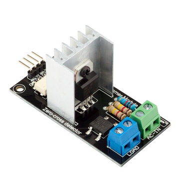

i found this AC dimmer for cheap, handles at least 6 A (triac is rated to 15A) PWM controlled, seems to be comparable to the one that you sell, just curious if anyone sees any issues with it.
That might work but not with the code I wrote, I am not sure what you would do with the zero crossing pin. From what I understand from the description you are offloading the work to the arduino, where the one I use is all on the dimmer board (attiny). Meaning we feed it a desired speed my board knows when to change it, that one relies on the arduino to read it and then change it. Not sure what else might be a down side of that maybe total speed, wire length/interference?
