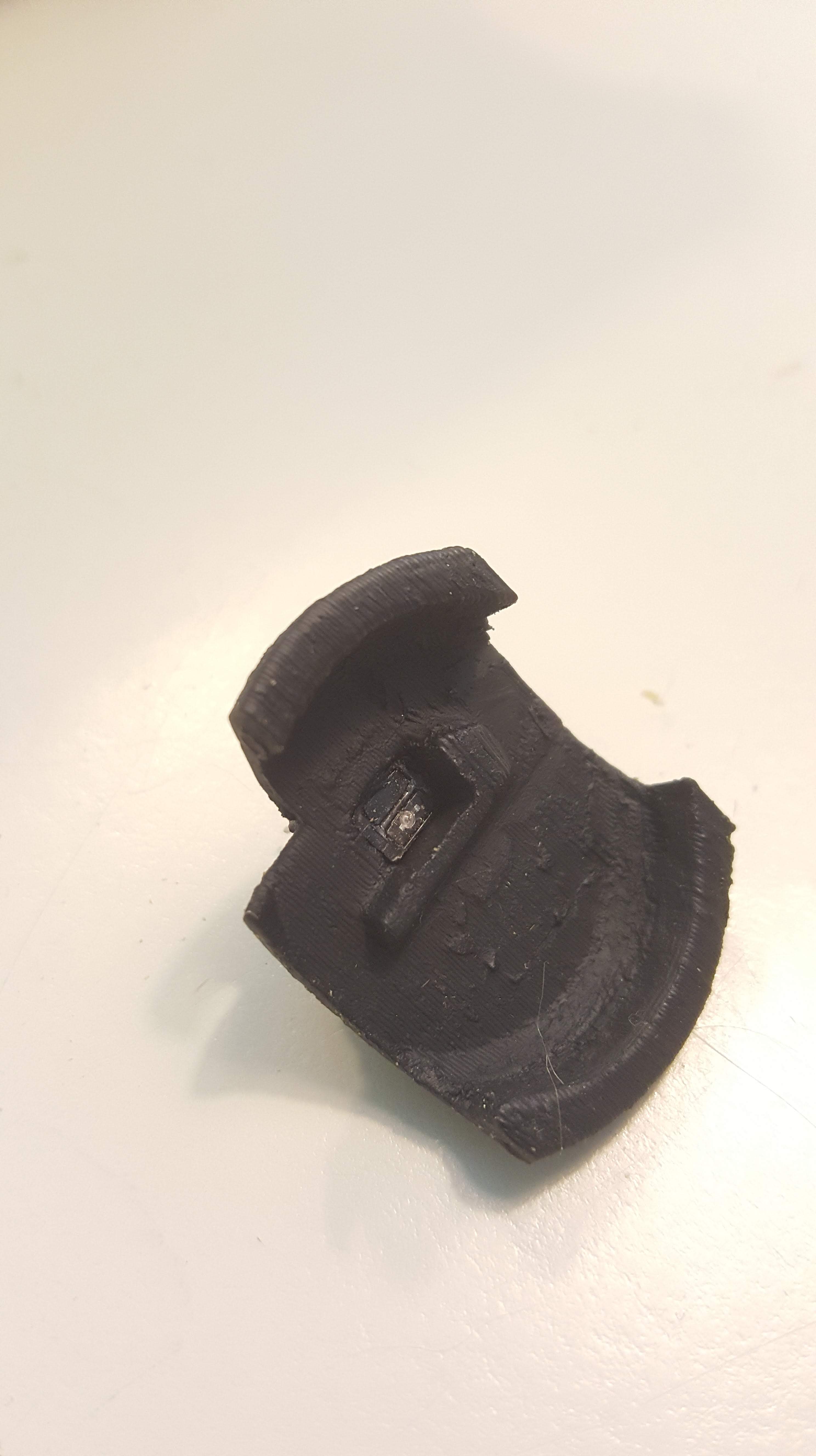

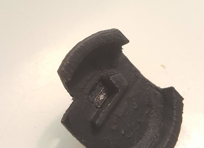

Printed the new cap and installed today did not get the same the clean test data as you did.

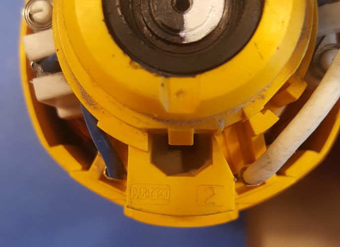

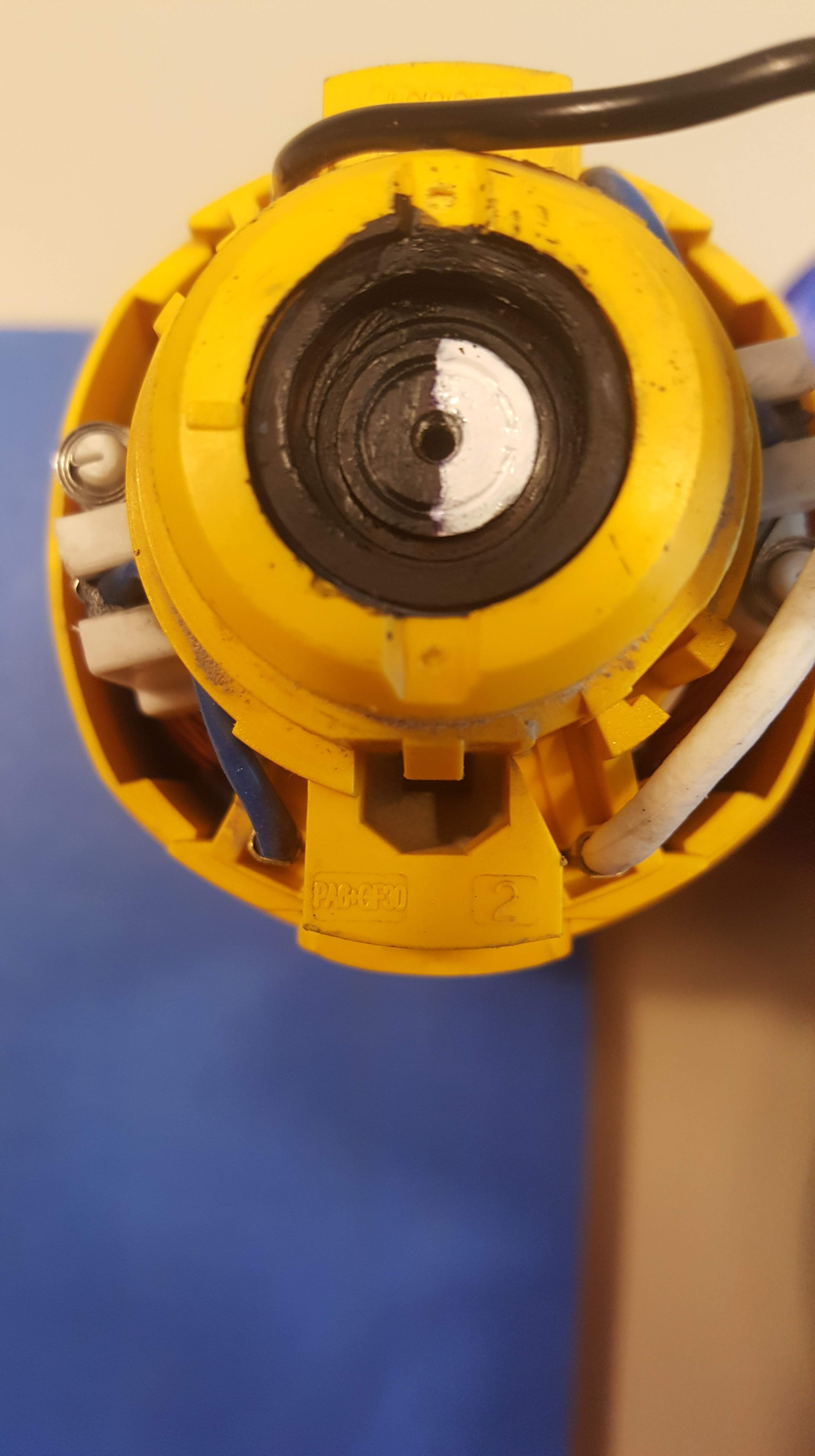

The highs and lows were not as large as yours. Will have to open the Dewalt back up and try to change the distance the censer is from the shaft. I think it is to high.
[attachment file=61031]
It should push all the way down. That print is missing some things. There are edges that should catch the led at the bottom, they aren’t even there on your print.

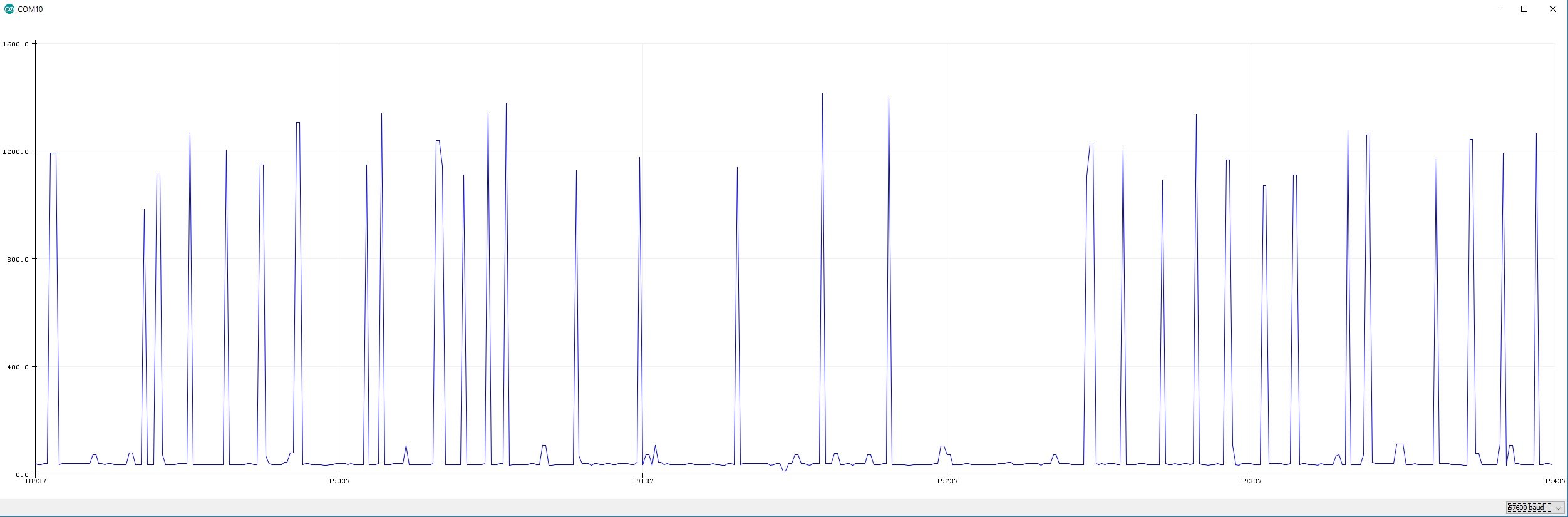

So my current best guess after all of this is that the line noise from the smaller Power supplies is getting pumped through the IR LED and Received by the sensor. This is causing an almost continual rising and falling situation. So when the router is running the real signal is stronger, but every few cycles the noise happens just in between the real signal and doubles the perceived speed, thus cutting the PID power.
So, clean power supplies work, dirty supplies…not sure if I can add a filter or cap or something. Everything I have tried has not worked so far to make it work with a dirty PS.

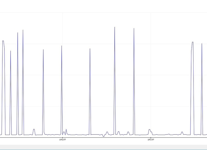

If I get the sensor reading just on the edge of the transition I can see the signal, much higher frequency. I am sure it is limited by the arduino interrupt speed only. Looks like it is picking it up down to ~40 microseconds (μs?). Use a different power supply the signal is absolutely clean. I don’t want a new power supply for everyone to be needed just to make this work.

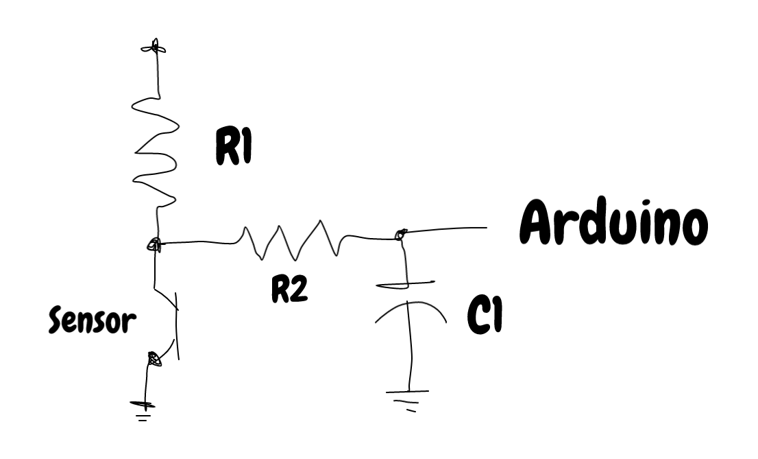

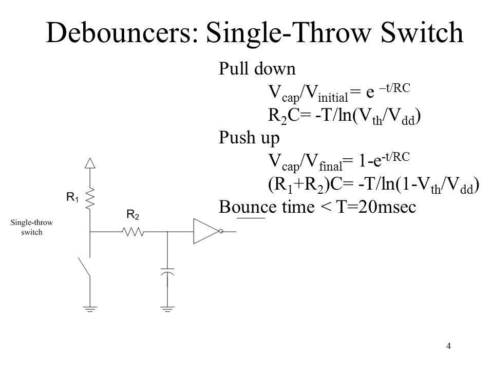

Can’t just use a pull up and pull down with a debounce cap in the middle? Hmm, I guess I mean a debounce circuit like this:
[attachment file=61049]
The signal change from the sensor is the switch…
Hmmm, I am not sure Bill, I will read up on that. The circuit already has the resistors that is why I tried to add some various Caps I had laying around. They didn’t seem to make it much, if any, better. But maybe I just have the wrong kind. It would also help as Jeff said to have an oscilloscope to see what I was trying to filter out.

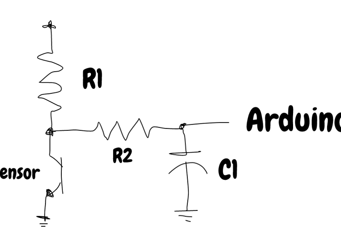

Filtering the noise with Bill’s circuit (congratulations, you are responsible for all debounce circuits now!) would smooth that out (probably?):
I made a sweet sketch with this: https://sketch.io/sketchpad/ and their default font is perfect!
[attachment file=61074]

Something else that’s bothering me. On that last graph, that is the analog signal from the sensor? And you have tried to put the sensor right on the border between on/off? Maybe that’s OK. You don’t really need to measure it when it’s off, right?

That last graph picture is still the time between falling edges. I can get the dirty signal by rotating the dewalt, find a falling edge, then slow move it back to get what I assume is just the edge of the black/white area on the shaft. They are not there with the 30A PS, or just USB power, but only the 6A PS.

Looks like I removed it when I cleaned up the support that was printed with the part. Reprinted last night and it looks better.
