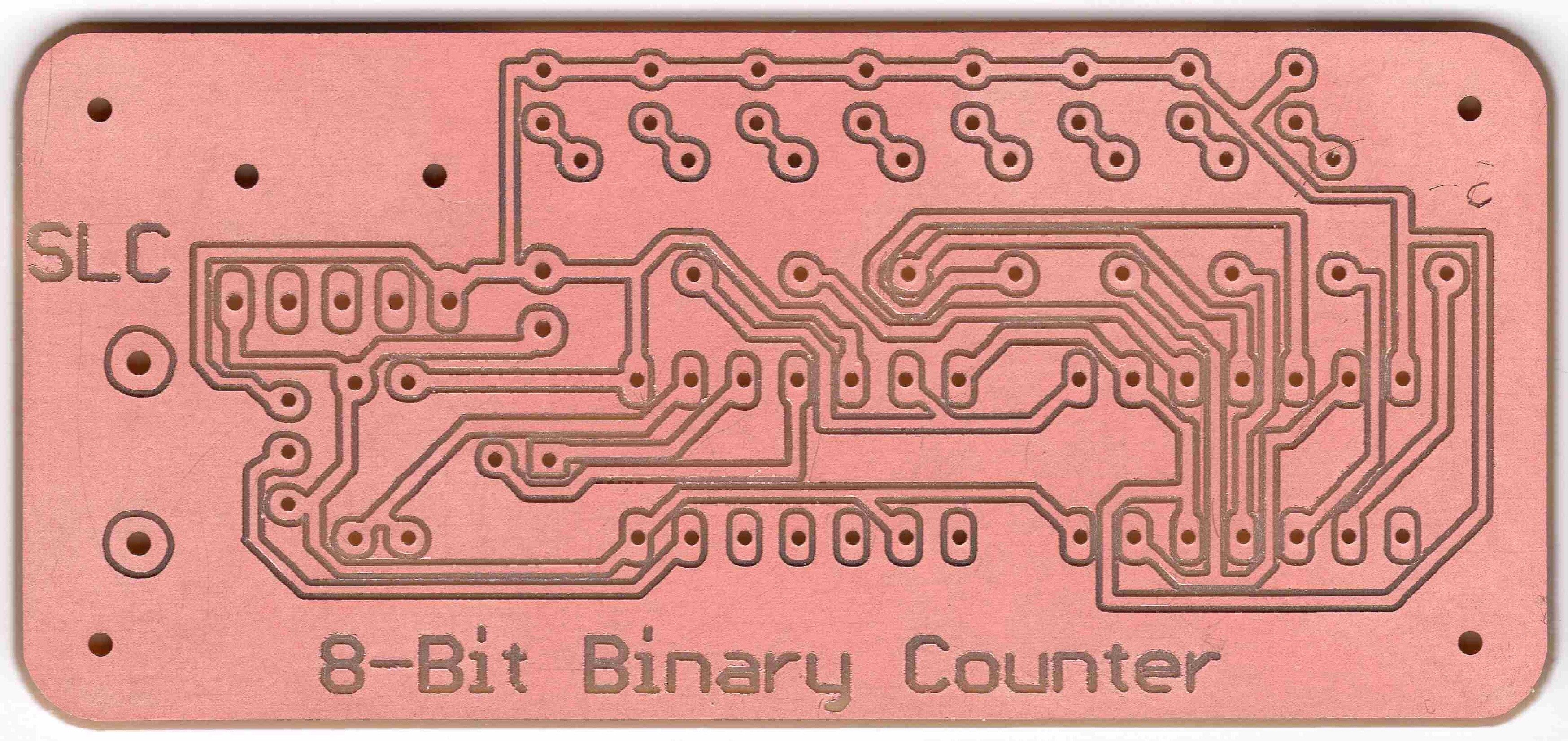

Thanks so much for your isolation milling write-up on github. Your notes and batch file gave me the inspiration to try it.
I made an arbitrary test board with a VCO and binary counter from some 35 year old 74LSxx parts that I had laying around. After the first iteration I squeezed the design rules and was able to get traces between the .1" DIP pads with very clean results. This is by far the tiniest thing that my 1 1/2 year old MPCNC has milled. The trace width is 0.6mm and clearance is 0.3mm. Probably could go a bit smaller.
I modified PostProcess.Bat to add tool-change pauses and messages on the LCD display and to combine everything into one gcode file. To set Z0 I just use a multimeter in continuity check beep mode and an alligator clip on the V-bit. I adjust the Z thumbwheel until it beeps then turn on the machine to lock in Z0. (I’ve been too lazy to merge your Marlin changes into mine for Auto-Z0 and to keep steppers active between files.)
I may modify the batch file to get rid of the feed rate defaults so that the feeds can be specified in Flatcam for each individual pass. For example I want a deep cutout pass as a bit slower pace but the drilling and engraving can go much faster, probably over 140mm/min.
This board took about 21 minutes to mill, 24 for drill, 6 for silk, and 4 for cutout. I should be able to cut that down a lot. There is a tradeoff between trace milling time and the isolation width. The PCB I’m holding in the photo used the Flatcam width=1 parameter which makes one pass around each trace. Width=2 will take two passes and clear out more room for easier soldering but will take twice as long to mill.
The milling and cutout was done with cheep ebay 10 for $10 V-bits, 30degree, 0.1mm tip. The PCB drills are from Harbor Freight. I found that the Inventables.com FR1 PCB blanks mill much cleaner than the FR4 that I started out with. No tear-out at all and no sanding was needed.

Awesome!
I’d love to see you workflow if you have the time to write it down - as I said before, I’ve just found a way that works, not put a lot of effort to optimize it!
Please post your modified bat-file as well if anyone likes your workflow more!
The speeds set in the bat file are very low! I have increased my speeds a lot compared to the bat file on github! (good to start slowly)

Dam, that is one clean PCB, nice work and thanks for the pictures!
