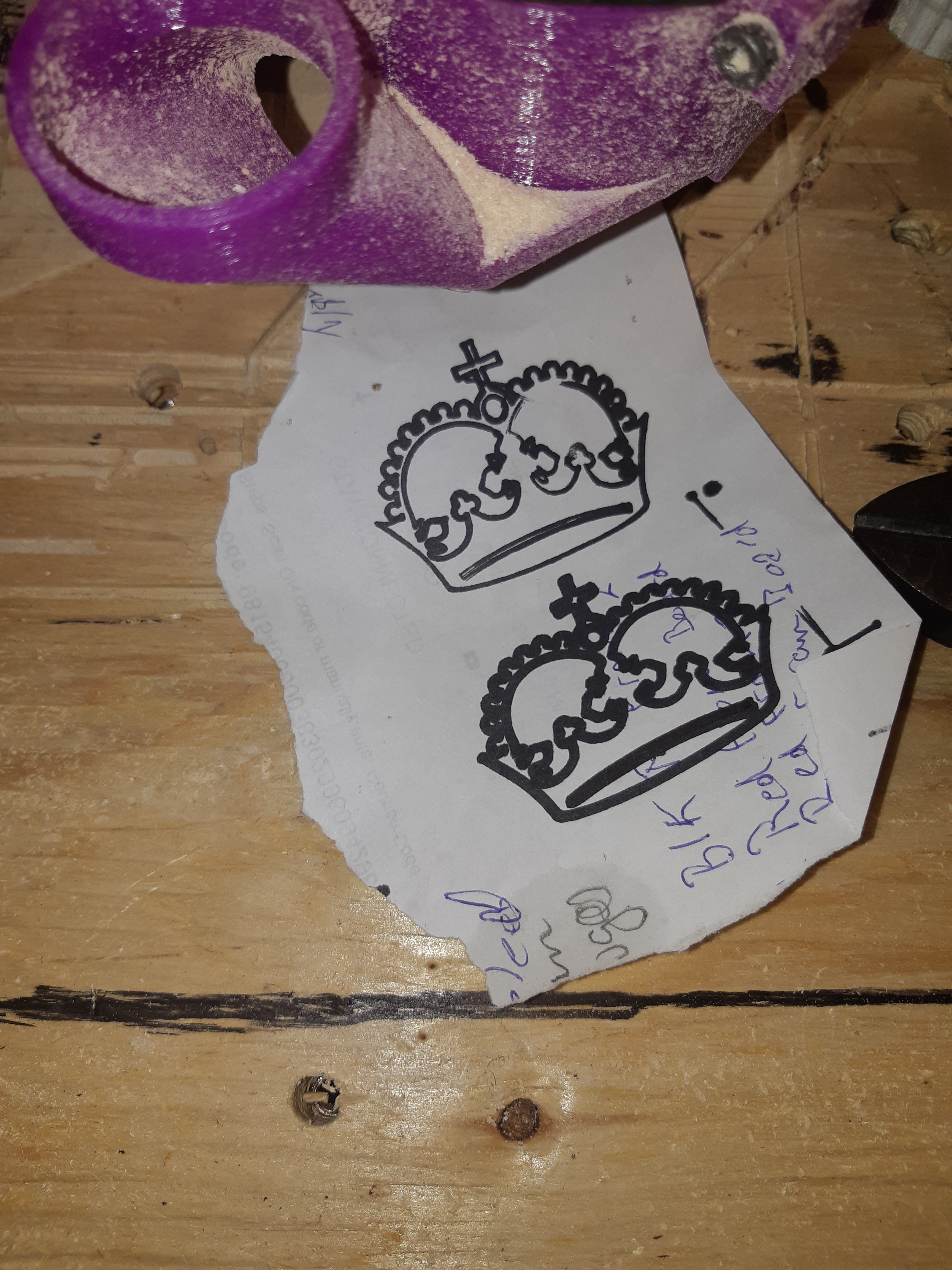

After I drew those crowns the first thing I ever milled was the parts for a lowrider so i could build one.
