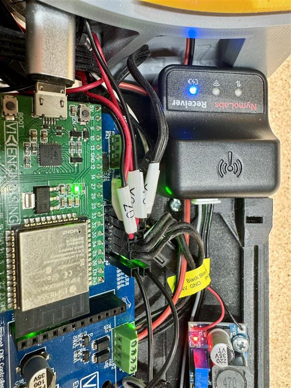

Receiver installed - three wires (GND,5-24v,SIG).

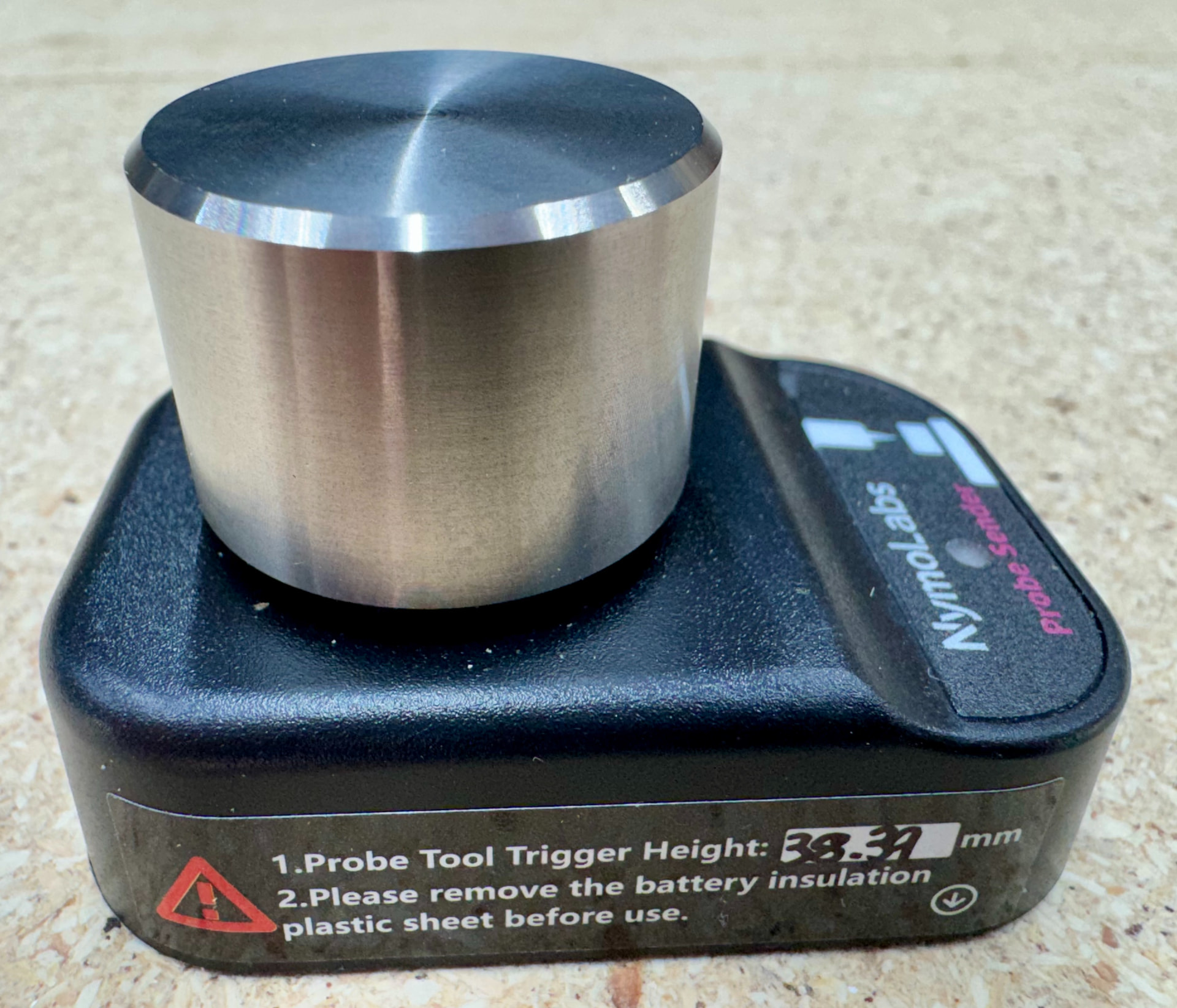

Can be mounted via double sided tape (included) or attached via the magnet on the back.
Transmitter/Probe - trigger height listed on side - worth measuring again yourself to make sure the numbers are accurate.

How you wire it to jackpot?

Wire the New Probe
Connect the three wires from the new probe receiver to the Jackpot board: Use the bare wire to JST plug included with the new probe.
  • GND (ground) → gpio36 - G (Gpio GND) (Lower Pin)
  • SIG (signal) → gpio36 - S (Gpio SIG) (Upper Pin) (Look for the row with the S beside it)
  • PWR/V-in (power) → 24V power supply input
Complete the Installation
  1. Plug the probe receiver into the plug you wired above
  2. Pull the battery tab from the new probe
  3. Gently press the probe—the Jackpot’s LED should light up
  4. Verify you hear an audible beep from the probe
Installation time: 5–10 minutes
Note: I wrote these instructions myself and had AI assist with cleanup and formatting. The content is not AI-generated.
Thanks for wiring info got it now.
Just a note I had to look at your Picture again your running a Jackpot1 the description threw me off for a minute ā€œtop pin, bottom pinā€. I’m mounting to Jackpot3for lowerider4, I have a Jackpot1 running a laser.
Yep, I don’t have one of those fancy pants Jackpot3 boards. I’m out here slumming it on my grandma’s Jackpot1 hand me down. :disguised_face:
Which is basically the same. :smiley:
Jackpot 3 just sounds much better than having a Jackpot 1.
Isn’t the Jackpot 3 three times better? lol.
It looks like the wiring instructions are still applicable to the 3 with the exception of describing the GND as being closest to the middle of the board.
On the 3, it would be the pin closest to the edge - still the ā€˜bottom’ ping for GND and top for SIG.
