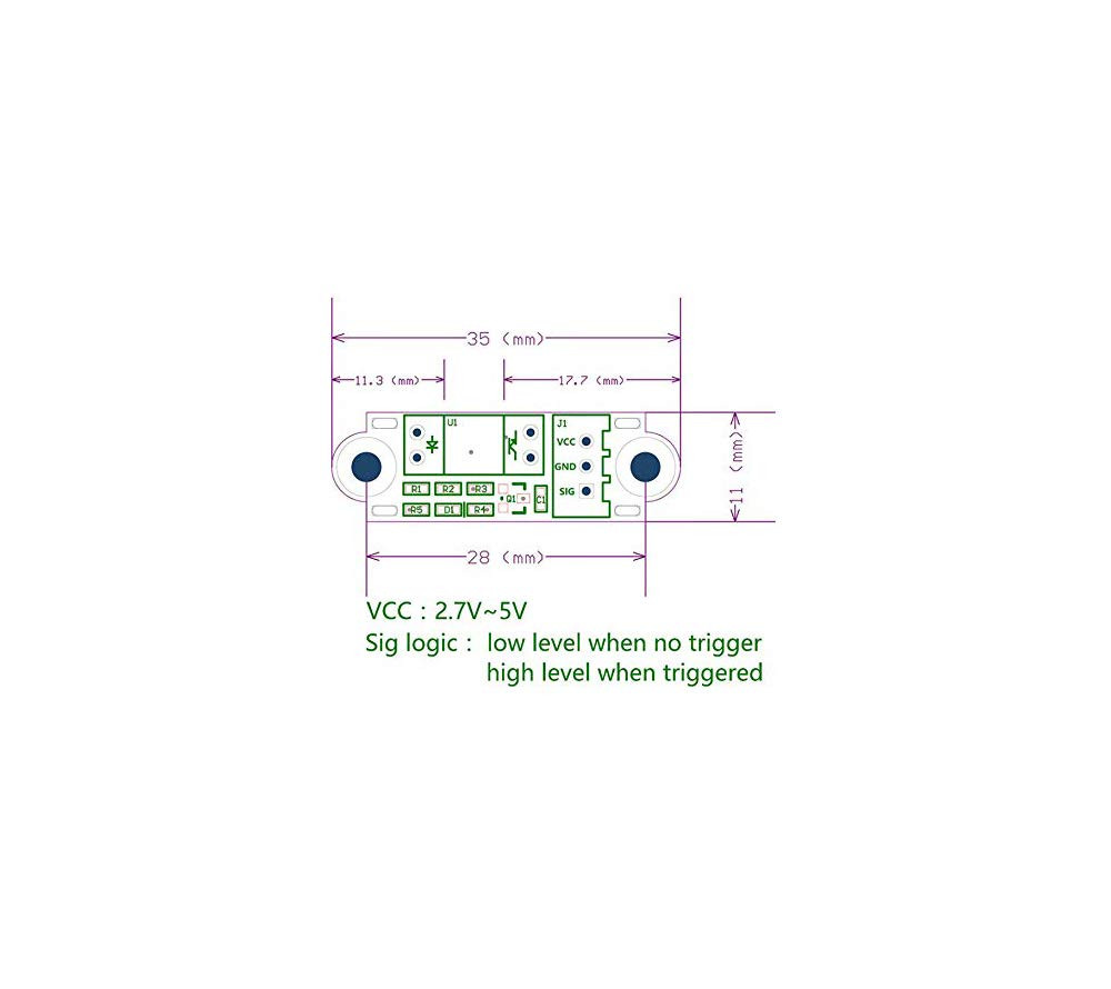

So I have already installed the Zen and tucked everything away all nice and neat…is there a pinout for the optical ends stops somewhere? I dont want to have to pull a module if I dont have to.
They look very similar to these I found on Amazon…can anyone confirm?
[edit to hold question until further testing is done cause I’m an idiot and looked for firmware configurations in the “firmware” section of the controller product page instead of the “controller” section]
They do look the same, and the pins are labelled on the back of the PCB in that same order, VCC, GND, Sig
