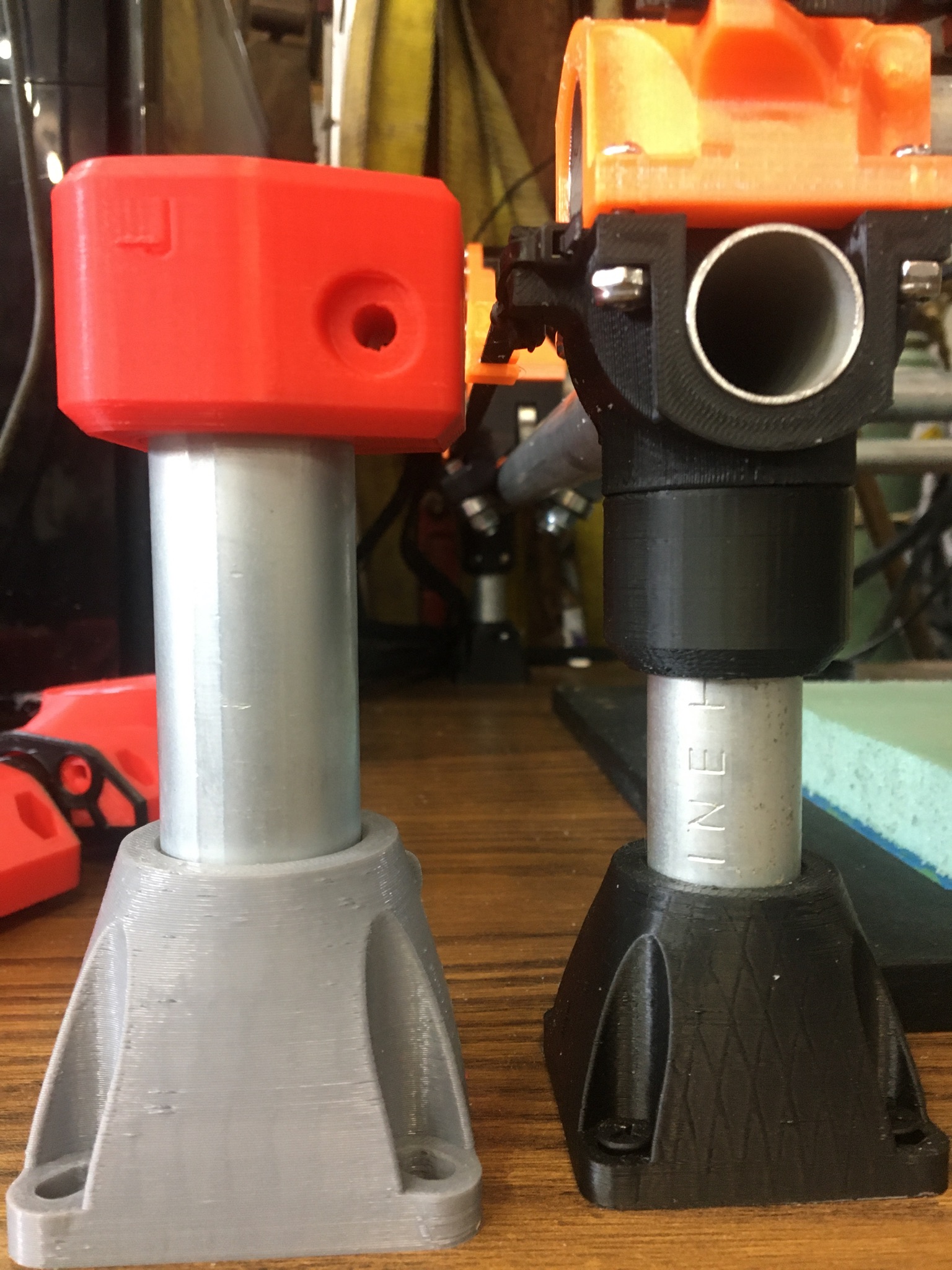

Well now you just hit on the downside of larger tubes…larger footprint, and slightly longer print times.
I think what you just said was good stuff?? Lol
I’m just shooting for a cheaper, sturdier, half-sheet machine, with the accuracy that the mpcnc can deliver.

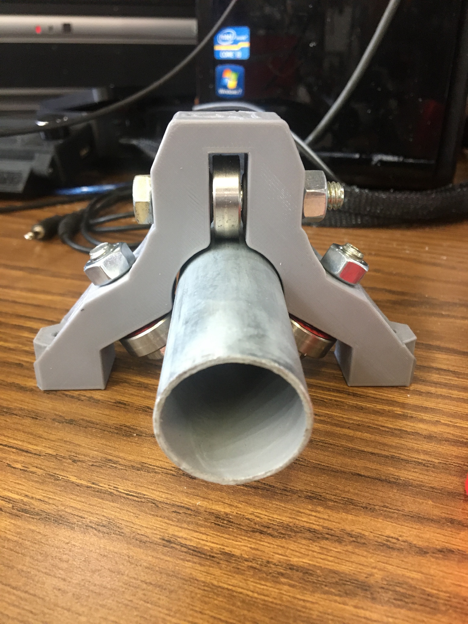

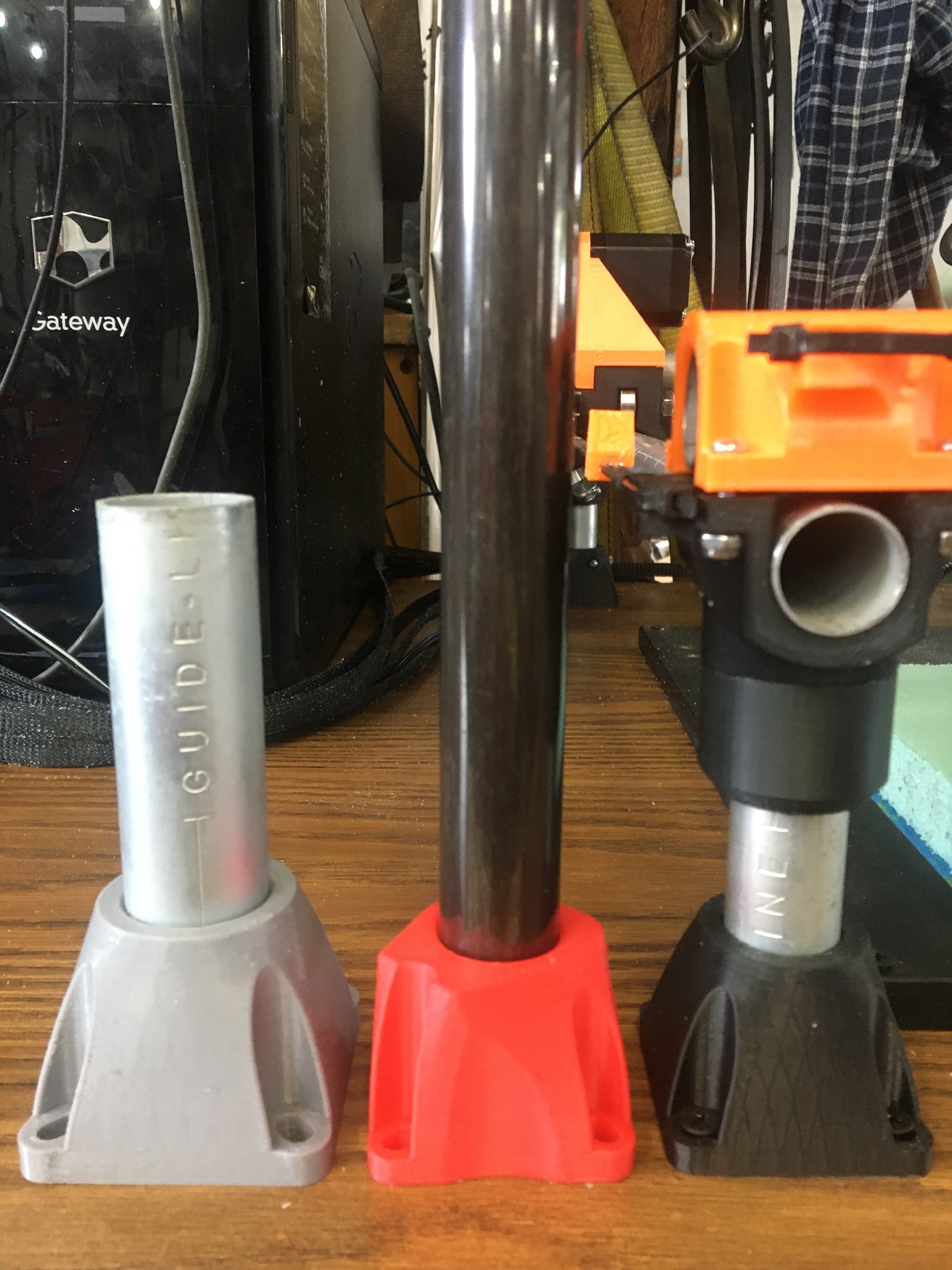

It just means you would need 1" EMT, if I go that way. Making a 3/4" version instead of a 1" just because you already bought the EMT seems a little unfair to everyone else right? I am not going to design and maintain 4 versions.
Of course. It seemed to me like the 23.5mm version was a foregone conclusion until recently, but if bumping up the EMT a size improves the quality of the machine, it’s hard to complain about that!
I was about to say I’d just make a LowRider with the 23.5mm that I already have, but that’s doesn’t appear to be an option. Any suggestions on what to make with it?
It’s worth noting, I’m still spending less than half the cost of the DOM, even buying the EMT twice!
I feel like it’s worth it for me to return or take a hit on 3/4" conduit in favor of the 1" conduit.

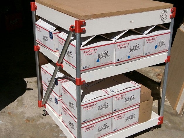

Lots of uses for conduit if you can’t return it. Lots of guys are 3d printing endcaps and using it is shop handles, the maker pipe Tony linked, I have a piece as a sledge handle, you can always make a burly with it, I even have parts you can print similar to maker pipe I use to make rolling workstations with on thingiverse.
