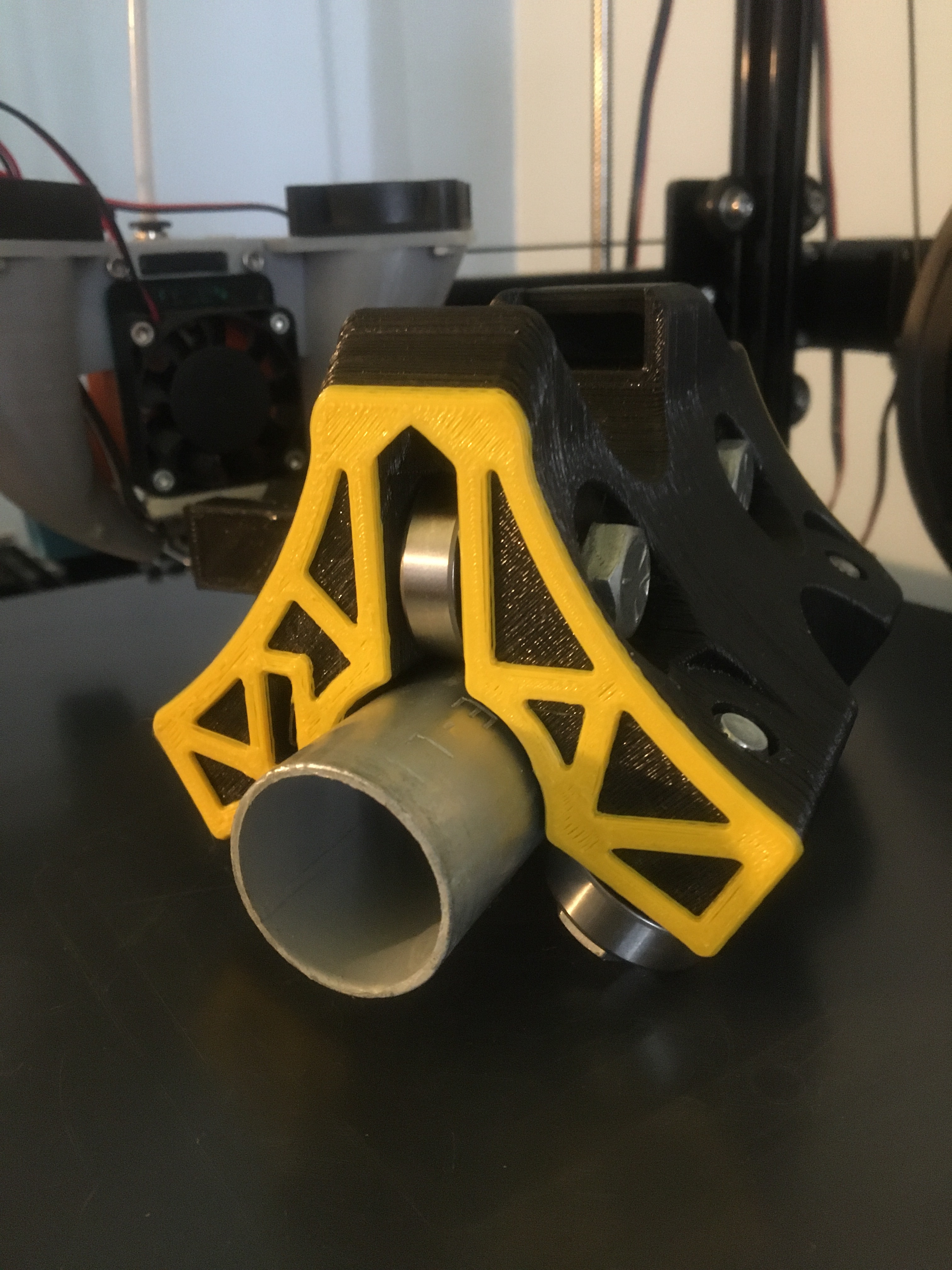

Core printed, was pretty close to my last part. Started having some serious artifacts at about the 80% mark (where it seems a lot of people had failures). Had several layers either skip the perimeters or print sections of them over thin air, and there was a tiny .5 mm layer shift at the top as well.
Other than the visual issues, it actually feels pretty sturdy still.
I’ll probably wait for some better quality filament to arrive and try a reprint, though I might try an initial assembly with this (unless y’all think it would be a complete waste of time)
I’m going to go in with a 3d printer pen and add back in the perimeters where they are missing, and hope that I can assemble it.

If you want to check out the build, it will be kinda okay. The end result is a Z axis that leans and who knows what will happen to the gantry rails. Unfortunately that is a pretty critical piece in terms of accuracy.
In that case I’ll do some printer tuning and see if I can’t get a better one to come out.
