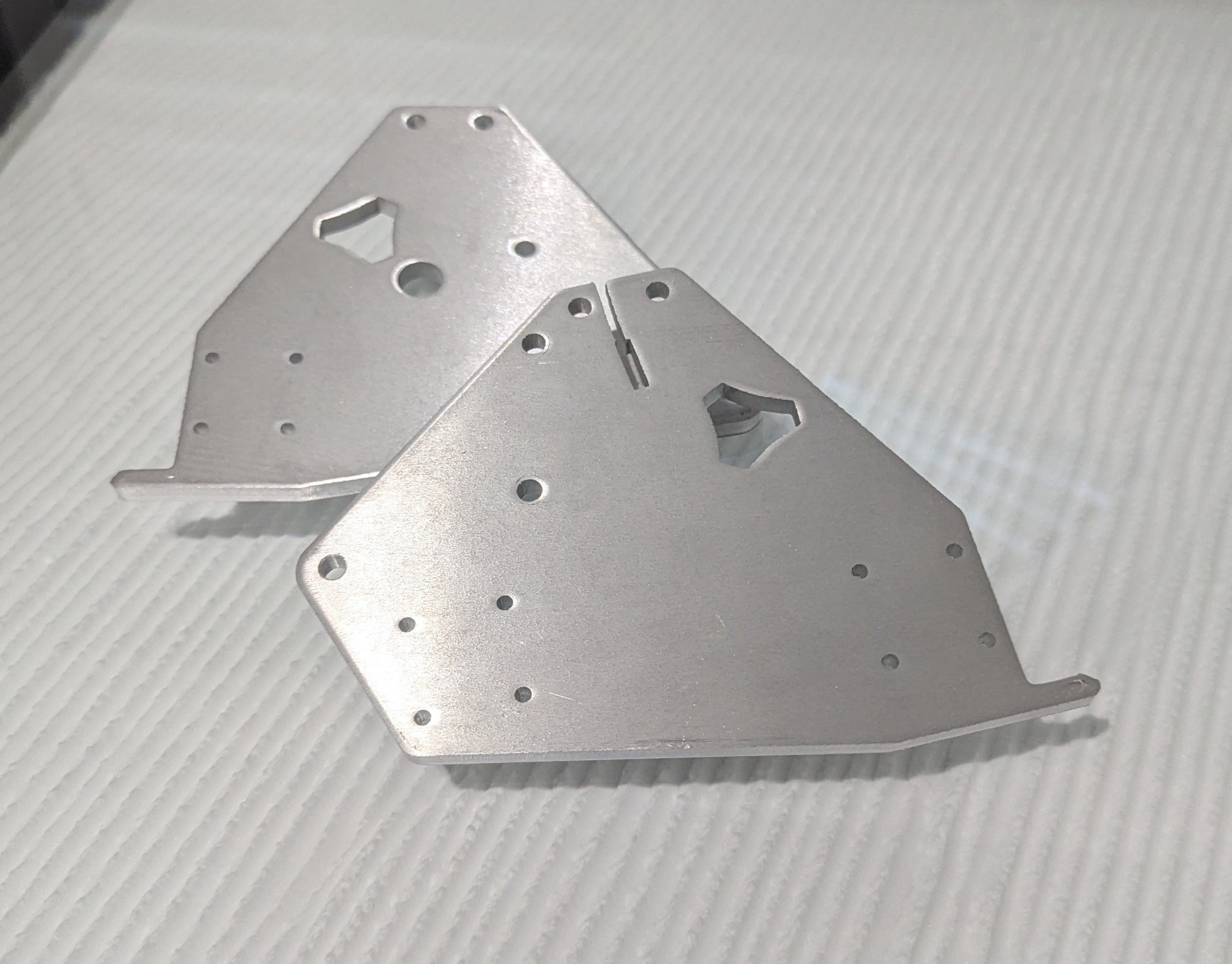

Yep! I gotta piece strut plates together because my Y-axis is shortened. I guess I got ahead of myself with cutting the XZ plates before strut plates. I figure nothing beats a failure but a try? :woman_shrugging:
You are adventurous. I’ll give you that. :laughing:
We are about to get some settings so we can add this thread to the Al tag and get more people cutting their own with printed plates!!!

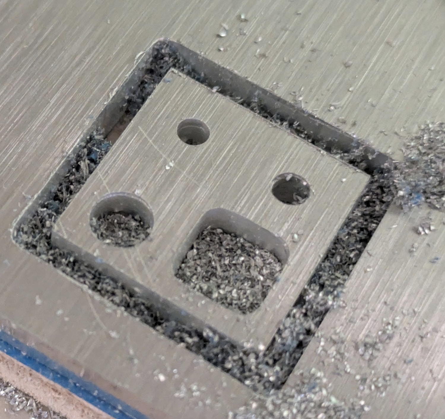

It cut great with aluminum this time! I used the following settings, following the recommendations @vicious1 made up-thread:
1/8” V1E.com endmill
200 mm/min feed and plunge
0.25 mm step over
0.5 mm step down
no coolant
same dull-ish endmill as before (I just wanted to see how it would do and if it was totally ruined, it still felt pretty sharp)
The bad:
It looked great coming out of the board, but I think my work-holding arrangement has some play (superglue and painter’s tape) which led to some parallelogram results as Z went down, and also I think I probably need to re-figure my steps-mm because the part isn’t accurate. It should be a perfect square 1” or 25.4 mm in width and length, but instead it’s ~24.5 mm in the X-axis and ~25 mm in the Y-axis.
It cleared chips like a champ, never got bogged down. There was probably some deflection and chatter, especially when starting out a straight plunge cut for the 1/8” holes on the test 1” square I was carving.

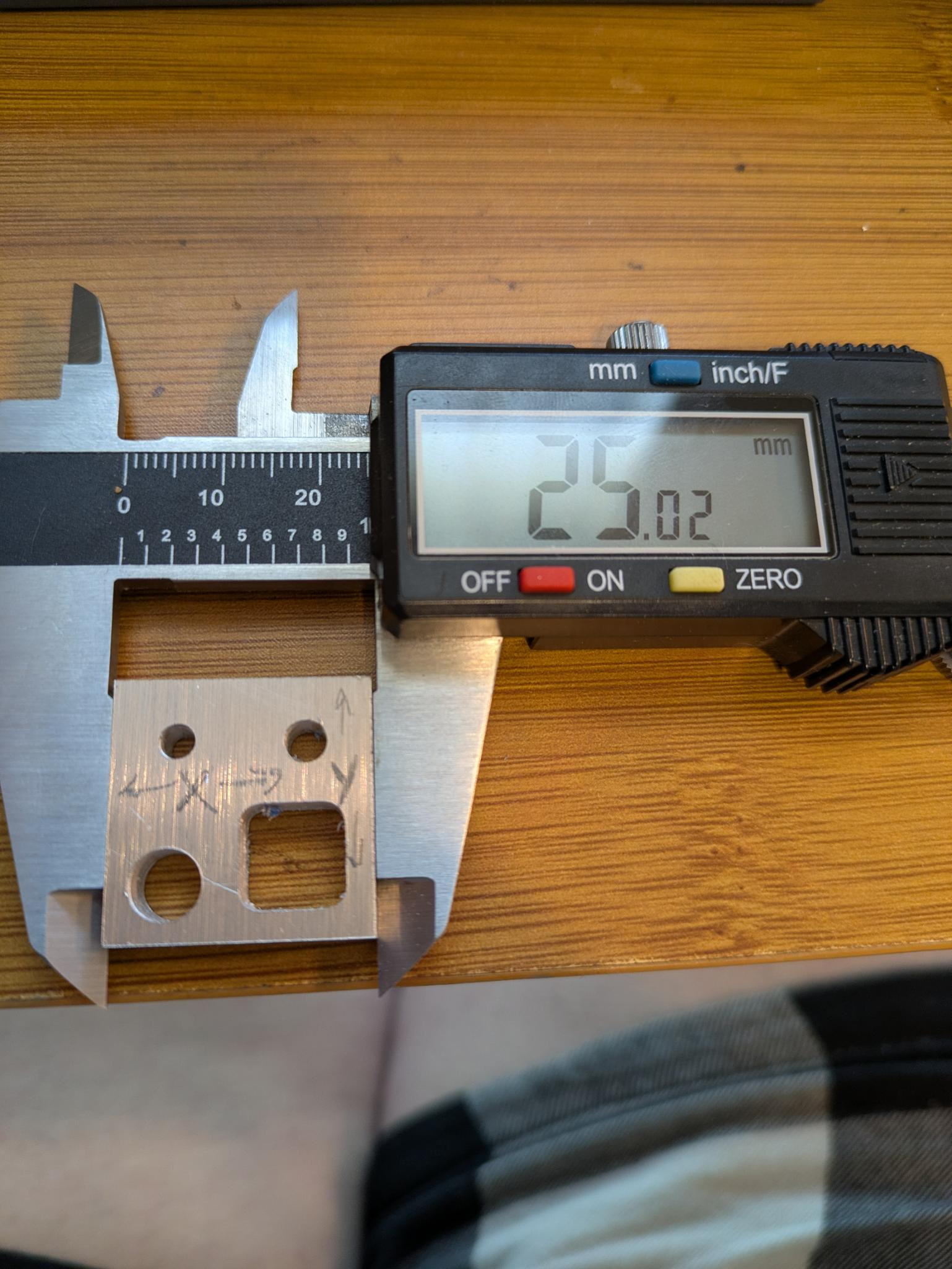

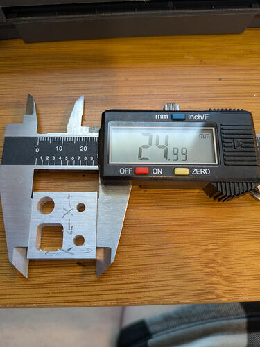

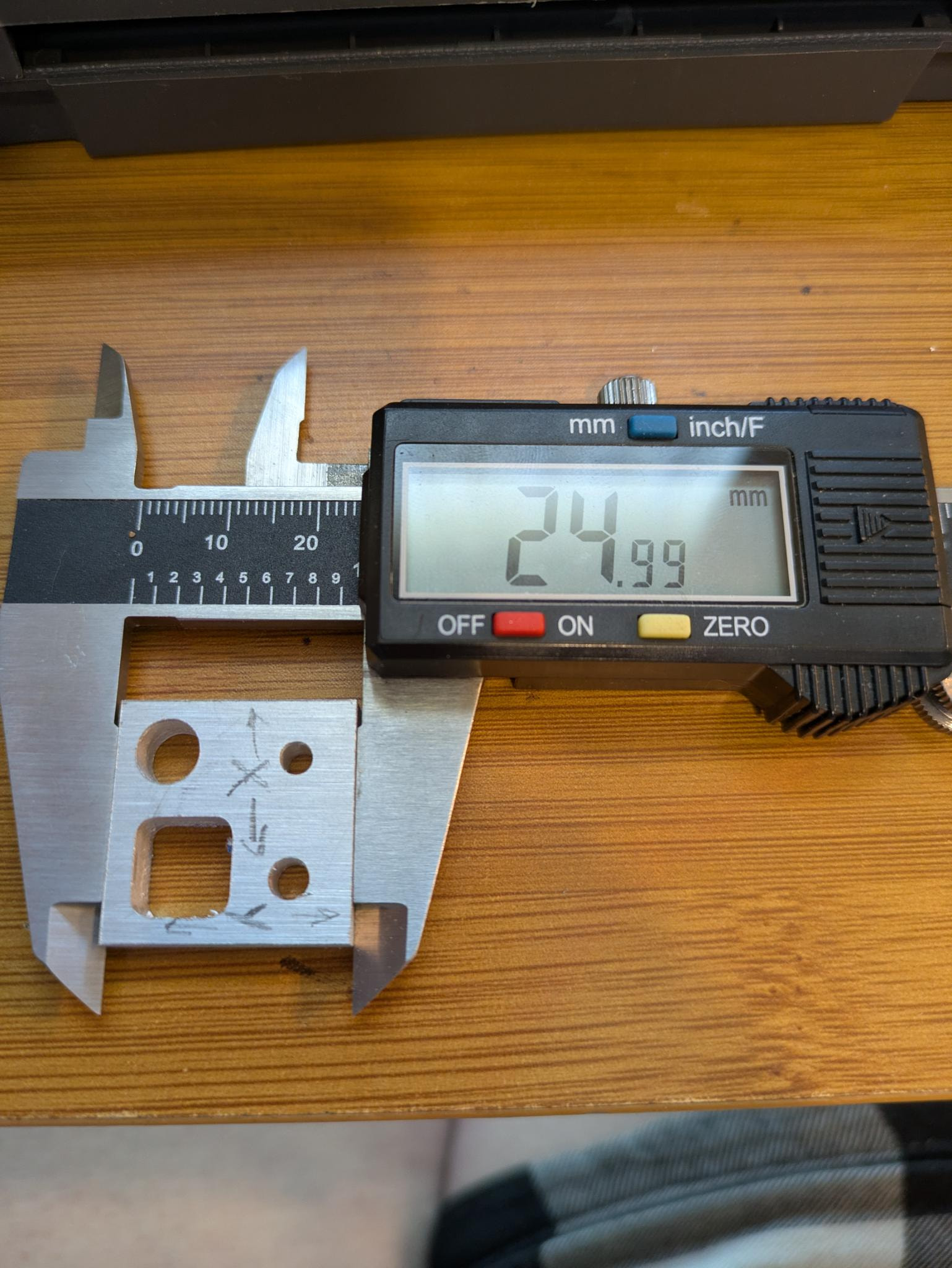

Progress still, but not quite there. I’m seeing about 0.4 mm of error after re-calibrating steps/mm for both X and Y following tightening the belts. The part did come out pretty square though there’s a tiny bit of skew and play I can pick up with my most-accurate (non-engineering) square. I hadn’t re-done my skew fixes from before, just steps/mm, I’ll do that before the next test-cut.
Do you all think I just need to continue to dial in steps/mm? Maybe I need a more accurate measurement from dot-to-dot, I’m using a metal carpenter’s yard stick. Perhaps there’s some error in there I’m translating to the machine.

You know, I think you’re all right, but also I think @azab2c nailed it with checking the tool. For some reason I had 3mm flute instead of 3.175 for the 1/8” endmills I got at the shop. I think that’s probably introducing the error on every side, leading to the .4 mm error.
I’ll try one more cut with the correction, and maybe also try to nail down a finishing pass if I can figure out how to do it. That should put me in the ballpark for pretty darned accurate, and then I’ll cut the plates. Woohoo!

LMAO, OK I’ve got feeds/speeds/etc. down. I figured out how to do a full-depth finishing pass in KiriMoto even! And now that I’ve a) set up the finishing pass to increase accuracy and b) adjust the cutting edge of the tool from 3mm to 3.175 mm (1/8”)…the error has now moved from being .4 mm under in X and Y to ~.45 mm over in each axis. For today…I give up :smiley:.
