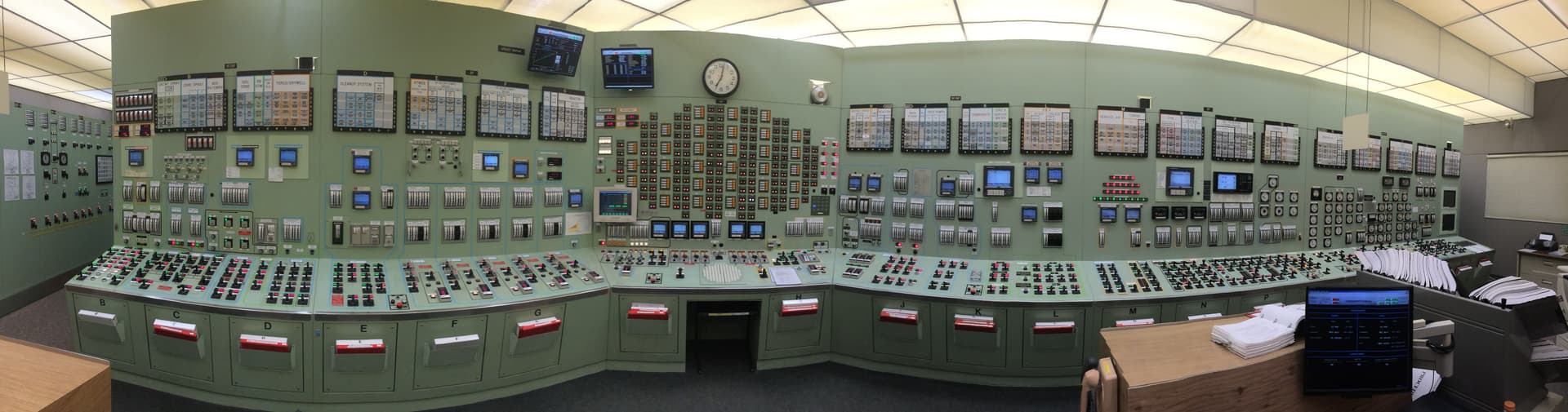

Also: I always push all the buttons to see what happens. :smiley:
Kids… :man_facepalming:
You would have loved my last job!
