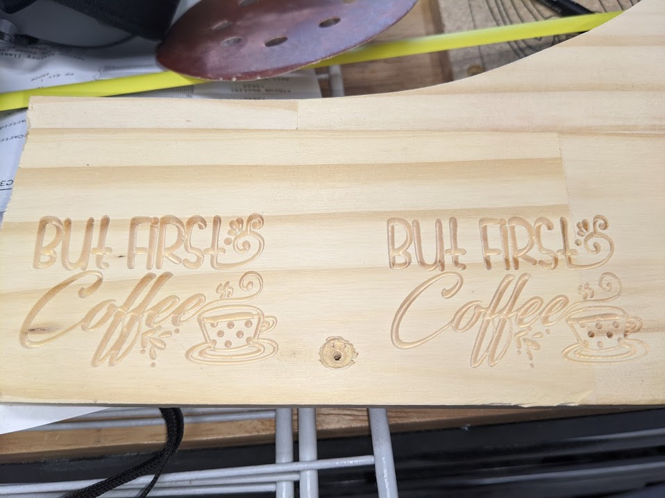

Ok, got the holes drilled into my spoil board and I made a few 1/4 inch x 1.5 inch steel dowels to use as pins to wedge things against with shims when cutting. So far everything appears to be working great, here’s a photo of my successful attempts:
Each iteration of that sign is about 1.75 inches tall and about 2 inches wide.
