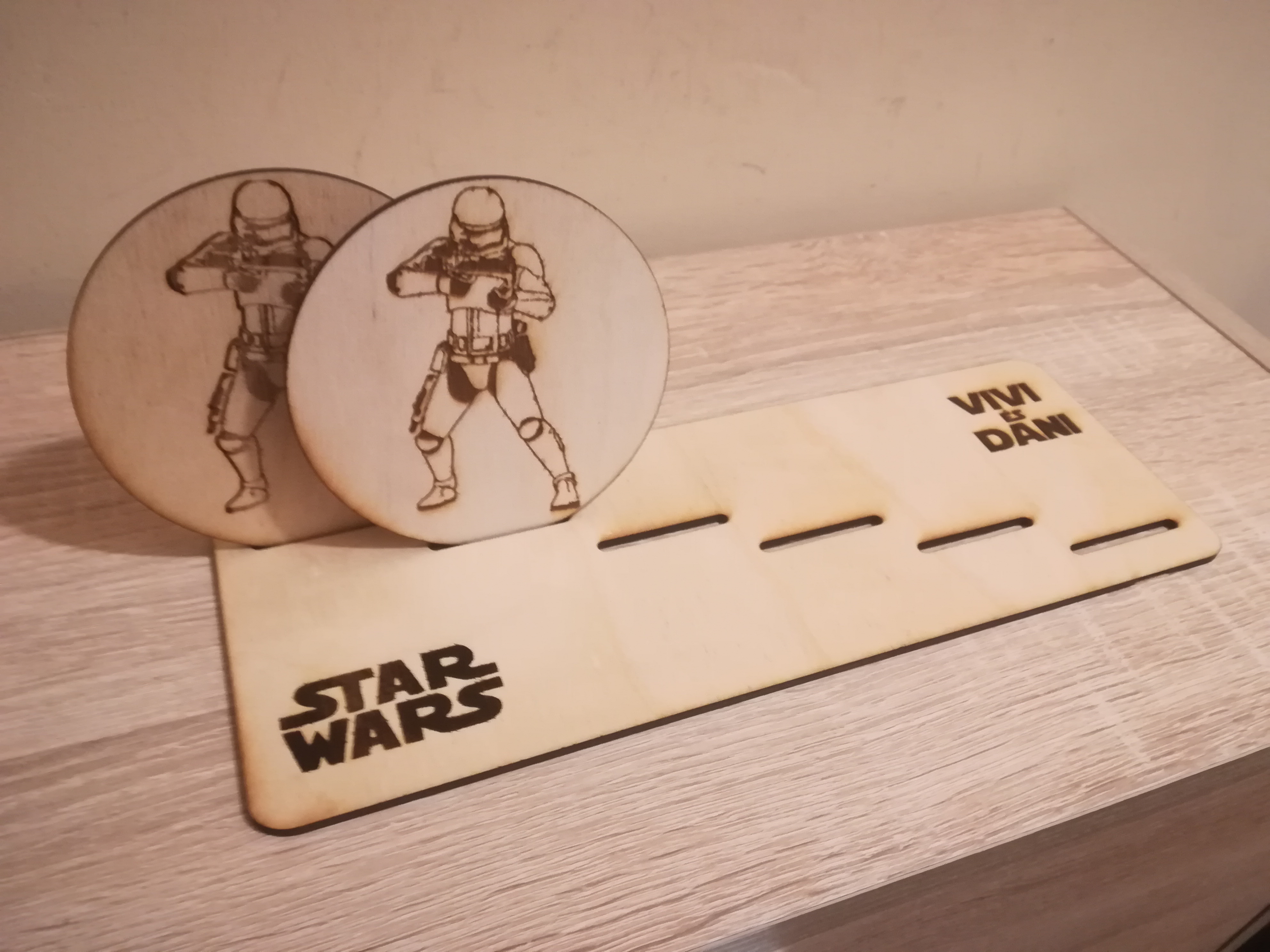

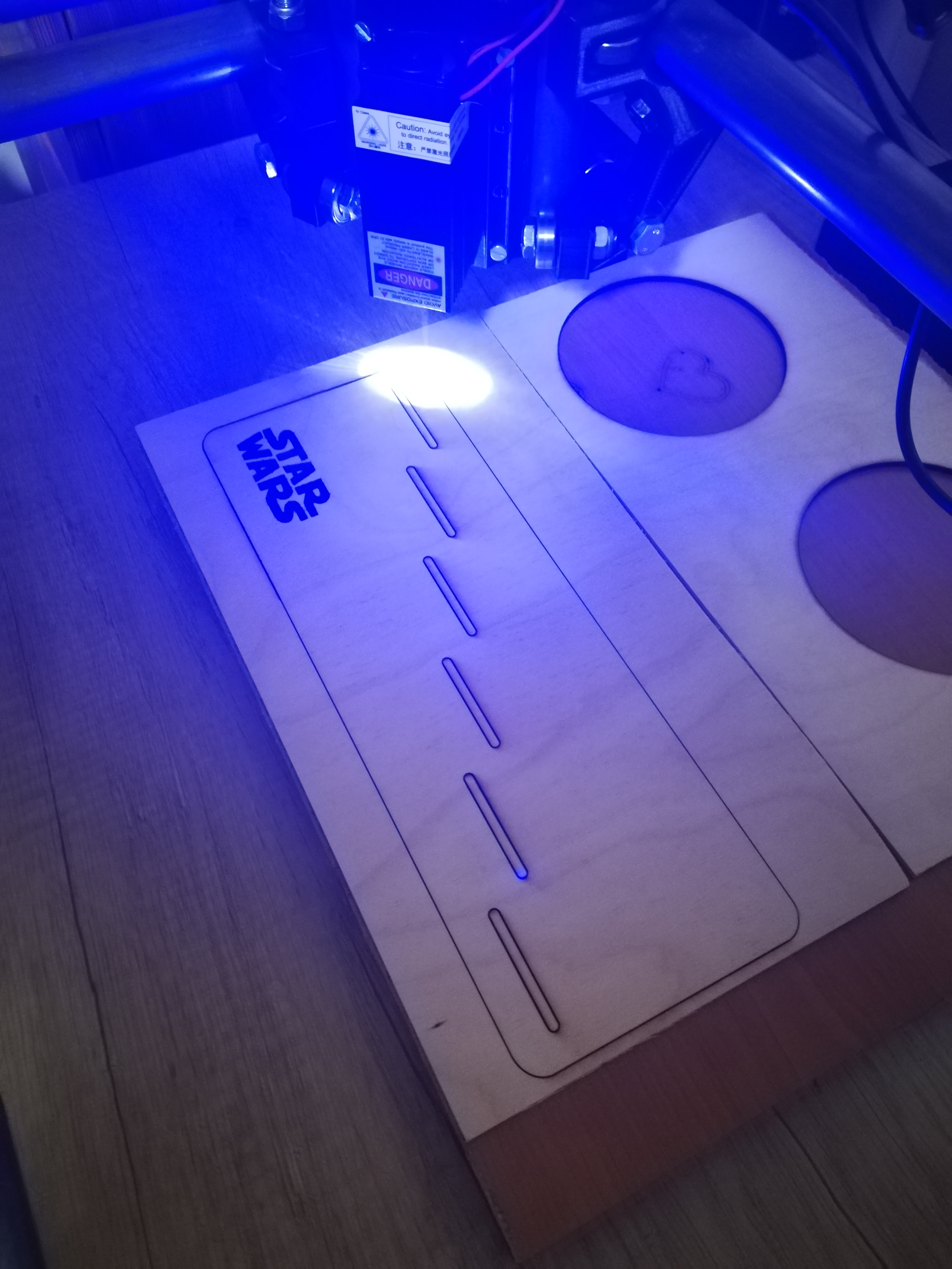

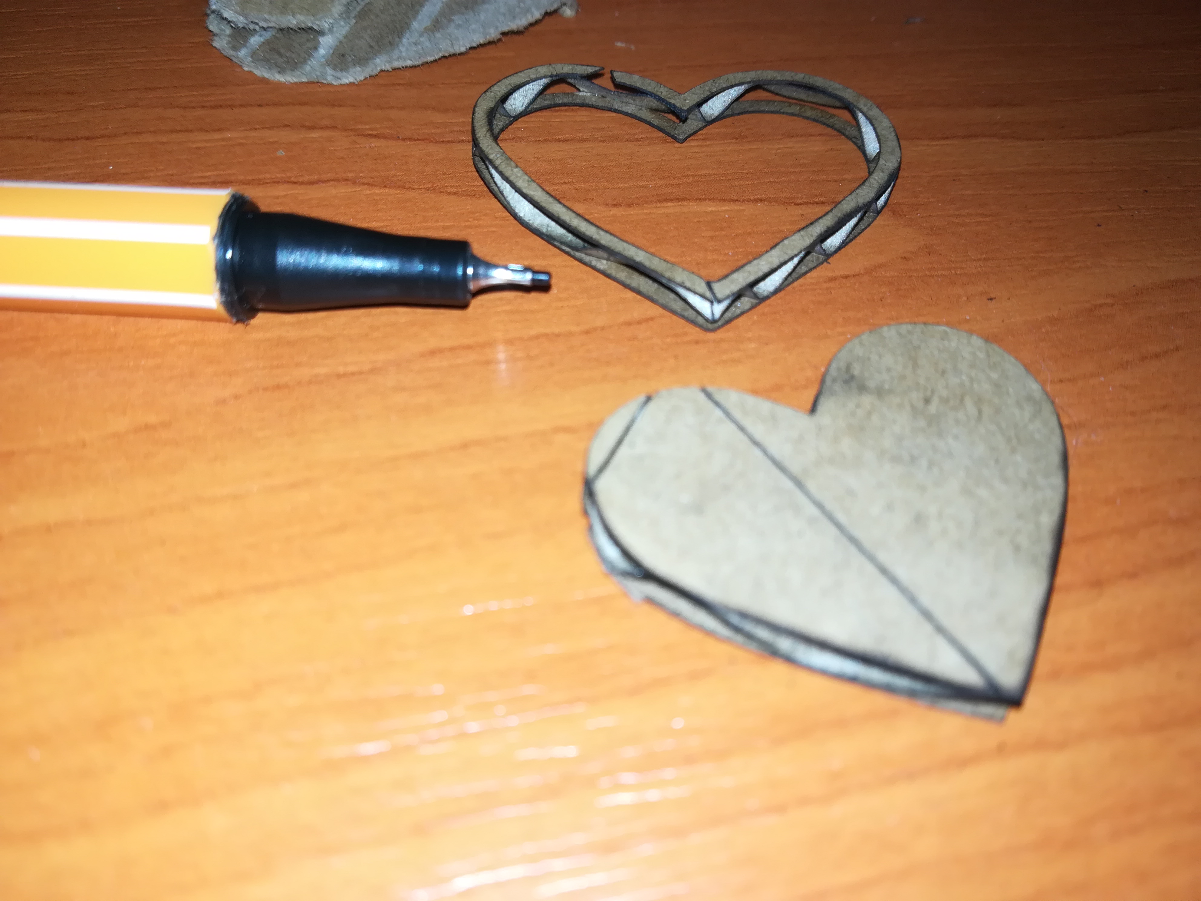

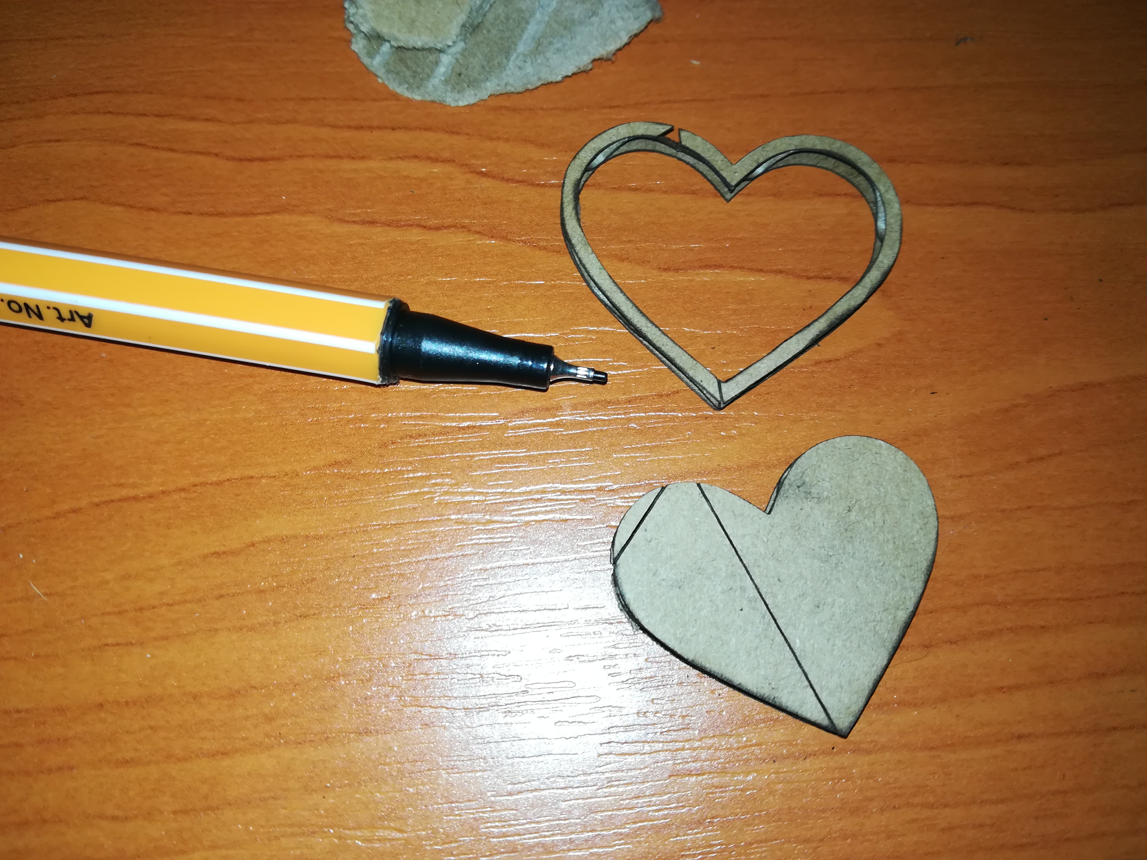

Ohh and before I forget: we already cut some wood (3mm, plywood) using LightBurn.
I’d really like to cut wood with a laser as well later on. But that’s for a time when I didn’t just blow my money for a 3D Printer and a Primo. :stuck_out_tongue:
Yes, yes we did. A Hungarian Sheepdog named “Dog” in Hungarian. We just knew that there were very few Hungarian speakers in New Orleans, Louisiana in the early 70’s. At least, that we were likely to run in to. Also, he was doubtfully anything near a purebred Puli, but certainly enough to warrant calling him one if someone asked what kind of dog he was.
Szep munka

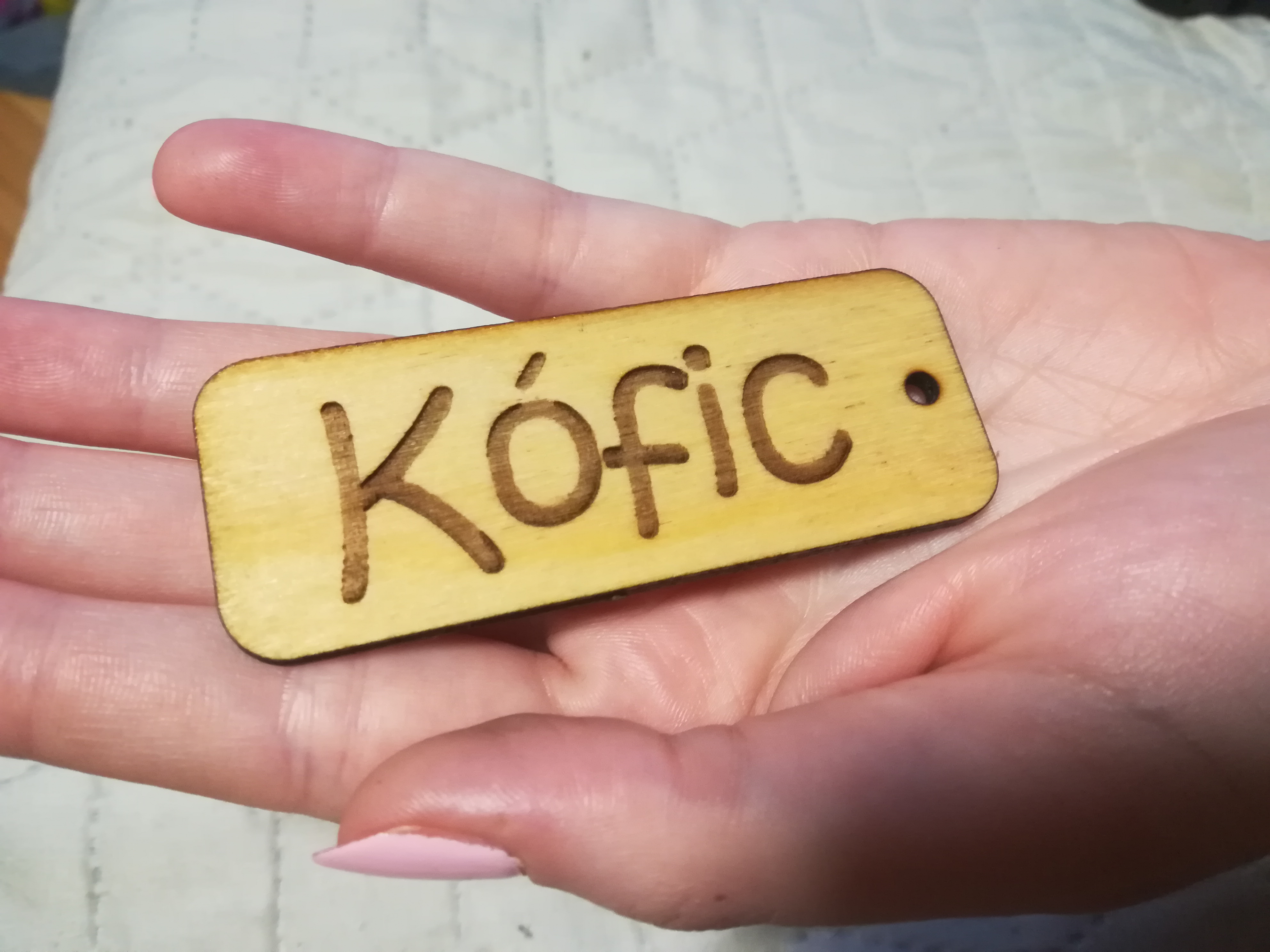

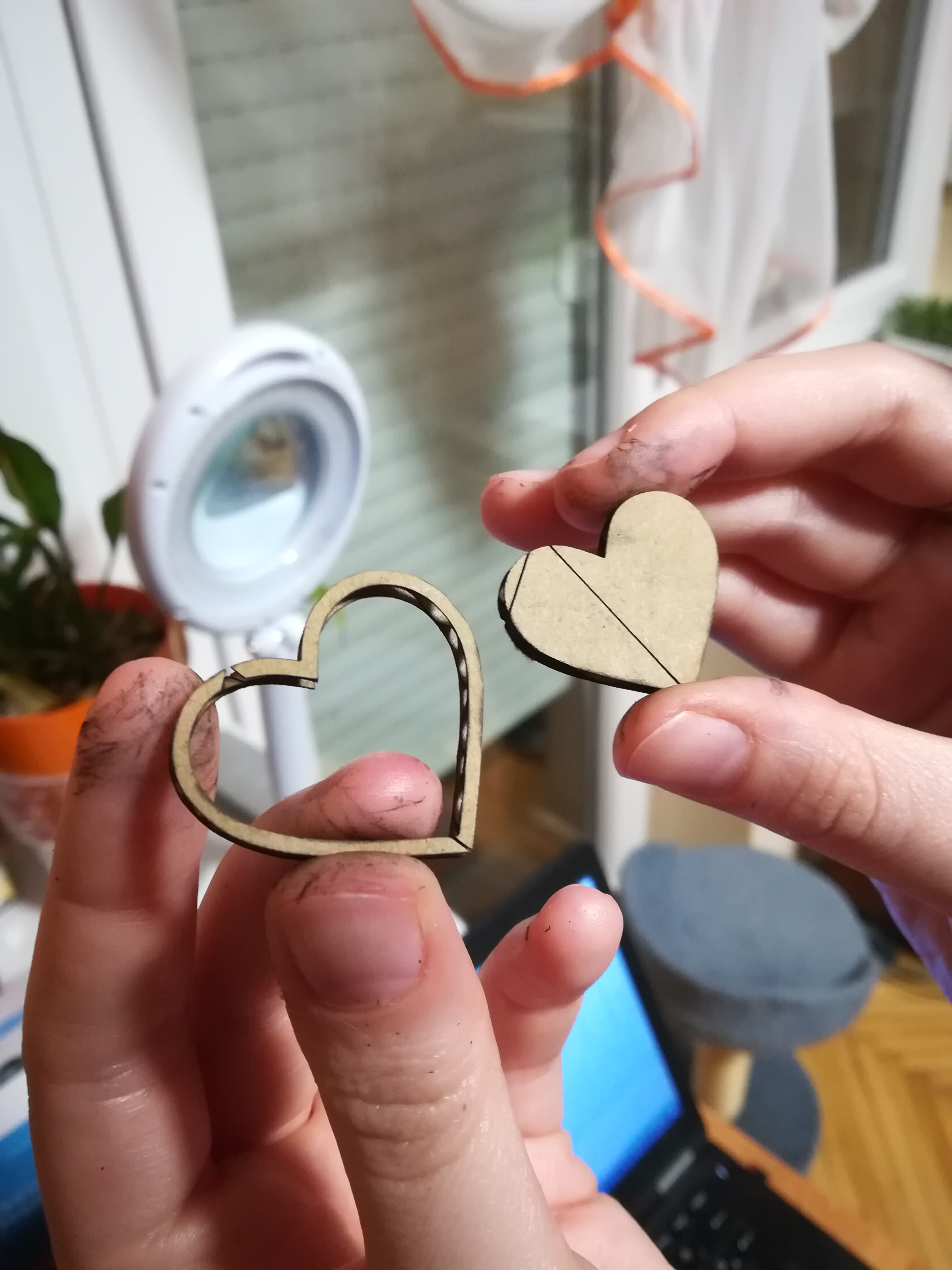

Laser? Looks great very detailed

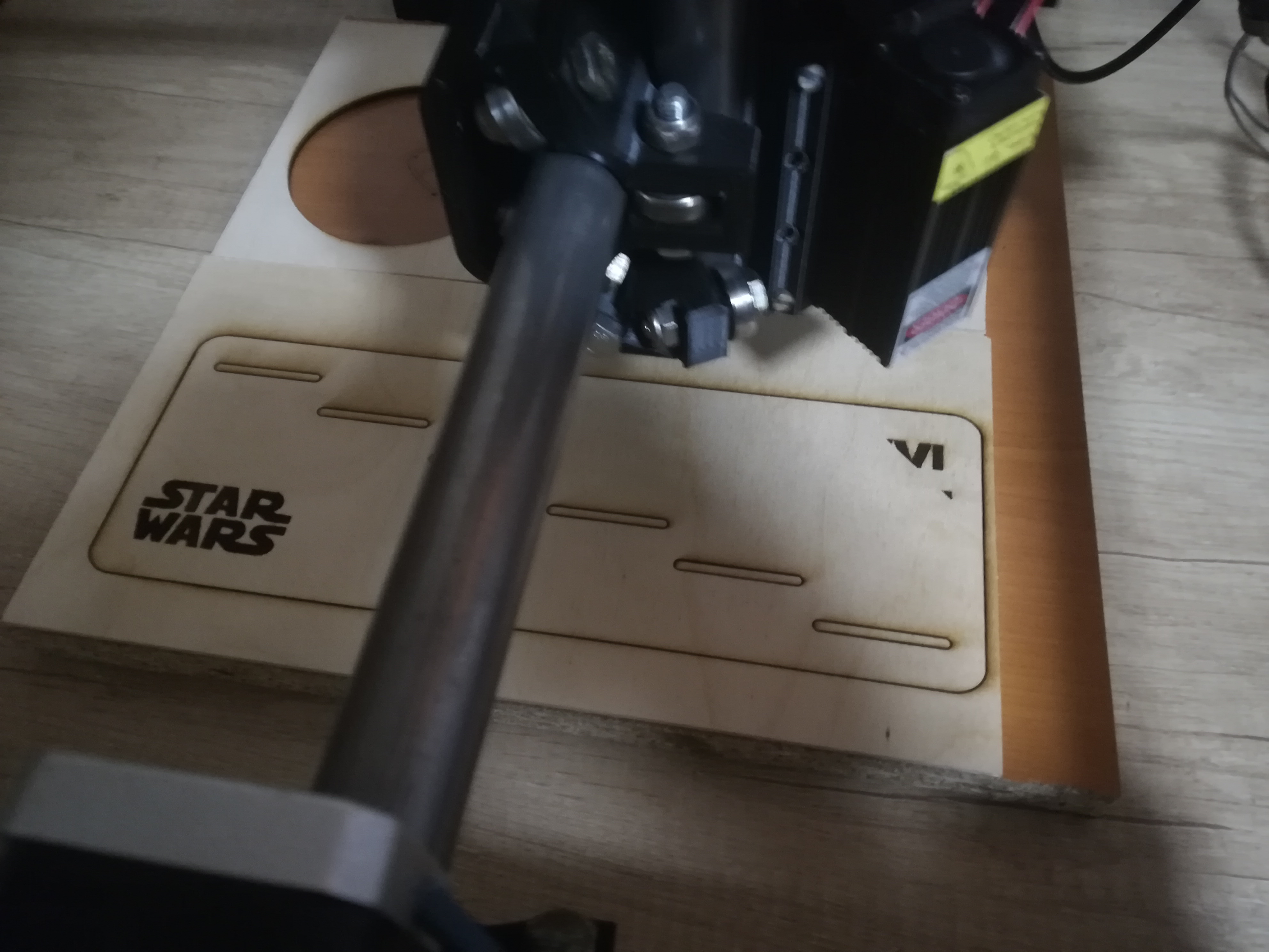

Yes. 5W laser, 300 mm/min, 10 passes.
Material: 3mm plywood. Focus: 1.5 mm into the wood.
Extra: air assist. Without air it’s impossible to cut through consistently.
