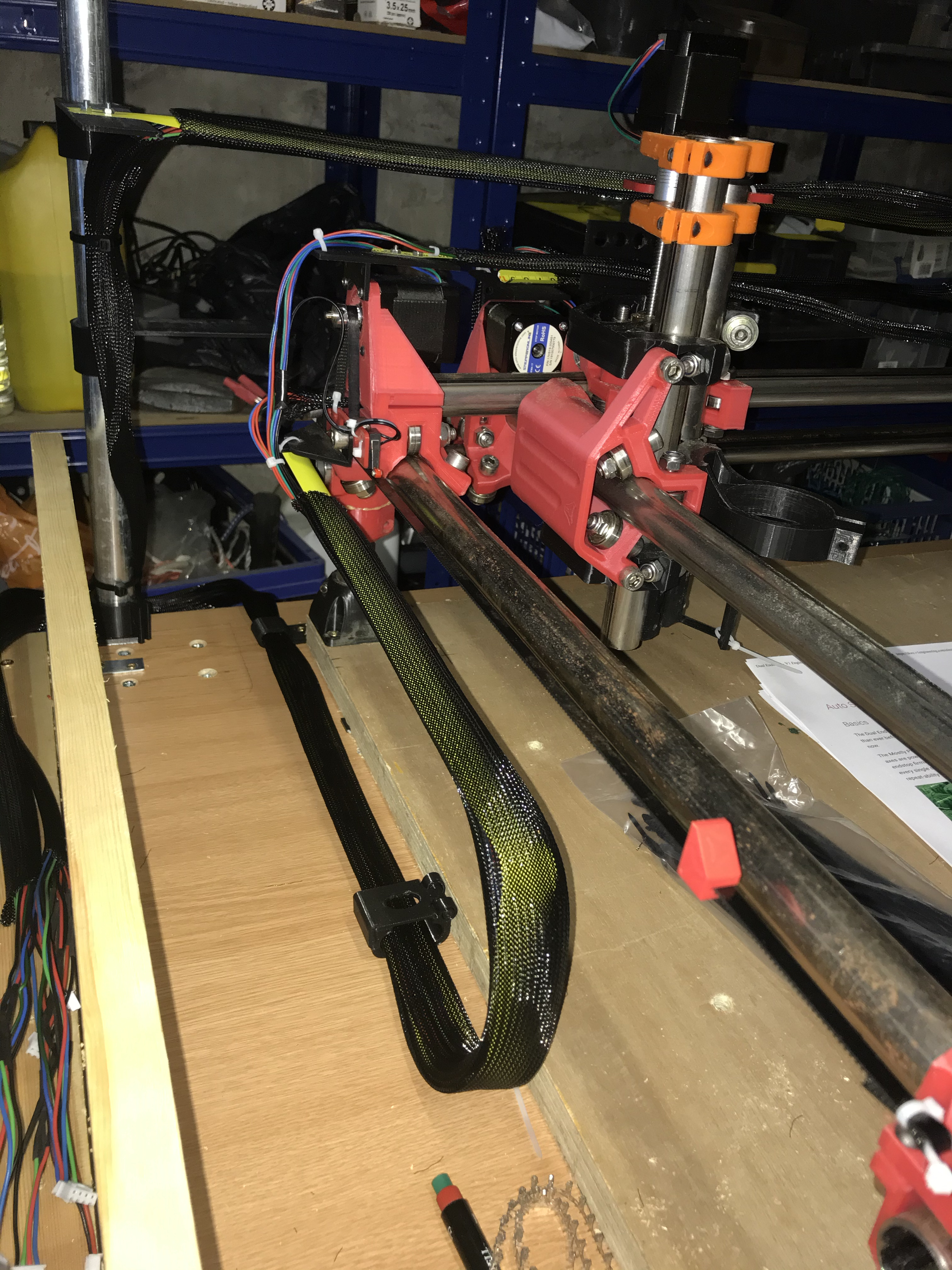

It’s been a long time since I updated this thread (two weeks). Somewhat surprisingly, I have actually been busy getting my MPCNC into a better state.
As can be seen from the attached photos, I now have a steel set of pipes to make a simple and strong top enclosure to keep the dust down, this will use hardboard (or plastic sides) that can clip on and off using Terry clamps. Whilst many people here (probably all the people here?) would have successfully made this from wood, my exceptionally limited skills lie in using Allen keys, cable ties, side cutters and simple pipe cutters. BTW are they called Allen keys in the US?
Anyway, the other reason for the steel tubing is that I can attach a vacuum hosepipe to the Z axis AND reduce the load on it. I was worried about torque on the Z gantry. I have an idea to support most of the weight of the hosing using the steel pipe frame.
I also wanted to use the steel pipe frame to move all the wiring off the CNC top, this allows me to slide in longer pieces to be CNC’ed as there is now a clear run all the way down the X axis. I’ve used the ‘tape measure trick’ to keep them supported. I also have been learning Fusion 360 and have done a few simple prints to provide Z axis guides and other supports for wiring as well as P-clips that are just the right size for me. I have to say, even as a complete novice (and some would say muppet) with Fusion 360, I can produce quite complex pieces with limited skills.
I also took the opportunity to revisit all the wiring and the various connections as:
- My life is not miserable enough. See previous posts on why wiring and I have a very special relationship.
- The wiring lengths were all wrong and I wanted them to be the right length. No, I am not OCD (though I sometimes wonder
) - I wanted tidy wiring. See point 2 on OCD.
I had printed a set of drag chains and the dust they collected was awful so have moved to nylon expandable braided hoses as well. That makes things a lot neater and needed the P-clips.
I have moved the control board outside the main CNC frame so that it keeps it clear of dust and debris. This also cleared some more space on the main board to hold the MPCNC, one lesson I have learnt is not to cram too much into the limited space.
The astute amongst you will notice the lack of SKR V1.3 motherboard, it’s taken off so I can print some covers.
End stops are now wired in and working, but not calibrated. Finally got that monkey off my back. Am trying to understand what is to be done and how it all works. For some reason, the words don’t make any sense.
Learning points:
- Don’t try and thread cables connected together by cable ties through nylon braiding. It’s difficult.
- Doing the wiring loom for all the cables so far in advance is stupid. Work out the actual lengths needed and then do it closer when you can lay a cable trail through the MPCNC and get a better idea of where they will run.
- Drag chains look really cool, but are a nightmare to clean when you are milling MDF board.
- Write on permanent pen on the JTAG connectors where the cables are from. Whilst keyring tagslook nice, they are a pain to thread through braided hose.
- If you cut the braided hose, use a flame to seal the ends to stop it coming apart.
- Get bigger braided hose then you think. Makes it a lot easier to manage.
- Designing and printing your own P-clips is dead simple and they ensure that things fit. Fusion 360 is worth learning and is free (for my use at least).
- The sprung steel inside a tape measure is dead easy to cut with a Dremel and can be punched with a simple bradawl. The tape measure edges do need sanding down afterwards though.
