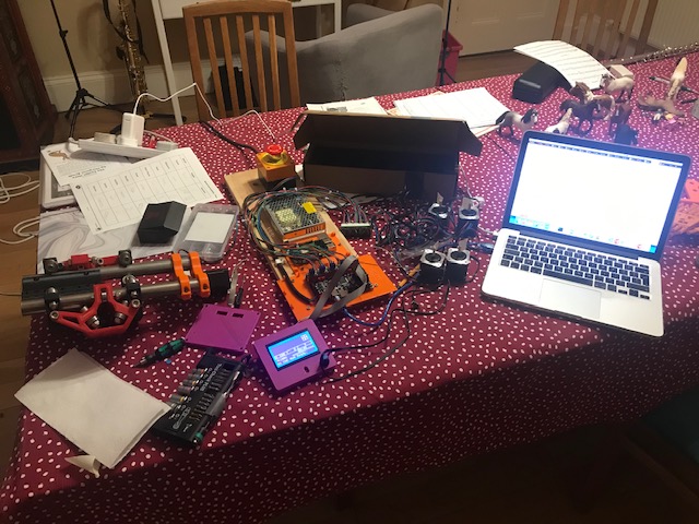

A quick sanity check on end stop behaviour if I may.
I’ve wired all the end stops in using patch cables for two X end stops and two Y end stops.
I think that I now go to the Marlin firmware->V1 Custom Menu->Home X&Y
I select this and both my X motors rotate in different directions. That looks right.
I close the end stop for one of the X motors and that motor stops.
I also close the end stop for the other X motor and they both stop and both reverse a little bit.
I then repeat the same for the Y motors, one stops when I close a Y end stop, I close the other Y end stop and they both stop and reverse a little.
I think this is how it should work.
M119 reports that all the end stops are then open as I’m not keeping them close. I am also assuming that TRIGGERED in Marlin means closed.
I have a feeling that this is all working, but it would be good to get confirmation before I start building and wiring things.
Many thanks
Rob
Correctamundo! :+1:
Thanks, now to look for the gcode for the Crown test and see if I can load into Macpronterface. I’m assuming that I can do that … :slight_smile:
Rob
Downloaded a crown.gcode file and loaded it into Macpronterface anbd told it to print.
No homing set up as the motors on the dining room table :slight_smile:
Motors started turning, the Z motor went up and down a small amount, X and Y motors kept turnng in unison but there did seem to be a pattern of activity.
I think it’s now working properly or at least as much as I can test on the dining room table. No idea if this translates (no pun intended) into the real world, but that’s a problem for a different night.

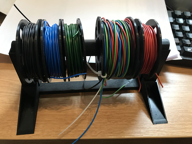

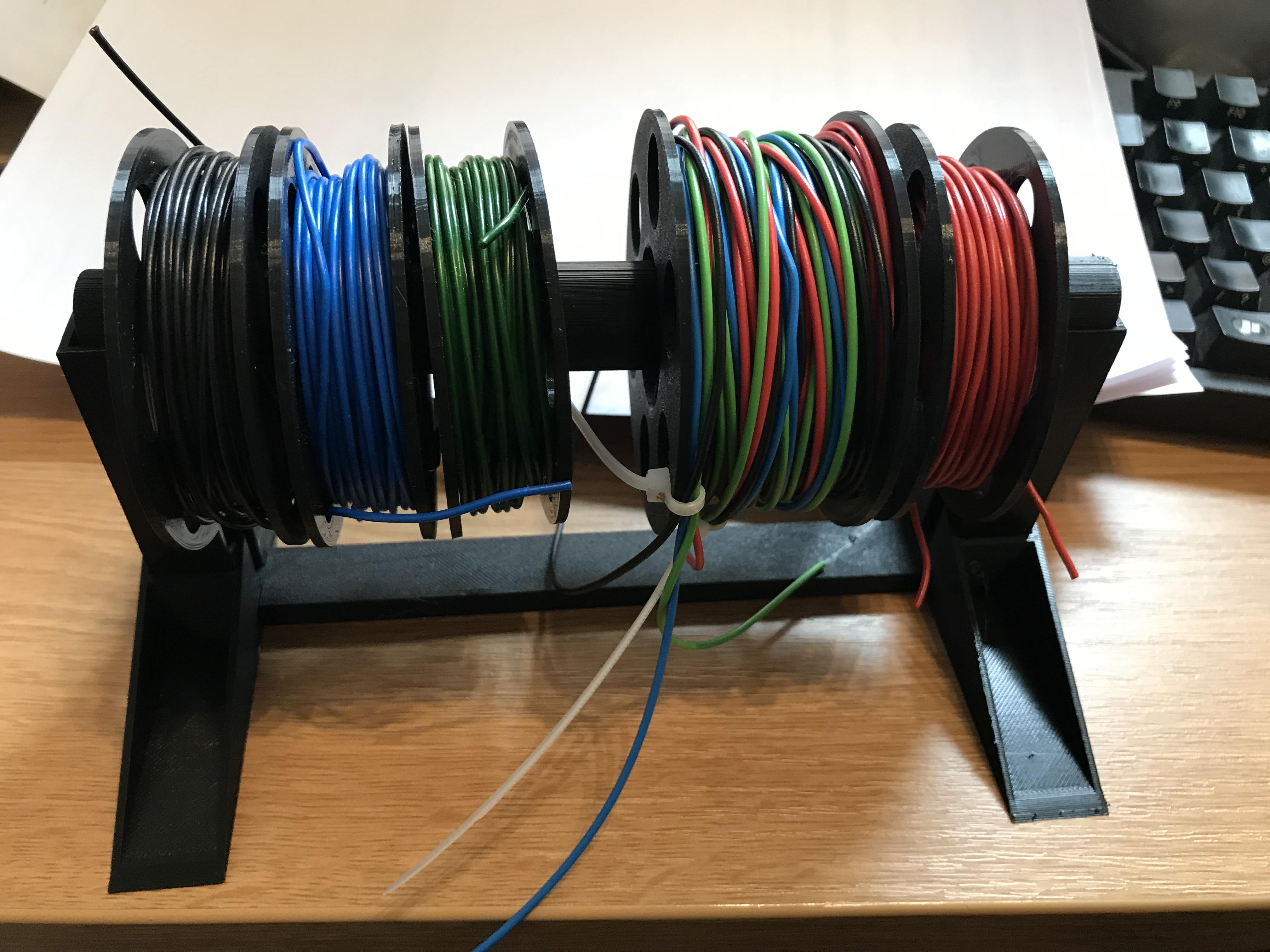

To help me with the wiring harness, I’ve printed off a set of small spools and stand so I can pull four correctly coloured wires at a time and don’t create an n-dimensional mess. That’s the plan anyway …
I have four end stops to re-wire, and five stepper motors, a quick check on the number of tags show I only have around 300 of them so might need to get a large order into Amazon :slight_smile:

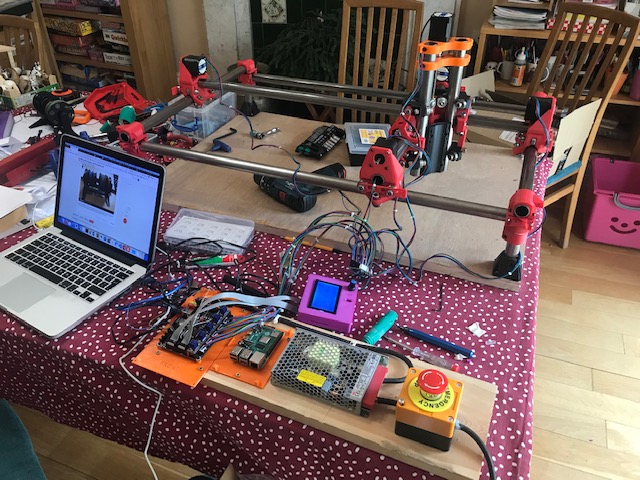

I have now done a first fit build to check fit make sure things seems to work OK. I can use this for working out the wiring loom, lengths, directions etc.
I can move things up and down on the Z axis and the X and Y motors turn in the right directions with respect to each other.
IMG_4435
Now to add belts and things.
Rob
I now have four belts set up, things seem to be moving quietly as well. I did have some chatter on a toothed gear but adjusted it out and it seems fine.
