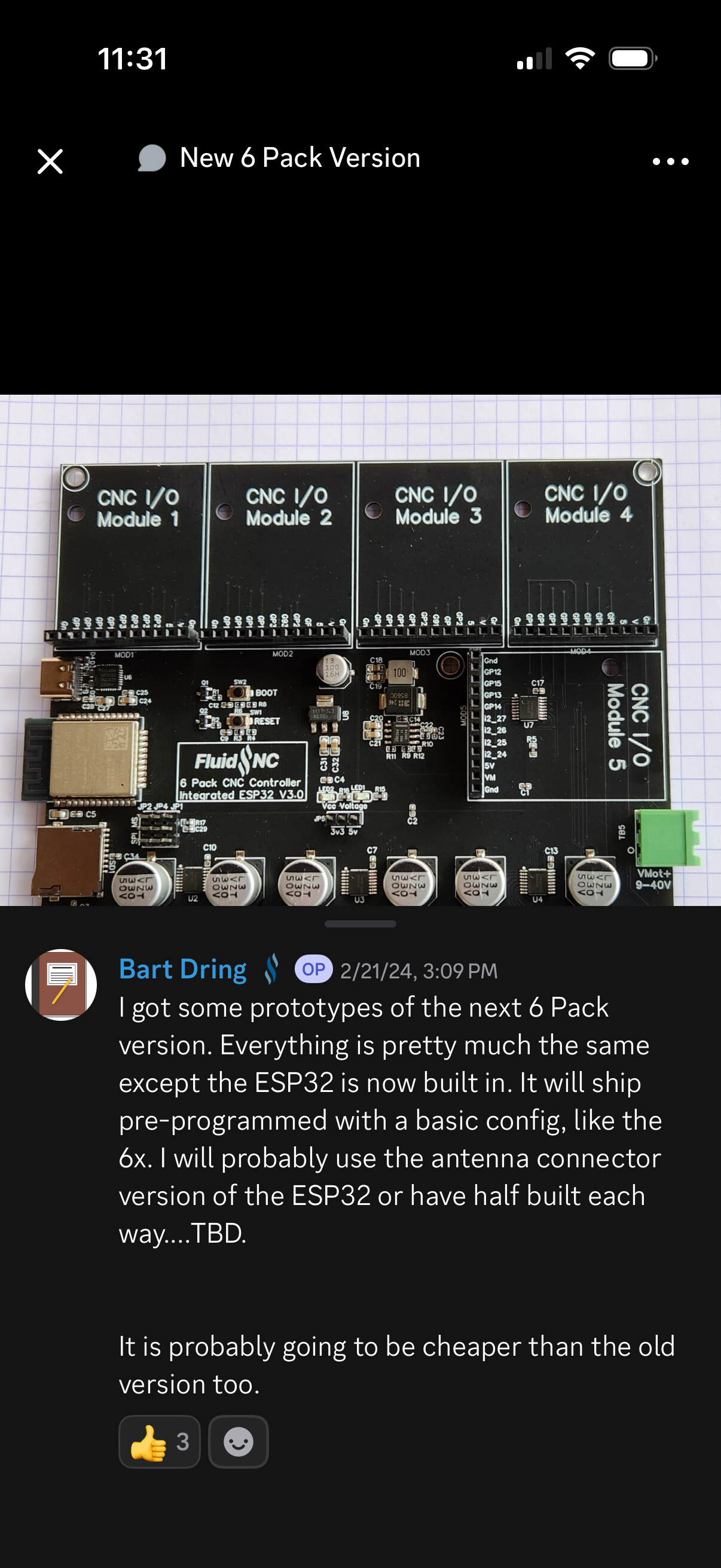

New Bart Dring 6x external board (ESP32-S3)
Interesting new external driver board that Bart’s preparing for release…
Amongst the many niceties in the board:

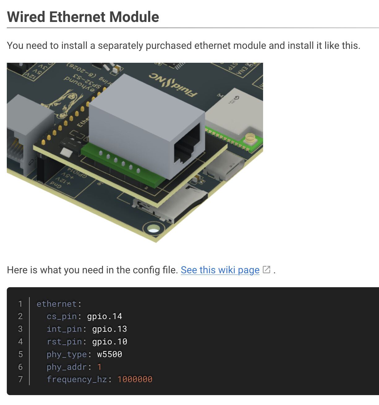

if it will have ethernet then I’ll make linuxcnc work with it and we’ll be able to use it with plasma :smiling_face_with_sunglasses:
Or a translator board and we could add Ethernet to Jackpots…

I also want to experiment with that Ethernet module and see if I can get one working on a jackpot.

My boards are mostly targeting full featured CNC machines with big VFD spindles. Those need at least 2A per axis motor and that is not realistic with plug in drivers. TMC5160: I have a lot of experience with them is plug in packages and they are not reliable.
