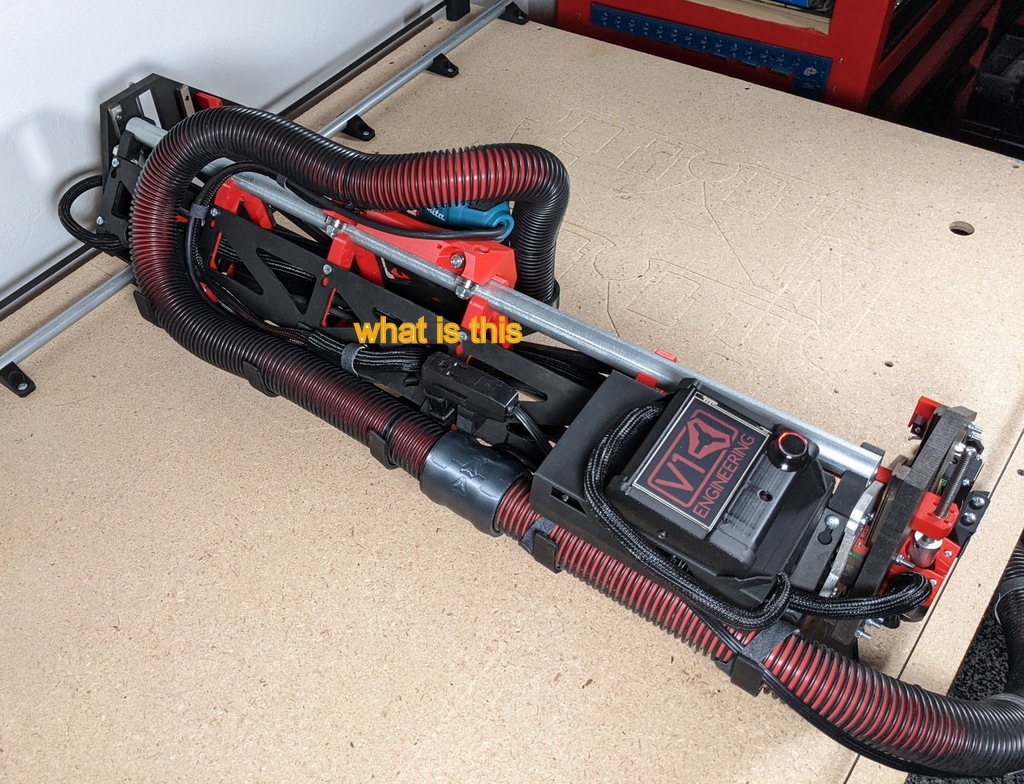

I just noticed a plug in one of the photos does anyone know what this is and where to get it? I have been trying to figure out how to get power to the machine for it and the router, this is the answer I just never noticed it.
@vicious1
I run an extension cord up, then plug in my router and board power supply. Slightly cleaner, and I tend to do a lot of random testing…lasers, LEDs, that sort of thing
I get that but I was actually curious where you found that, I can only find extension cords designed like that with two prong plug ins not the grounded three prong one. Also do you have any problems with overload? Reason for that question is when I was cutting my struts I tripped the overload on a outlet strip twice. After that I went to a much bigger outlet strip and have not had a problem. Three prong multi plug with a flat cord priceless!!
