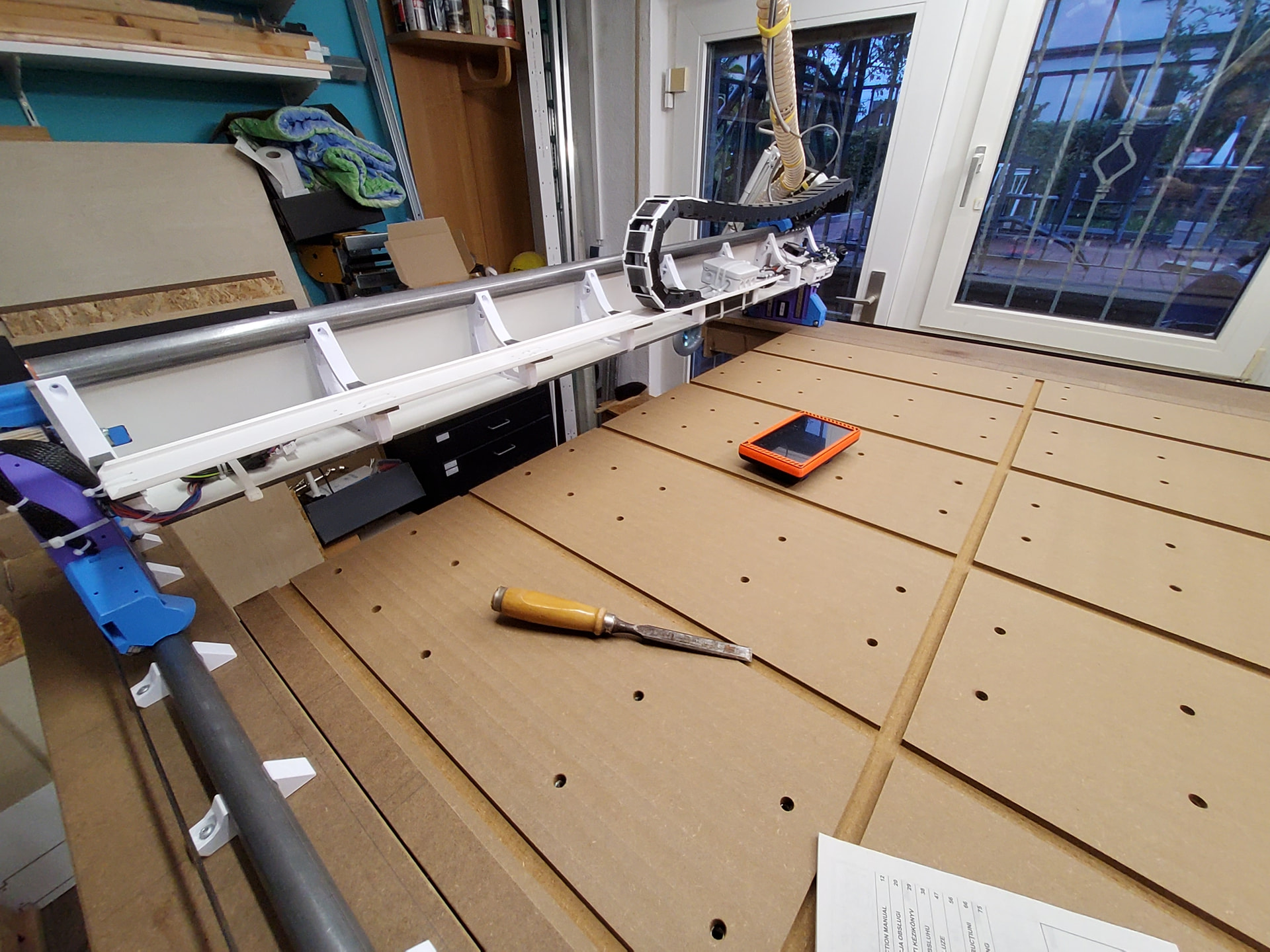

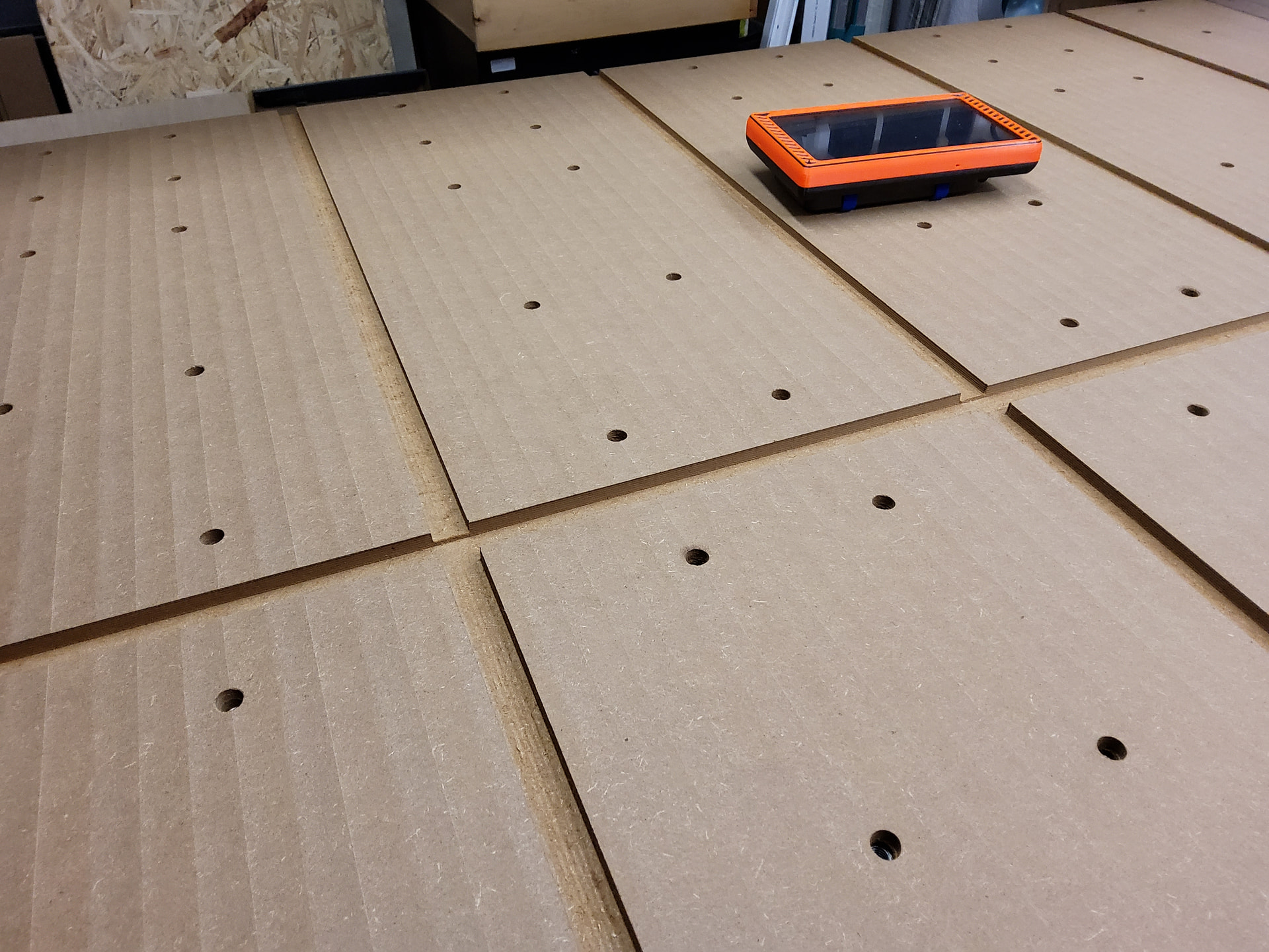

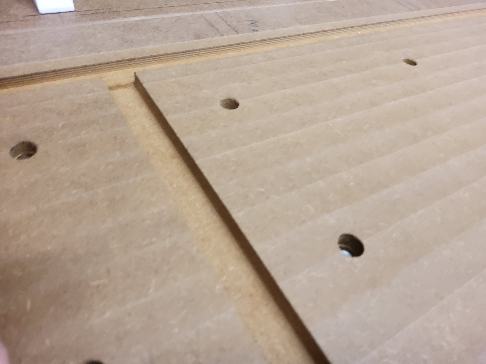

I tried to cut grooves for C shaped aluminium tracks… they should be around 5.5 mm deep, with a total height of the aluminium profile of 11 mm the idea was to have the spoil board parts being aligned between the tracks…
LR cut first groove (Y direction, front of table), then second and so on, but only when it cut the last groove (X min to X max) I saw that each groove of the first row was a few mm deeper than the last.
What could be the reason? I will show you some pictures plus the gcode file I used…

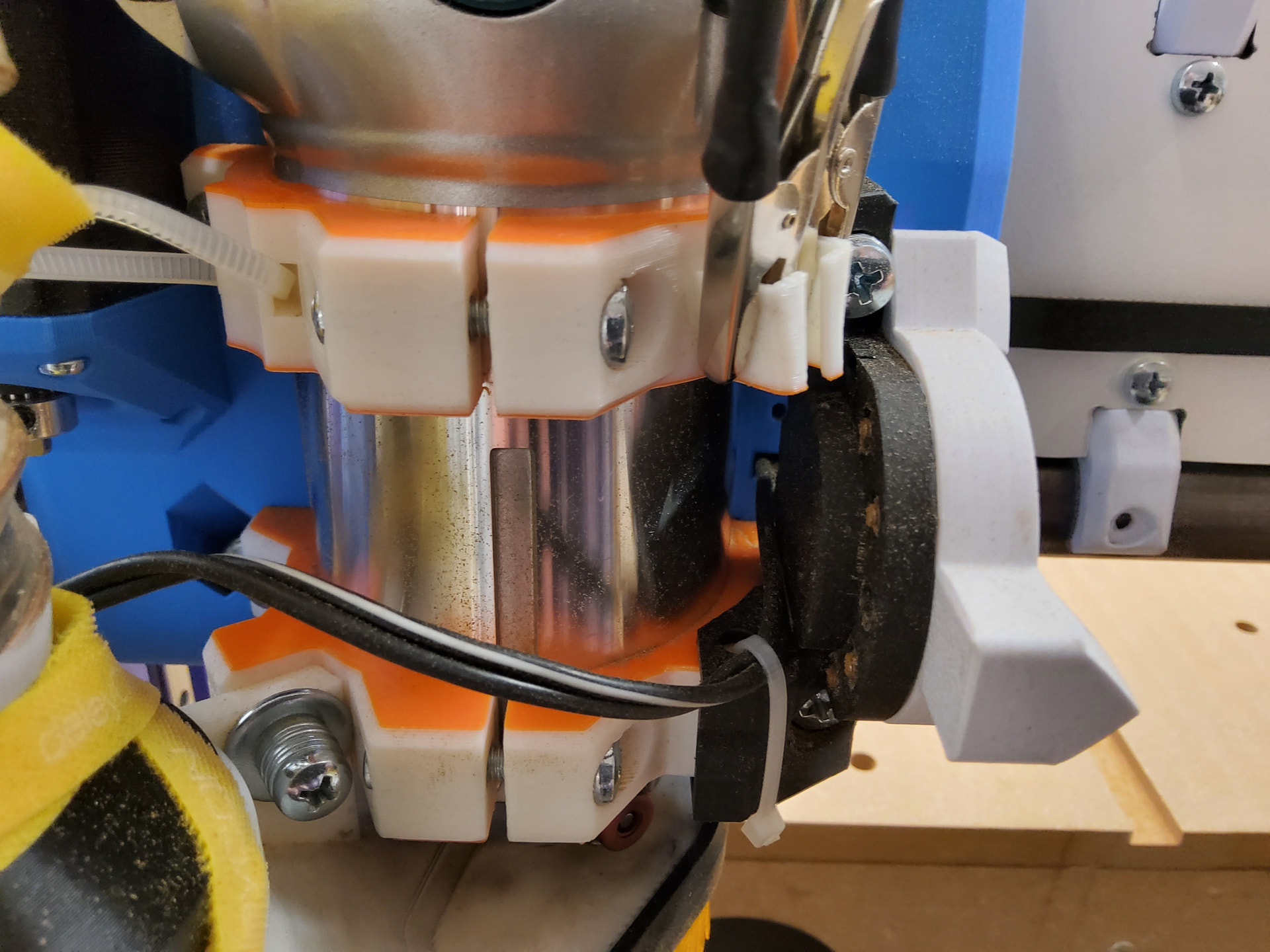

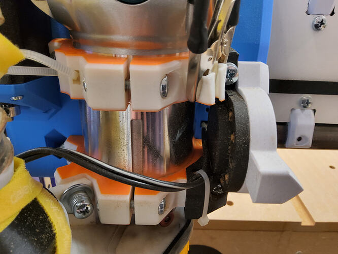

Possible reasons could be the Z stub screws, which where really loose, but I removed them for good now (not jet tested, tbh…). And sometimes the left side (xmin) of the LR makes some “knacking” sound when moving completely up or down.. Lead screws are greased, can easily be turned by hand without any blocking…

Either Z is losing steps because of going down too fast or not having enough energy
Or
The endmill is slipping in the collet because it’s getting too hot because of non-optimal cutting parameters. Has happened to me more than once.

You can not really measure losing steps, but I had my inlays go deeper and deeper continuosly. Took me a while to figure out that the Z was basically losing steps. There are a looooot of Z movements for inlays though.
So I am staying at the endmill is getting too hot. :grinning_face_with_smiling_eyes:

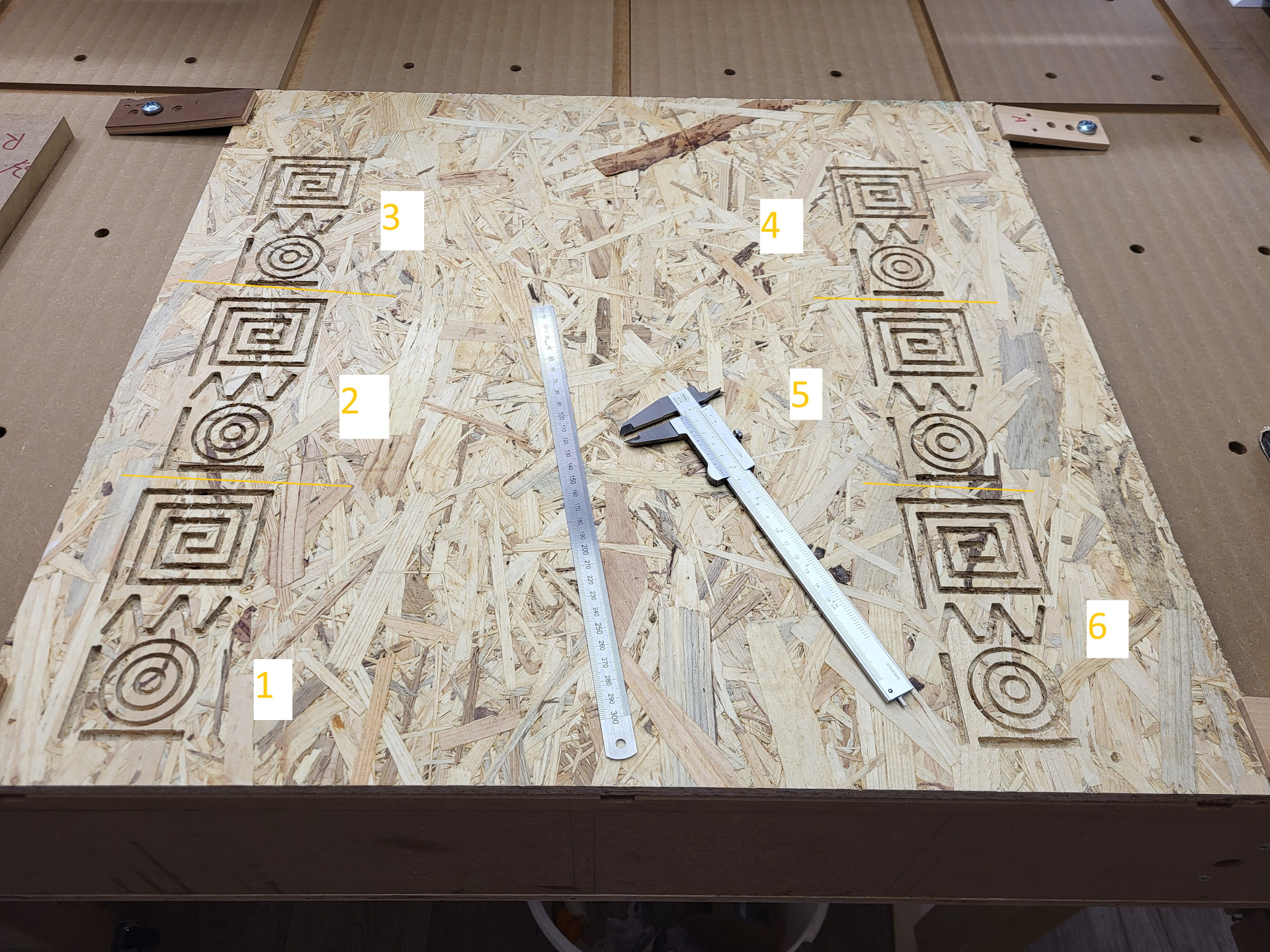

Well… I still don´t know. I thought about some test pattern with some nice direction changes (mild = circles and hard = 90° corners) and a lot Z movement… but this time it worked fine, the cutting depth is measured between 5.2mm and 5.4mm, with a set point of 5.0mm. But it is OSB/3 board, so exact measurement isnt tha easy. And it is not super flat and even, I guess… All steppers not even got more than hand warm, maybe 35°C with ambient temp at 23°C.
I did not think about touching the endmill before maybe 30s after end of job… it was cold. And it had the same length of 16.5mm , measured against the router collet.

Ok, again everything worked out as I drew in Fusion360 and setup in ESTLCAM… all over the test cutts i get the desired 9mm depth…

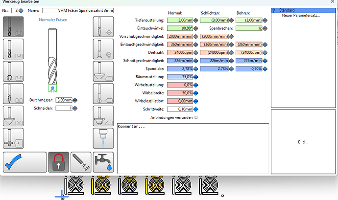

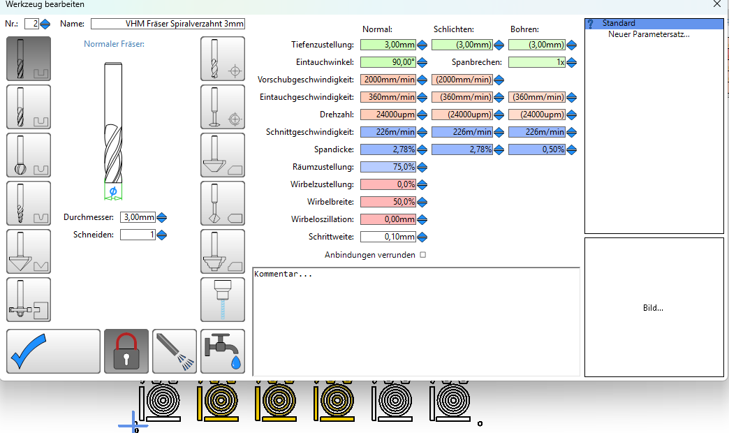

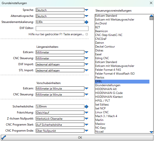

I use the following settings in ESTLCAM:

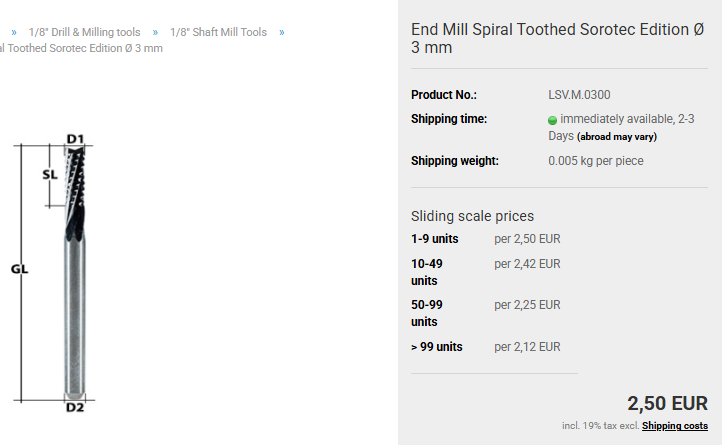

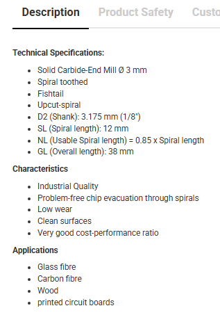

Is the “Schneiden = 1” (cutting edges = 1) set properly for this fishtail diamond tooth endmill?
I used this endmill (SOROTEC brand, LSV-M-0300)
ESTLCAM-Settings:
Is the endmill to cheap?
Is it the right kind of endmill for cutting the grooves into MDF?
What are the right settings for ESTLCAM and for my Makita RT0702C router?
Do I have to calculate for each material/depth of cutting/endmill size an type the right feed rate and rpm, or is there some tolerance for guessing?
I am counting 7 spirals around the endmill, so ist should be 7 tooth for ESTLCAM, I guess…?! Still need to learn a lot, obviously…

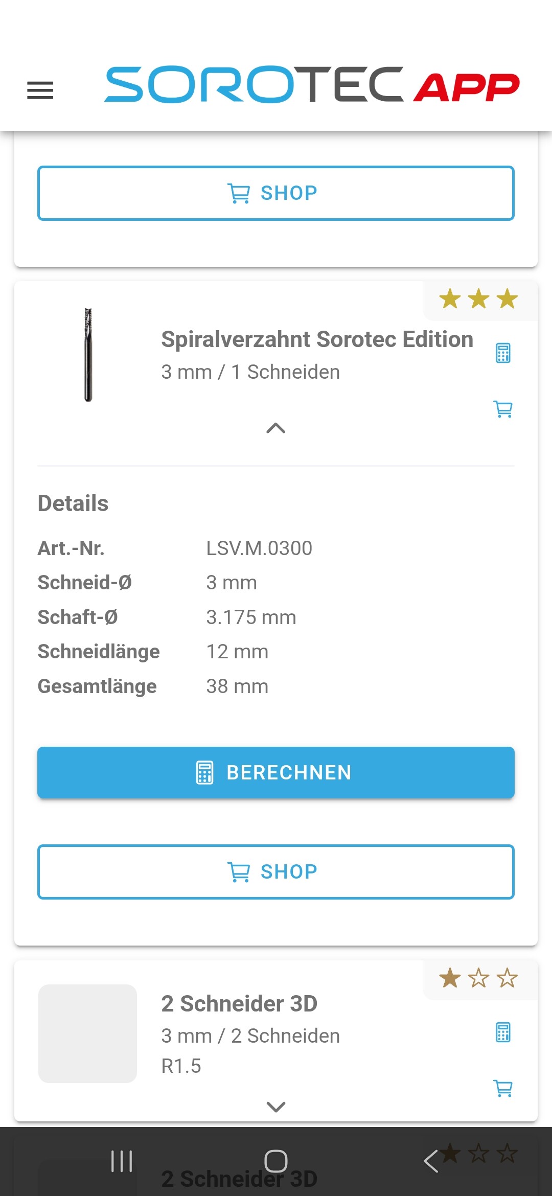

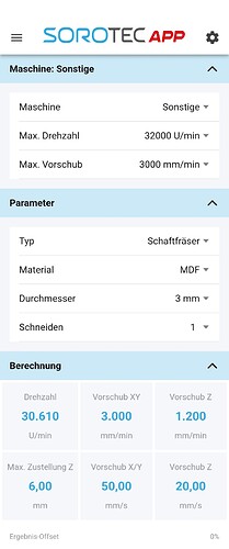

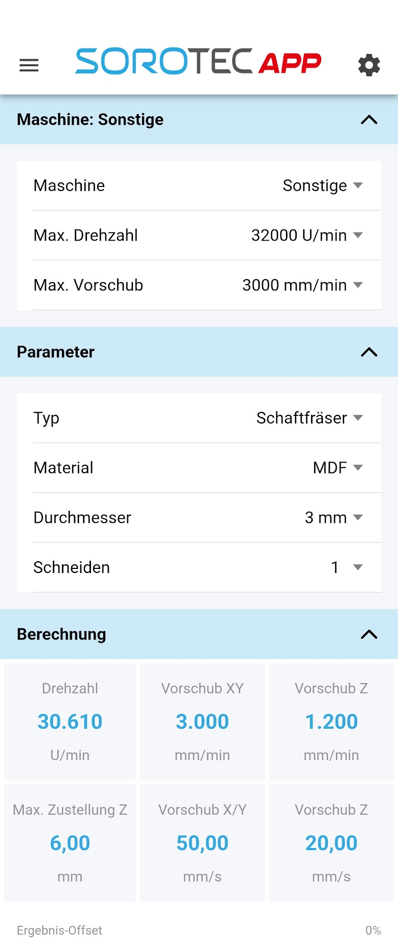

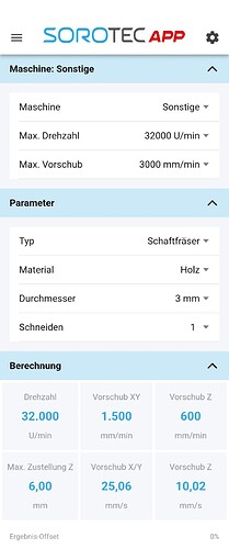

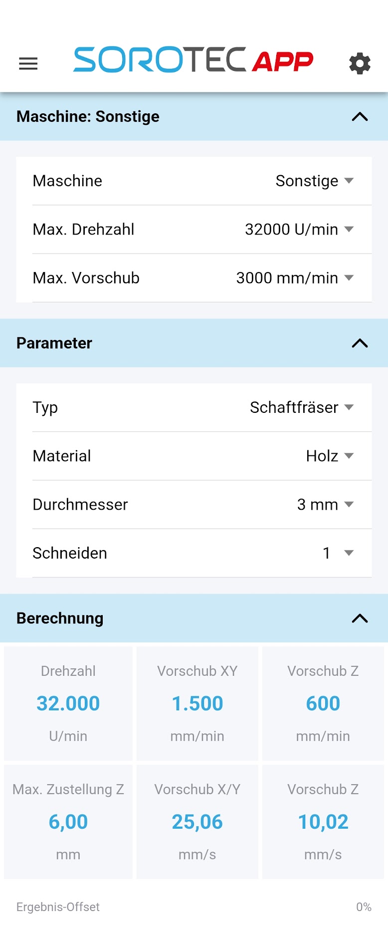

But… SOROTEC has an android app…where I could find that endmill… and it says “1 Schneide(n)” (1 cutting edge)… And for wood (one can choose between woord, hard wood, MDF) it tells me to go with 1500 mm/min @ 32000 rpm
What are good and proven feed rate calculation apps or websites?

Philipp is leading down the right path. Only thing I will add is be very careful when using collet adapters. Most are not worth the time.
When you are using them you have to be sure to seat the bit fully in the adapter. Always clean the collet and bit,and the barrel.
You can check the seating of the bit by simply sliding the bit into the adapter. The bit needs to go through the adapter,anything less will not properly clamp, which can lead to runout and or bit sliding in collet
The diamond endmills can be calculated like 2-flutes, but they aren’t good for MDF, just for plywood.
It´s Saturday again, and I found time to test my Lowrider… I have changed all motor run amps to 1.2 A, but did not feel comfortable with that in the long run. I could still touch them, but they felt warmer than a “warm handshake”, so I reduced the current to 0.9 A.
Netxt thing I changed is the collet adapter, I bought a direct 1/8" collet from Philipp, but thats not tested yet. I bought a Makita 8mm collet, to use my 8mm shaft router bits for cutting the groves into my MDF table top. My thinking was, that the 8mm diameter wolfram carbide cutter without a spiral has no tendency to move up or down inside the collet. Plus I cut away part of the dust shoe to allow using two open-end wrenches.
All that together did the trick, I could cut the groves for the complete table with the same z depth. Only small mistake at th beginning, when I tried to X and Y probe the grove side from my previous attempt, to continue from there… Have to figure out more how the zero point in ESTLCAM works together with the probing sideways and the tool diameter (was off by tool radius in X direction and cut into the table, but only 1 mm deep…
Now I have to clean the groves before glewing and screwing the aluminium c tracks into them.. MDF in the middle layers of the board is very fluffy, not easy to get a smooth surface…
