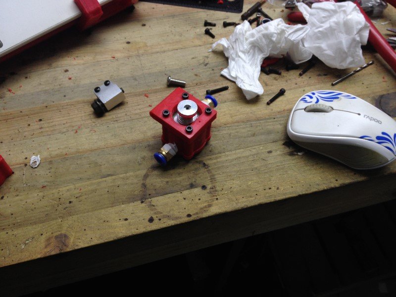

Hello everyone,
It’s been quite a while since I didn’t work on some mods on my MPCNC. Now that it works flawlessly, I think it is time to make the print head a bit more stiff and compact. It is quite a challenge since I have so many things in there, but it does take too much space currently, it looks bad and the whole thing is a bit flimsy. Plus I have to be there to untighten a screw before anytime I do an autolevel and then tighten it again just before it prints, so it is not fully autonomous.
My plan is to try to make something more compact, to gain a bit of printing space, to do it stiffer to limit print defects and to find a way so that I don’t have to do any manual operation. I’d like also to be able to swap for a different print head in less than one minute.
First thing I had to do was to make it stiffer. The main reason the thing is not stiff is, I think, the way nozzles are traditionally attached to the rest of the printer. I’ve got an E3Dv6 volcano, and the thing is only connected at the top, which leaves a long lever arm of about 80mm. Plus I have this whole liquid cooling system I’ve done I had to attach somehow. It’s a bit like if you try to hold a pencil, you’ll be more precise by holding it close to the tip than far away from it.
So what I’ve done was to rethink the way I’ve done this cooling system. I made several different designs and finally found one that works, apparently. The major difficulty was of course to get the thing water tight, but it seems like I finally managed to do it.
So basically it looks like this:
[attachment file=73005]
One O-ring on the bottom:
[attachment file=73006]
One O-ring on the top:
[attachment file=73007]
The water comes from one of the coupling and goes out from the other. The whole thing is made out of 3 parts sandwiched and tightened together by 4 long screws
[attachment file=73008]
I’ve tested it for a while and it doesn’t leak, aside from a few little holes on the sides which are due to my Delta 3D printer not working very well these days. But it’s an easy fix, just heat the tip of a screwdriver and melt the hole spot to fill it.
[attachment file=73009]
I think the main concern of most of you would be “Will the plastic be able to handle the heat?”. Well I’m not 100% sure yet, I still have to test that, but I’m very confident it will. Reason being that it shouldn’t see any heat in the first place, because it will be constantly cooled by the water inside, and it won’t touch anything hot, there should always be at least one or two millimeters of gap. The fins inside will remain cold and even if they did get hot, they are not touching the plastic since there are the O-rings in between.
I’m pretty excited about this mod, since it would be an easy, affordable and most importantly doable by anyone water cooling mod, which not only adds water cooling but also add stiffness to the whole thing. Previous method was already easy and cheap, but I think that most people didn’t have the silicon tube or didn’t know where to find it. For me, having this mod means that I can build several print heads with different nozzle sizes, and swap them in a few seconds.

Well Dui, I made one of you previous silicone tube style cooling mods and tested it in the sink and it was fine but I never got round to mounting it on my anet a8 cause I didn’t want to break it. I have today bought a broken printed off ebay for £44+£12 so £56 all in which hopefully the only extra I will need is an extruder motor. I figure I will get this one working and use the water cool mod. This way I can have a fine detail printer with the normal 0.4mm or less nozzle and use the new beta printer as my large scale 1.2mm nozzle job and employ that linear advance too.

Hehe, I do understand your fear, but I never had any issue of leaks with my ghetto silicon tube system, just had a few droplets once because I did a mistake, but really nothing else. But yeah, I understand it is a bit scary because it looks totally crappy.
I’m not sure the watercooling will be very useful if your printer is a small one, but it shouldn’t hurt anyways. It will run a bit quieter and give you a more stable extruder temperature though.
