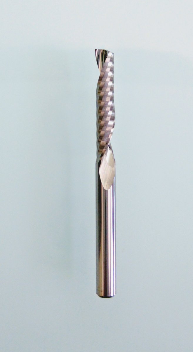

@vicious1 Can you also recommend one of your 1/8" bits, capable of cutting a full depth finishing pass through 3/4" MDF? I see some on your shop page, but not all specify the length of the cutting area. Prefer a single flute, but if you have a better suggestion for my purpose, then I’m all ears. MDF is pretty much all I work with, and usually 3/4".

For 3/4" I like the one with the red collar it just does a 3/4" full finishing pass, but some like the other single flute better. For me the red collar (kyocera) stayed sharp longer.

This bit?
And ok, I’m going to order 10 or so of those red collar bits today or tomorrow. I looked at my arsenal from the Maslow stuff, and all I have is 1/4" 2 flute upcuts. I know those will work, but I’m trying to stick to what the recommendations are. I also read something where you had said the 1/4" bits actually need to move slower, so I’m gonna roll with your 1/8" bits. Thanks, and HOPEFULLY I’ll be getting her dirty this weekend. Still plenty to do while I wait on the bits. Gotta route my power cables under the table, and mount the power brick to the Y Plate. And I’ve still yet to get a vac hose. Plenty to do indeed.
Either of these.
You can also remove that little red donut with some pliers. It is just press fit on there. Just be careful you don’t cut yourself with the pointy parts.
@jeffeb3 What’s that for? I thought it was probably some kinda depth guide for inserting it into the router.
:man_shrugging: I assumed it was to tell the different kinds of bits apart. I suppose it could be used as a depth gauge, but I think a touch plate would be much easier and more accurate.
