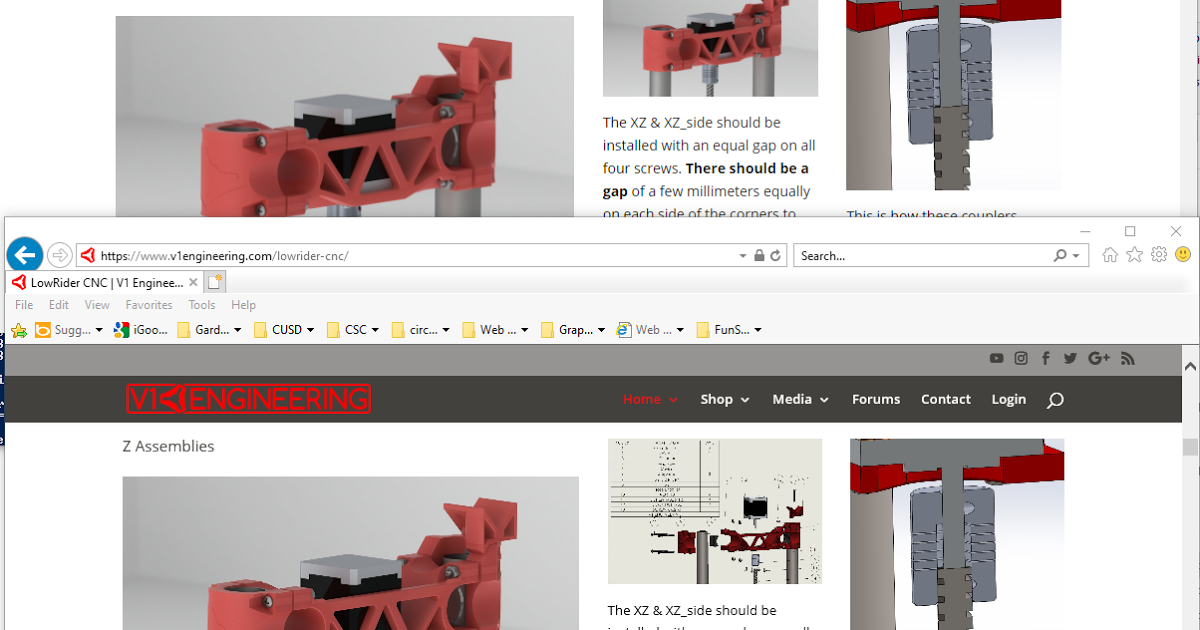

The second link in my first post above is the one that takes my connection to the exploded view.

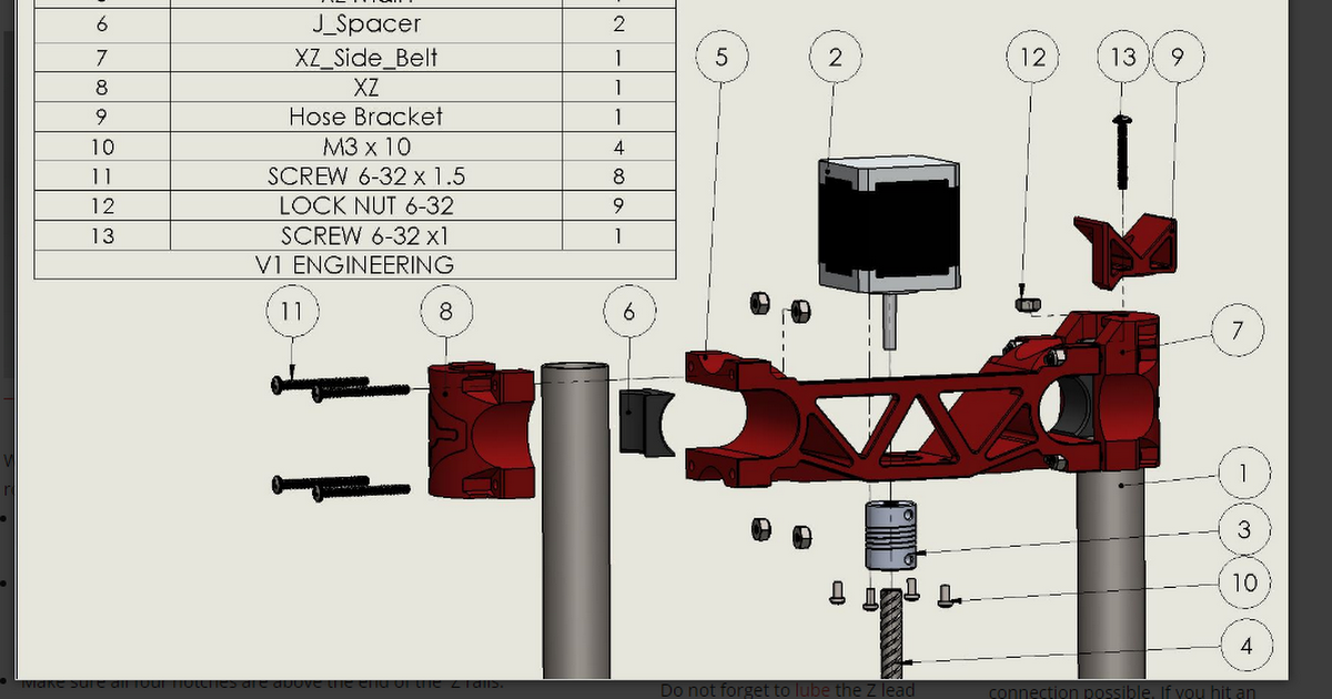

Here it is again along with a screen shot of what i’m calling the ‘exploded view’…
\https://www.v1engineering.com/wp-content/uploads/2018/08/Z-assm.jpg
Not sure if you are getting the same view (two pictures of the fully assembled Z, one large, one small) when looking at the web page. I’ll trying using Firefox and Exploder and see if the page isn’t presenting itself the same to both of us.
Thx.
EG
Yeah, I have the links to the images, I’m trying to get a link to the page with the instructions.
Doh!!! sorry.
It looks like Chrome and IE are resolving the page links slightly differently.
Definitely might be something in my Chrome/IE instances, but I’ve seen other posts of people saying they couldn’t see the exploded view of the Z: assembly.

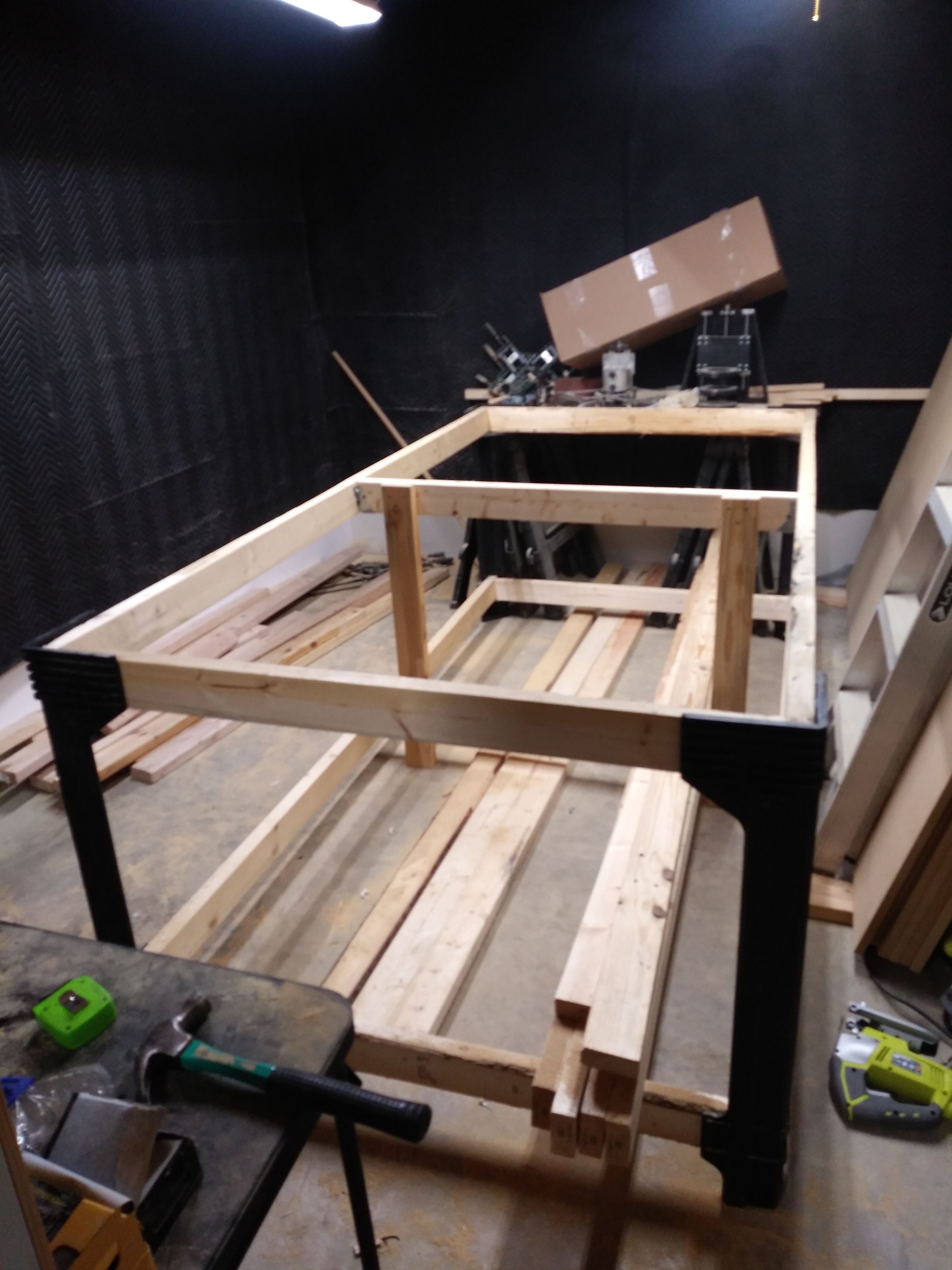

So I know it’s been a while, I had a pretty rough first of the year, and I’m JUST NOW getting back on my LR2 build. I got the frame done today, I’m 1 step closer to being in the full sheet family!
Things that were bothering me… I kept hearing ‘Has to be square’ ‘has to be level’ so I’m nervous af about those 2 things. To the point I was trying to find a table that would work. Then I found some resin legs on amazon. Keeps things square, and level. IF your cuts are good. I totally bought them, and the listing was accurate. My table is square, and level. I DID add some support to the middle section to eliminate any sagging under weight. I used some joist hangers, then shot in some 3" deck screws. I’m really shocked at how sturdy the table is, being the legs are resin. But, color me impressed.
Overlook the mess. I had to take that damn Maslow apart and all those 2x’s are just thrown against the wall. Wish I had a burn permit, I woulda got so much more satisfaction watching it go up in flames. But, I’m not bitter… Just wish I had found the LR2 first.
ANYWAY, so tomorrow I’ll put the top on. I’m building a ‘sorta torsion box’, then Monday, I have the day off, and I’ll put my machine together FINALLY!!! I’m freakin’ excited man… Can’t wait to get it together!
As square as possible is the most important, but don’t worry to much I have never put much effort into flat…if it is bad you will have a robot that can fix it.
Even square can be tweaked with a little sandpaper if needed. But really if it rolls straight it will do so on a parallelogram as long as you start at square.
Thanks @vicious1 for the encouraging tips! I put a piece of MDF on it, which I will have as my spoil board. It’s perfectly square with the 2x Frame. No overhang in any places, and flush all the way around. That really made my day, and got the excitement level back up to where it was!
