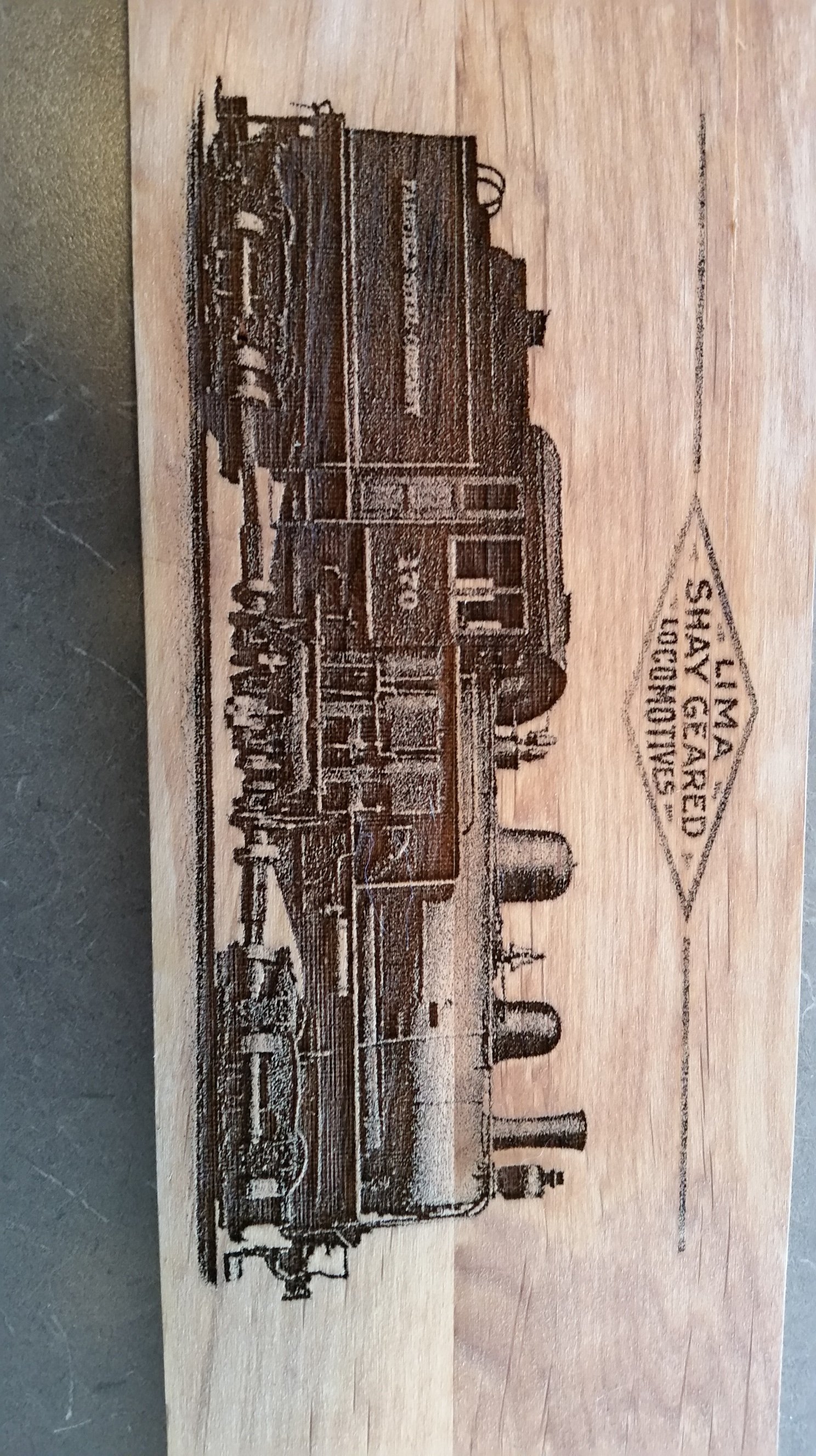

Got to burning a bit more, here’s a bit of work with a dithered image in PEP5. First is dirty, then the soot washed out. Last one shows depth of the burn.
[attachment file=33386]
[attachment file=33387]
[attachment file=33388]

The results on the train picture are amazing. How long did it take?
Roughly 3 hours
