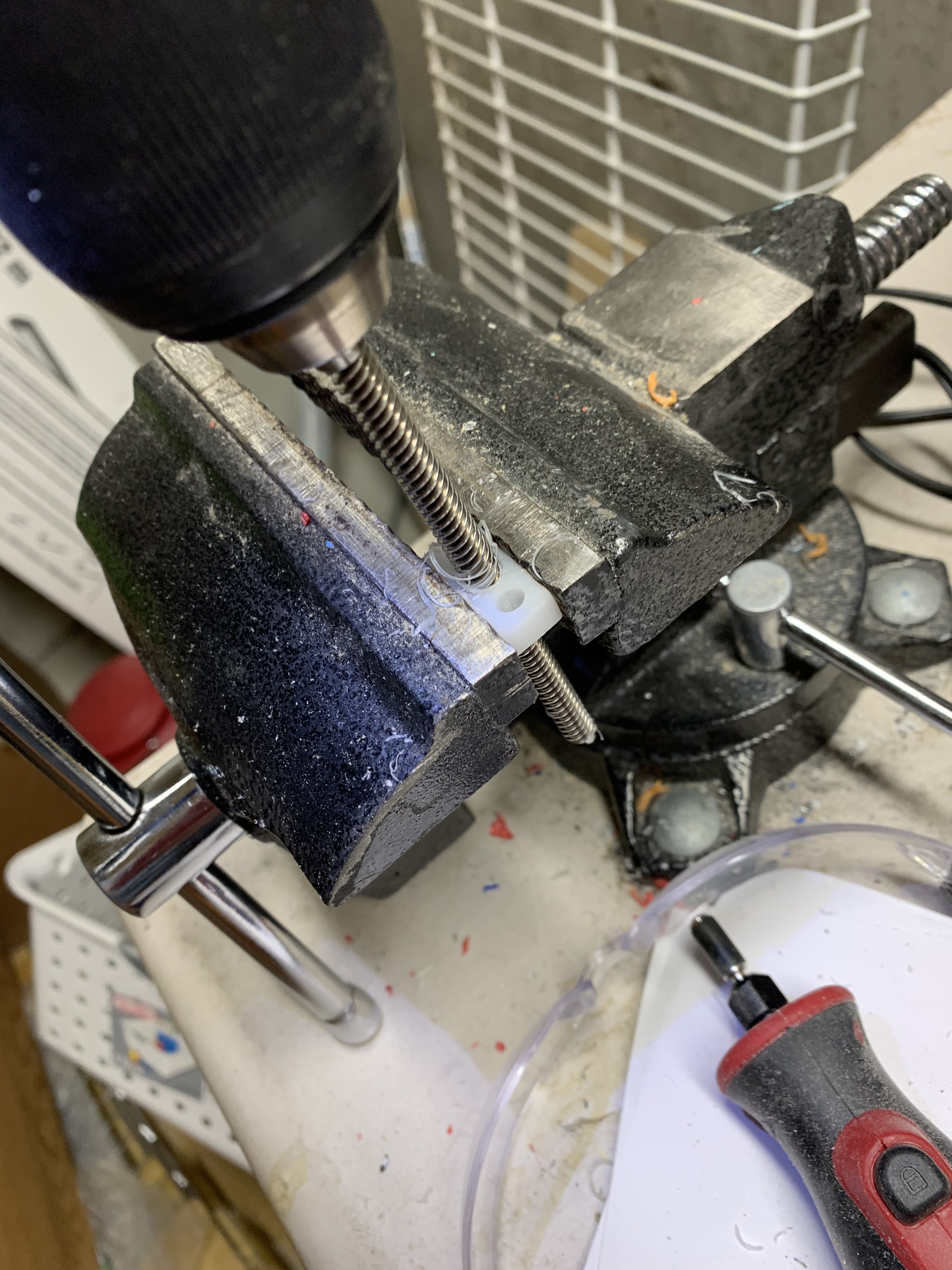

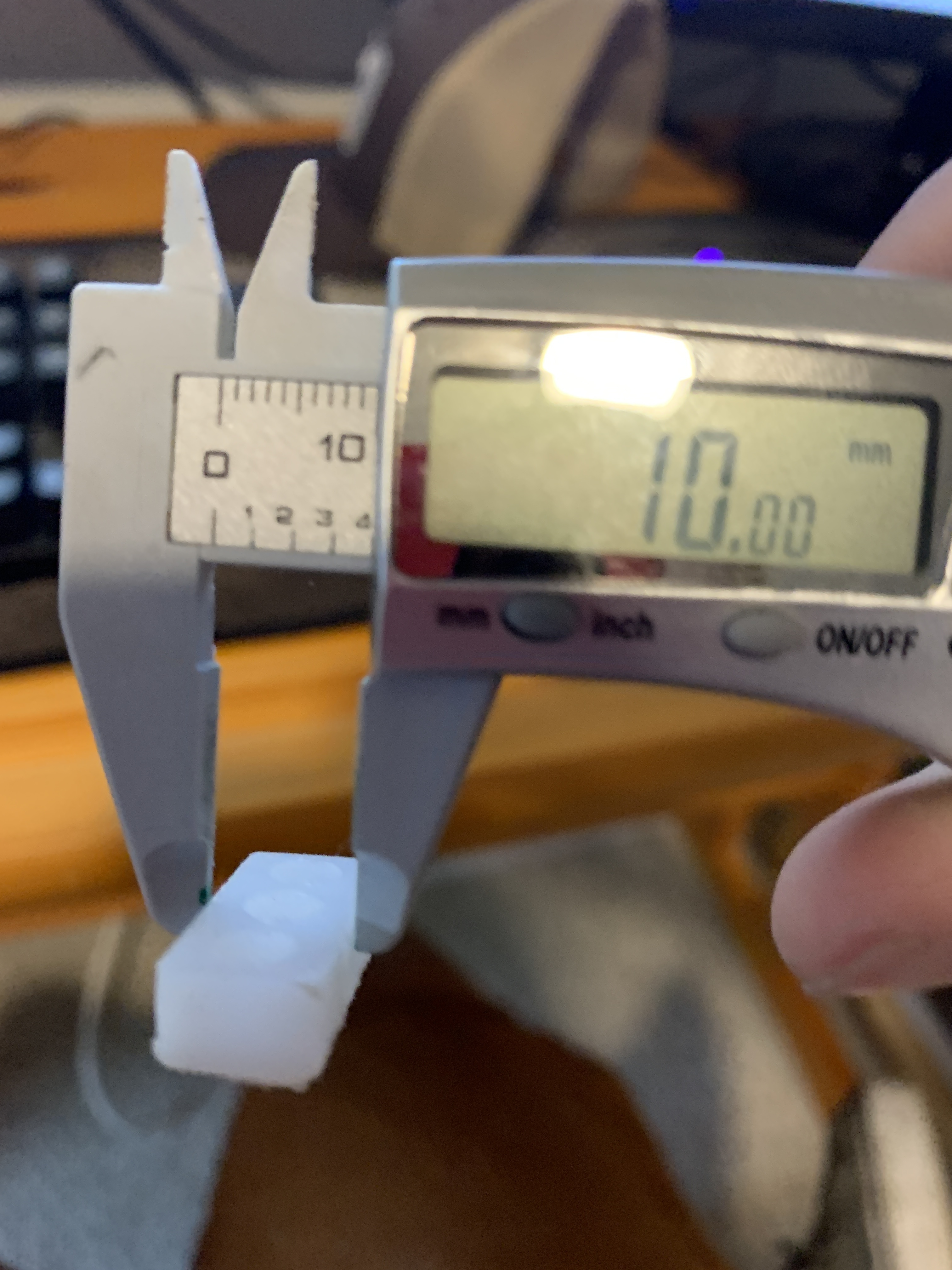

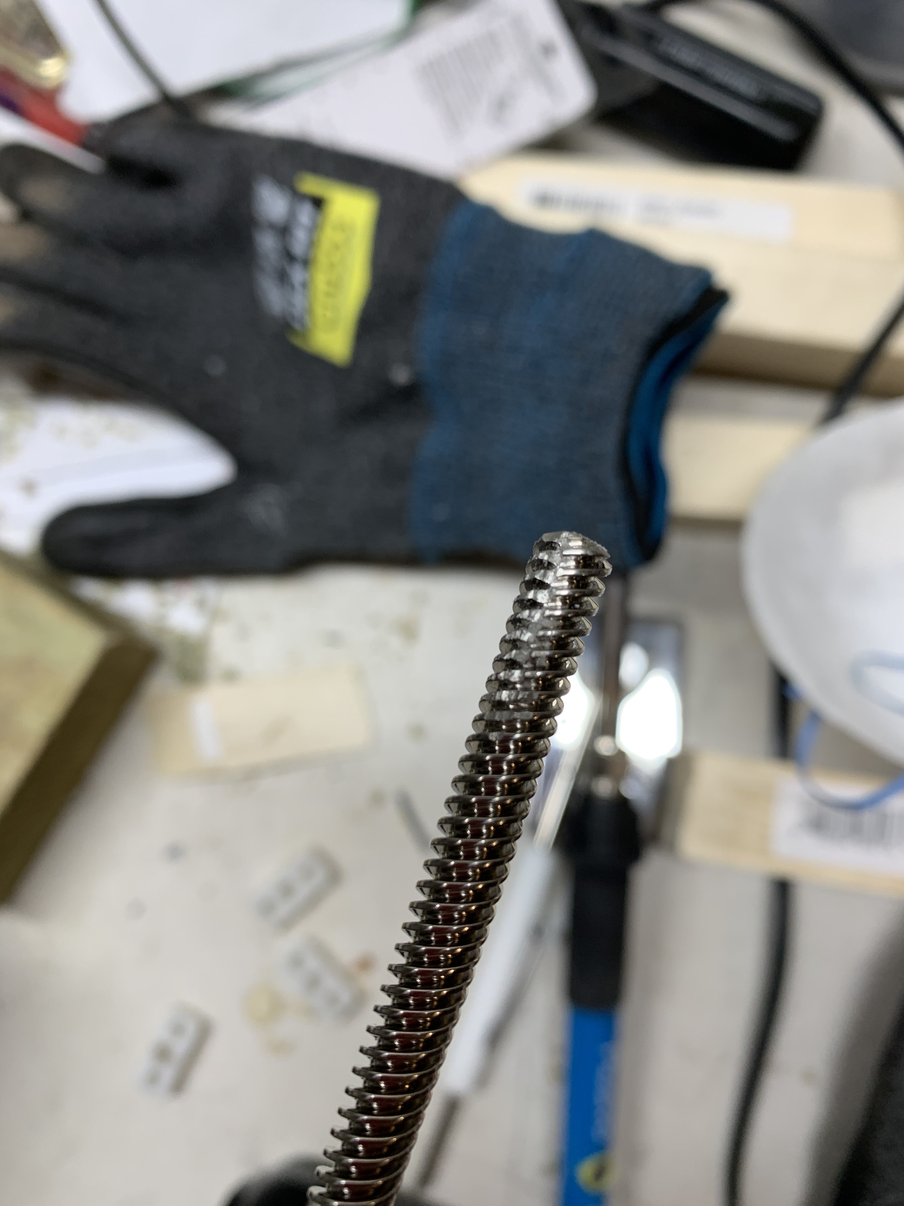

Just made the lead screw nuts. These things came out super well.

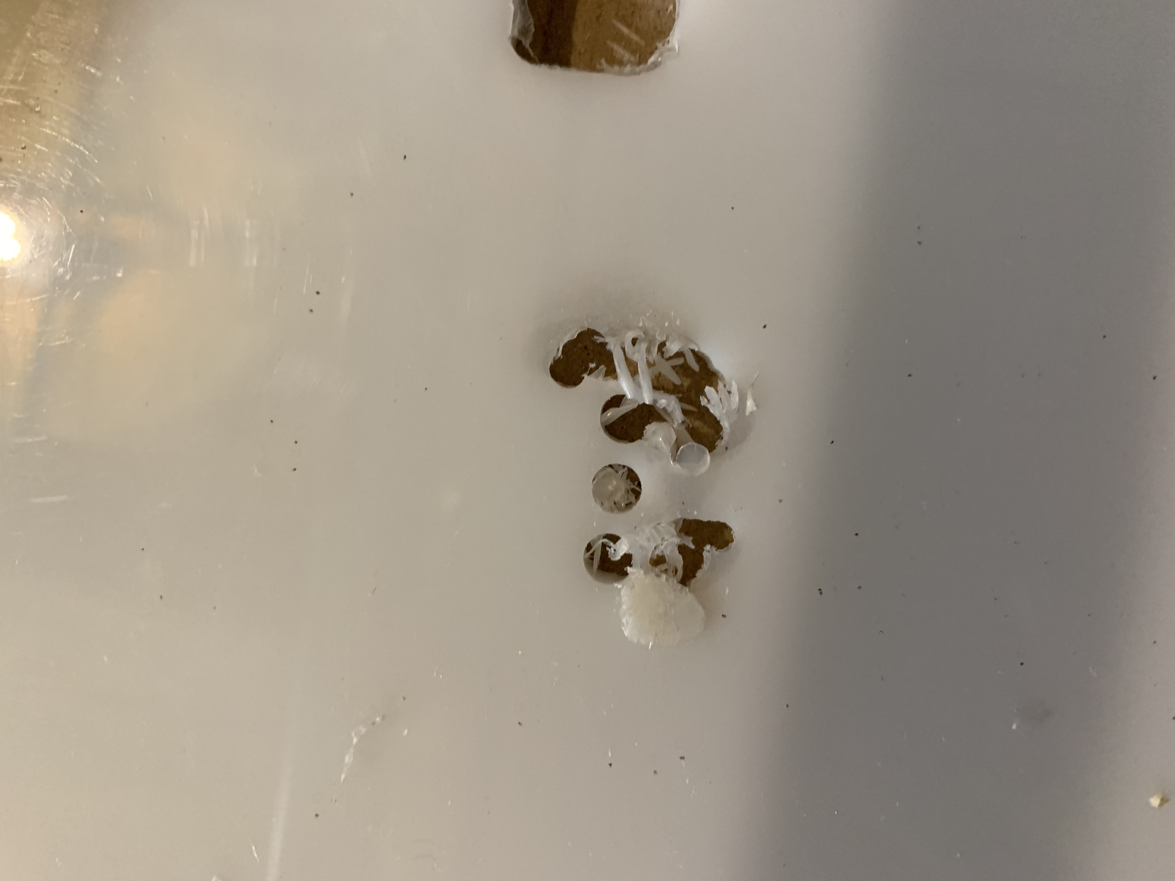

Had my first real fail on the mill today too. Didn’t know you had to go slower with a downcut endmill. Clearly you do.
I will probably start printing tomorrow, I’m almost done with the designs, I couldn’t use my computer for a week or so cause I was away, but now I can.
