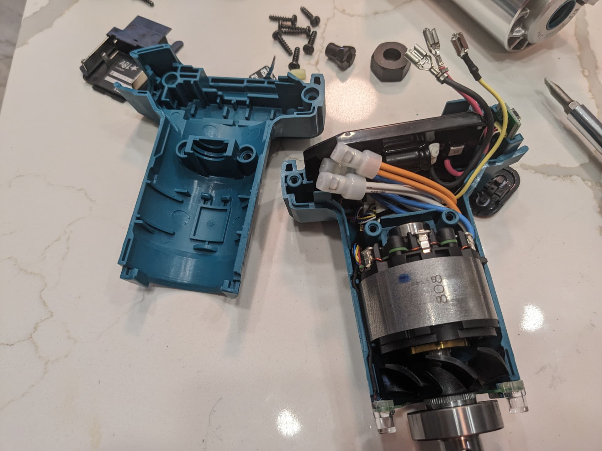

I’m doing a new MPCNC build…I’ve had a few before, but would like something a little different this time. I’m also sick of burning up brushes on a dw660 :rofl:
Has anyone used a Makita brushless router? I’ve been eyeballing the XTR01Z. It’s similar weight to the dw660, will take the same elaire collets from the store as the brushed version, and it should be easy enough to feed with a power supply…theres a few threads where someone did this on a shapeoko with a VESC & it just looks like a fabulously fun project.
Any thoughts before I make the plunge?

It’s brushless & I have a tiny pile of dead brushes from swapping them out. The self feedback should let it hold rpm better (not that bogging is a huge issue). It should be a lot quieter and cooler which is nice since this one is going in an enclosure.
Half the fun will be figuring out the vesc part.

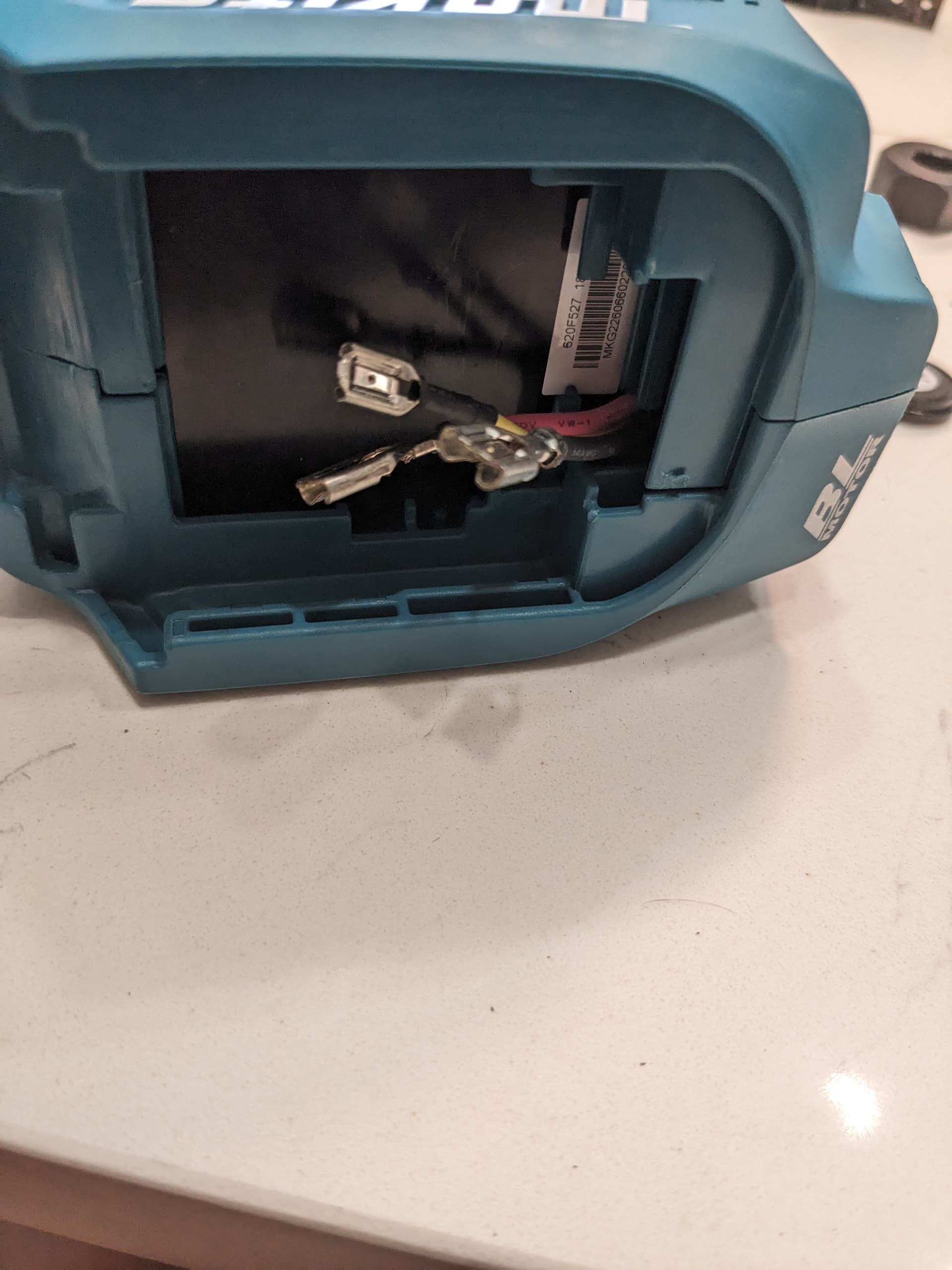

Powering it is just a matter of feeding some voltage to the correct terminals. Even easier with a battery adapter and some terminals
Now that I think about it, messing with the VESC is enough of a reason for me :rofl:
I’ll set it up first stock with a power supply in case anyone wants to take advantage

Just a quick test before I wire in the power supply
Quieter than dw660 & much less heat. Already glad I did this. Same diameter & collets as rt700 series
