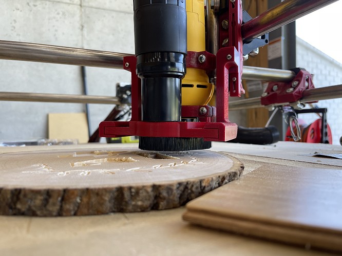

I originally was designing this to work with Phillips but found hex m3 machine screws in my collection halfway through. So I designed some caps for them to make it tool-less.
Either or would work! Phillips would probably turn out to be a PITA.

I’m excited to make this! I’m wondering - can you detail the dust collection side of things? What hose (and size) are you using, what vacuum, etc? Are you using a cyclone dust collector, that kind of thing.
@JCutrell Sorry, I missed the notification for this.
This is a printed cyclone that I’ve been using, its not bad and seems to capture 90% of the dust. If you have $50 bucks just go buy one from Home Depot tbh.
I have a 12 gallon Ridgid shop vac and a Ridgid car cleaning kit. The orange hose you see in my pictures is this hose here.
One more thing - I can’t seem to get the dust shoe low enough even sliding all the way down. Is this because you have modified the DW660? I don’t see the black locking mechanism on yours. The dust shoe is about 1/4” to 1/2” above the work piece. Do I need to print longer arms or mount them lower on the core possibly?
@JCutrell I’m not sure why the forum is not sending me notifications. Sorry for the late reply. Yeah my guess is that your corner legs are higher than mine. You’ll have to modify the sliding arms using the step file I provided.
Other than that, the build looks great! got any more photos?
