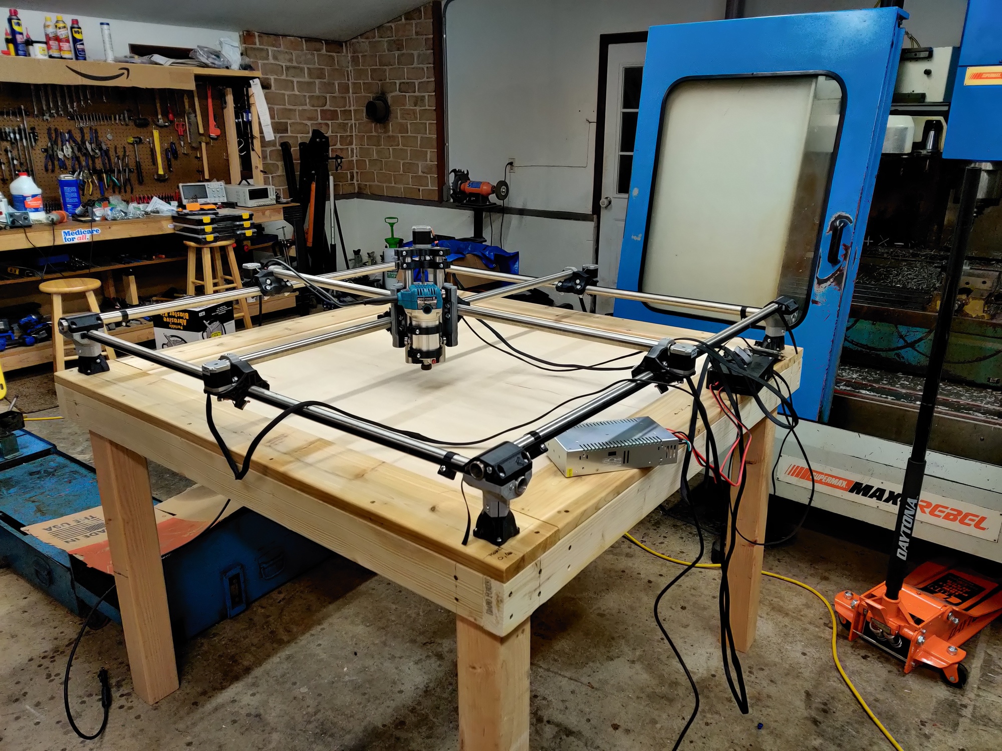

Got dual endstops working, and I had to compile the firmware with BED_SIZE set for 1000 mm by 1000 mm otherwise I got a kill alarm during homing (soft limits).
Finally got this monster out into the shop too.

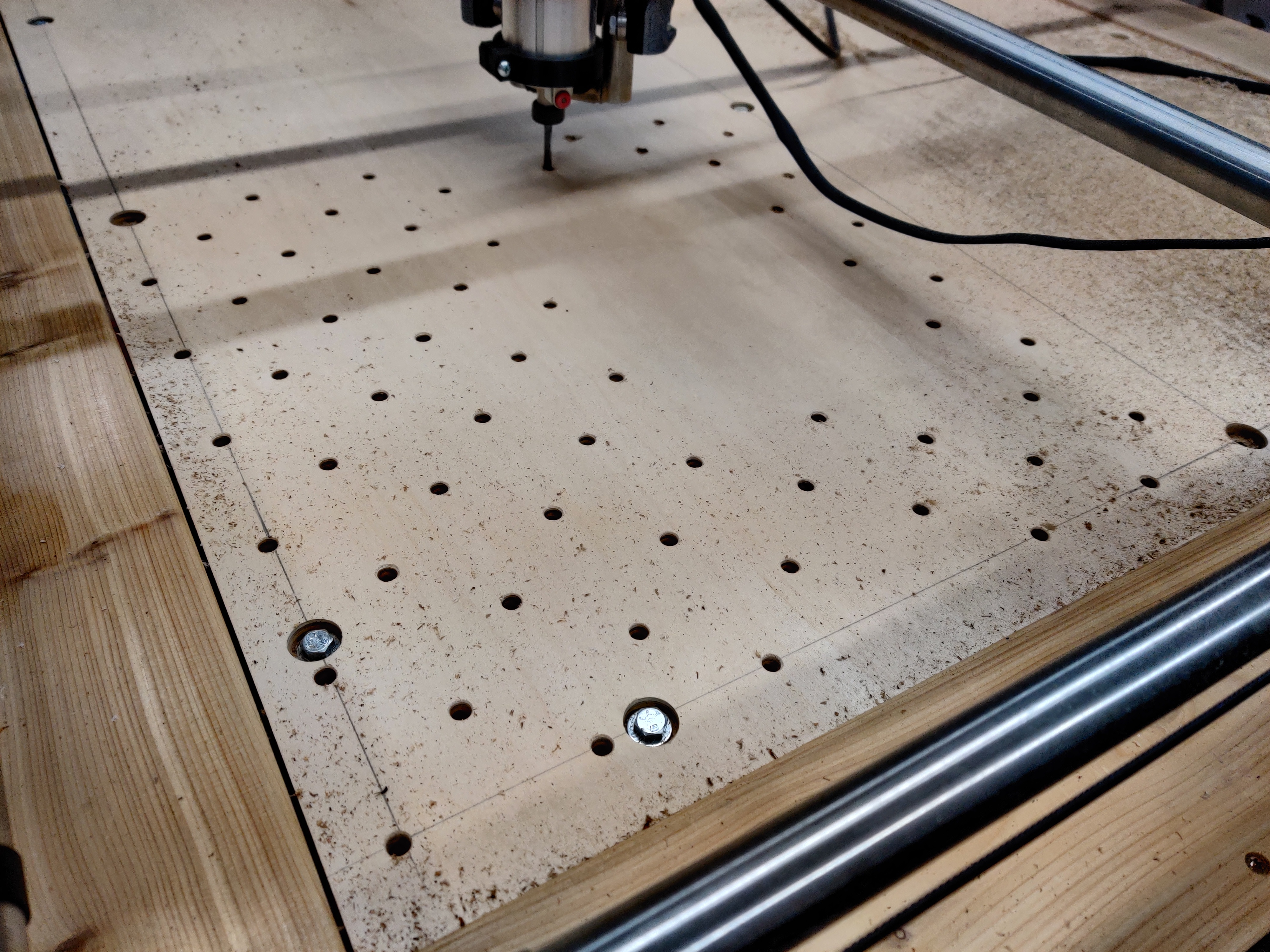

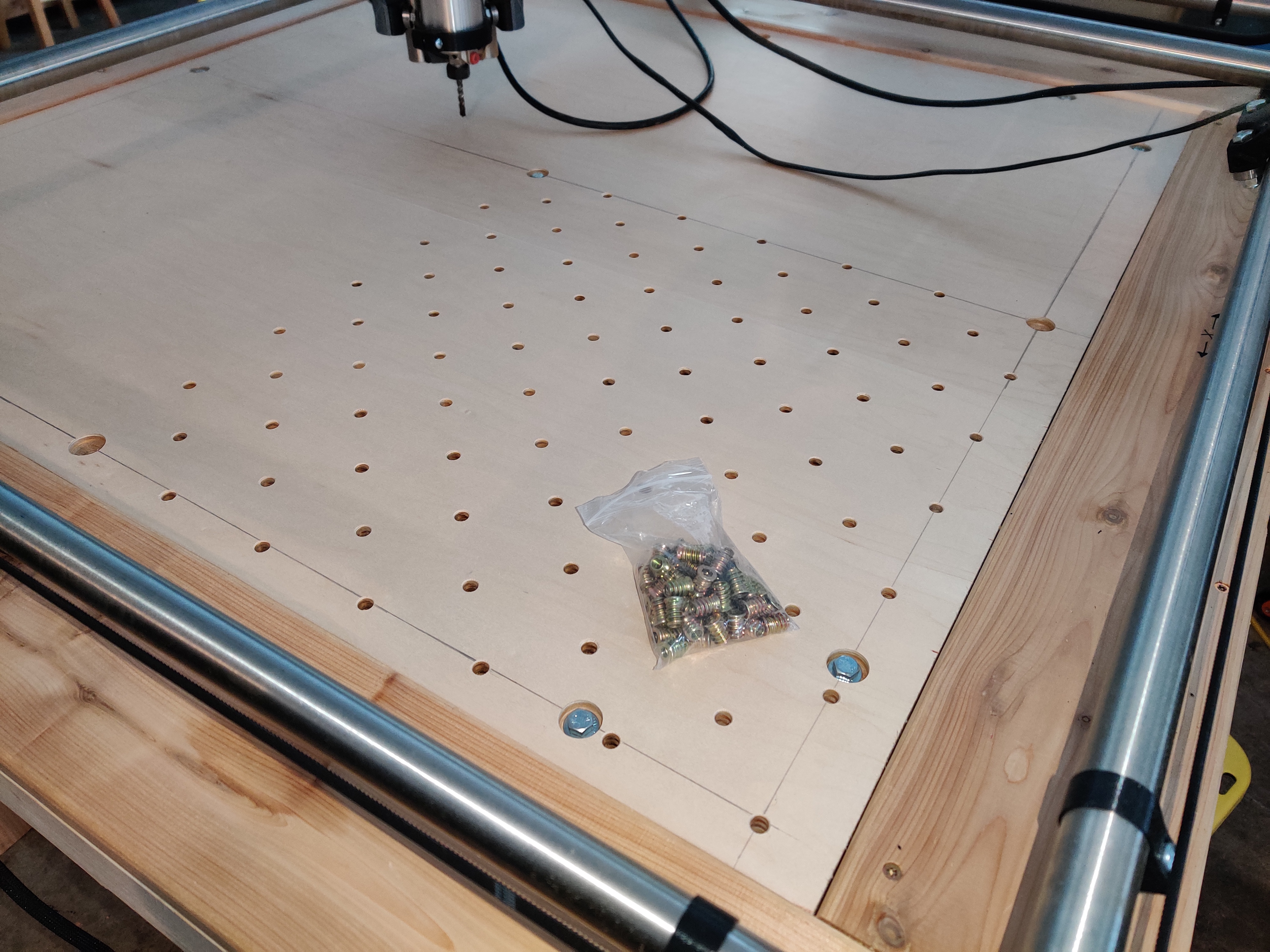

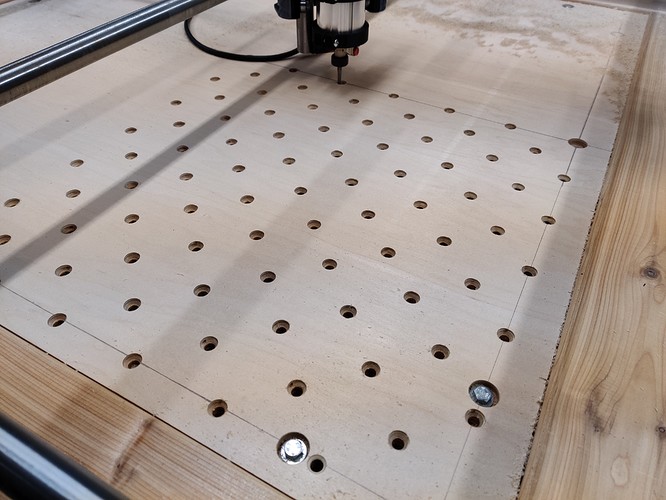

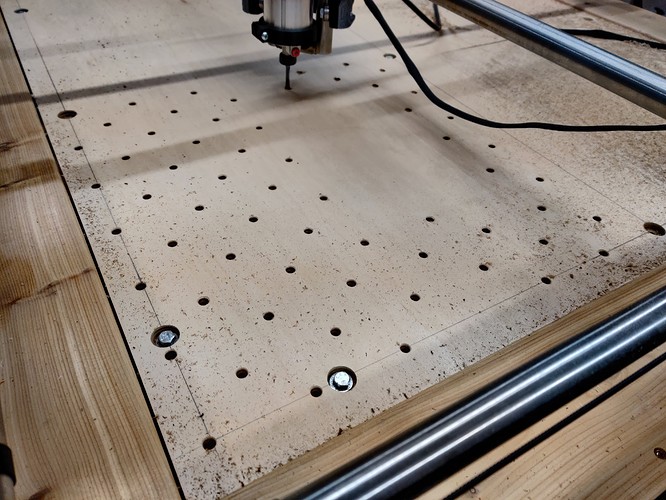

I did a section of threaded inserts in the meantime (cut in by the router). I decided to let the router do the countersink as well.
