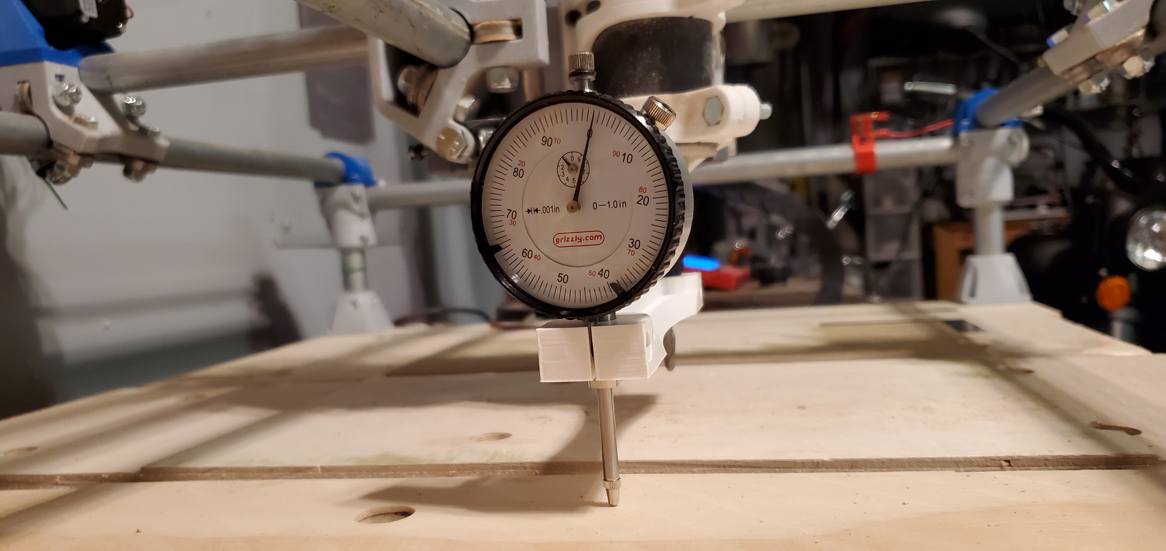

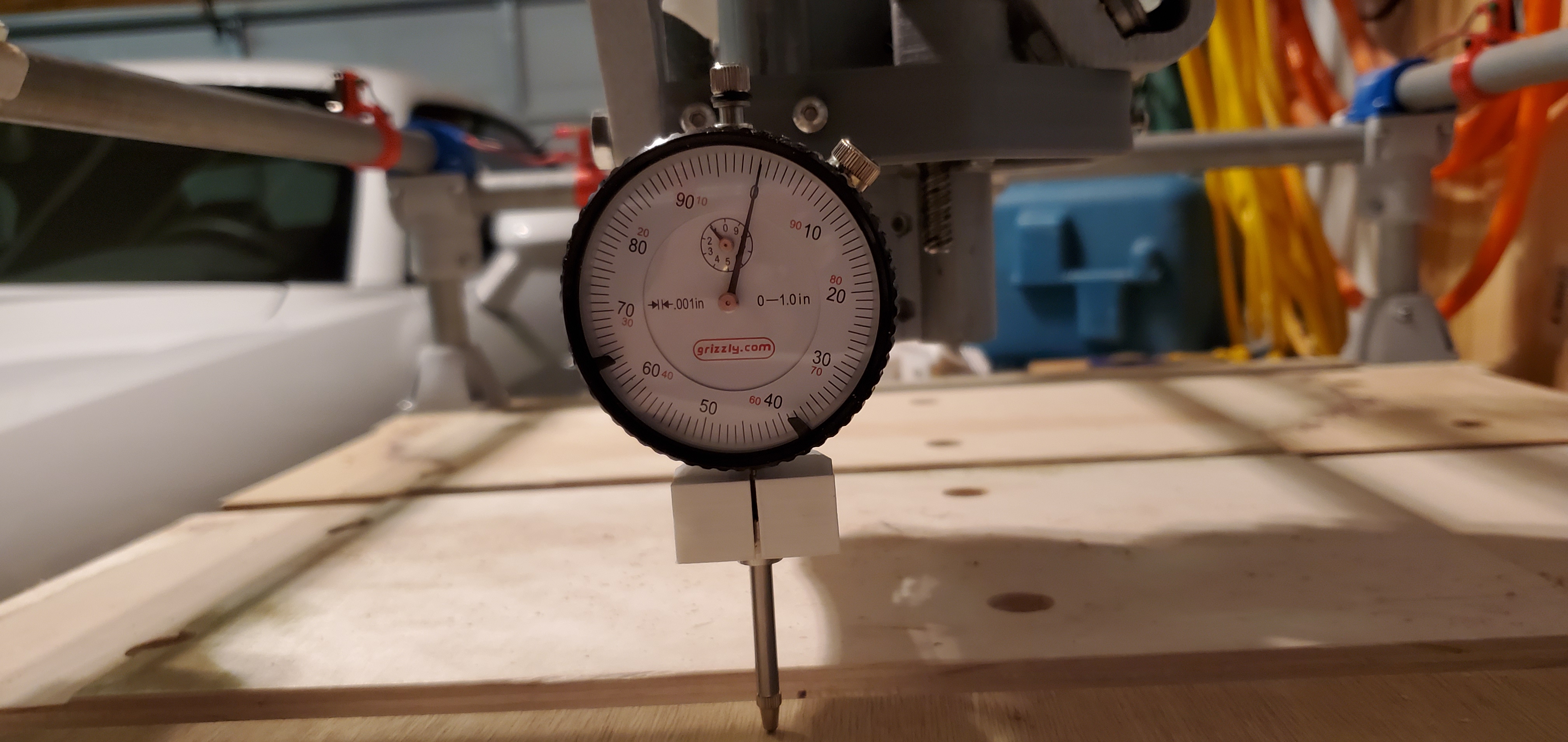

Alright, the verdict is in - figured why not install it, I already printed the parts! So I did… and it works like a charm! Here are some photos showing the dial reading after adjusting the set screws. I ended up installing top and bottom parts. The set screws have a teflon lock-nut on the inside and a nut on the outside to lock the screw once adjusted. Basically the set screws push the main screw/bearing against the Z-body conduit pushing it in the negative direction or releasing it, to the positive direction. I used 2 set screws to have one on either side of the bearing for better adjustment.
Looks nice but isn’t that a too long lever that will minimally bend anyway?
I was wondering the very same thing. Even when I use a metal rod to attach these kind of gauges, the reading vary a tiny bit, so I’m pretty sure plastic will be even less accurate…
isn’t the bend going to be the same in all directions though?
It’s only 15cm long and the profile has a spine to minimize bending. That’s not to say it won’t bend, but if it does, it’s negligible, e.g., a few thousands of an inch…
