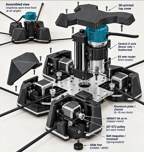

The basic concept is a small central CNC body with a 65 mm router/Z-axis in the middle and four vertical NEMA17 motors around it. Each motor would control a GT2 belt running out to an anchor point at the corner of the work area. The belts could be pulled out manually during setup and hooked to fixed anchors around the spoilboard.
Where possible, it could reuse typical MPCNC-style parts such as NEMA17 motors, electronics, belts, pulleys and Z-axis components, while the rest would be a completely new compact body, mainly 3D printed around an aluminium base plate.

One more Idea. Yes I have used AI to create the pictures
