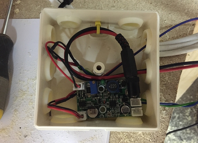

@Leo69 I have places a 10 kOhm resistor on the TTL output on the Ramps board.
The step when i should adjust the current to 1,75A to get the max out of the laser, is stopping at 0,7A.
Yes, the laser diod is connected.
You’ve confirmed that the fan power is on full (S=255)? You’ve confirmed that you have 5V on the Ramps TTL output pins with fan power on full? Are you controlling fan with LCD or sending Gcode with host software?

I have tried both setting the fan output with Repetier and LCD.
Checked the voltage with S0 = 0v and S127 = 2,5v S255=5v
The thing is that the laser i working but i don´t think I can get full power out of it.

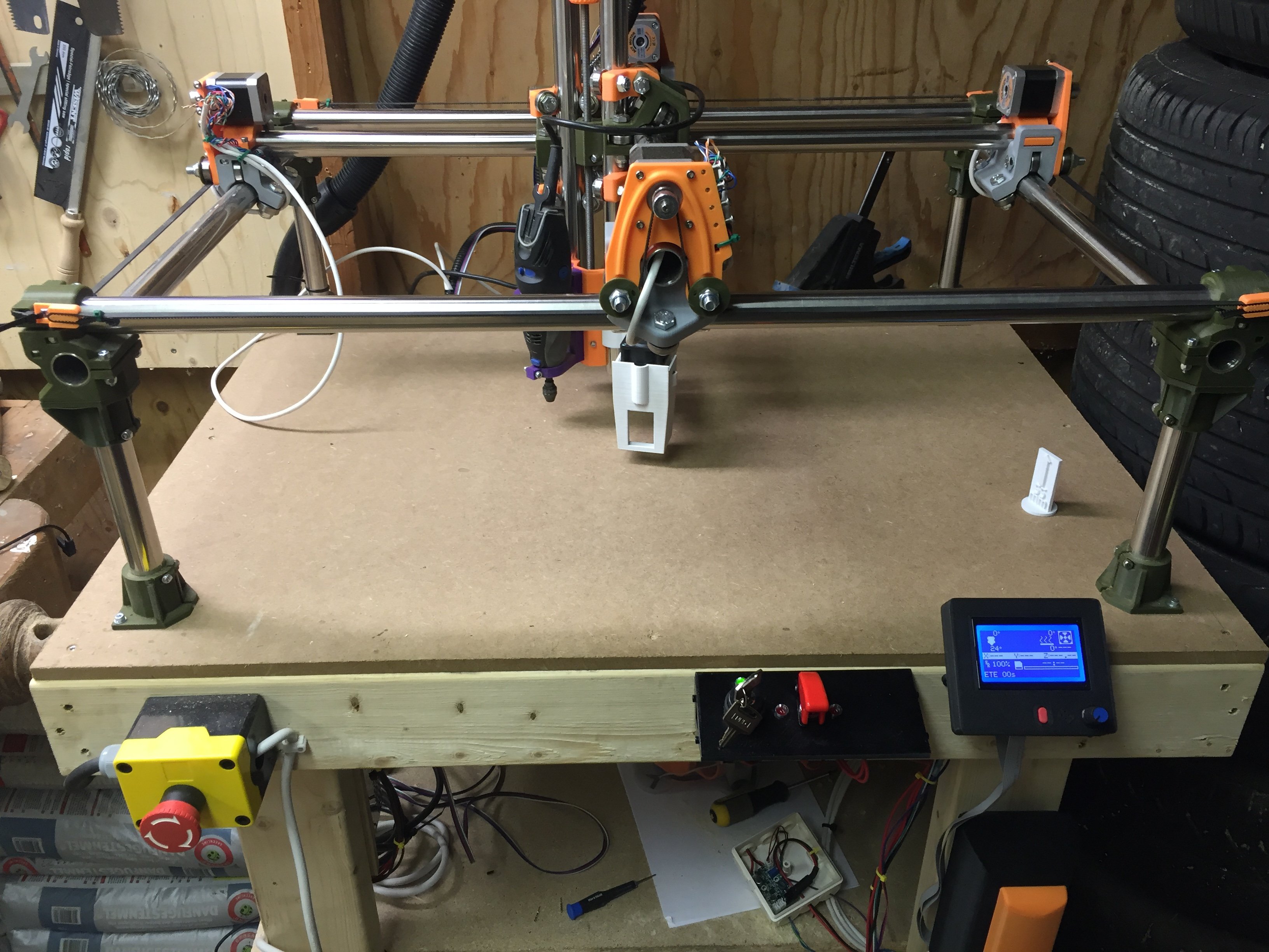

I don´t have any test setup. It´s a complete setup.

I posted some pictures in the Facebook group.
They where to many and to big to upload here.
This forum is loading very slowly for me.
If there will be more pictures in this thread i will upload them to facebook if it´s okey.
Do me a favor and try something for me. Disconnect the laser and connect your meter to the driver laser output instead and follow the steps for the driver VOLTAGE setting with these exceptions:
  1. Connect meter to laser output as in guide
  2. Turn fan to full power as in guide
  3. Adjust voltage to 6.5V as in guide but BEFORE you adjust voltage, turn current adjust 5 full turns clockwise.
  4. After the voltage has been adjusted to 6.5V, turn the current adjust 6 full turns COUNTER-CLOCKWISE.
  5. Connect the laser diode and continue with the current adjustment procedure.
I just want to be sure the driver is at it’s operating current threshold when the voltage is set. I have the LED light to let me know but you don’t so I figure we can try cranking the current up, setting voltage , then cranking back down before connecting the diode for final tuning.
Please give it a try and let me know how it works out.
Also , you mentioned that the laser is coming on. Hot enough to burn things after it’s focused? If so then I would repeat the tuning with a different meter. It’s possible a cheap meter won’t read the current level past a certain point. I had one that wouldn’t go past 1.4amps and then I used my other meter and found I was actually at 1.9amps and had to adjust down.

I tested as you described.
  1. Check
  2. Check
  3. With 5 turns on the current adjust I was not able to get it stable on 6.5V. It shows everything between 3V and 22V. It get out of range in 0-10V settings on the meter.
    I ended up take the current adjust 1 turn counter-clockwise, so it been 4 i total. Then I was able to get i stable at 6.5v. When i was playing with the voltage the LED was turned of at the lower voltage. I didn´t notice exactly when it was turned off becouse of the jumping in voltage with 5 turns on the current adjust, but at 6.5v it was turned on.
    4.Ceck
  4. The result was the same as before, It stopped at 0.77A on one meter and 0.72 on another.
I will try to get my hands on a Fluke meter but i´m not sure when.
I tried it on 2 of my drivers and it worked as it should, and I got to try out the g2 lens as well.
I think you might have a bad driver, if both meters showed the same result.
