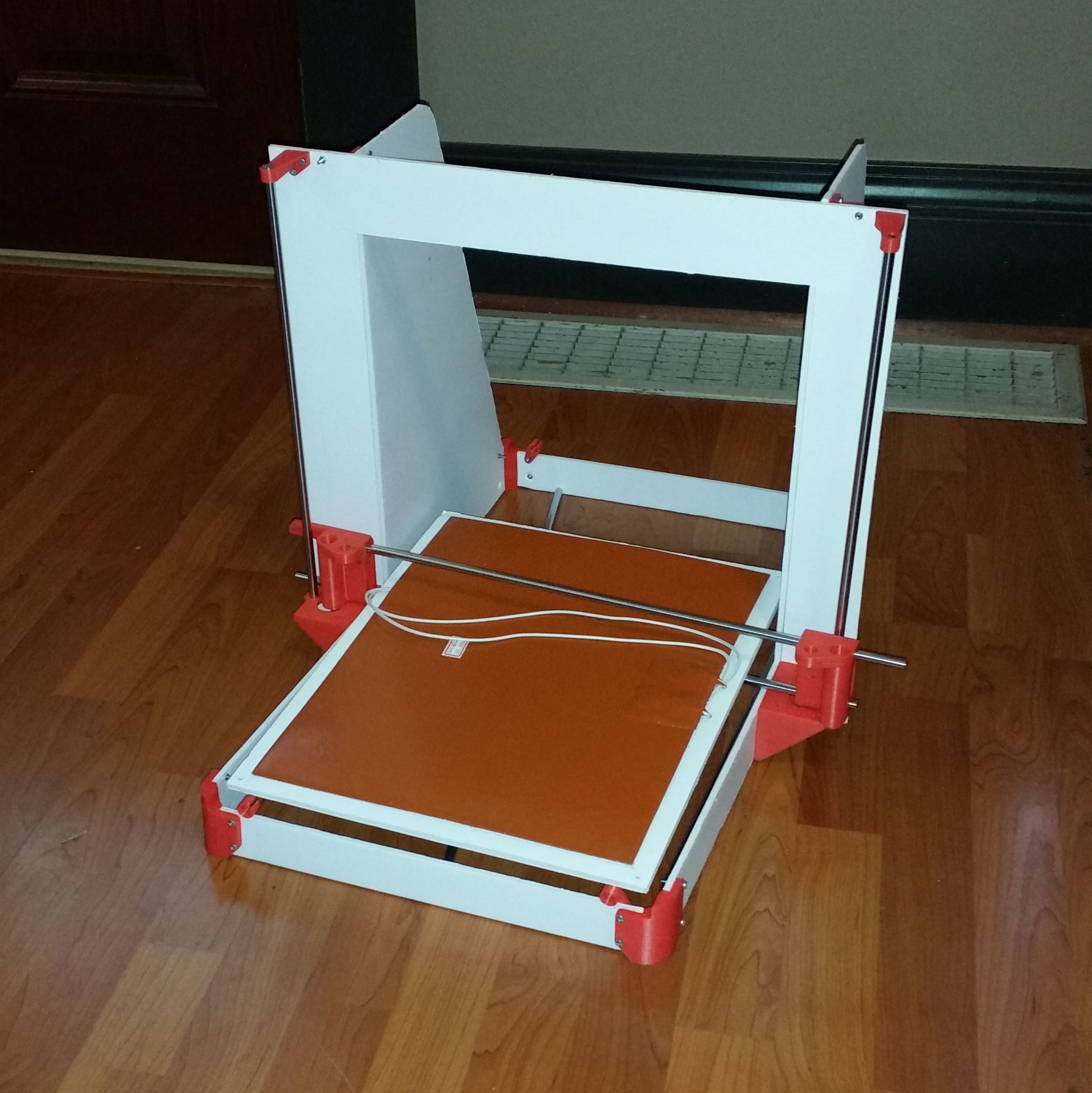

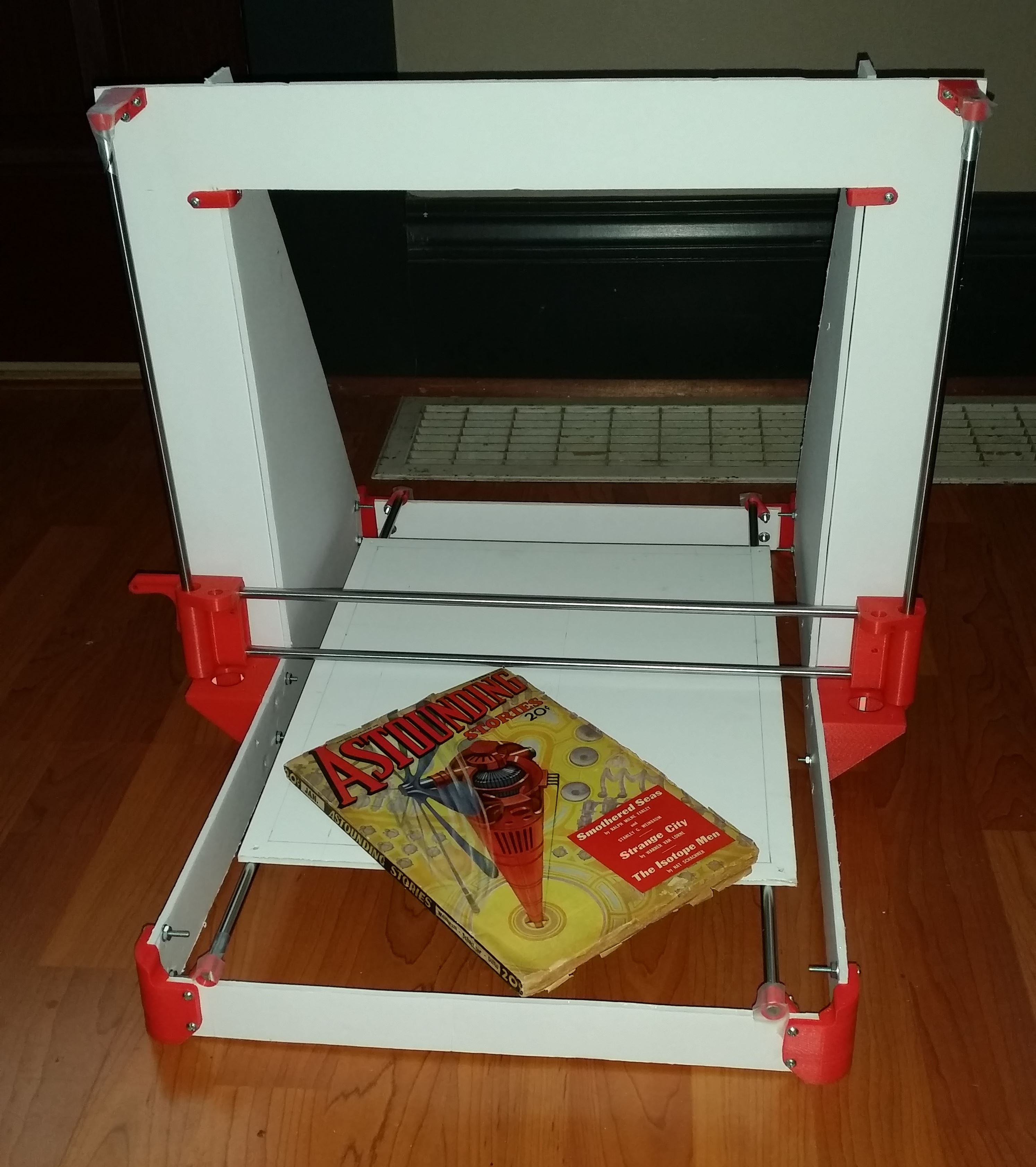

Time to start a build thread on the second printer, we’re tweaking the design a bit though. This one has a 300x380mm footprint using a 600W silicone heat pad with glass for the build area. So far we have a mock up assembled with foam board, though all the printed parts are done. We’re thinking of remixing a few parts, but the bulk are stock. First image still needed some resizing of the routed parts, second is much closer to right. I put the pulp magazine from the 1930s to give an approximation of size (about 7x10").
Looks awesome. I don’t have a pulp magazine from the 70s as reference. 300x380 seems pretty big though.
You’ll have to put it next to the other one and take a pic when it’s done.
That is awesome! Nice work Bill. Now you can print me the Cyclone Dust Collector (which wont fit on any of my beds), LOL.
I would love to see a side by side as well!

Will do. I get back home the end of the week so it’ll be a few days. My partner on this needed one big enough to print skate shoes for one of his projects and his should work just fine!
