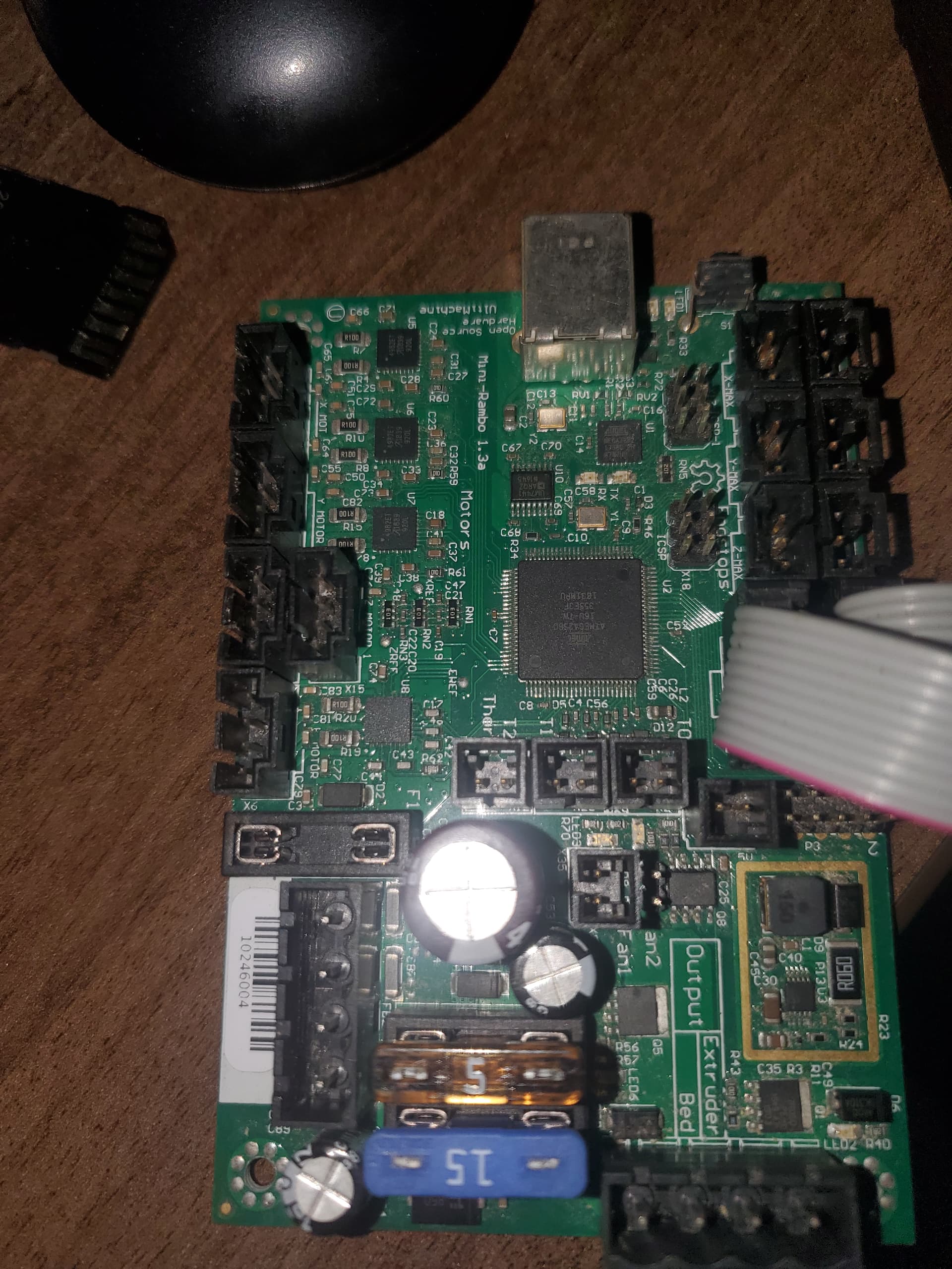

Mini Rambo 1.3a board keeps blowing 5 amp motor fuse
Good day all, i recently moved my mpcnc to a bigger enclosure, whilst doing a cutting job the machineissed steps, it track it back to a issue with d rails not being perfectly squared, so I took of the machine and square it, however when i restarted the machine i saw smoke from the rambo mini board so ill press the emergency button, and started to inspect d board, i saw that the 5 amps fuse responsible for motor control as blown, now when i replaced it with a new 5 amps fuse, the board keeps blown the fuses immediately, i even when i unplugged all motors and try it again, once d power is turn on the fuse blows. Has anyone had this issue or have an idea what is causing this?

Thats my initial thought , so i cean the board and still not luck. The funny thing is the board comes on, wven the lcd comes on and works but not the motors and if i quickly bridge d fuse holder the board restarts
Can you post a good photo of the board?

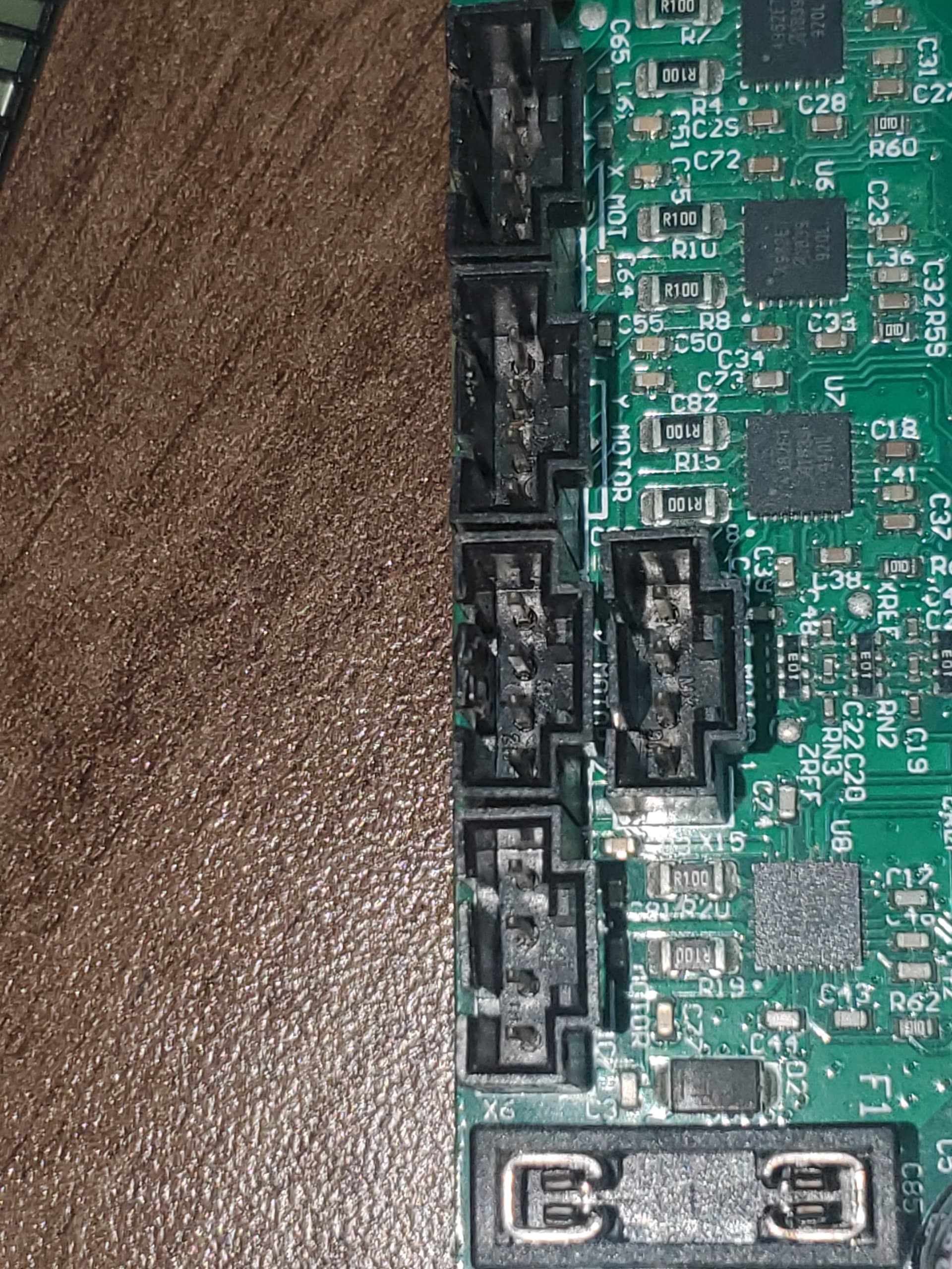

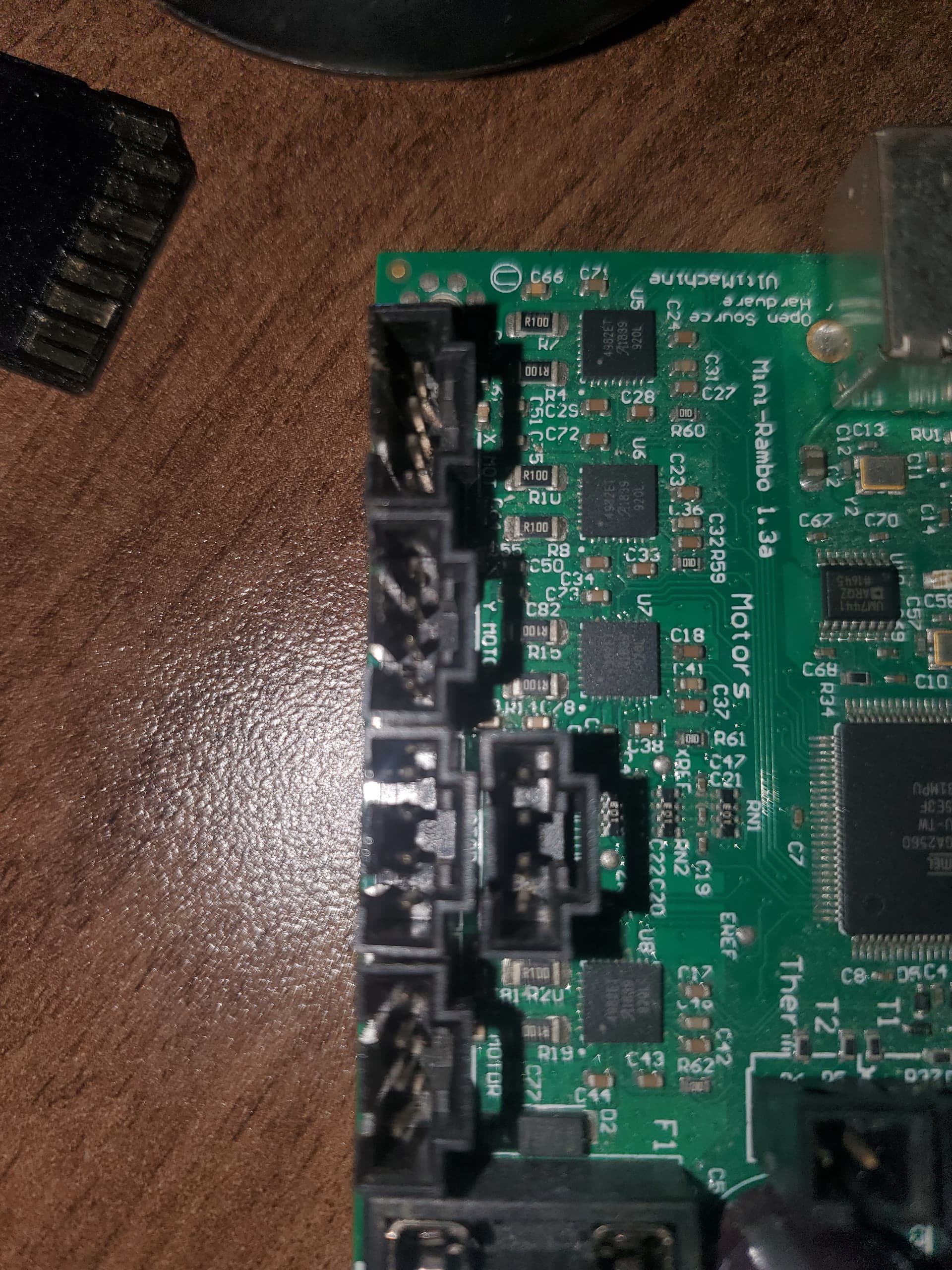

It blows the fuse even with no steppers plugged in, so i can rule out d steppers and its wiring for now. I looked and cleaned inside the steepers plug mounts on d board all cleaned
Board might be toast then. If you post a photo of your board with some good light on it, we can look and see if anything jumps out at us to check.
Here is a picture of the board
I am thinking the same think but if its toasted woould d led boot as normal and i can even select print files and run the code, its just d move does not run, n it blows d fuses instantly

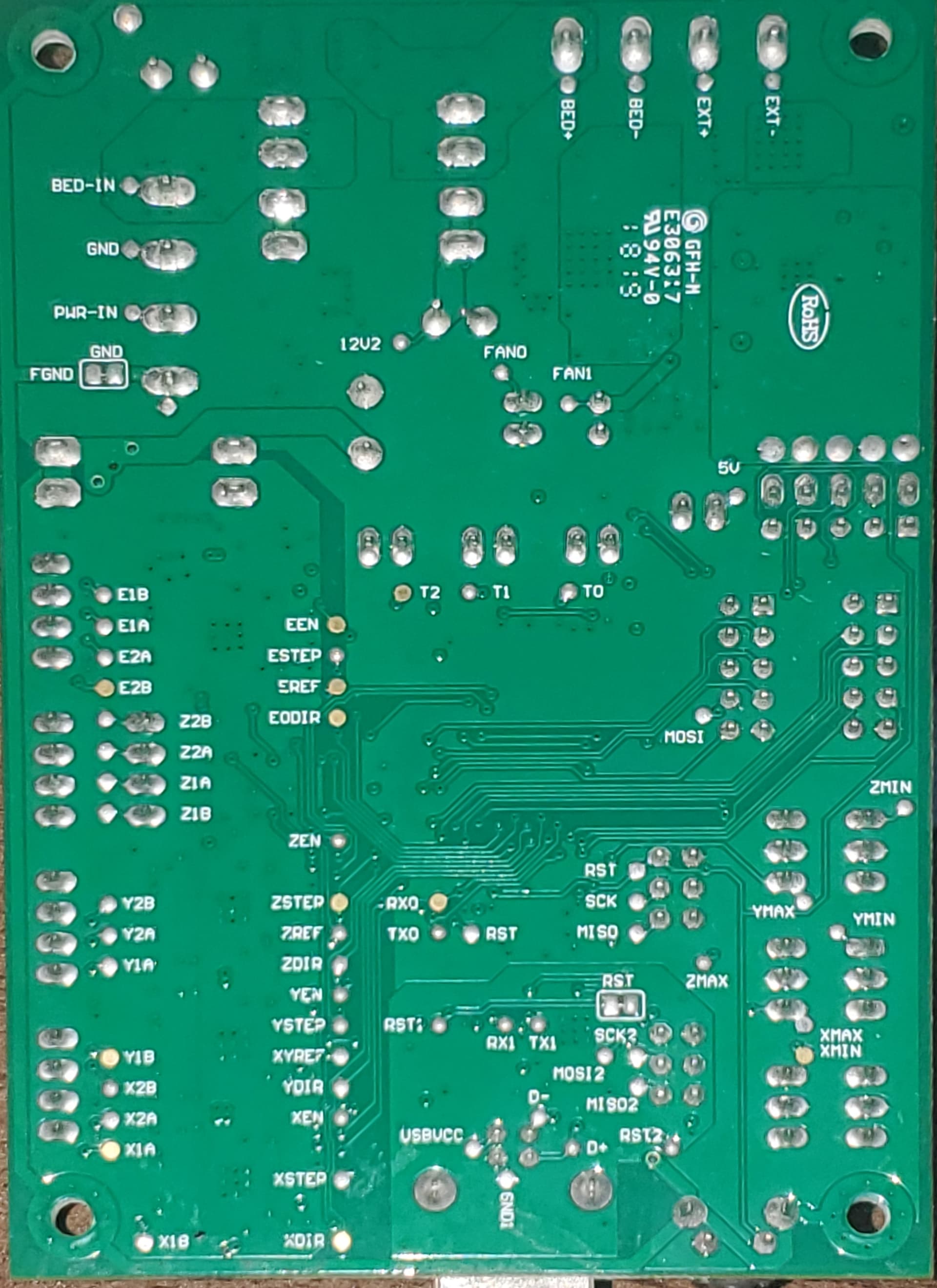

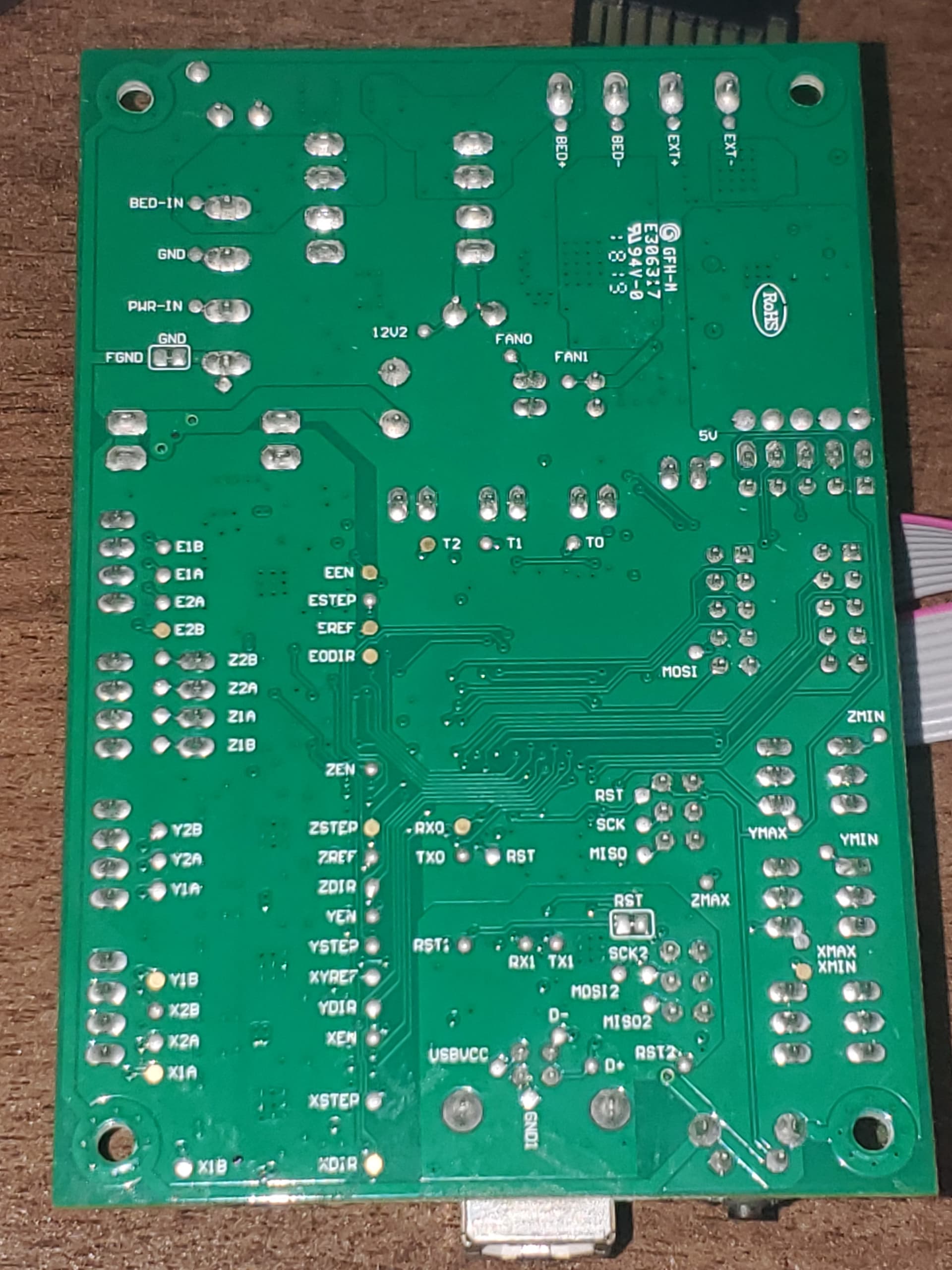

What’s the bottom look like?
I don’t know dude. That’s weird. Board looks fine.

You said that you saw smoke coming from the board - pretty good evidence something on the board is toast(ed). And popping fuses with nothing plugged in that tells you too. Obviously, the challenge is finding what fried. The best lighting and highest magnification you can get will help. As best you can, inspect the components from the sides as well as the top. Considering there was smoke, I wouldn’t necessarily be looking for just blackened components - especially on the I.C.s. I’d also be looking for a grey area that might be smoke residue. Might sound strange, but your nose can be a help sometimes (yeah, yeah, toxic fumes …) One thing I see that seems a bit off is that quad flat pack labeled Q8? In your pic, it looks as if there may be some pitting (blow hole?) on the top. The other is that black component on the right of the fuses. Probably just because the pic of it isn’t very clear. Good luck.
Yeah. The smoke is probably causing a short. It may be something like a diode that cooked and turned into a short. I have had this happen and it can be very hard to find.
If you found it, we could help you figure out what part that was. Then you would have to order it, and then do the replacement. That might fix it, or whatever toasted it might just take out the new chip. Rework is also not a guarantee. Sometimes it works, sometimes something gets broken while soldering.

For the original problem… Blowing the fuse with the power on, becore enabling the motors probably means that it’s a component in circuit before the driver. I’d look at the components in the power conditioning circuit first. These will be near the fuse,
. Ill will try to look for the component but i dont have the skills or tools to do smd repairs., i will cancel the order of the new tdt 35 v3 s reen cus i dont care for touchscreen, ill put d $45 towards endmills. Once again thanks for the advice
