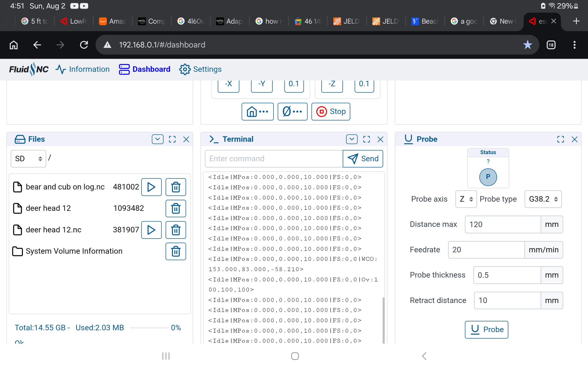

No, the UI should run it if it has the correct extension and it can load it. Can you post a screenshot of the UI?
ok here it is. The deer head 12 with the play symbol is estlcam and the other without the play symbol MM.
You need to add the “.nc” file extension. I believe “.gcode” also works.
Need a file extension that tells FluidNC and WebUI that it is a gcode file.
I’ve always used gcode file extension without issue. The 2nd file in that list doesn’t look like it has an extension and is most likely the issue.

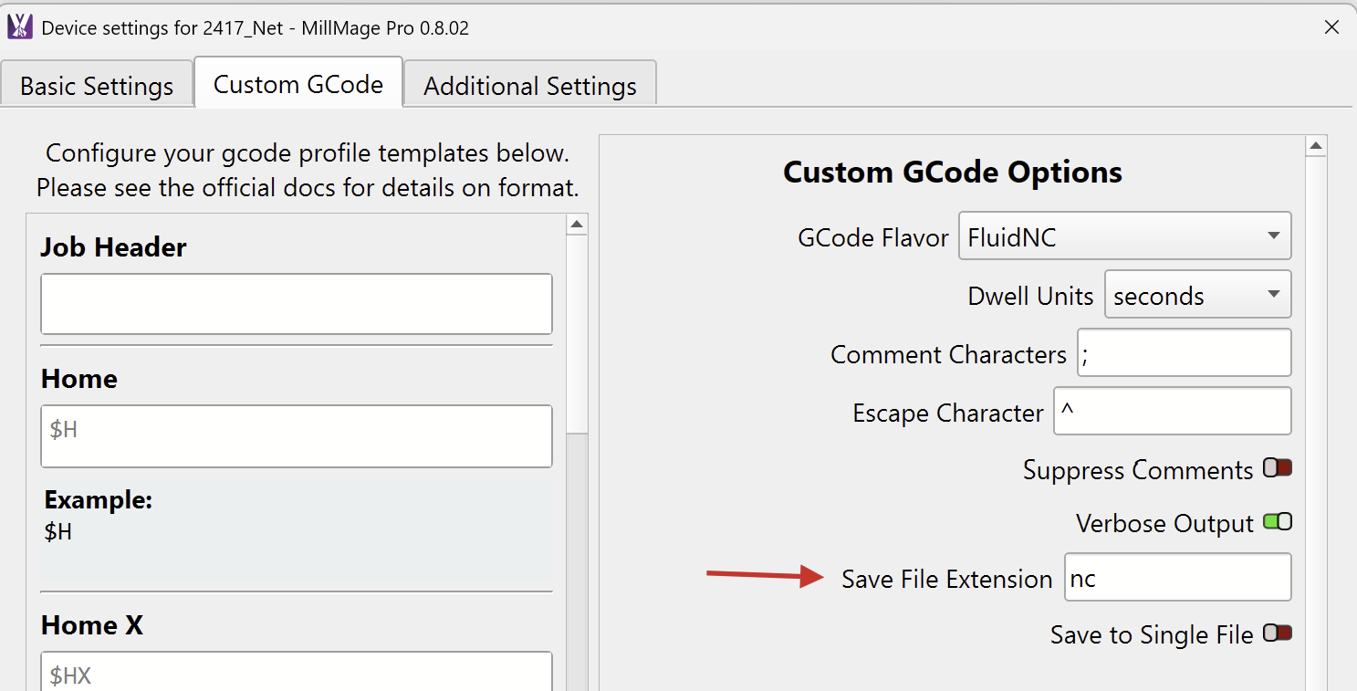

You should use the FluidNC GCode flavor in the Device Settings instead, but that’s not the problem here.
You can change the exported file ending in “Edit > Device Settings, Custom GCode” here:
Thanks Aaron
