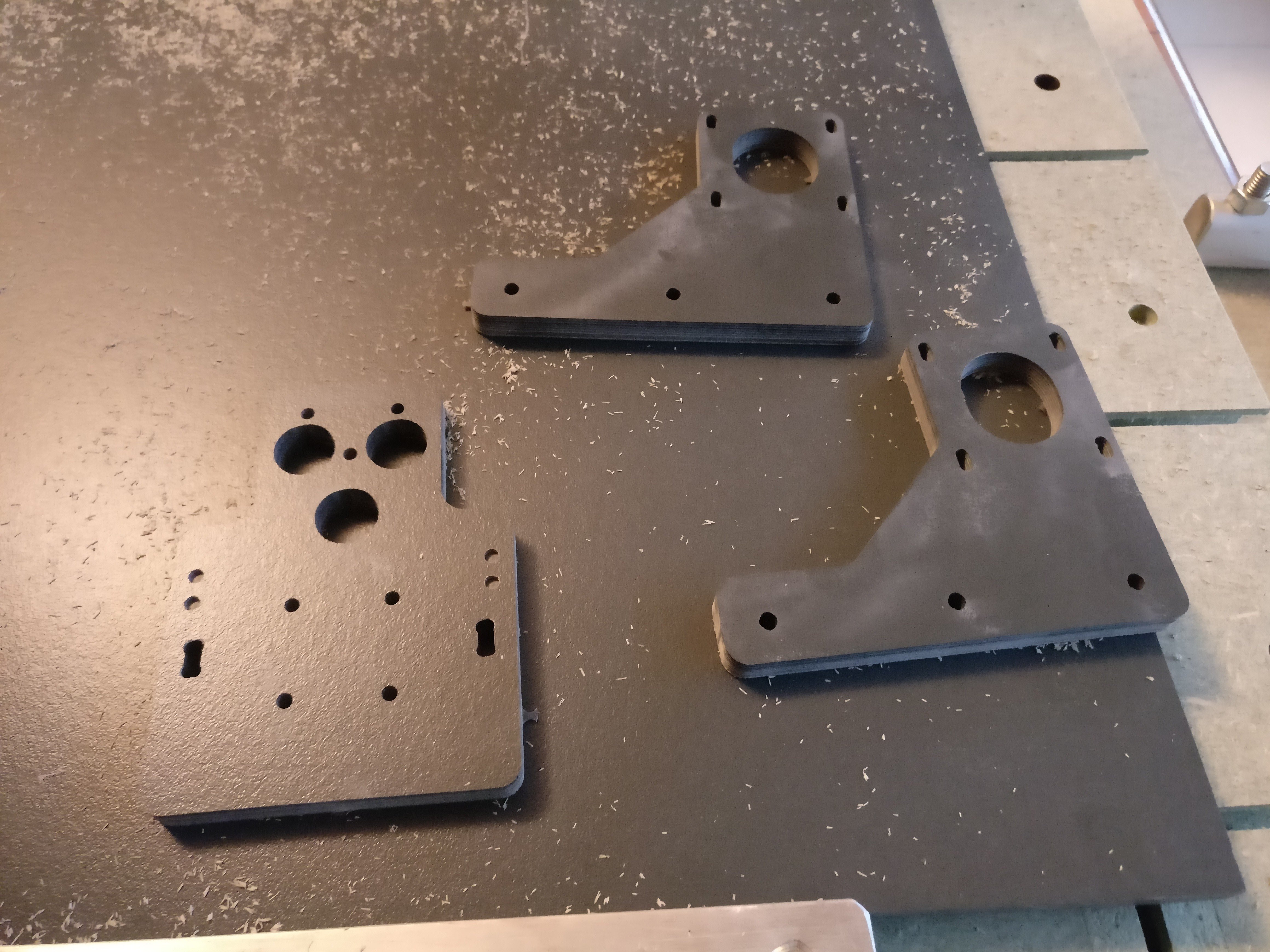

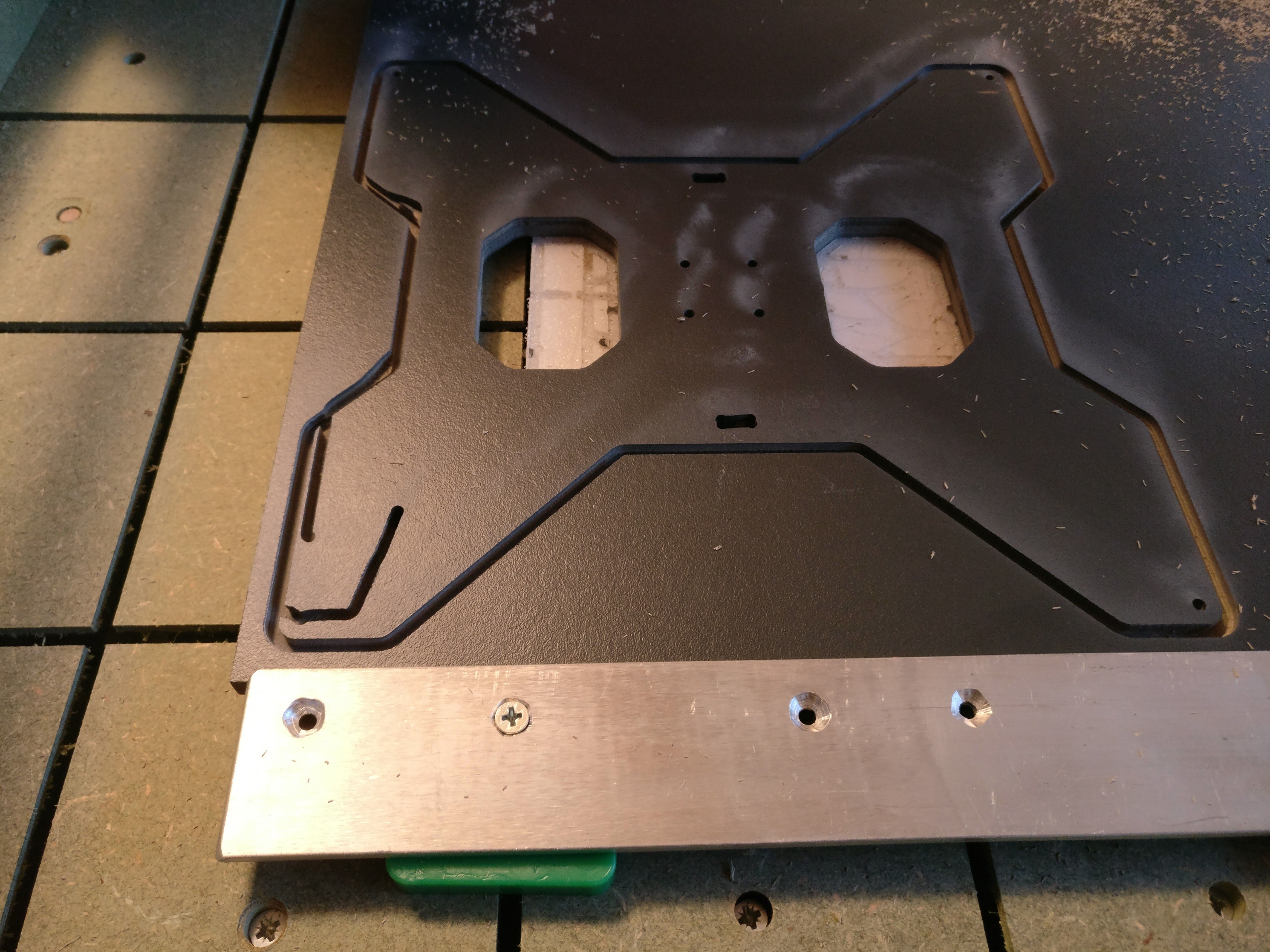

Best friends,
Do you have any idea what the problem of this may be?
Sometimes it’s fine, (picture 3 pieces).
At the larger part, it goes wrong (picture).
DRV8825 Stepper Motor Driver, tested between 0.7 and 1 volts, same result.
Problem does not start in the same place but is really at random.

What are your rapid speeds set at?
bitpower
(Marc A)
July 15, 2017, 11:05am
3
Wow Ryan,
That’s fast.
Std Marlin software of your webside.
Mil 3mm double flute 30.000 p/min
Z+ 0.9mm
Fxy 20 mm/sec
Fz 10mm/sec
vicious1
(Ryan)
July 15, 2017, 11:09am
4
There it is, Z can not exceed 8.4mm/s unless you change your firmware. This results in random processor overloads.
bitpower
(Marc A)
July 15, 2017, 12:06pm
5
Ryan,
You’re the best.
Just milled the Y-plate again without problems.
Thank you kindly for your super fast reply.
Best regards Marc A
