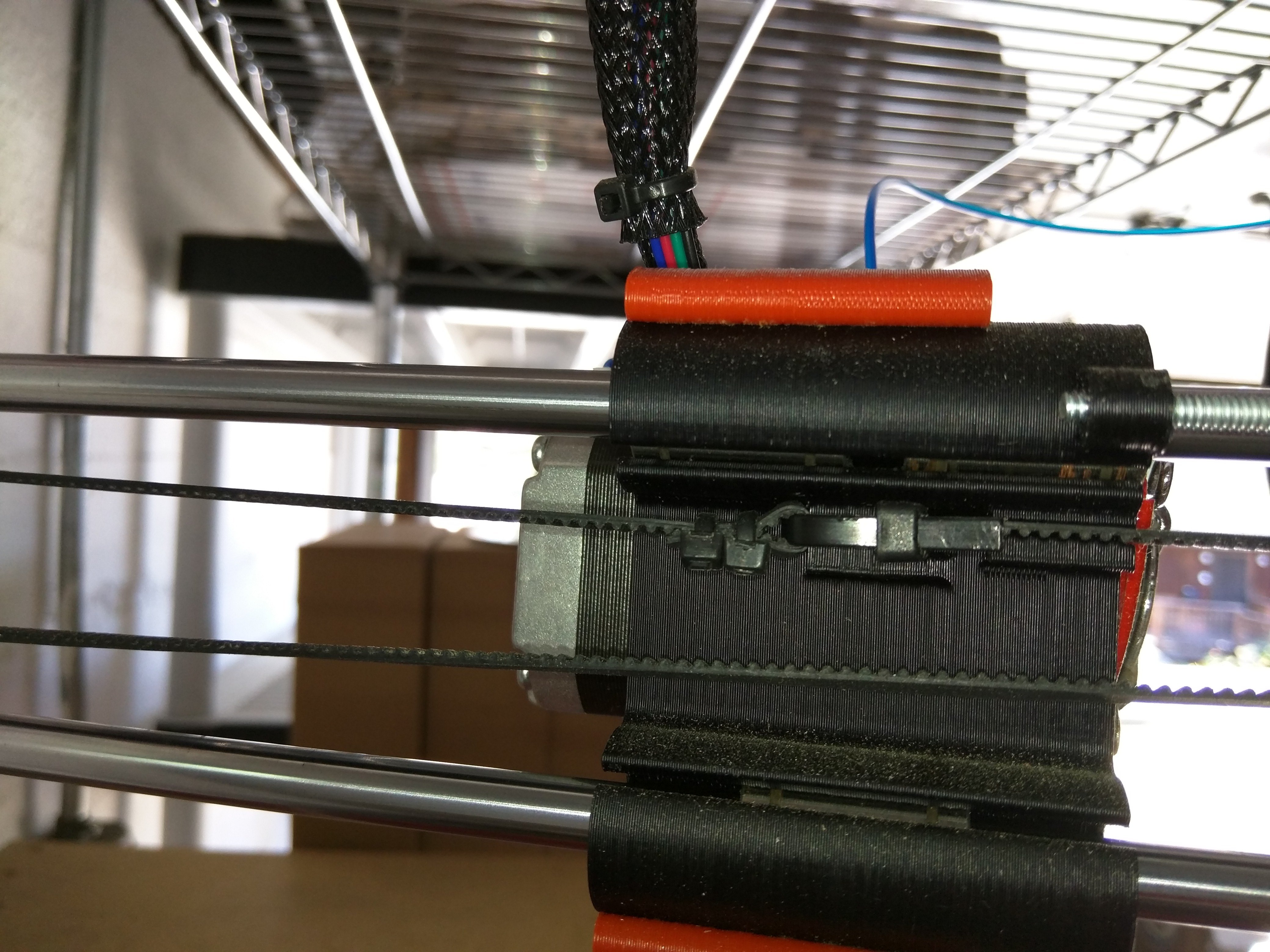

I also have no idea how you meant to hook up the timing belt. What I have works and looks reasonable, but doesn’t quite feel perfect… (Pics tomorrow)
Does this help?
That’s a bit easier than I thought… I used a zip tie on the other end too as a just in case…
