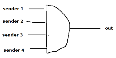

A UART is high when idle, if I recall, which is why an AND gate would isolate the TX from each other and forward whichever sender is pulling the TX line low. If multiple senders talk simultaneously then garbage occurs but it is safe electrically.
Also since high is idle, a falling edge (or floating line) generates garbage so you have to be careful with the switching.
So, if input 2 was idle (high) and input 3 was transmitting, and low… The idle line would have enough resistance so that the current going from 2 to 3 would be low enough (presumably, because of a large enough pull up resistor) that it wouldn’t let the smoke out? You’d essentially be shorting an output of high to an output of low though, right? If you did that on a normal arduino (SoftwareSerial, perhaps?), that would break something.
No, in my scenario they are all inputs to the and gate. Like this:
And they need pull-ups or else if one goes away with an open circuit it ruins the channel for everyone.
You could implement a poor-man’s AND gate with diodes and a pull-up resistor but it might be kinda crappy since the diode drop means the ouptut voltage won’t really be zero, and there will be extra capacitance, and the output impedance won’t be very low:

Yes, you do need to be careful that you don’t short the serial line. The serial data doesn’t like going through a diode (but it will).

Right. But I was talking about the first wiring diagram.
I am not sure how risky it is overall, since there is some internal resistance, and the bits are only ground for a short period (no pun intended).
Ah, ok, I missed that in the original diagram, multiple can be enabled at once and 2, 3, and 4 disable 1 but do not mutually disable each other. So yeah it seems they would fight each other to some extent.
Looking at it again now, there might also need to be a pull-down on pin 1 of the 4001 IC, or else floating (or even low) values on the other channels could leave serial 1 disabled.

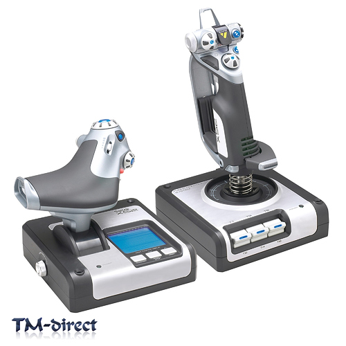

I have this PC Flight joystick, (Saitek x52) that I don’t use much anymore, wonder if I may be able to use it. Would be so cool to tie into the extra buttons for custom commands!
