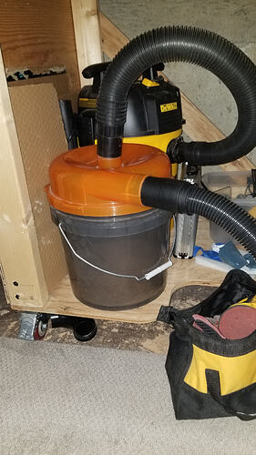

I went down a rabbit hole with the various 3D printed cyclones and other dust collection things. I think it’s cool to see people pushing the envelope like that, but at the end of the day I got a 20L bucket, mounted a cheap Chinese cyclone to the top and then cut some baffles to stop it getting crumpled by the vacuum.
I think I’ve emptied that bucket 10-15x while still on the original filter bag for my Makita shop-vac. I really just don’t think there’s actually that much benefit to having 99.99% dust collection vs 99% dust collection in most cases.
My one thing is that I wish it was easier to see inside to know when it needs emptying. That would be a much bigger quality of life improvement than preventing a few extra grams a week from getting into the Makita bag.
And it keeps up with my thickness planer pretty nicely, too. The bucket fills up bloody quickly, though.

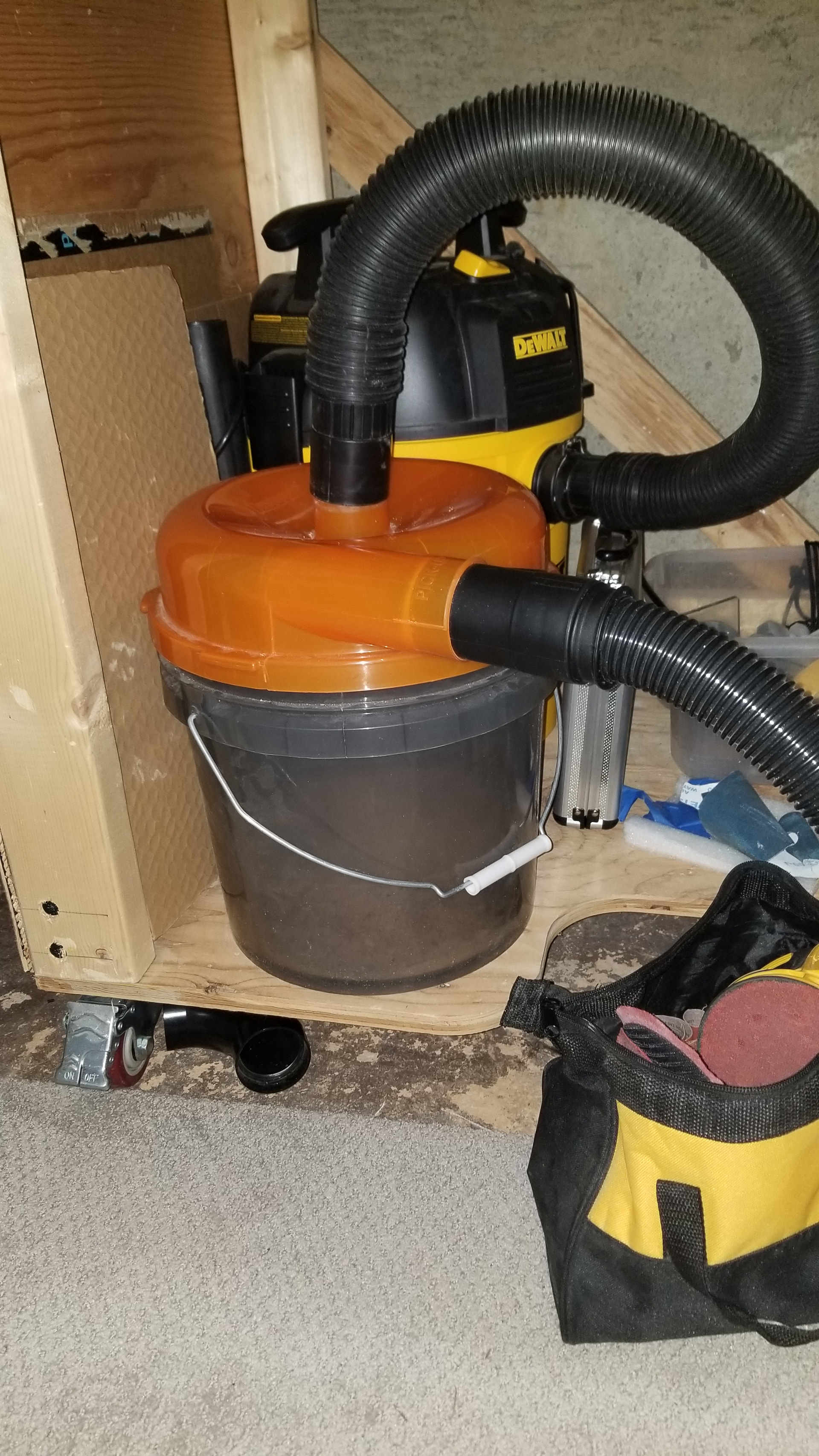

Have 3.5 gal (~13 litre) translucent bucket that’s easier to see when full…
I wouldn’t trust the filtration of this setup for frequent use of fine particle generating cuts, anything carbon or toxic woods.
Ideally, detaching/reattaching the Dust Stopper would be easier, or, bucket would be clearer with easy removable drawer bin (similar to home shredders), while still having decent vac seal. There’s some interesting diy options/videos out there.
Yeah, in my case I just went with the cheapest 20L bucket that was there. I also went with 2 of them so I could slide the inside one into the outer one and screw the outer one to the cart I made for it, so even if they were clear, it’d be hard to see through.
I saw a couple of designs based around clear square storage tubs that looked good. I intended to laser cut an acrylic window for the lid to glue in place before I lost access to the laser cutter. Oh well, I just lift it and give it a shake every now and then.
I also did solid PVC pipe and swept angles for the connection between shop vac and cyclone. No idea if that helps much but at least it’s an attempt to limit some of the pressure drop over the corrugated hose.
