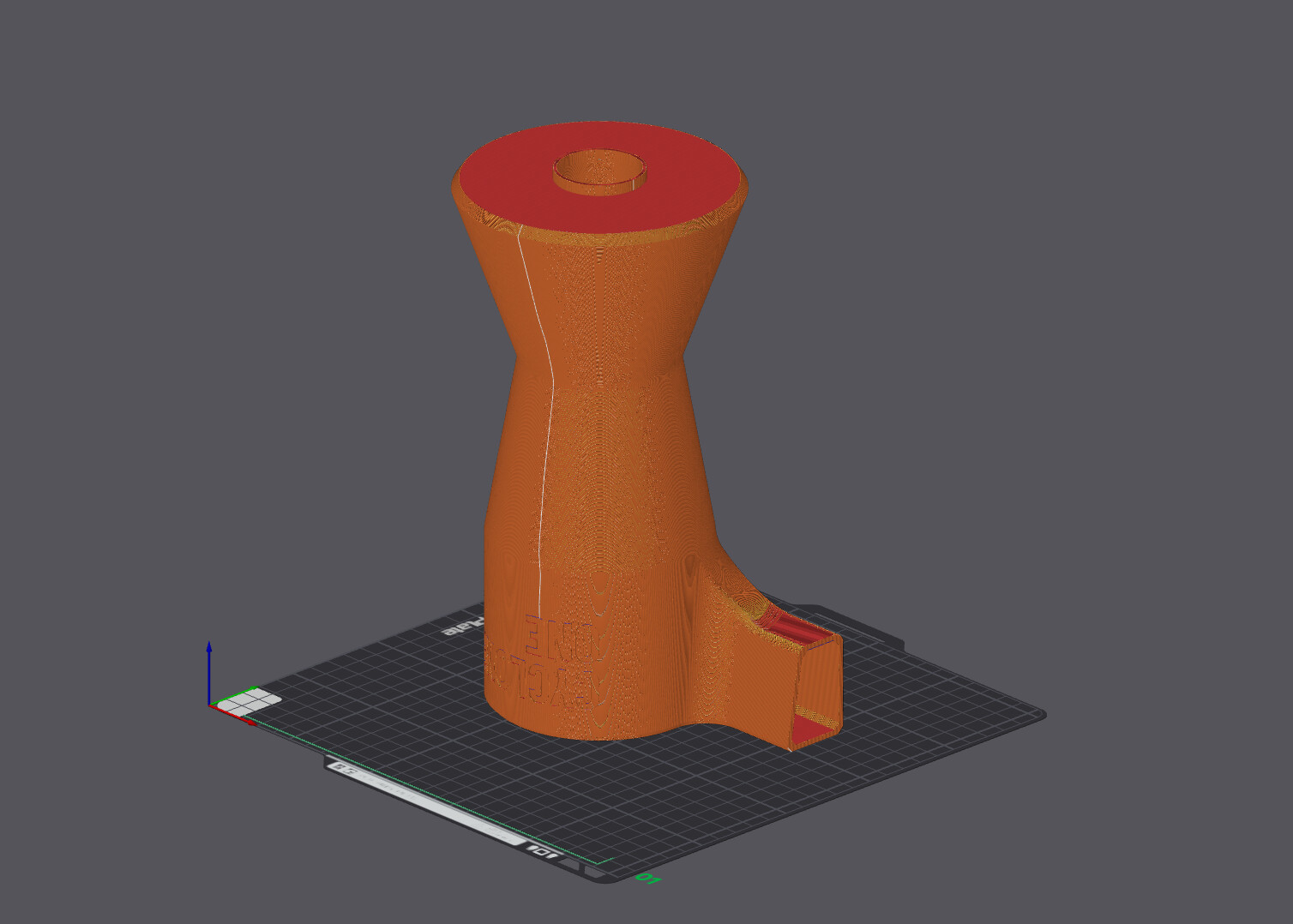

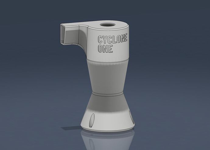

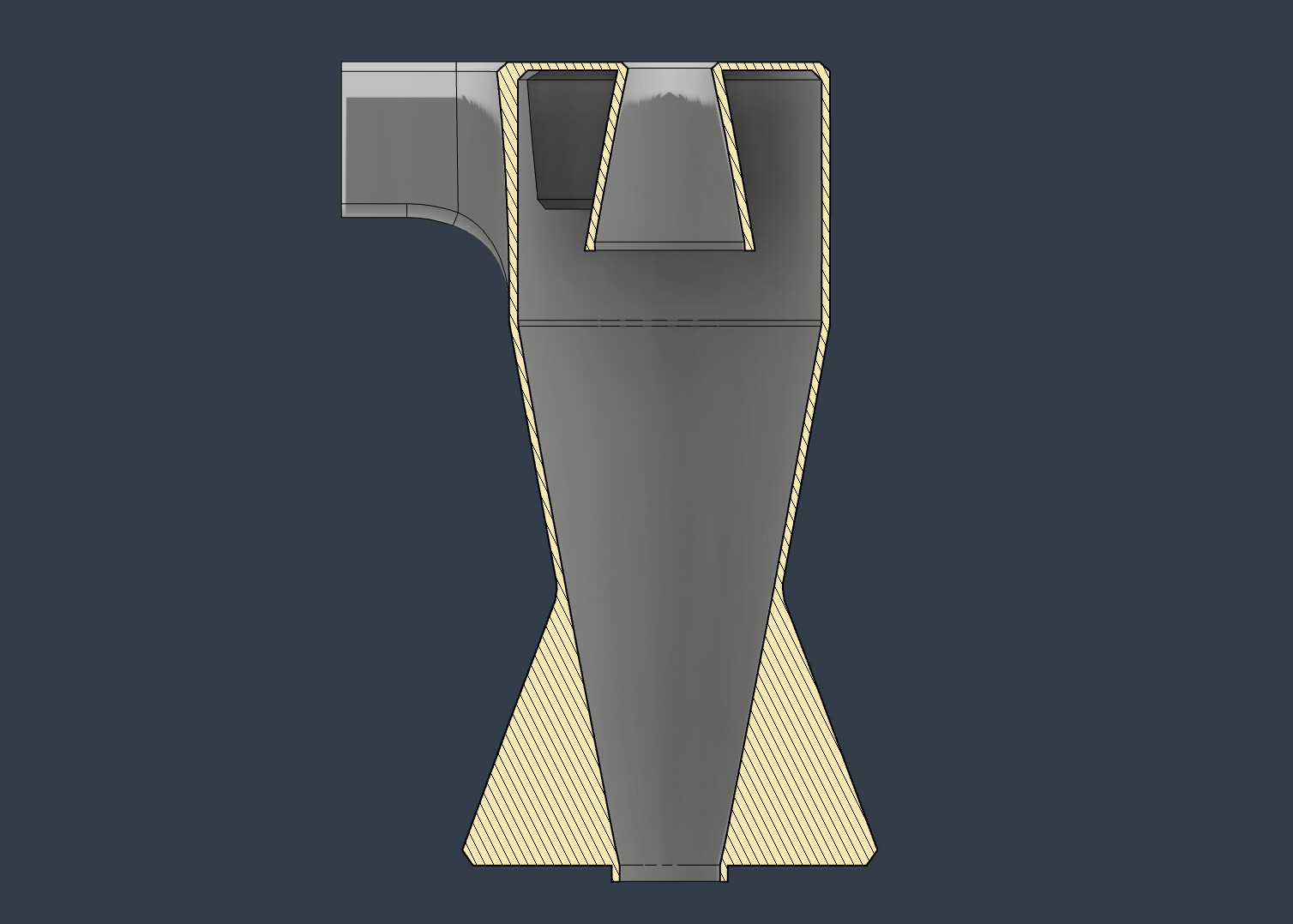

Wanted to share a dust cyclone I’ve been working on today. I just ordered a Henry Vacuum and thought I could use it on my CNC maybe along with a cyclone bucket.
There are designs on printable, but I couldn’t find one that’s a single piece with no supports.
This fits on my P1S. Will begin testing soon. Quite a lot of fun designing these cyclones!
it might be worthwhile to make the vacuum connection round rather than rectangular so it can mate up with an actual vacuum hose.
